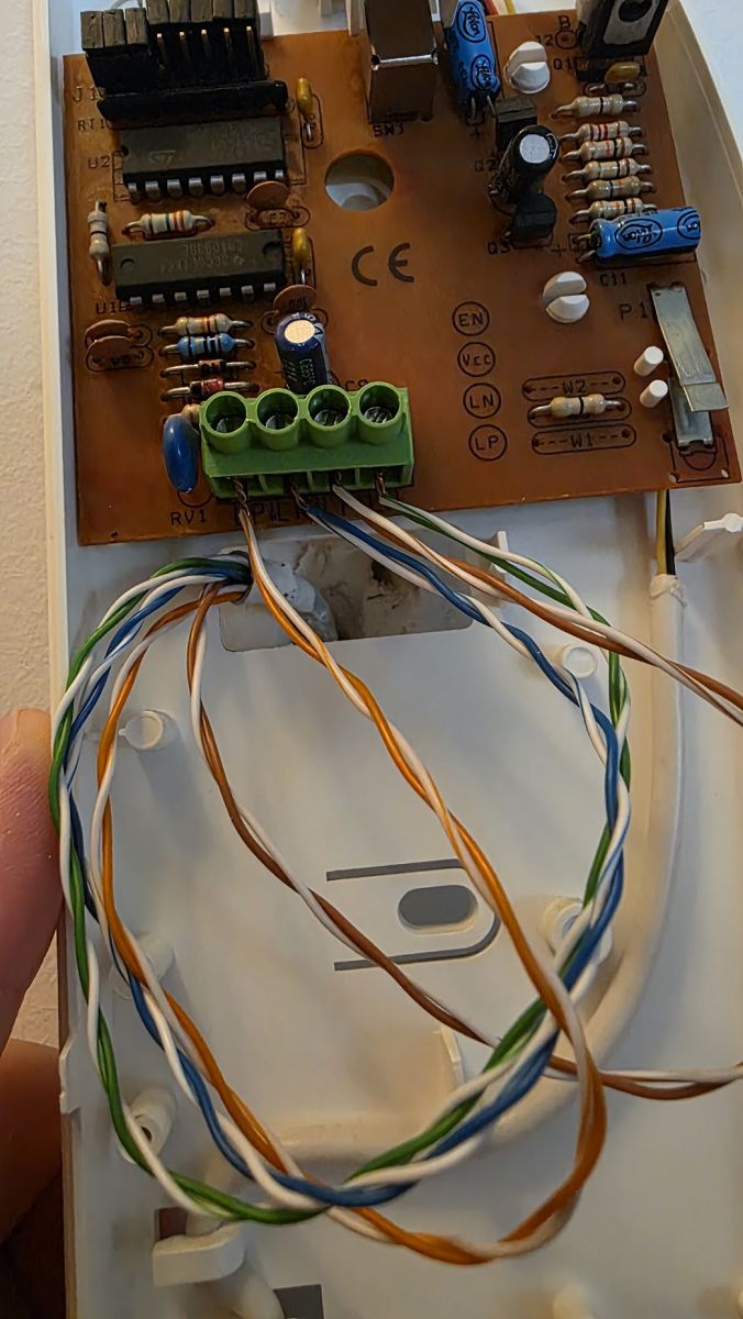

    I had an old Farfisa intercom station https://www.farfisa.com/en/catalogue/intercom-for-df6000-km812w.html (old connection attached).

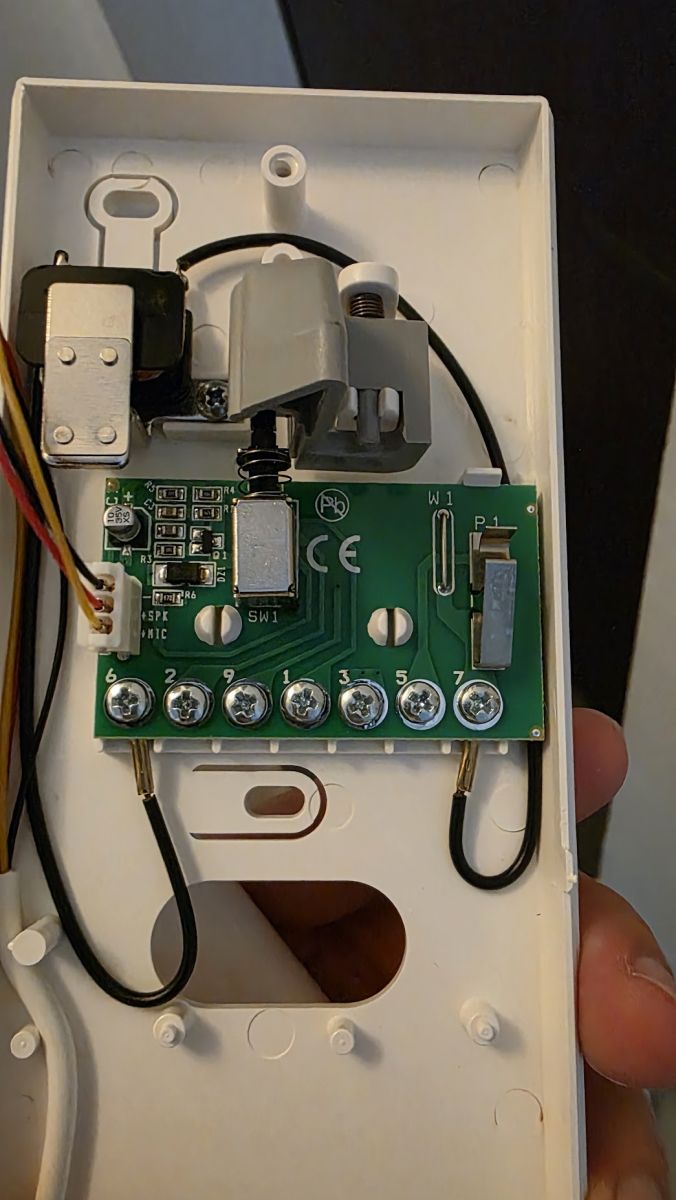

    The new one is https://www.farfisa.com/en/catalogue/basic-intercom-pt510w.html. (photo attached)
    Pls advise how should I connect the new system?

    Interior of new PT510W intercom showing circuit board and terminal connections
    Circuit board of old Farfisa intercom with connected wires

    You have bought the wrong uniphone. The uniphone PT510W does not match your system.

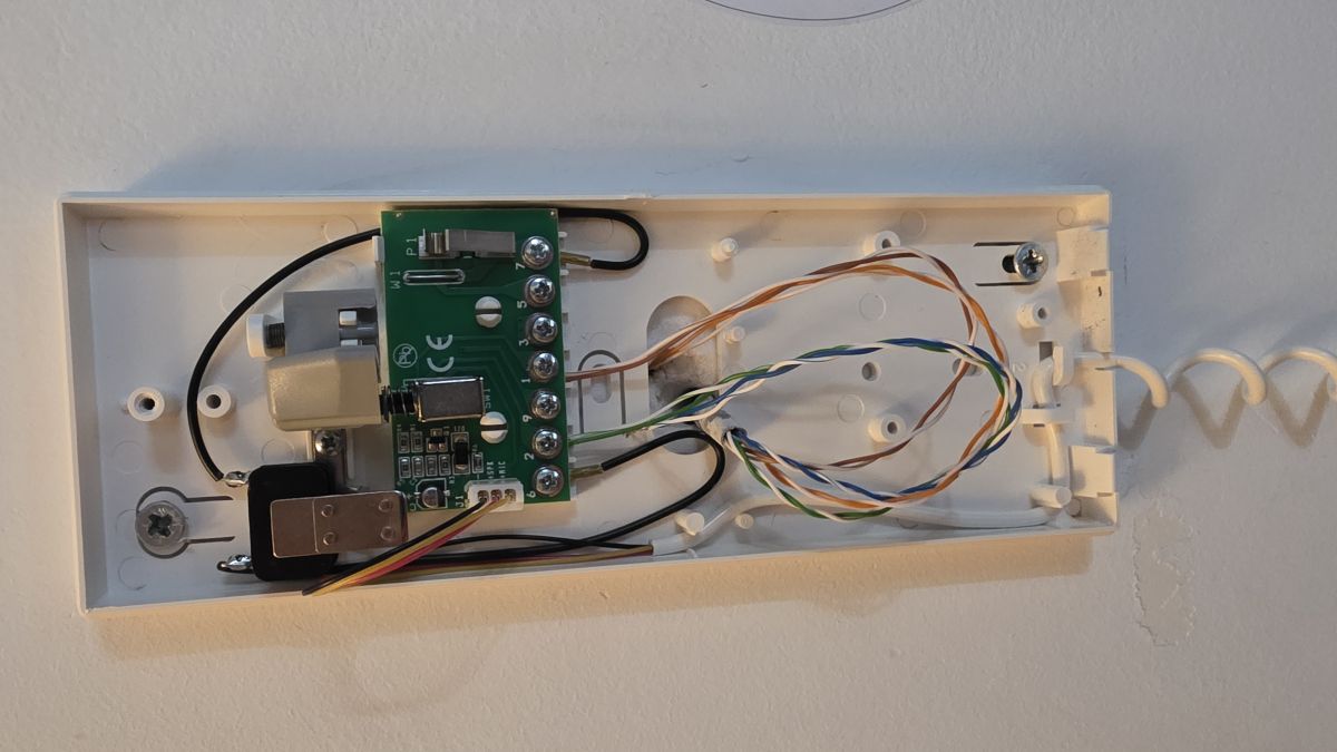

    Dear sir,
    I've managed to match 2 wires.
    I can hear and can be heard.
    While testing I also somehow managed to open the door and receive the call sound.
    But can't repeat it.

    Opened intercom with exposed circuit board and connected wires on a white wall.

    Don't get it wrong, you have the wrong uniphone

The discussion concerns replacing an old Farfisa intercom handset with a new PT510W unit on an existing 4-core twisted-pair wiring system. The new PT510W was identified as incompatible with the original installation, and attempts to connect it only partially worked: two wires were matched, allowing audio in both directions, and intermittent door release and call tone functions were observed. After further clarification, a compatible replacement for the DF6000 system was recommended, specifically the Farfisa EX312 model. The final outcome was successful installation of the compatible EX312 intercom, with all functions working correctly.
