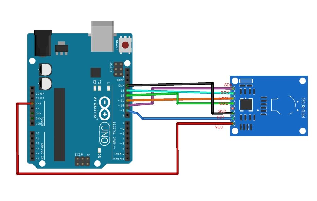

    Wiring diagram between Arduino Uno and RFID RC522 module
    This is the RFID wiring diagram

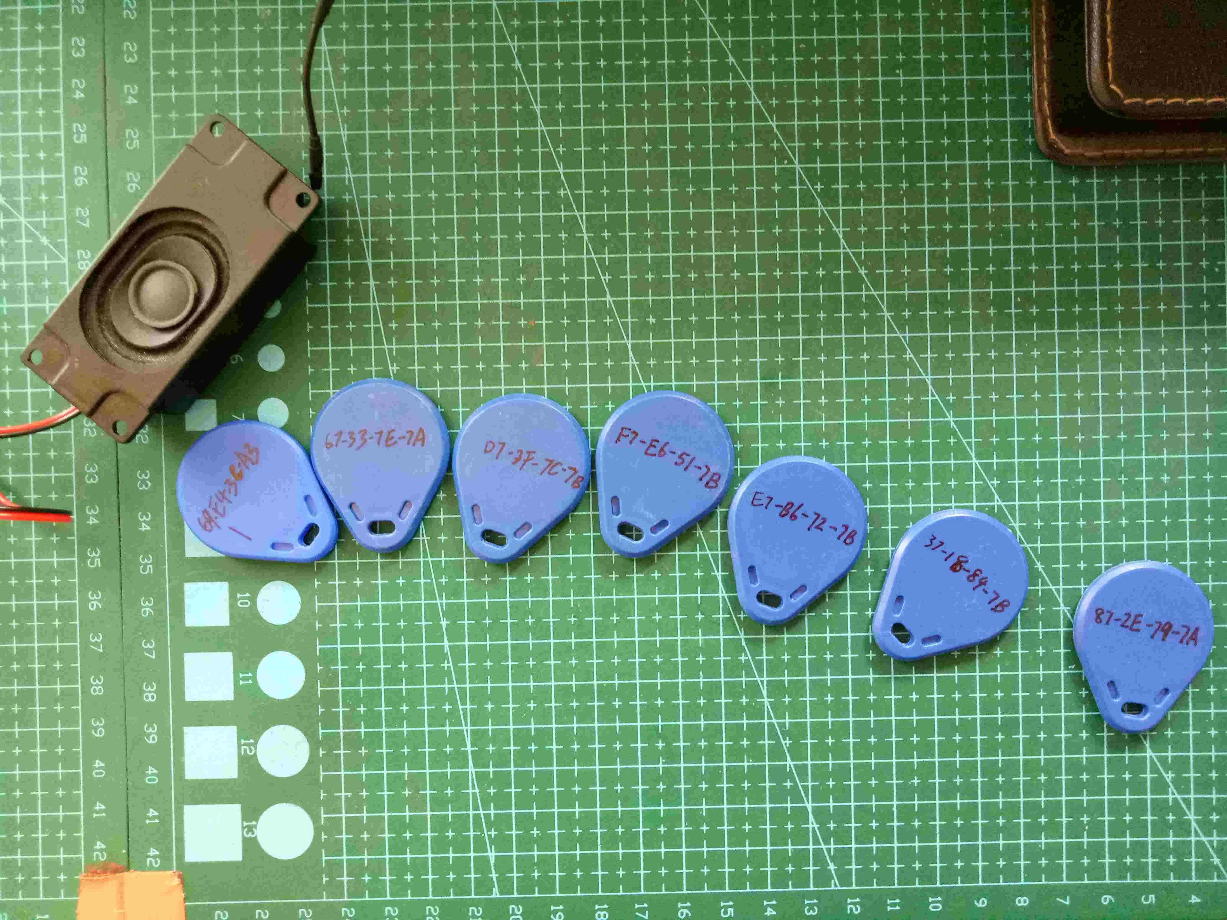

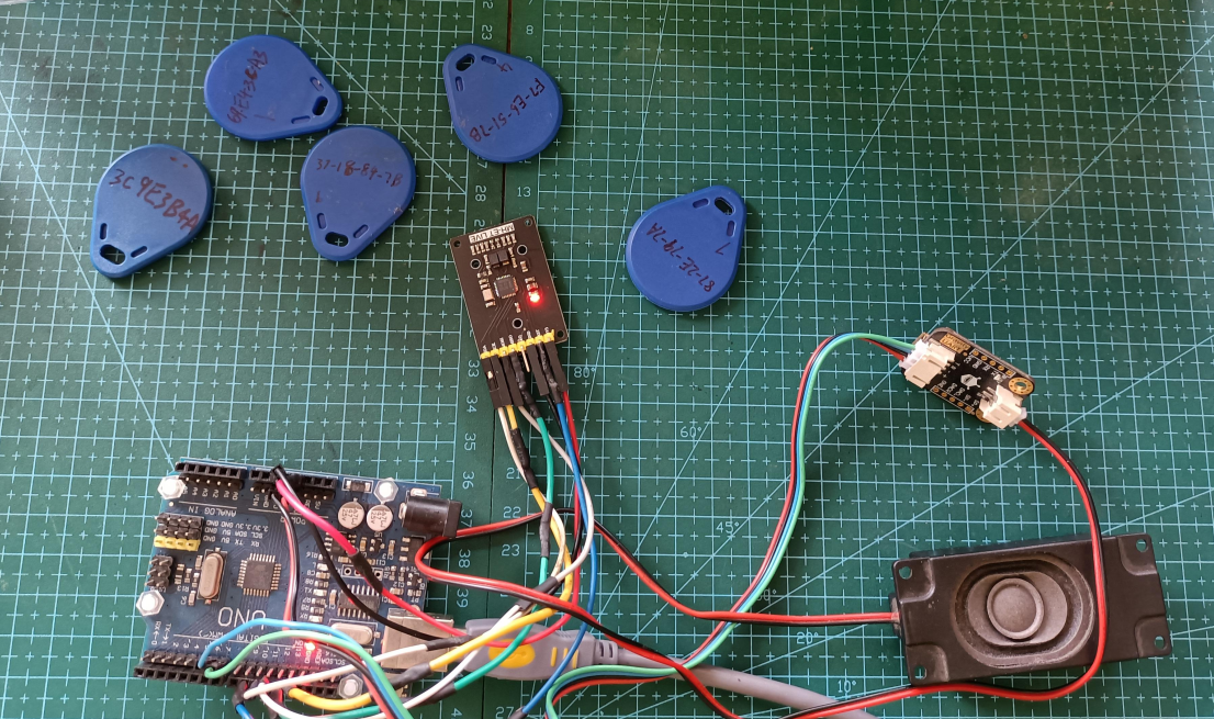

    Post some hardware photos to give people a visual understanding
    Speaker and seven blue RFID tags with handwritten codes on a green cutting mat
    Arduino setup with RFID, MP3 modules and labeled blue tags on a measurement mat

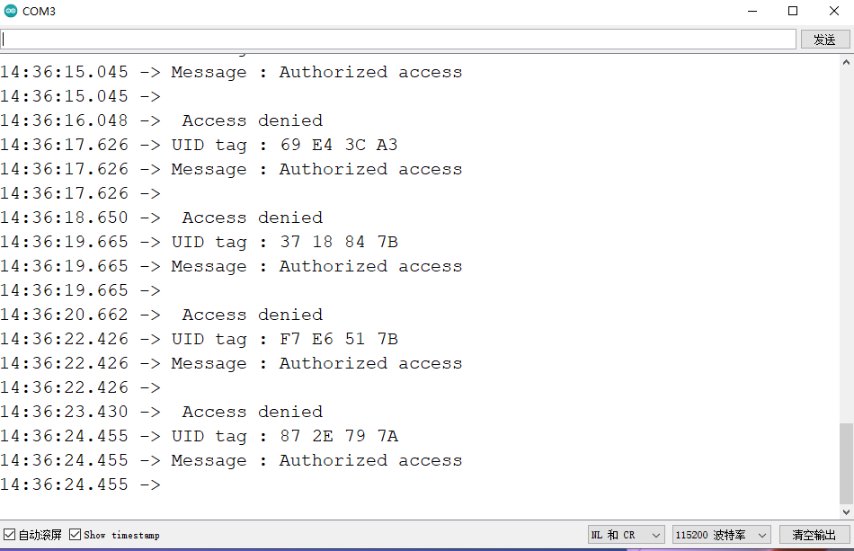

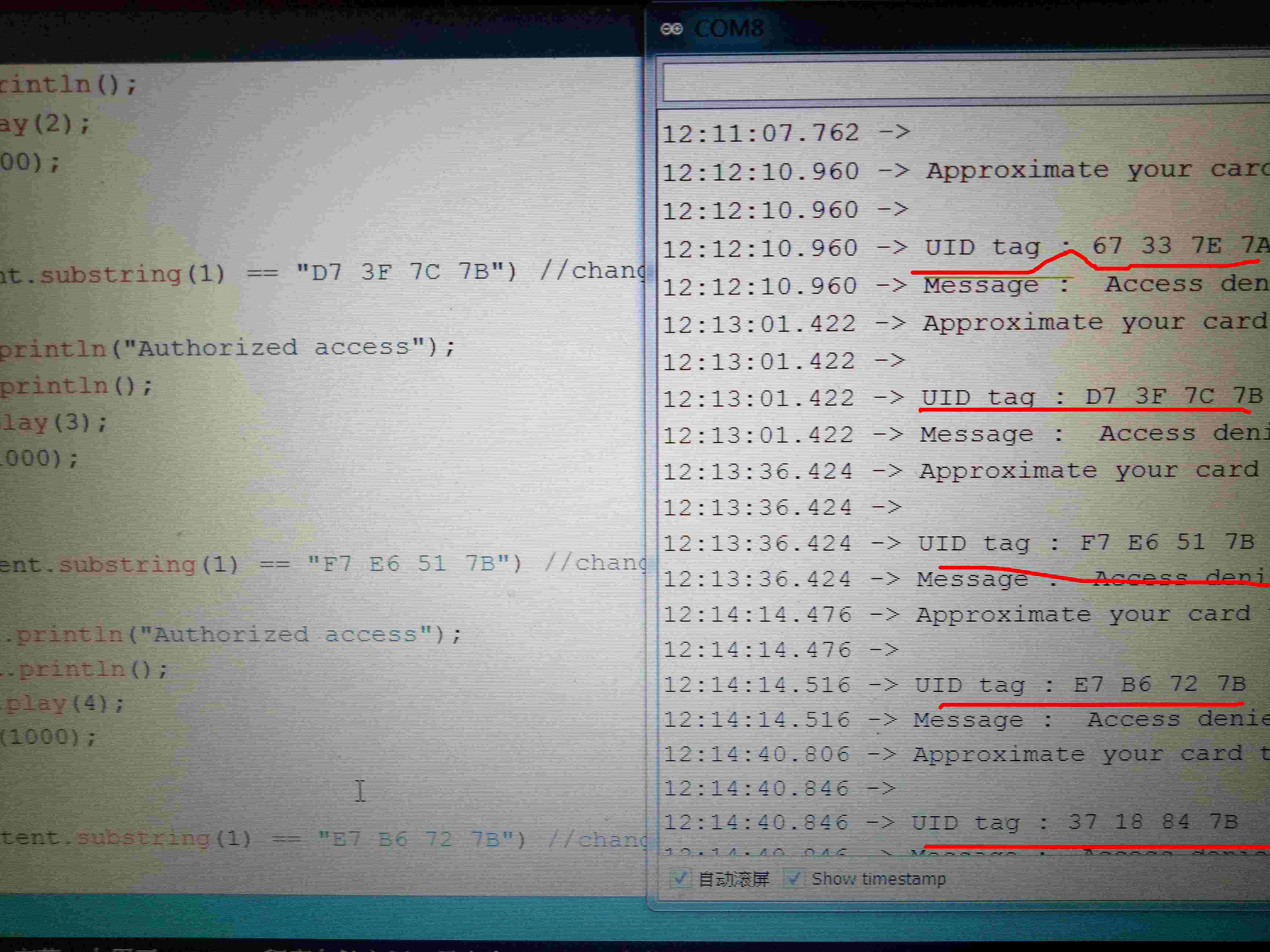

    Locate the encoding for each tag via the Arduino serial port. Specifically, open the Arduino example files, navigate to the RFID folder, open the cardread file, and upload it. Then scan the RFID tag with the RFID reader and check the encoding for each tag in the serial port.
    Screenshot of Arduino IDE showing RFID code and UID results in serial monitor
    Arduino serial monitor showing RFID tag UIDs and access messages
    View the tag encoding after scanning the tag in the serial port

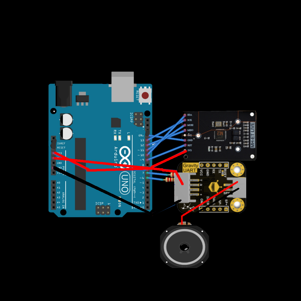

    Step 4: Wiring diagram
    Wiring diagram of Arduino Uno with RFID and MP3 modules and an 8-ohm speaker
