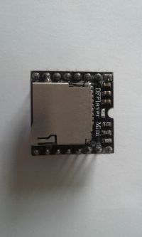

  • Hello all.
    I would like to introduce you to a cheap Chinese MP3 player - DFPlayer Mini.
    The cost of such a player is less than $ 1.5.
    DFPlayer mini has the ability to play music in MP3 or WAV format from the built-in micro SD card reader, you can also play music by connecting a USB flash drive to the player. The storage medium should not be larger than 32GB and should be FAT16 or FAT32 format.
    This player has the ability to control both by connecting goldpins and through the UART interface with a speed of 9600 bps.
    It has dimensions of 20.5 x 20.5 x 13 mm.
    DFPlayer Mini - a short description of a cheap MP3 player
    I became interested in the player after reading the article of one of the forum users, where he described a changer emulator he had created for cars of the VAG group.
    https://www.elektroda.pl/rtvforum/topic3380561.html
    The player was ordered directly from China, after 3 weeks it was in my hands.
