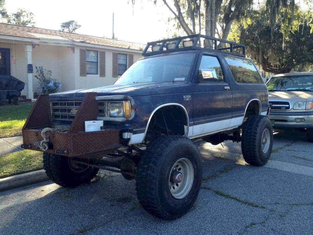

How can I build or source a 4-user truck intercom with headsets that supports VOX and lets occupants switch between radio, CB, phone, and intercom audio?
The best advice is to buy an off-the-shelf aircraft intercom and adapt it, rather than trying to design the whole system from scratch [#21665717][#21665718][#21665724] Aircraft intercoms already offer features like pilot isolation, voice activation, and multiple audio inputs, which closely match your radio/CB/phone/intercom requirements [#21665718] 12V units are readily available, so you should be able to find something suitable for a truck electrical system [#21665720] A 4-place setup with noise-cancelling headsets and VOX can be had in the roughly $600–700 range on the low end, with more expensive options available [#21665720] If you use a standard intercom instead of VOX, you would need push-to-talk switches for each person, so look specifically for a voice-activated unit or one with pilot isolation and input switching [#21665720]

The discussion centers on designing a 4-user truck intercom system integrating headsets with VOX (voice-operated exchange), radio, CB (citizens band) radio, and phone communication capabilities. The original poster seeks a schematic and component arrangement to enable all four occupants to communicate via intercom while selectively listening to radio or CB through headsets. Responses suggest that building such a system from scratch is complex for a beginner and recommend purchasing off-the-shelf intercom units, especially those used in aviation or motorcycle instruction, which offer multi-user communication, pilot isolation, voice activation, and multiple audio inputs. These commercial systems often support 12V or 24-28V operation and can be adapted for vehicle use. Infrared or Bluetooth wireless transmission is noted as safer alternatives to wired headsets to avoid hazards like cable entanglement. Safety concerns about drivers wearing headphones are raised, emphasizing the need for situational awareness. The original poster clarifies the system is for off-road use, where hands-free communication reduces distractions amid high engine noise. Suggested suppliers include Trade-a-plane, Aircraft Spruce, Univair, and Chief Aircraft Inc. The SoftComm ATC-6PS 6-place panel-mount intercom is highlighted as an example of a suitable aviation intercom system with advanced features that could be adapted for truck use.
