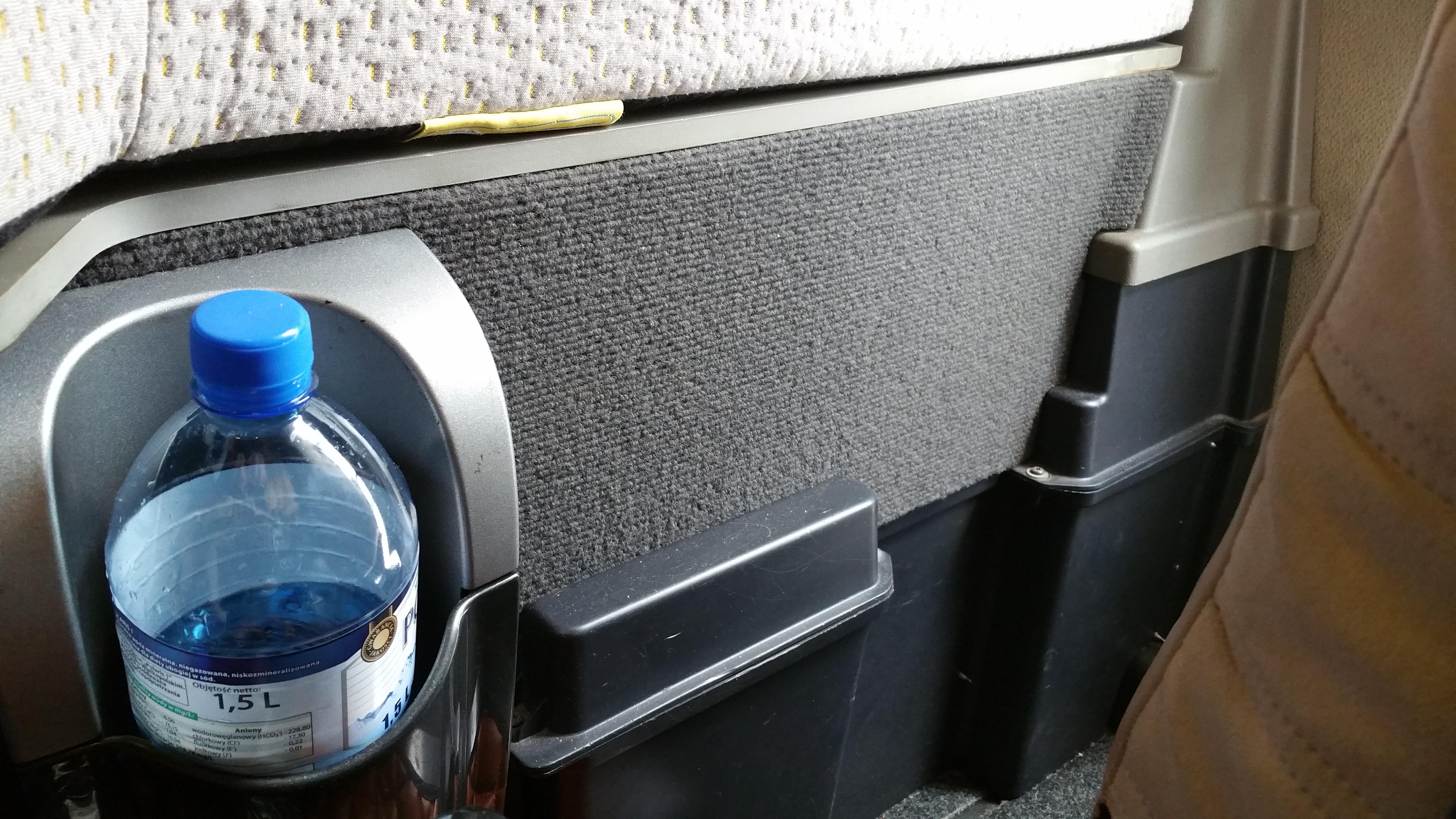

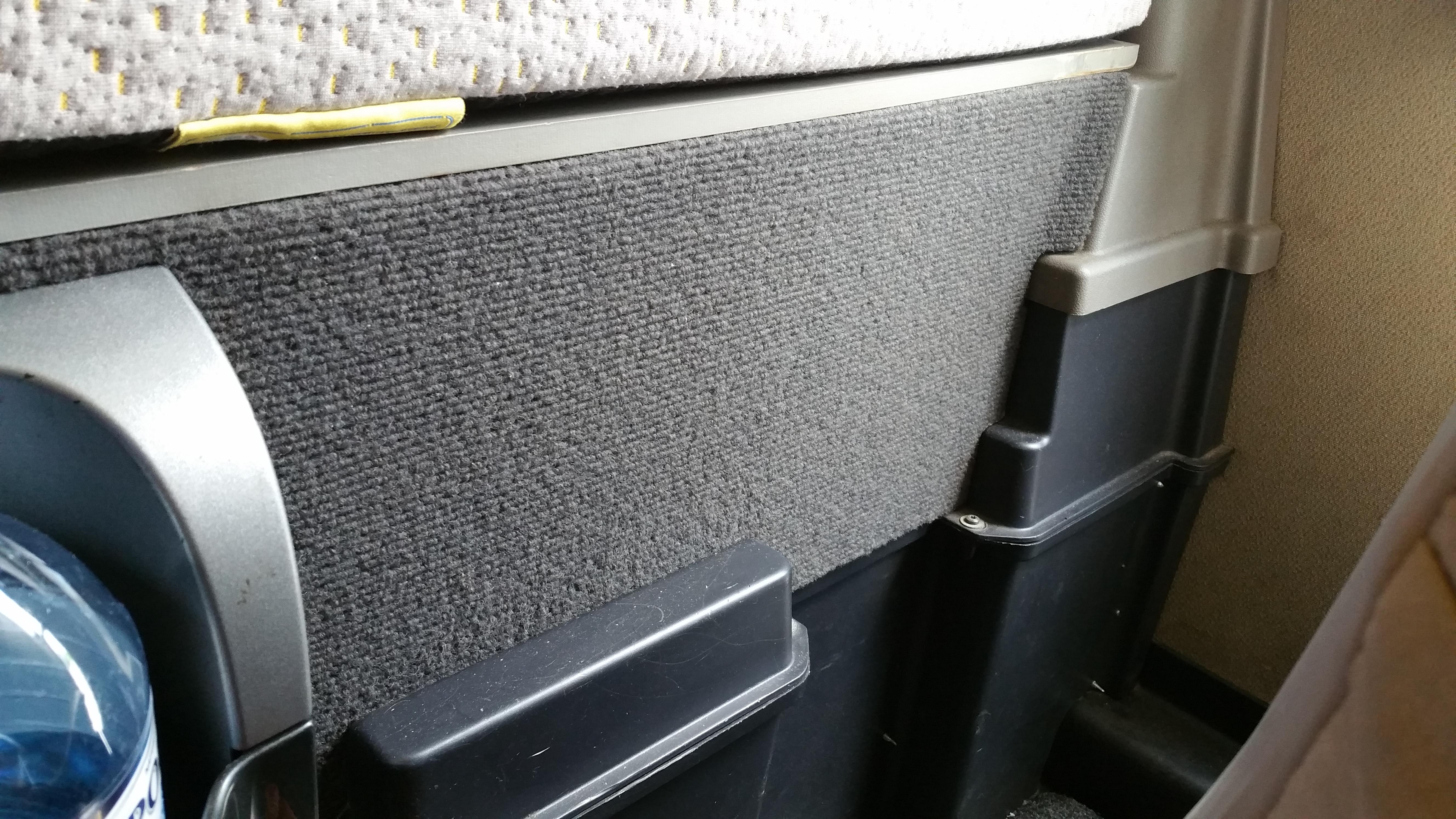

    It is the same on both sides. This is how max 200mm speakers fit. We will not cabin with the door because it won't work out because the boss has forbidden to cut anything in the door. And there is a stable disc behind the seat, with us one on the company there has speakers and they play great.

    Is this a storage room? How thick is the wall? What dimensions does it have?
    After reinforcing it with some disc from the inside, something interesting could arise from it.
    But at least I won't help here remotely. Someone with practice with such cars would be useful. Seeing in pics, and to feel in person is completely different ...

    Yes, there are storage spaces under the bed and the board is about 1.5 cm thick. I thought to give bass speakers and build it in the back with a disc at the front and there are two subwoofers next to the speaker. I just need help choosing equipment. Which loudspeakers and amplifier, because so far nobody has prompted.
