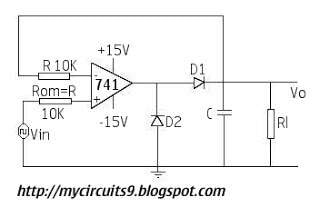

Peak detector circuit with 10k resistors, 1uF/10uF cap, IN914 diode, 15V op-amp not working
270 9
Why doesn’t my op-amp peak detector circuit produce an output with 10 kΩ resistors, a 1 µF/10 µF capacitor, a 1N914 diode, and a 15 V supply?
Your circuit needs a few fixes: move the anode of D2 from ground to the junction of the 741’s inverting input and the 10 kΩ resistor, and add an output capacitor of about 100 nF [#21665843][#21665842] Make sure the circuit is being driven with an AC signal rather than DC, because a peak detector only works on AC input [#21665836] Check the LM741 datasheet as well, since one reply notes its input range is about ±12 V minimum and its output swing is less than the rails even on a ±15 V supply [#21665838] If the input frequency is high, a 10 µF capacitor may be too large because the op-amp’s internal resistance and the capacitor form an RC time constant that can prevent proper operation [#21665837]

  • Peak detector needs grounded input and lower capacitance

  • Possible latch-up from input overvoltage

  • Requesting scope traces at op-amp inputs and output

A peak detector circuit using 10k resistors, 1µF or 10µF capacitors, an IN914 diode, and a 15V powered op-amp (LM741) was not producing the expected output. Key issues discussed include the importance of input signal frequency and amplitude, as the peak detector functions for AC signals and may fail at high frequencies (e.g., 1MHz) due to the op-amp's internal resistance and RC time constant with the output capacitor. The LM741 op-amp's input voltage range and output swing limitations were highlighted, with a reminder to consult the datasheet to avoid input voltages exceeding supply rails, which can cause latch-up in some ICs (though LM741 claims no latch-up). A suggested correction involves adding a 100nF capacitor at the op-amp output to stabilize the circuit. Another modification recommended moving the diode anode from ground to the junction of the op-amp's inverting input and the 10k resistor. The circuit was noted to behave like a half-wave rectifier, charging the output capacitor to the peak input voltage if conditions are met. Proper grounding and signal tracing with an oscilloscope or AC voltmeter were advised to diagnose the issue further.
