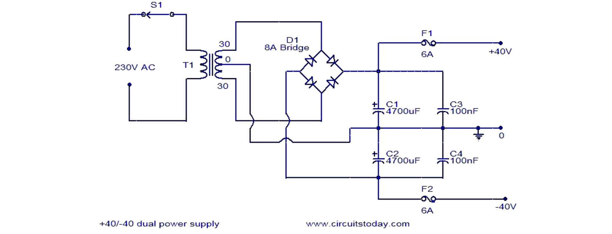

Powering Two TDA7294 Amplifiers Using a Single +65V Supply—Is It Possible?

  • Why a 95 VAC transformer yields ±65 V DC

  • Transformer voltage appears far too high

  • Transformer voltage likely drops to about 59V loaded

  • TDA7294 supply voltage and capacitor sizing limits

  • Transformer voltage and ripple calculations for TDA7294 supply

  • Choke-input filter or dual 40 V switching supplies recommended

The discussion addresses the feasibility and challenges of powering two TDA7294 power amplifiers using a single +65V dual power supply. The original setup involves a transformer with a 95V center-tapped secondary, resulting in approximately ±65V rails after rectification and smoothing. Attempts to create two separate ±30V supplies from this using resistor voltage dividers proved inefficient and unsuitable for high-power amplifiers. Key points include the importance of transformer voltage ratings, the peak voltage after rectification (approximately 1.414 times RMS voltage), and the ripple caused by load and capacitor size. The TDA7294 datasheet specifies a maximum supply voltage of ±50V (recommended ±40V), indicating that ±65V rails risk damaging the ICs. Sharing a single supply for two amplifiers is possible but may cause interference if loads differ significantly. Surge currents at power-on due to large filter capacitors and lack of series resistance or inductors can stress components and cause failures. Suggestions include using a transformer with appropriate voltage ratings, considering choke input filters to reduce surge and ripple, and avoiding inefficient resistor dividers for voltage splitting. The discussion also touches on the regulation stability of split supplies and the practical limitations of off-the-shelf SMPS units, which typically provide only positive voltages.
