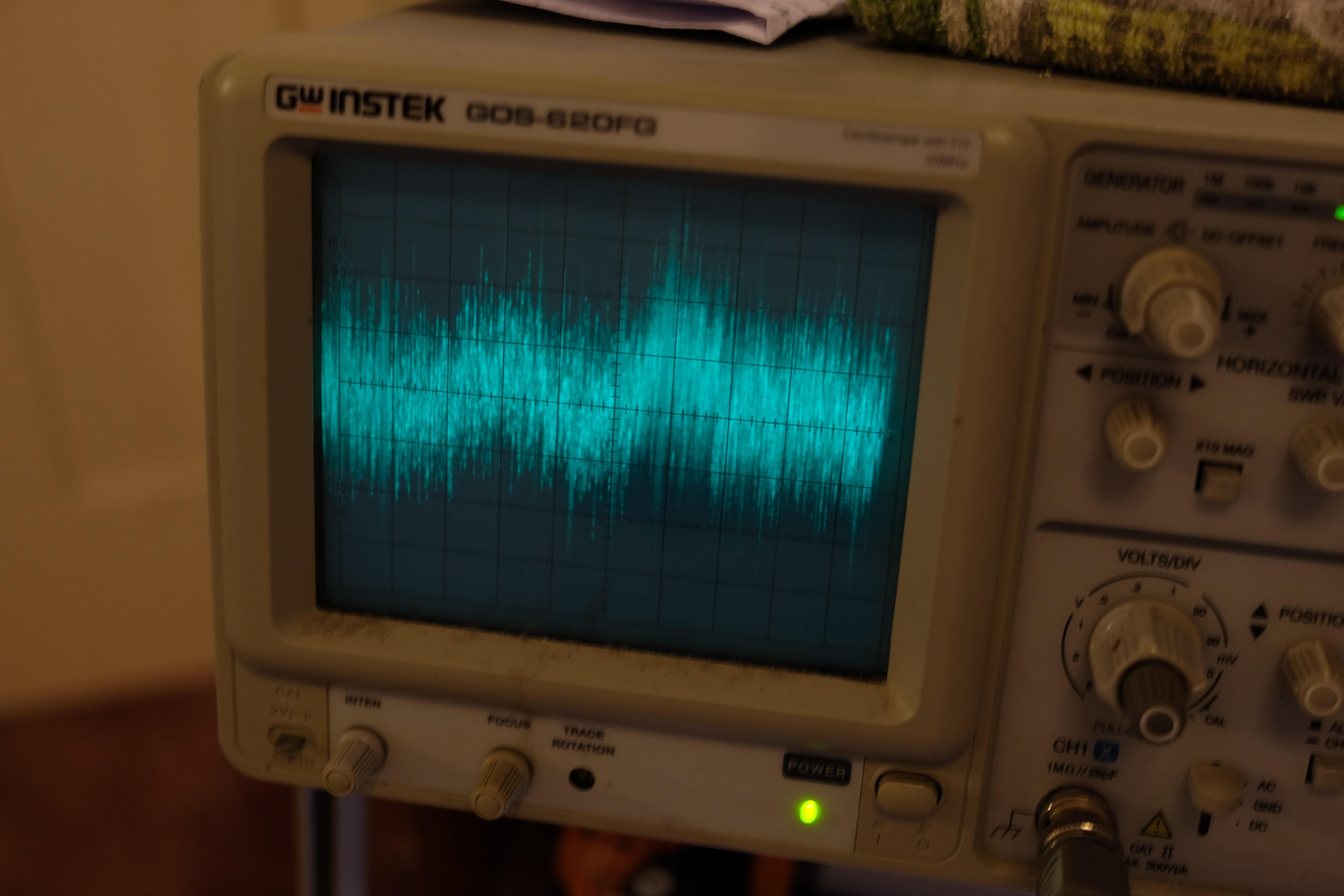

NE5532 Preamp Noise Level High With 47nF/10nF Feedback Caps, Gain 50, Scope Plot Attached

  • Layout likely causing NE5532 preamp noise on vero board
    #1 21679529
    huddslad huddslad
  • Diagnostic questions for NE5532 noise source
    #2 21679530
    David Ashton
  • Noise calculation shows wideband NE5532 output noise
    #3 21679531
    PeterTraneus Anderson
  • Suggesting mains pickup, oscillation, and inverting gain fix
    #4 21679532
    David Ashton
  • Power amplifier used to estimate op-amp noise
    #5 21679533
    huddslad huddslad
  • Suspected poor socket contact causing excess noise
    #6 21679534
    huddslad huddslad
  • High-impedance input may be picking up noise
    #7 21679535
    David Ashton
  • Correcting noise gain and feedback capacitor effects
    #8 21679536
A low-noise audio preamplifier was built using the NE5532 op amp with a gain of approximately 6. To reduce RF sensitivity, 47nF and 10nF capacitors were placed across the 10Ω feedback resistor, and 4.7nF capacitors were added across 100kΩ resistors. Despite these measures, the output exhibited significant white noise and hiss when connected to a power amplifier with gain 50, resulting in an estimated preamp noise output of about 1.6mV peak-to-peak. Noise measurements with the input shorted to ground confirmed the noise was not from the input signal. Analysis showed the noise level aligns with theoretical noise calculations for the NE5532, considering voltage and current noise densities and bandwidth. A faulty turned-pin IC socket causing poor contact was identified as a likely cause of excessive noise and bandwidth issues; replacing the socket improved performance significantly. Suggestions included verifying component values, minimizing unused veroboard tracks to reduce antenna effects, and reconsidering input impedance and resistor values to reduce thermal noise. The use of bandwidth-limiting capacitors across feedback resistors was noted to reduce noise by limiting bandwidth. Reference was made to Cirrus CS5368 evaluation board using a 634Ω input resistor to reduce resistor noise. Overall, careful layout, proper component selection, and reliable IC socket contacts are critical for low-noise NE5532 preamp design.
