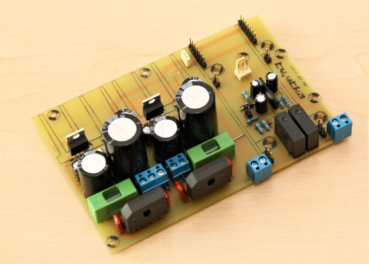

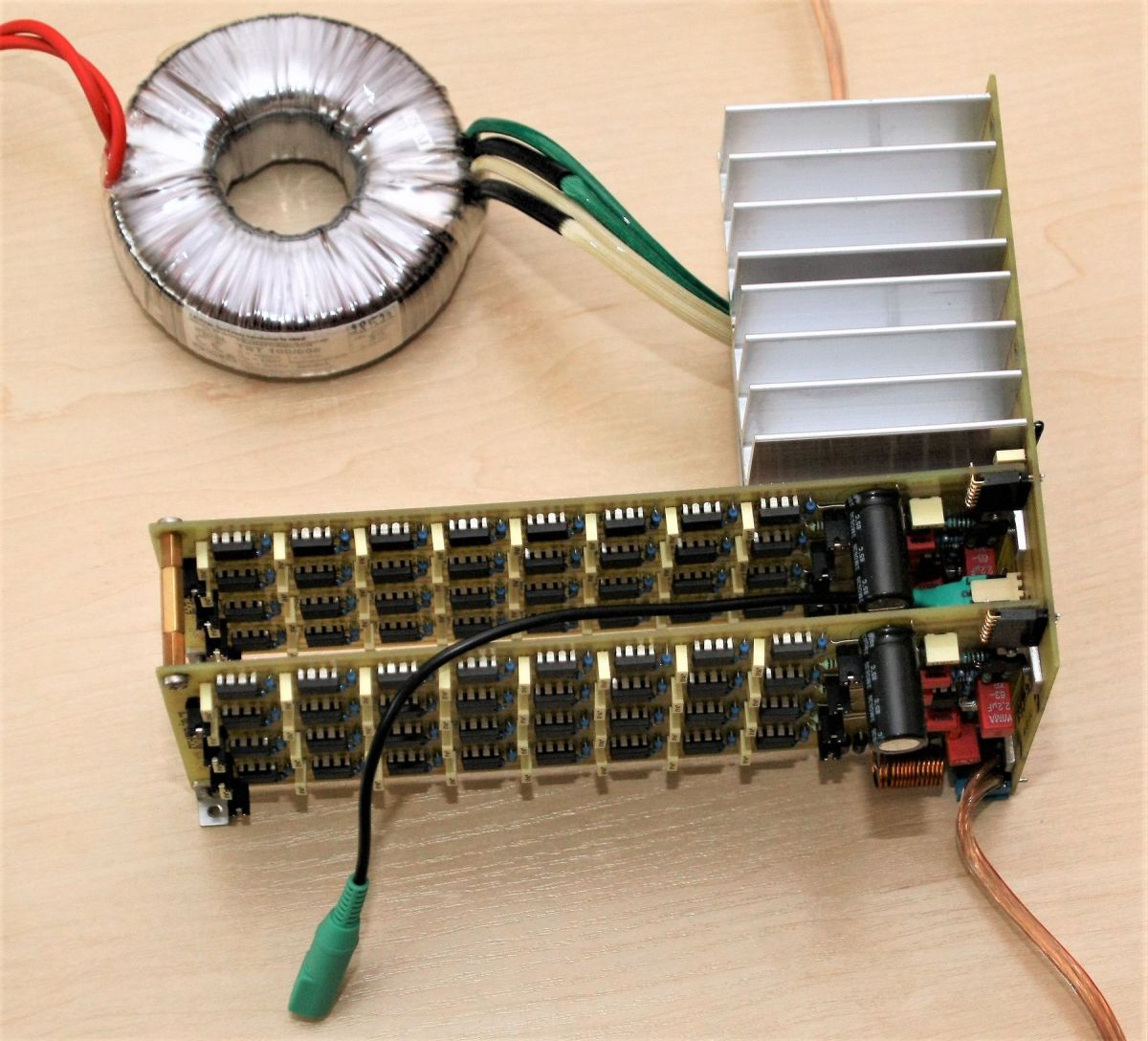

    It may seem ridiculous, but you can build an interesting power amplifier from ordinary operational amplifiers (with the right amount of them). :)
    From this "miracle" I achieve 2×14 W on a load of 8 ohms. Maybe this value is not shocking, but considering what we get it from, it's probably not a little bit.
    First things first.
    This project was created only as an experiment, made out of curiosity.

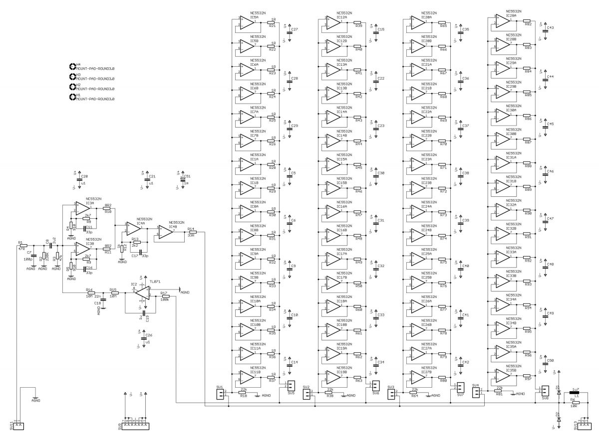

    The source of inspiration for this project was an article by Douglas Self in the Elektor magazine (issues 10 and 11 of 2010). Whereas the design of my headphone amplifier ( link ) served as a fitting for this very crazy project.
    However, my project is not an exact copy of the mentioned article. I simplified it a bit in my experiment. I resigned from balanced inputs and the possibility of connecting both channels into a bridge. I made the security system on uPC1237, and the stabilizers on LM338.

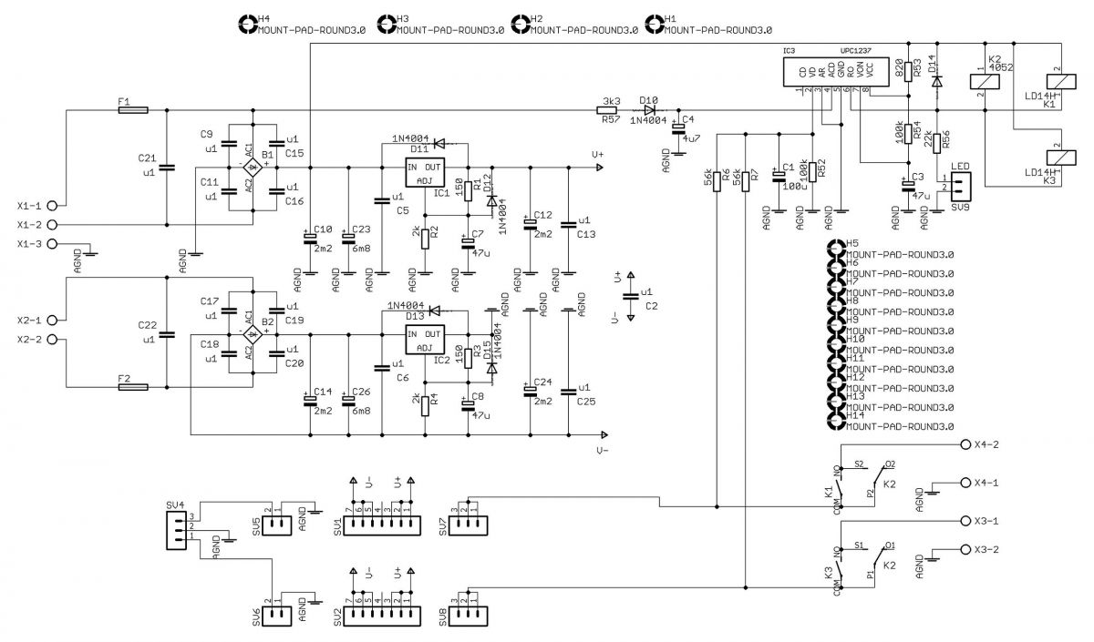

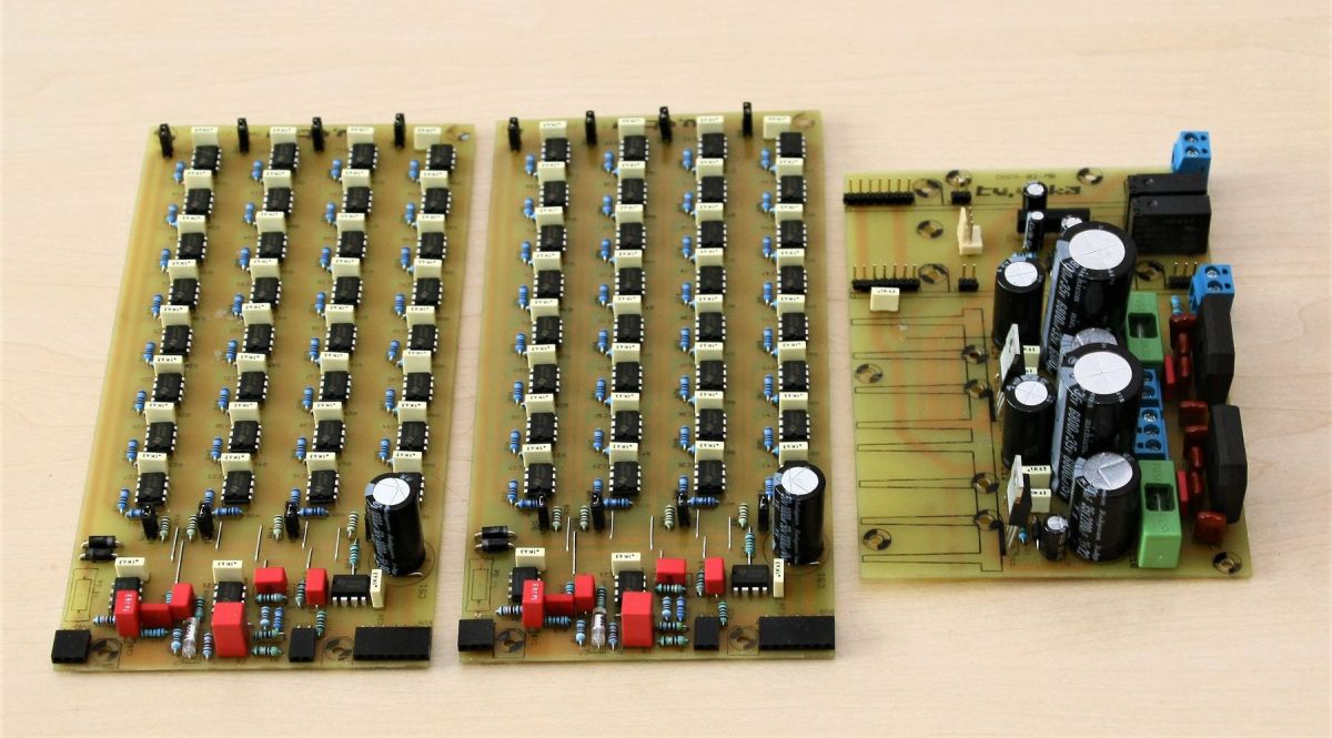

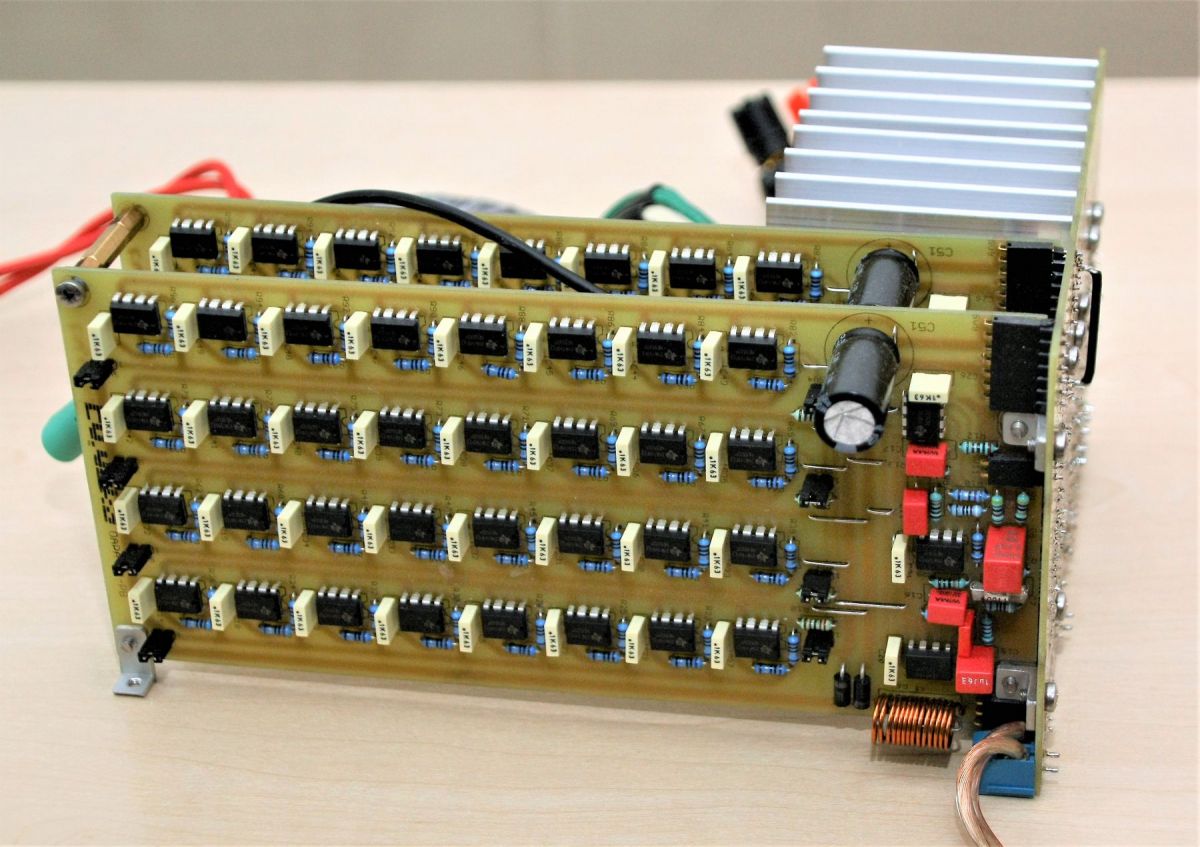

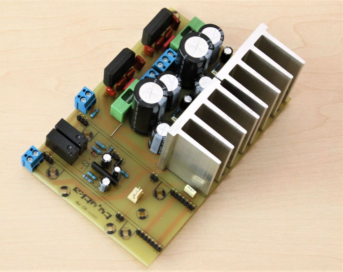

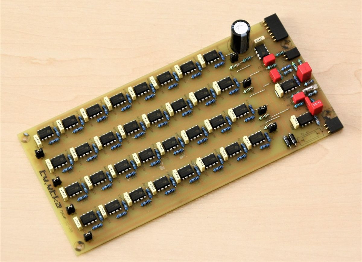

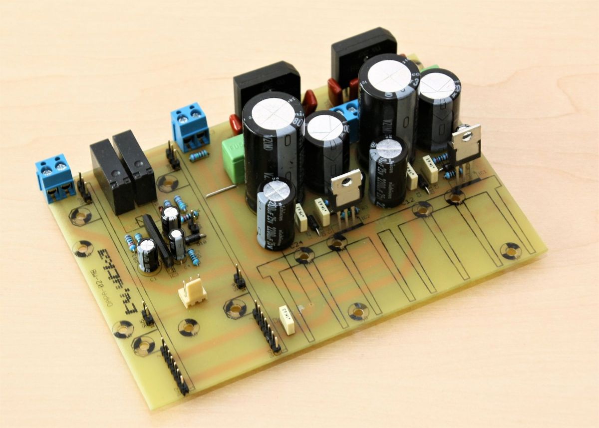

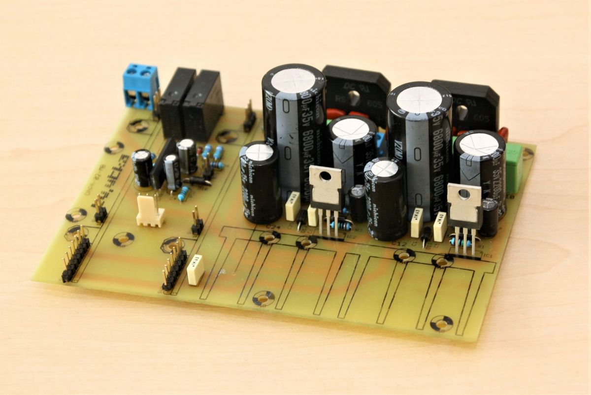

    I assembled the whole amplifier on three boards. One containing stabilized power supplies, supplying +/-18 V, and a loudspeaker protection system. The other two contain amplifiers for each channel. Each channel contains 4 operational amplifiers in the voltage amplifier part, 64 operational amplifiers connected in parallel working as an output buffer and one op-amp operating in the DC-servo system.
    Tile schemes:
    Power amplifier on NE5532 - ty.ytka Power amplifier on NE5532 - ty.ytka

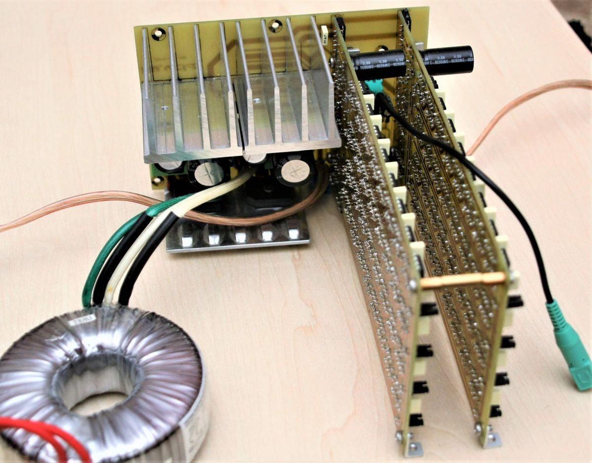

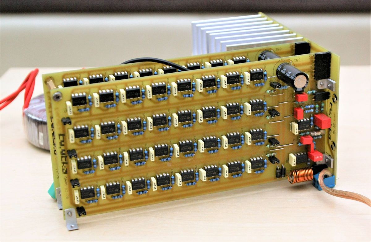

    A few photos of the assembled layout:
    Power amplifier on NE5532 - ty.ytka Power amplifier on NE5532 - ty.ytka Power amplifier on NE5532 - ty.ytka Power amplifier on NE5532 - ty.ytka Power amplifier on NE5532 - ty.ytka Power amplifier on NE5532 - ty.ytka Power amplifier on NE5532 - ty.ytka Power amplifier on NE5532 - ty.ytka Power amplifier on NE5532 - ty.ytka

    However, if someone wanted to use something like this for a specific purpose, remember to ensure proper cooling. Unfortunately, the stabilizers have to dissipate quite a lot of heat, and even the operational amplifiers themselves heat up to about 45-50 degrees Celsius during such operation.

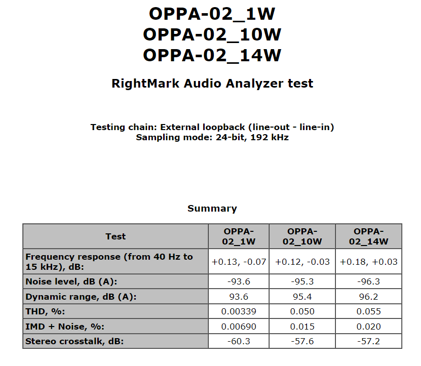

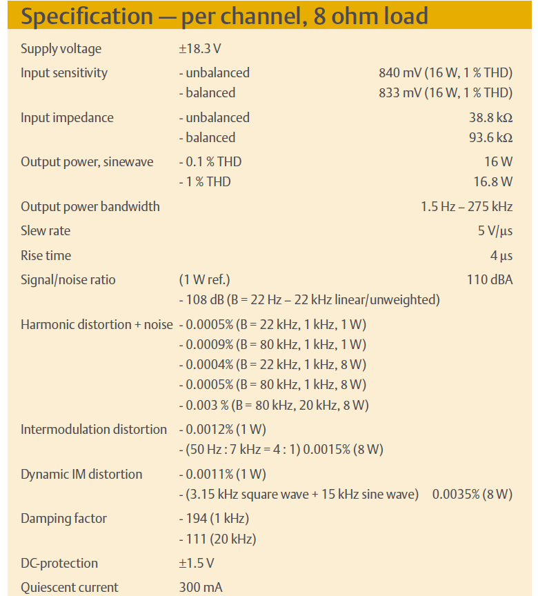

    Something about parameters.
    Output power with simultaneous control of both channels - 2×14W on 8 ohms .
    Other parameters are presented in the table below. Values for three different output powers 1W, 10W and 14W .
    The author of the article mentioned at the beginning achieved slightly different parameters in his experiment:
    The differences in the obtained parameters could have been influenced by the simplification of my system and the fact that I used the cheapest version of NE5532, because " P ".

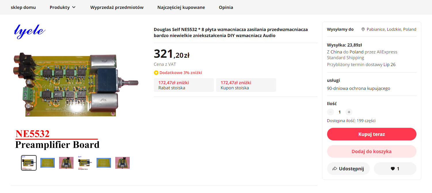

  • Chinese sellers offer NE5532 amp boards with sockets
    #3 20641066
    rb401
    Posts: 3003
    Help: 750
    Rate: 984
    The source of inspiration for this project was Douglas Self's article published in Elektor magazine (no. 10 and 11-2010). However, the design of my headphone amplifier (Link) served as a fitting for this crazy project.
    The concept seems older than 2010 to me.
    Your performance is very nice. I also like that you managed on a single-sided PCB.

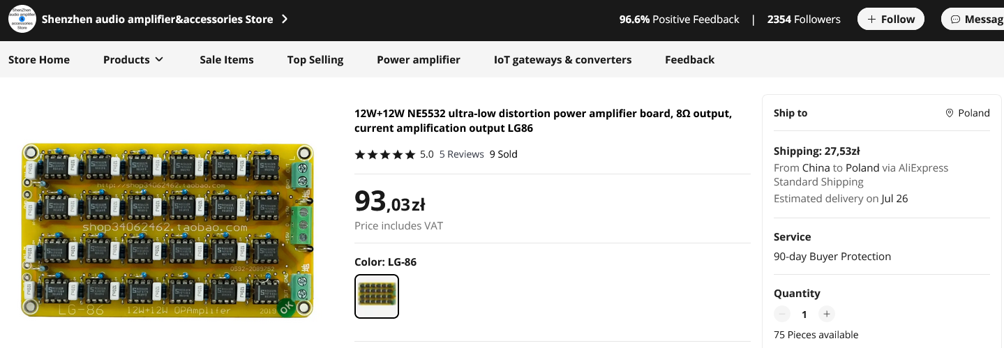

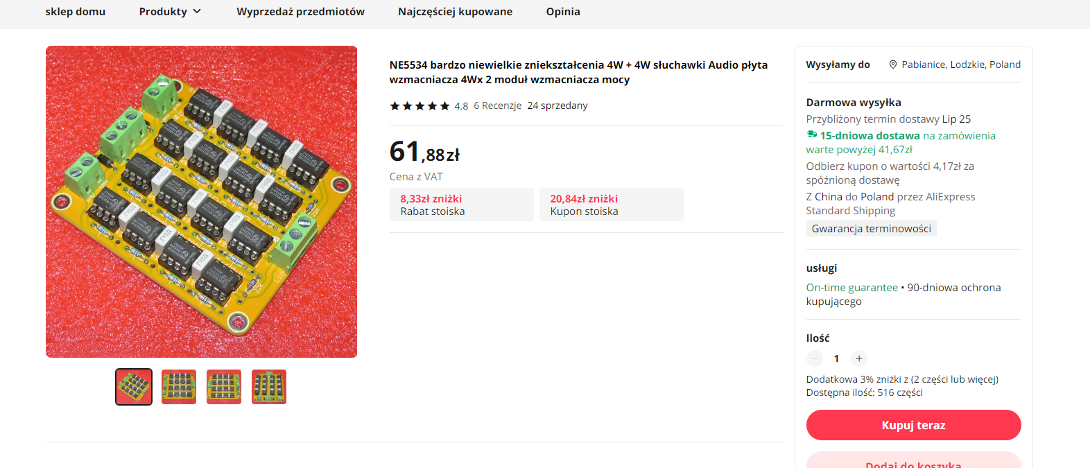

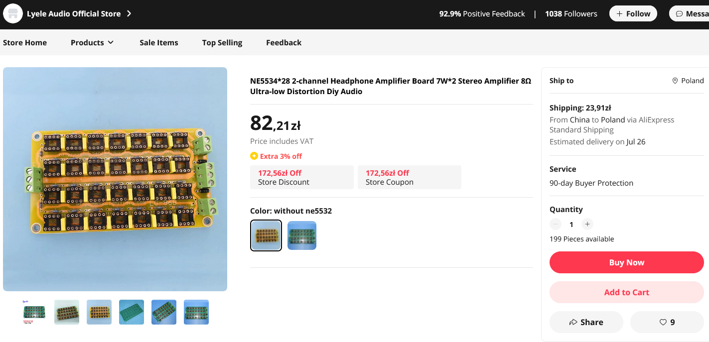

    Such a curiosity. Recently, on Aliexpress, I also came across several such reactivations of this old idea. Actually, the power amplifier boards themselves.
    Unfortunately, I couldn't get to the details, diagram, etc. it's hard to refer to these offers.
    The interesting thing about the Chinese is that they offer some versions without amplifier cubes. The plates are fitted with precision sockets. And in the descriptions for complete performances, they boast that the picks are second-hand, i.e. stimulants. You can also see that they are reluctant to put on cheap ones from their market: brand new, 100% original, genuine.
    First from the shore, examples:
    https://www.aliexpress.com/item/1005004652826097.html
    https://www.aliexpress.com/item/1005001273625129.html

    What did you measure with? Do you have a card reference measurement? Because you don't know where the measurement limits are. The second thing, do you have a differential measurement on the load or asymmetrically? The asymmetric measurement generates a ground loop from the card output through the amplifier, the ground cable to the load, and the card input ground. For me, changing the configuration improved the tip noise signal from 102dB of dynamics to 110dB.
    Similar parameters are achieved by simple power amplifiers based on transistors :) but they're not that impressive.

    I also found similar modules on Aliexpress.
    Only they break everything into mini-blocks. Those boards that colleague rb401 pointed out are the output buffers themselves.
    They even offer such little things:
    https://pl.aliexpress.com/item/1005003424837886.html?gatewayAdapt=glo2pol

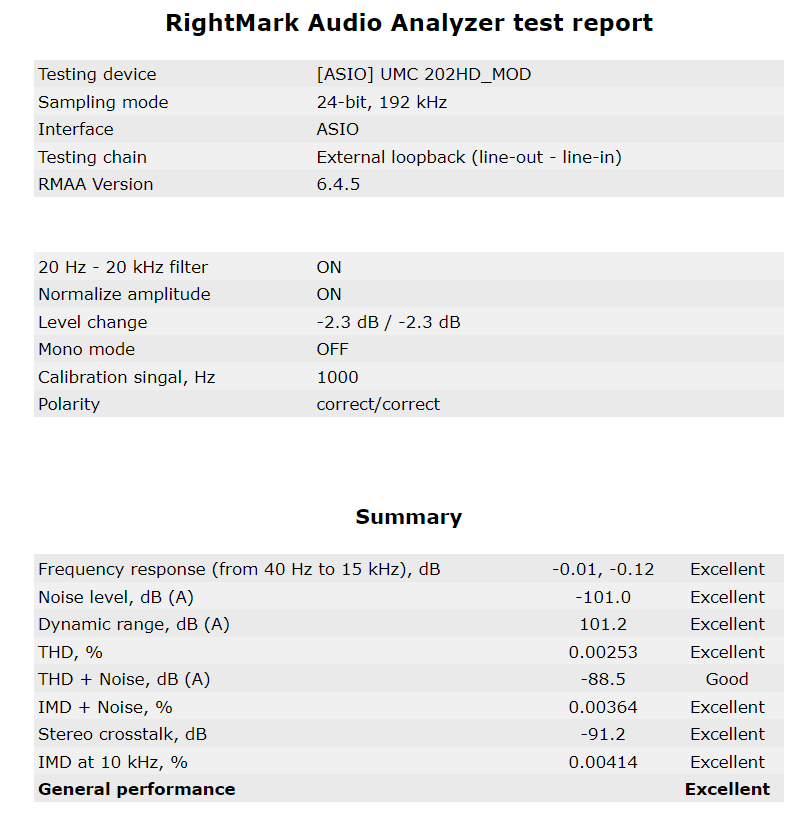

    The measurement results, I know, are not impressive and I have already made transistor amplifiers that achieved better results in tests. But as I mentioned, I did not chase test results here (cheapest NE5532, etc.). It was more about listening to it.
    The measurement was made asymmetrically. I will post the reference measurement of the card in the evening.

    Here is the promised reference measurement of the card used for the measurements:
    Can you reveal what you modified in UMC202HD to get such good parameters?

    @lechoo I limited the input path of this card to a minimum, because as it turns out, the factory Midas input amplifiers are a total flop and the reason for the imperfection of this card. I described my modification here: https://www.elektroda.pl/rtvforum/topic3655998.html
    Now, for security, I put some protection on the input. And this is after I recently burned the input AD8694.
