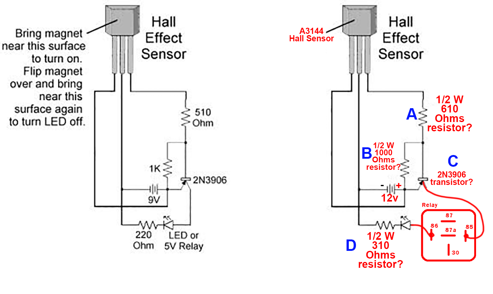

Are My Component Values (A, B, C, D) Correct for Hall Sensor Relay on 12V Automotive?

  • A3141 output current and relay drive limits

  • 1 k pull-up and 2N2907 relay drive choice

  • Separate relay and LED feeds with flyback diode
