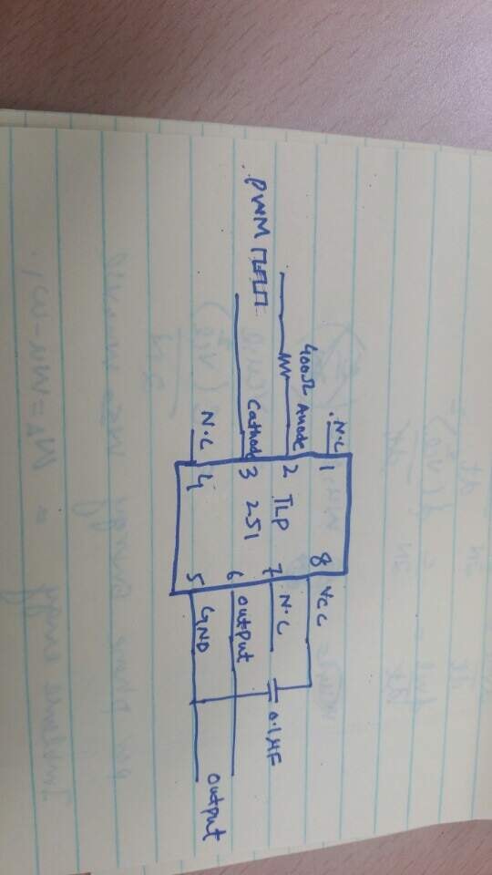

TLP251 Photocoupler Heating Up When Driving IGBT With PWM—What Could Be Wrong?

  • Diagnostic tests and driver current questions

  • Wrong gate polarity overheated the TLP251

A user experienced overheating of the TLP251 photocoupler when driving an IGBT with PWM signals. The supply voltage applied was 15 V, with Vcc isolated from the logic power supply. The PWM frequency was 2.3 kHz with rise and fall times of 8.3 ns. The IGBT used was a G60N90 DG3113. The overheating issue was traced to incorrect gate-emitter polarity: applying negative to the gate and positive to the emitter caused the TLP251 to heat up, whereas reversing the polarity (positive to gate, negative to emitter) resolved the heating problem. Additional troubleshooting steps included isolating Vcc and load power to confirm the source of heating and considering the use of a low-value gate resistor to prevent oscillations. An alternative driver, the FOD3184, was suggested for higher current drive capability.
