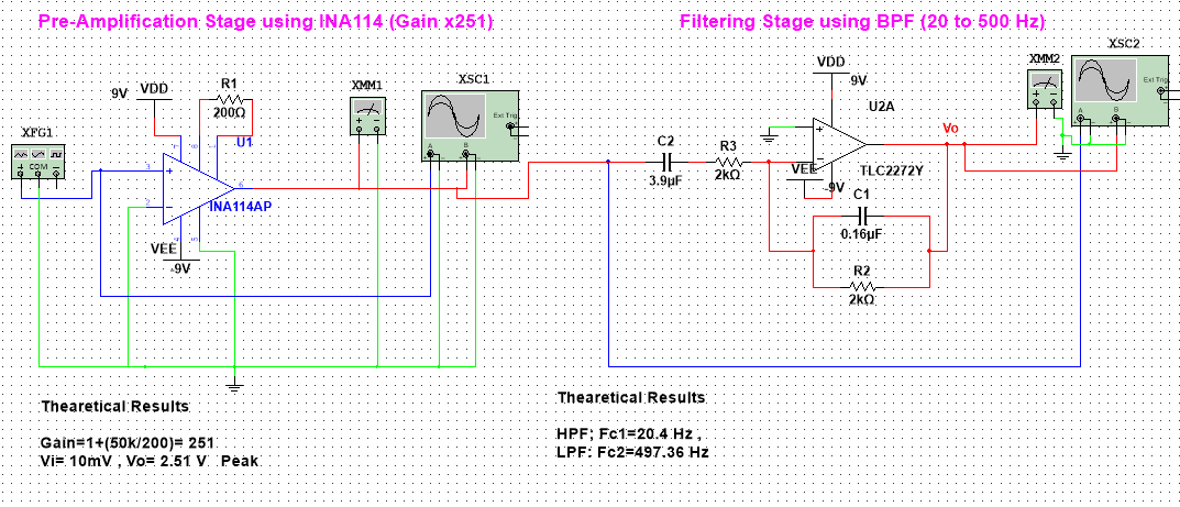

Recommended Gain and Filter Type for EMG Data Acquisition: Sallen-Key or Butterworth?
234 8
  • Choosing gain and band-pass filter order for EMG acquisition
    #1 21680639
    Mo Tuk
  • Gain staging and filter topology clarified
    #2 21680640
    Richard Gabric
  • Input LC filter suggested to reject pickup interference
    #3 21680641
    PeterTraneus Anderson
  • 32-bit audio ADC fullscale far above thermal noise
    #4 21680642
  • Questioning instrumentation amp benefit for single-ended EMG
    #5 21680643
    Aubrey Kagan
  • #6 21680644
    Richard Gabric
  • Series capacitor to block DC offsets in EMG front end
    #7 21680645
  • EMG signal processing references and electrode guarding
    #8 21680646
    Richard Gabric
  • Diagnostic tests for EMG lead noise and interference
    #9 21680647
