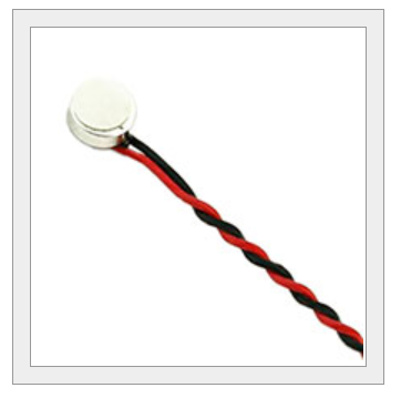

Designing a Microphone Circuit for 30-100dB Range Using EM4015LW-38C10NF & LM386
207 2
  • Need logarithmic calibration for 30–100 dB range
    #1 21680994
    Otb123 J
  • Use an RMS-to-dB converter IC for calibration
    #2 21680995
    David Ashton
  • LM386 is unsuitable for microphone amplification
    #3 21680996
    David Ashton
