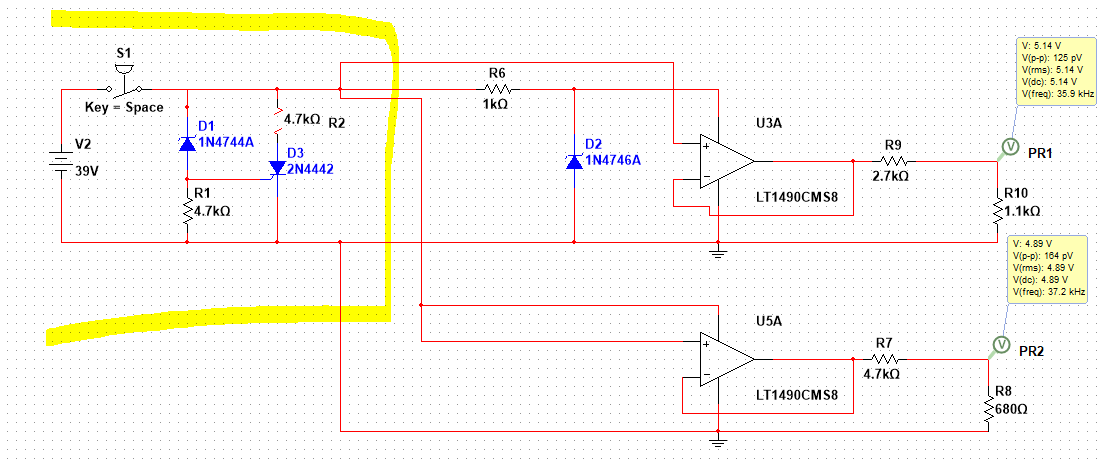

Crowbar Circuit Component Selection for 25-40V Sensor Overvoltage Protection
306 6
  • Crowbar circuit burns at 39–40 volts

    Jose Ignacio Mora Cordero
  • Clamp op-amp inputs with series resistor and diodes
    #2 21685422
    Richard Gabric
  • Analog crowbar alternatives with 40 V-rated parts
    #3 21685423
    Aubrey Kagan
  • Crowbar clamp is unsuitable for 40 V sensing
    #4 21685424

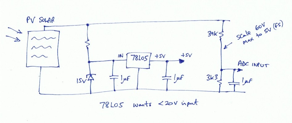

    Leslie Green
  • Need for a proper 5 V supply from panel voltage
    #5 21685425
  • #6 21685426
    Leslie Green
The discussion addresses the design challenges of implementing an overvoltage protection circuit for a sensor measuring 25-40 V inputs, powered by the same voltage range. The original approach using a crowbar circuit with a 15 V Zener diode was problematic due to the crowbar's nature of shorting the supply line and the Zener's tolerance, making precise 40 V clamping unfeasible. Crowbar circuits typically require high current and a fuse for protection, which is unsuitable for low-level signal inputs. Alternative recommendations include using clamping circuits with shunt diodes or Zener diodes combined with series resistors to limit current, or transient voltage suppressors (TVS) for overvoltage protection. It was suggested to scale the input voltage so that the ADC input range corresponds to a slightly higher voltage than 40 V (e.g., 45 V) to avoid damage. The use of a 78L05 voltage regulator preceded by a Zener diode as a crude pre-regulator was also mentioned for powering the microcontroller and peripherals from the photovoltaic panel voltage. Additional resources and parametric search tools from Analog Devices and Texas Instruments were recommended for selecting appropriate protection components. The overall consensus is that crowbar circuits are generally unsuitable for precise sensor input protection at these voltage levels, and more refined clamping or voltage limiting methods should be employed.
