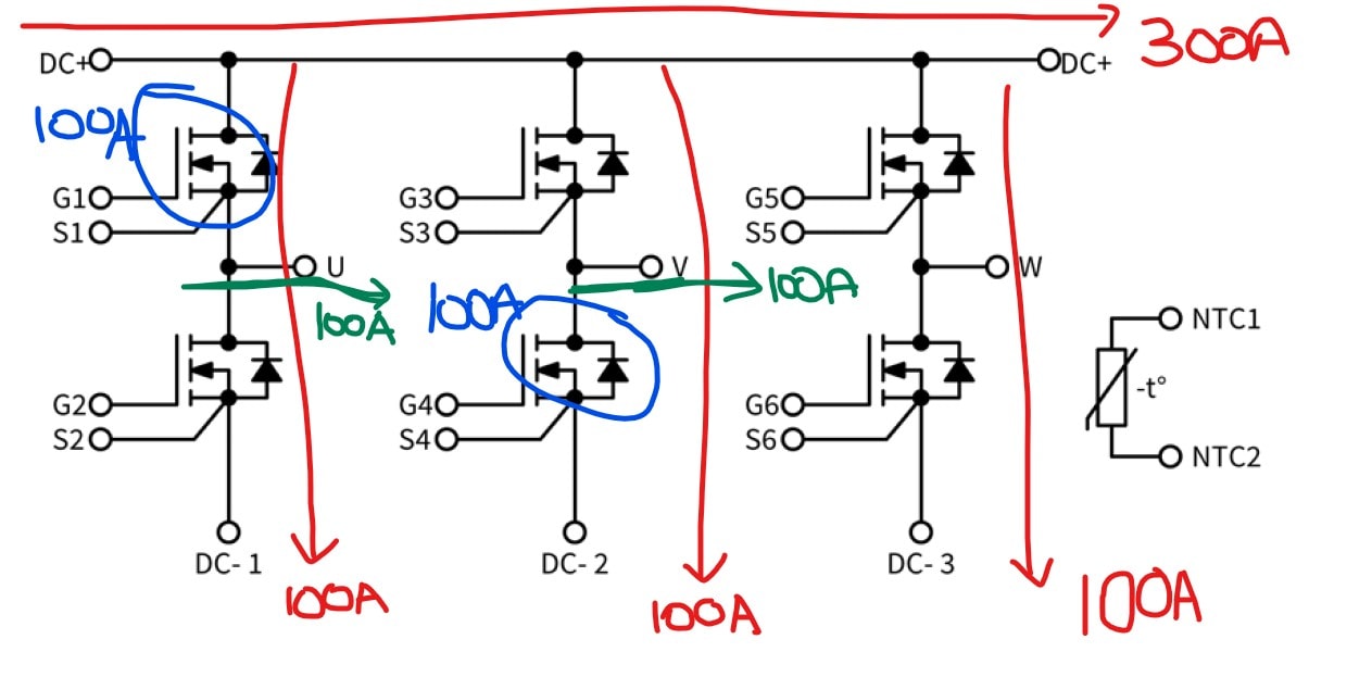

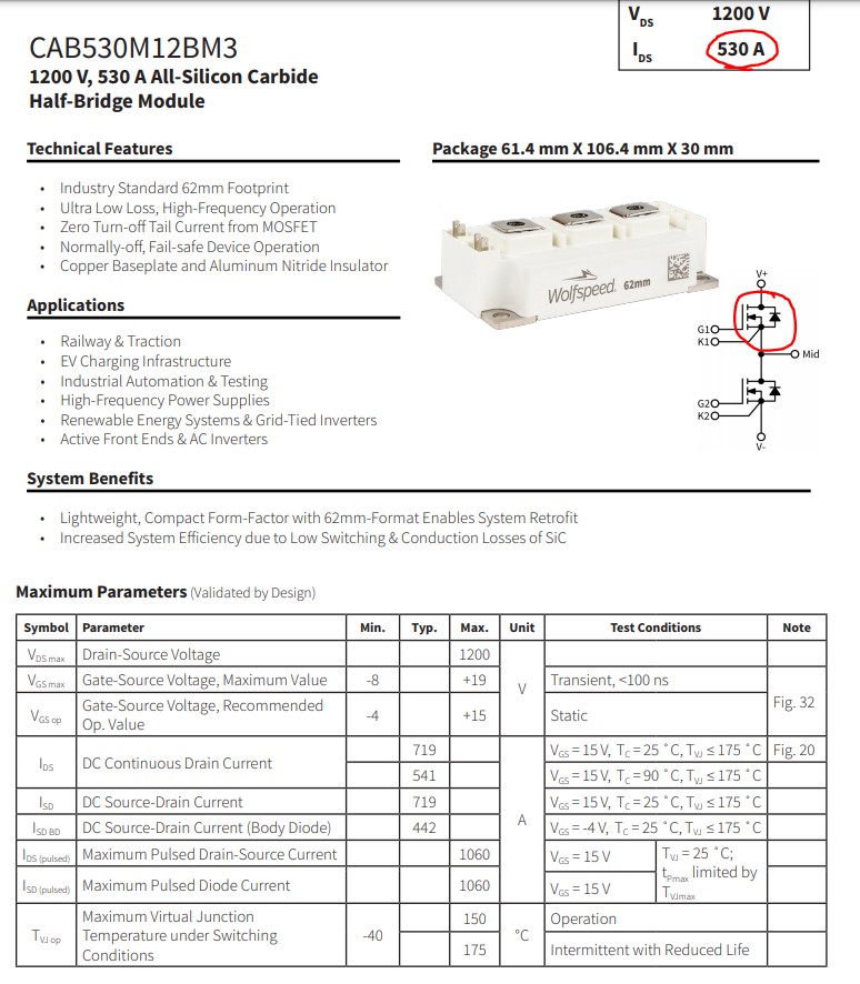

How should I interpret a 530 A current rating in a dual-MOSFET module: is it 530 A per MOSFET or 530 A for the whole module?
The 530 A rating applies to each MOSFET individually, not as 265 A per device or 530 A shared between them, and in series devices the same current flows through both [#21685472] [#21685471] The module is a half-bridge, so only one of the two MOSFETs is supposed to be on at any time; turning both on would short the supply [#21685472] You also need to derate the current from the module’s thermal/current graph and design the heatsinking carefully [#21685472] In a 3-phase bridge, current flows through one high-side and one low-side device in the conducting path, and the actual current depends on the bus voltage and the load, not on a fixed split across the module [#21685478]

  • Half-bridge MOSFETs rated individually with derating needed

  • Each MOSFET carries phase current, not total DC current

  • 3-phase bridge current depends on load and bus voltage
