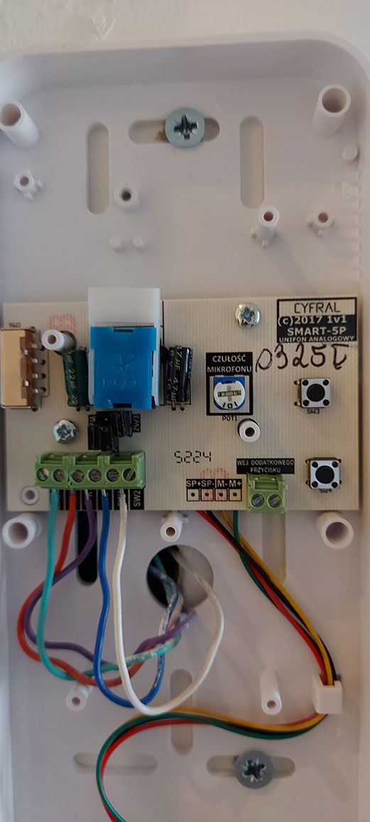

    I replaced my old Fermax intercom with the new Cyfral Smart-5P. Everything works except the microphone. The person can't hear me.
    Do you have any idea what I'm doing wrong?
    Thanks for your advice.
    CYFRAL SMART-5P intercom circuit board with wires and buttons

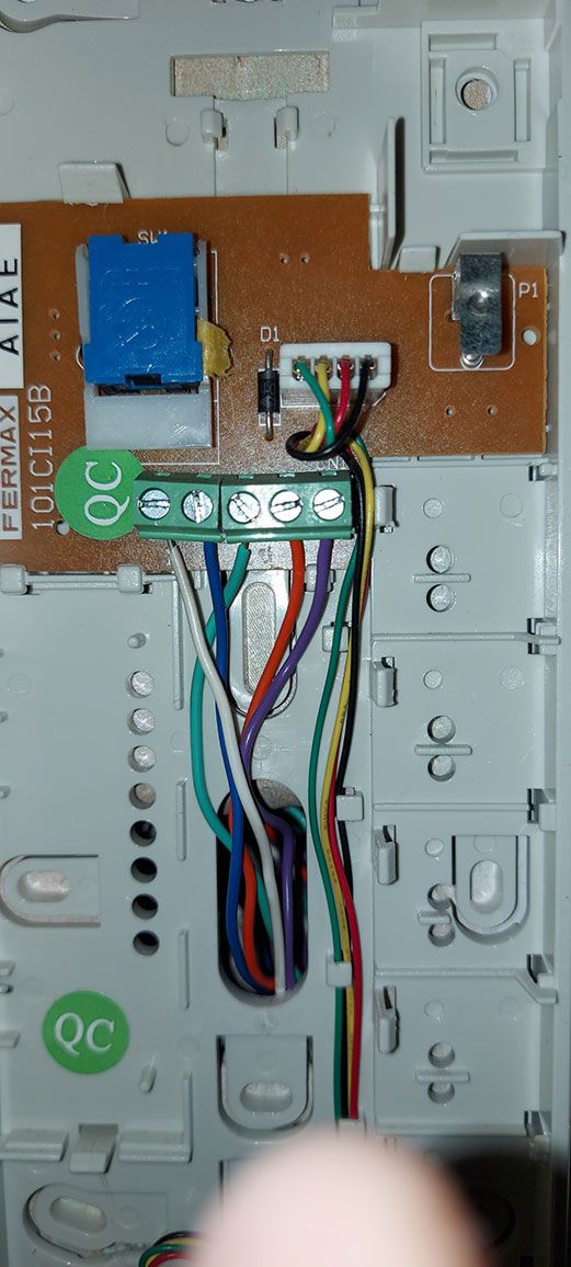

    Give a photo of this old Fermax̌ uniphone including visible connections.
  • #3 21694159
    rexxodus
    Posts: 6
    Here is the requested image. Thank you for taking the time to respond.
    FERMAX circuit board with multicolored wires and connector components

    Try connecting as follows:
    Ring - 4 (red)
    SPK - 6 (violet)
    MIC - 2 (blue)
    Ground - 3 (I think it's green)
    SW1 - 1 (white)
    ZW1 and ZW2 jumpers pulled down and ZW3 put on.

    Hello barman,
    This is exactly the wiring I did. :) (first picture)

    Swap red <-> purple in place

    I swapped the cables, it doesn't work, I wonder if the old installation was correct.

    If you still have an old uniphone, plug it in and check.

    You can also check with your neighbour whether he has the same colour wires connected.

    Maybe you just happened to come across a faulty unit? Sometimes this happens with new products.

    An electrician came by and the device was indeed defective! Thanks for your help, and sorry to have wasted your time.
