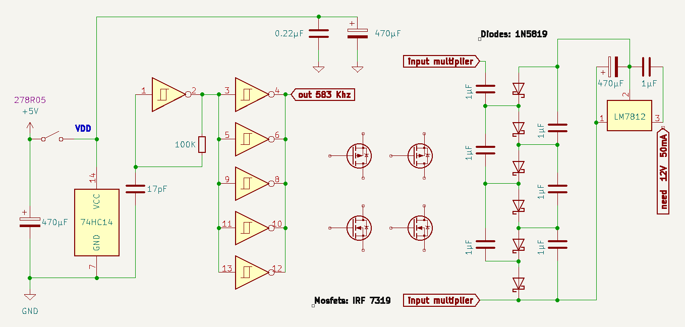

     A real working driver is needed for signal from 74AC14 to voltage multiplier via driver.
    Supply 5 Volts from 278R05. on one element 74AC14 create generator 583 kHz.
    Next 5 triggers connect in parallel for more current value.
    output signal need connect to driver (2 or 4 MOSFETs) on IRF7319 (P-channel and N-channel in one package).
    driver connect to voltage multiplier x6 VCC. Next connect to stabilizer L7812, and need output about 50mA current.
    need driver circuit with IRF7319.
    Not ending driver sample I attach:
    IRF7319 MOSFET Driver Circuit for 74AC14 Signal to 5V Voltage Multiplier at 583kHz

    Hi,
    The P-channel transistor of the IRF7319 or AO3415 should be at the top. The source of the P-channel transistor should be connected to VDD.
    The N-channel transistor of the IRF7319 or AO3416 should be at the bottom. The source of the N-channel transistor should be connected to GND.

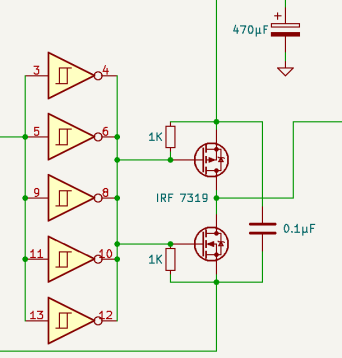

    kirvoboy
    if this method - that MOSFETs damages:
    Circuit diagram with IRF7319 dual MOSFET and four logic gates via 1kΩ resistors

    jonas123
    >>21702423 I’d also check the gate drive conditions before assuming the IRF7319 itself is the issue. At ~583 kHz, switching losses, gate charge, and overlap current can become significant, especially if both devices are not turning fully on/off or there’s insufficient dead time. A small gate resistor and checking Vgs with an oscilloscope may show what’s happening. Similar high-frequency switching discussions come up regardless of whether parts come from sources like Fonhuaicho or elsewhere, but the layout and drive timing usually end up being the deciding factors.
