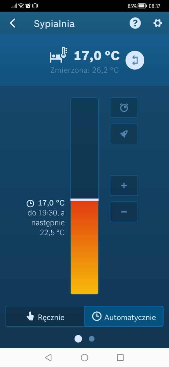

    Hi, I have this problem.
    I have bought a Bosch thermostat II head for the radiator in my flat. For this I bought a Bosch Smart Home Driver II controller and installed the Bosch Smart Home app.
    I have connected everything, theoretically it works.
    The problem is that the head heats too much. I set myself a schedule. It's supposed to heat at 22.5 degrees at night and drop to 17 degrees during the day. However, the head maintains a temperature of around 26/26.2 degrees.
    Any suggestions as to what could be wrong?
    I have reset the head, done the calibration again and still the same. Bosch Smart Home screen shows measured temp 26.2°C and setpoint 17.0°C in bedroom

    If you close the head completely so that the heating is off, is the radiator warm or does it cool down? If the radiator is warm even though the head is closed, it means that there is a gap between the head bolt and the valve and some distance needs to be used.

    When I reduce the temperature to 5 degrees (that's the minimum), it still holds that 26 degrees.
    But in the app I have an option to pause heating, when I turn this on then the head closes completely and the radiator is cold. So it's unlikely to be the fault of play between the pin and the valve.

    At 5 degrees the radiator should be closed, apparently the calibration was not done correctly. Maybe the radiator head pin pushes in with a lot of resistance and the Bosch head detects the resistance during calibration and the radiator valve is not completely closed. You can measure the stroke of the head after calibration (close - open) and compare with the stroke of the needle of the radiator valve.

    It seems to me that if it detected too much resistance, it would throw an EO3 error (at least that's what it says in the instructions).
    As for the head pitch after calibration - I hadn't thought of that, I'll measure it and see what it looks like. Thanks for the hint

    During calibration, the head works from resistance to resistance and so learns the working range. There can be an error if the firing pin stroke is too small.

    I calibrated the head once again and so far it is working as it should.
