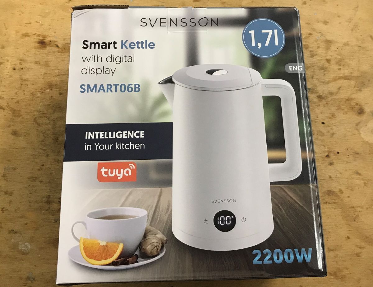

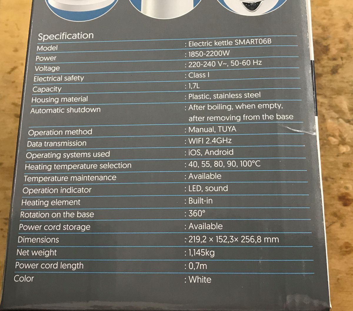

    Ever wondered what a remote control for an electric kettle could offer us? The SMART06B has just such a control - all thanks to its built-in Wi-Fi module and compatibility with the Tuya mobile app. Here, I'll try to check it out and showcase it, including the centre of the device. Does such a product make sense? Let's find out!
    We bought the SMART06B for PLN150, although we may have overpaid because we ordered from a local importer. An ordinary electric kettle can be bought for a few dozen zlotys, so here we are paying about a hundred extra for.... Exactly, for what?
    Why WiFi connectivity in an electric kettle? Svensson Tuya SMART06B test .
    The first thing that catches the eye is the temperature selection. That's already something. Let's check out the contents of the kit.

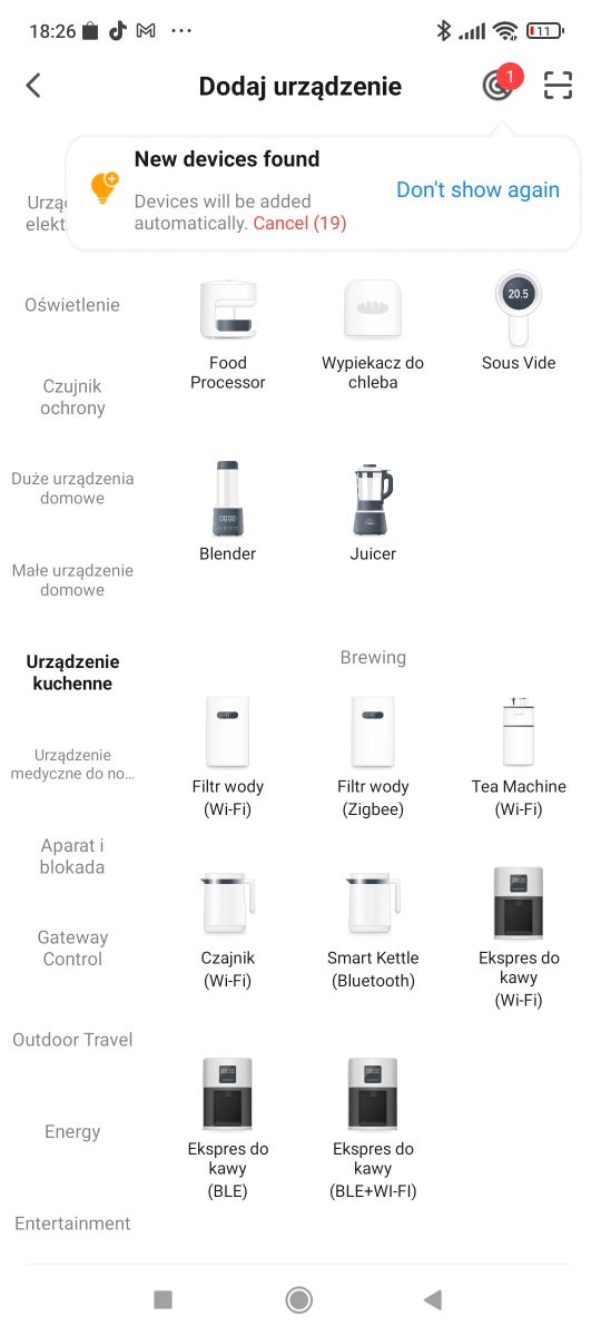

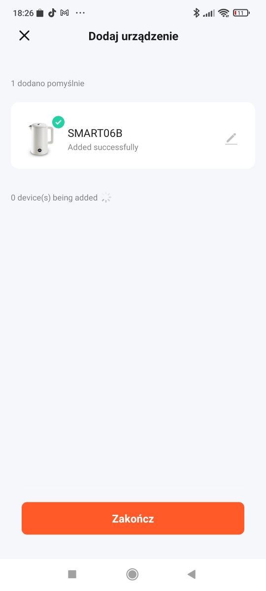

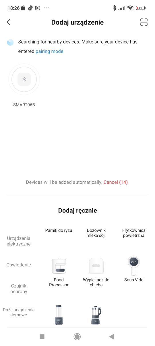

    Pairing with the app is seamless, but you need to turn on Bluetooth and location access beforehand. In the pairing state, both LEDs flash rapidly.

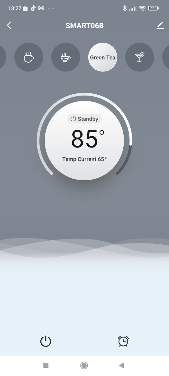

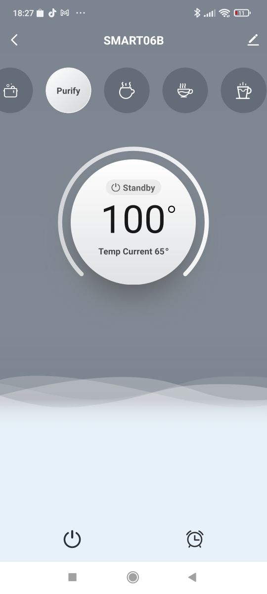

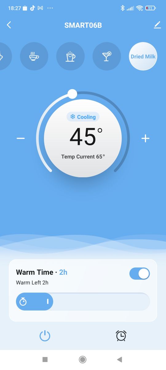

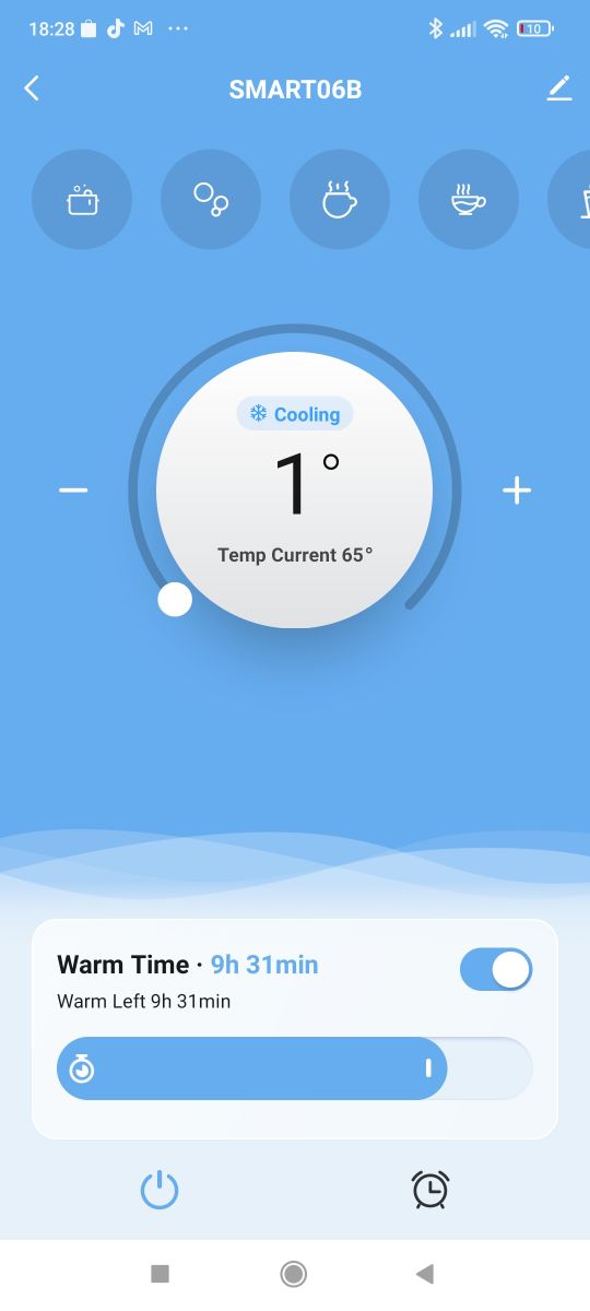

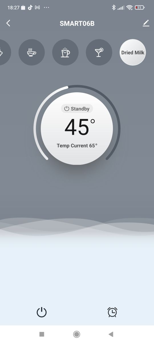

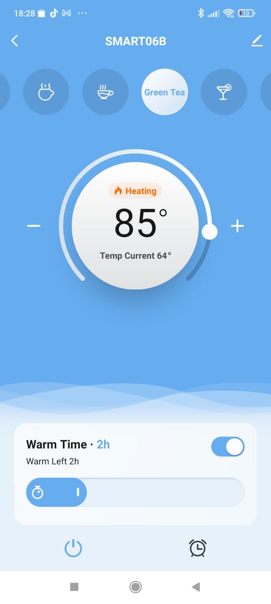

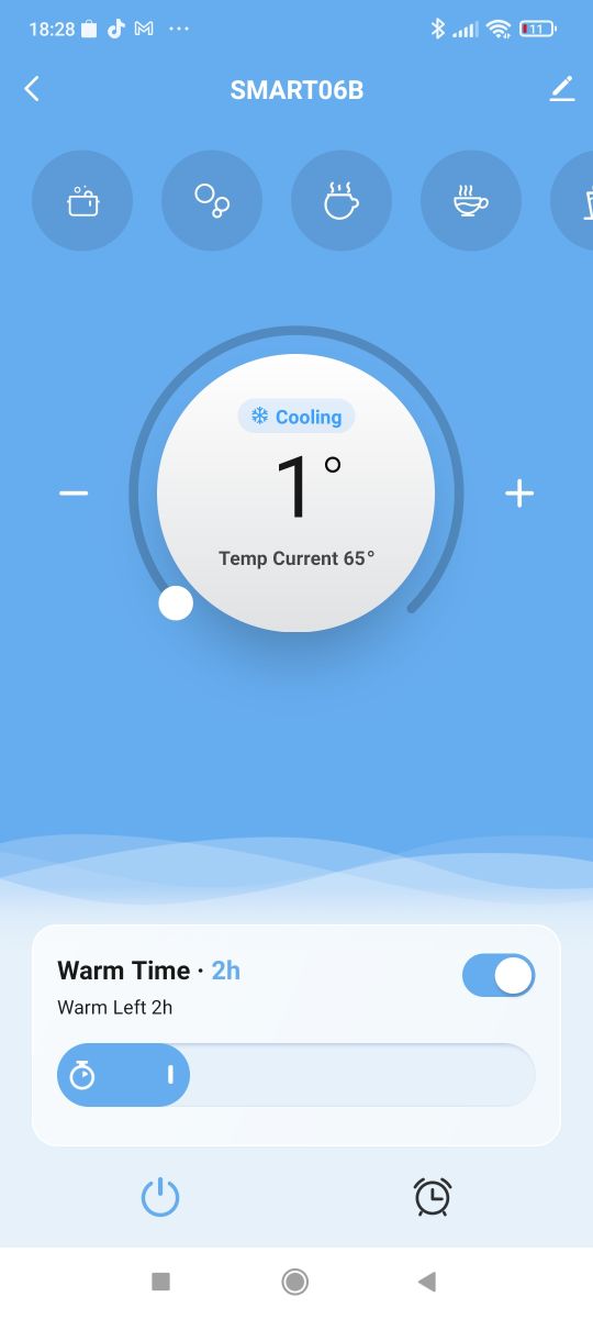

    In the app, we are welcomed by a preview of the current temperature, operation control and operating modes. We can select one of the predefined temperatures, or set our own.
    For example, a temperature of 85°C is given for green tea and only 45°C for milk.
    An interesting option is the possibility to set a temperature hold time - this way you can ensure that your drink is always warm.

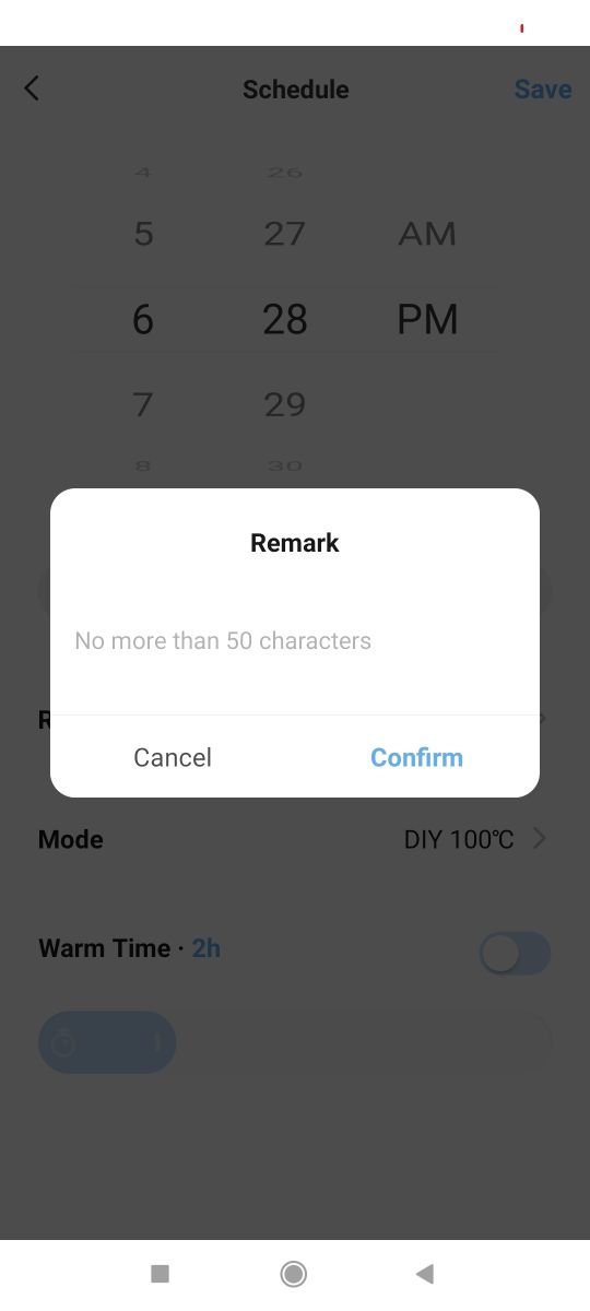

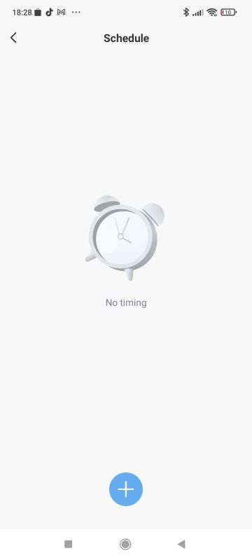

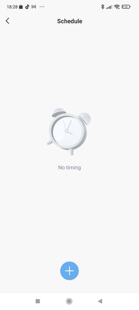

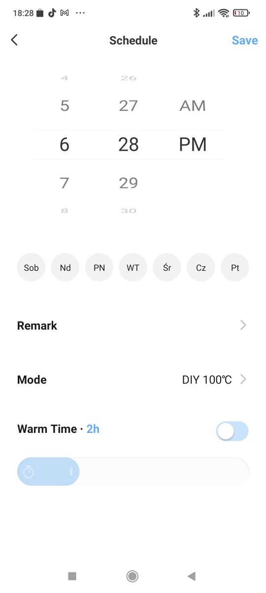

    Automation can be set. For example, you want the kettle to boil water on a given day at a given time.
    Kettle SMART06B app screen with scheduled time and temperature settings visible .
    Schedule settings screen with comment input and confirm option .
    When heating is switched on, the status on the screen changes to "Heating".
    SMART06B app interface showing green tea mode and 85°C temperature setting

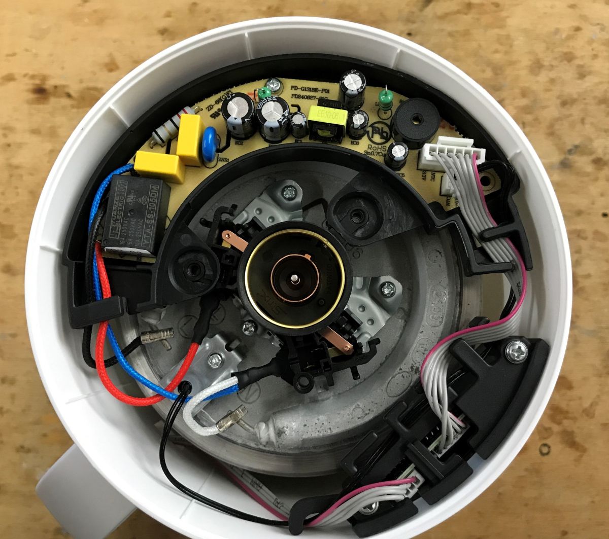

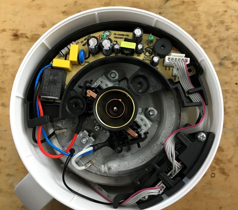

    It is now possible to look inside the product. There are no electronics in the base. We therefore unscrew the cover from underneath:
    Interior of SMART06B electric kettle showing control electronics and wiring .

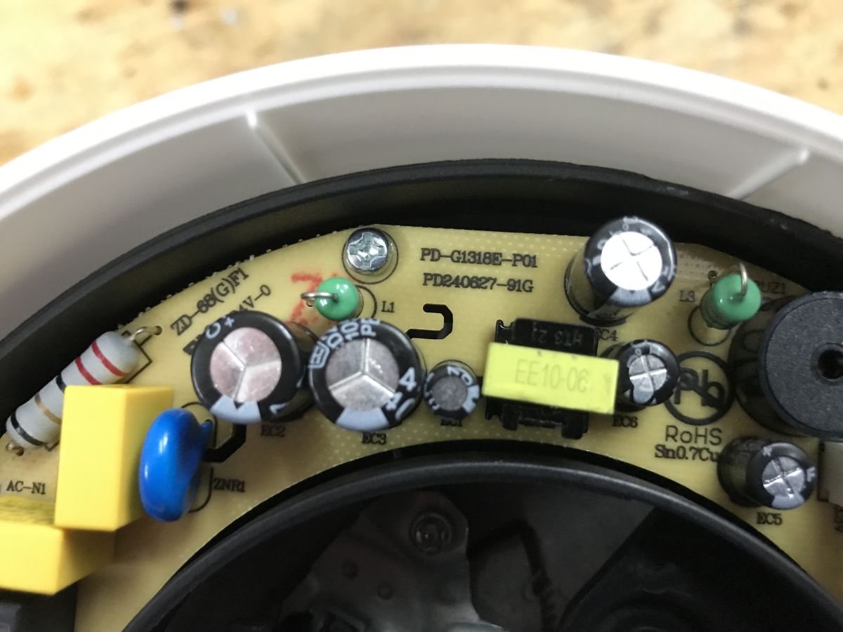

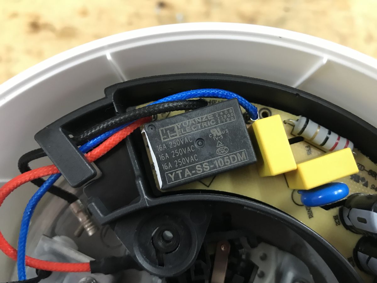

    PCB designation: PD-G1318E-P01 Inside is a buzzer, a small power supply, probably in flyback topology, and a relay for 16 A, the YTA-SS-105DM. I also see input filters, a varistor and a fuse resistor.
    YTA-SS-105DM relay inside the SMART06B electric kettle housing .
    Close-up of the SMART06B kettle PCB with visible capacitors and EE10-06 coil .

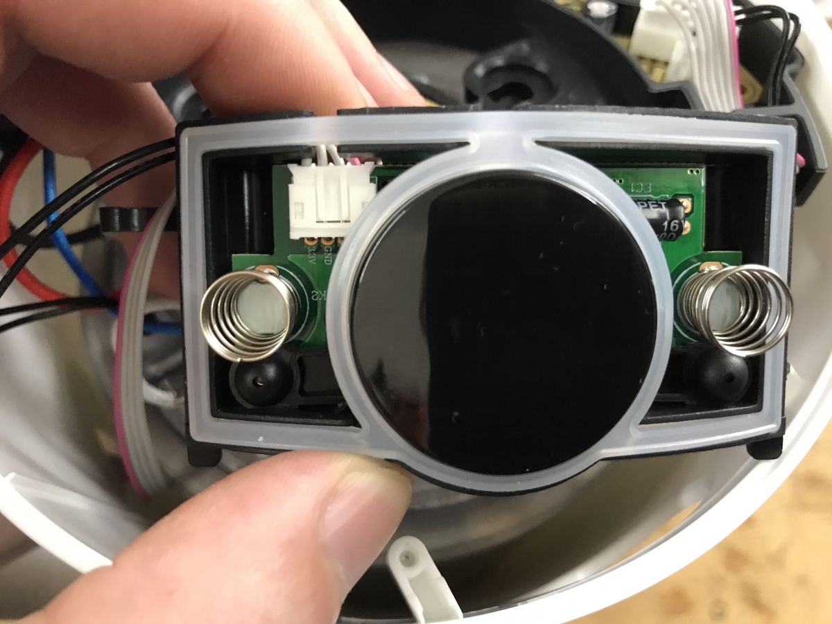

    The module with the display has two buttons, and four signals go from it to the kettle handle. The markings GND, 3.3 V and RX and TX suggest TuyaMCU.
    Control module with dial and springs inside the SMART06B kettle handle .

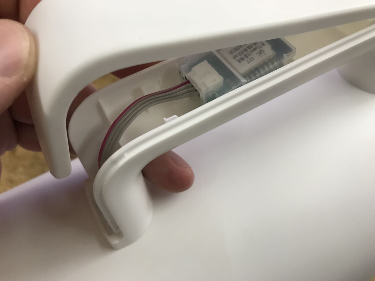

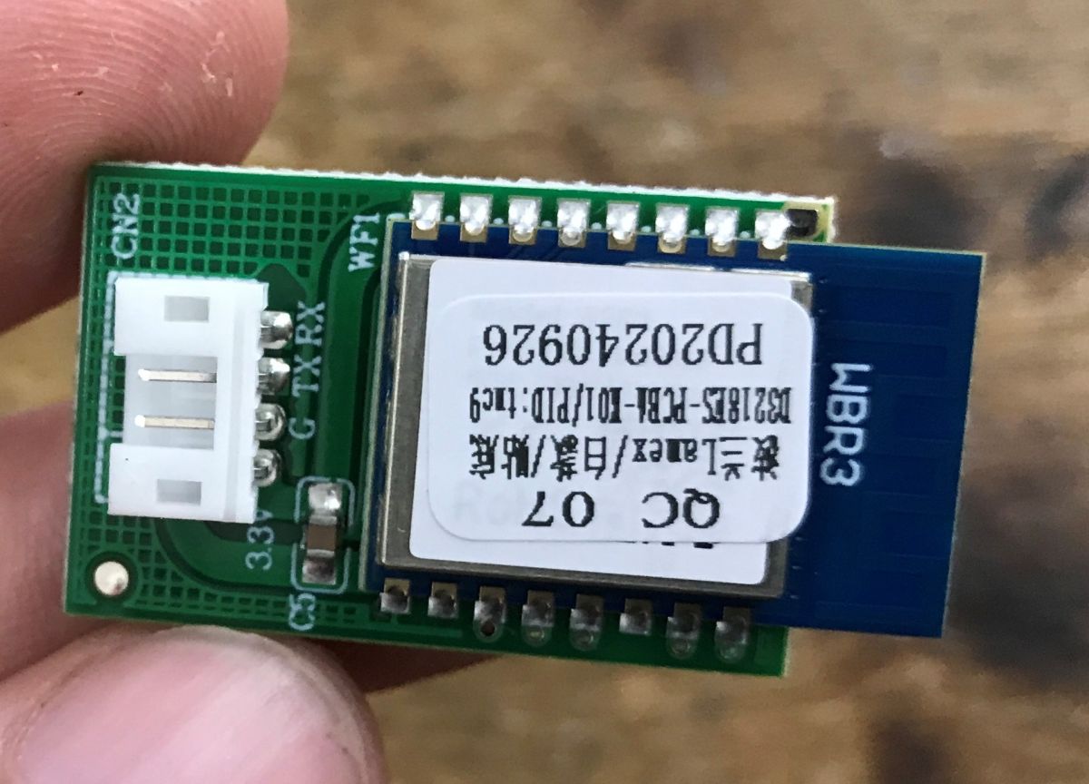

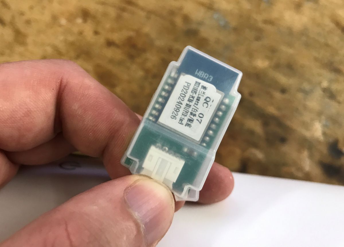

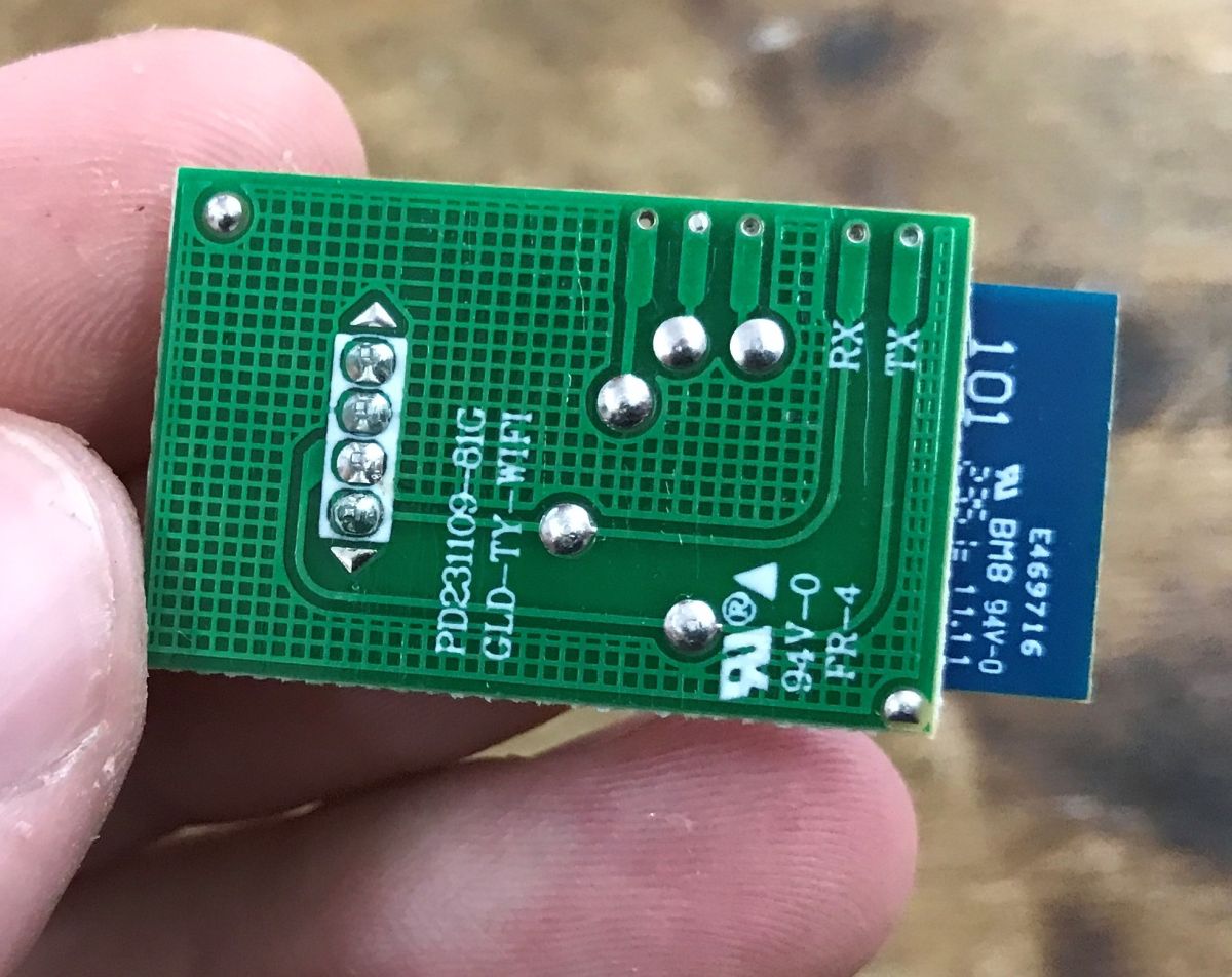

    So we look into the handle - it's hooked up.
    WBR3 electronic module inside the handle of SMART06B kettle .
    WBR3, this series was described on the forum: WBR2, WBR3, WBRU, W701-VA2-CG pinout, data sheet, flashing for Home Assistant .
    Close-up of WBR3 WiFi module in plastic housing held in a hand .

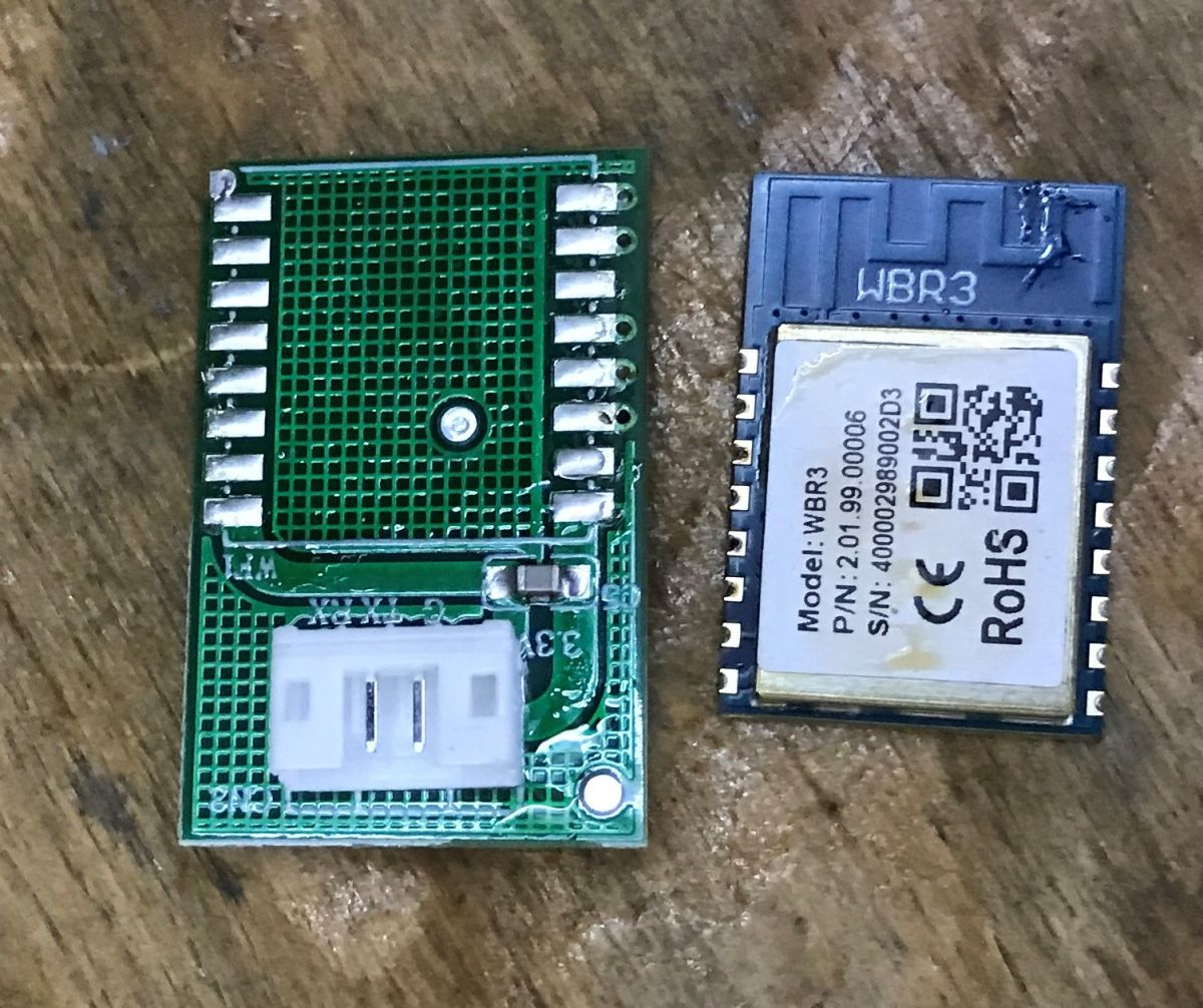

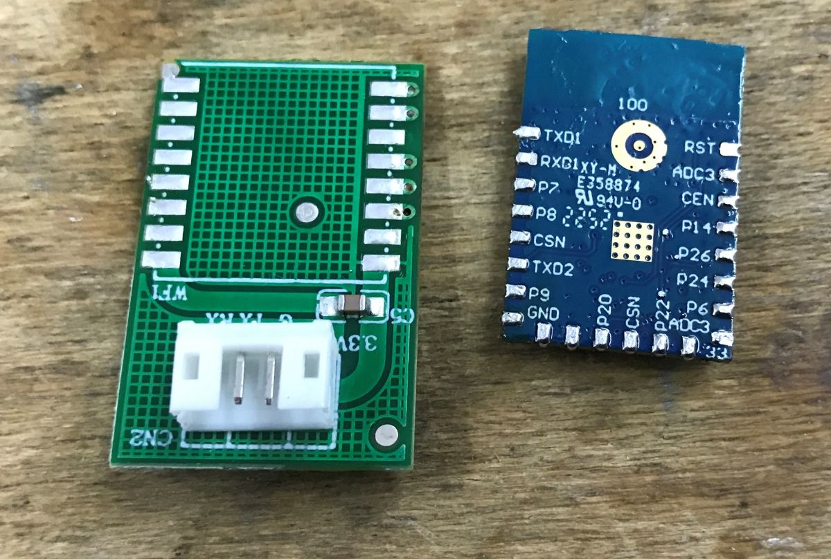

    The programming pads are on the bottom of the module, so you have to solder it off the board.
    WiFi module WBR3 with labeled pins RX, TX, GND, and 3.3V, held between fingers. .
    WBR3 WiFi module on PCB with UART connector in close-up view .
    WiFi module WBR3 and adapter PCB on a wooden surface .
    WiFi module next to programming interface board on wooden surface .
    I made a copy of the batch and uploaded the OBK:
    Copy of the batch: https://github.com/openshwprojects/FlashDumps/commit/f9f283d2cddad48157f4a7911798b242974dbe36

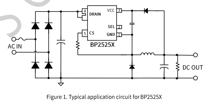

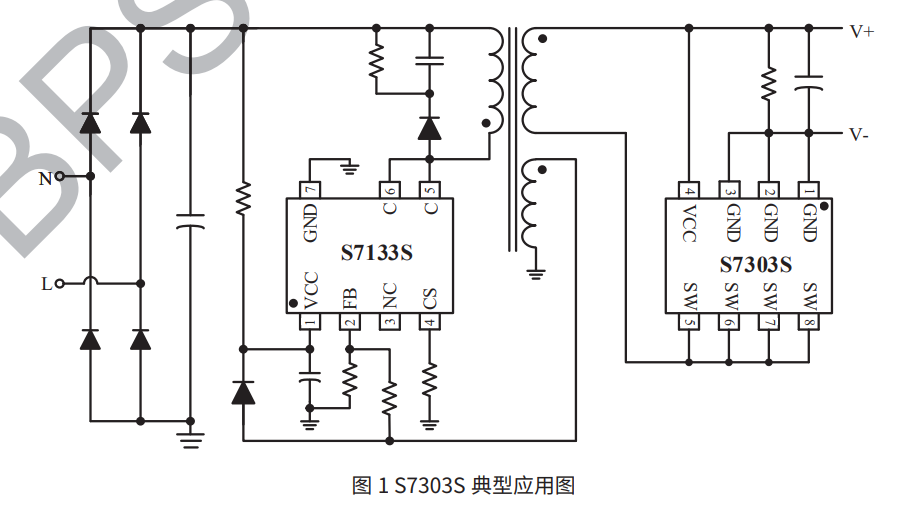

    Can you clarify what you mean by powering the electronics in this case? I've checked quite a lot of Wi-Fi controlled devices and I know that there rather flyback converters (with galvanic isolation) are used, or non-isolated step-down converters, such as on the BP2525:
    Application circuit for BP2525X controller with AC input and DC output, no transformer .
    Flyback power supply schematic with S7133S and S7303S and transformer .
    (As for the second diagram - in IoT devices I see it with a Schottky diode, they don't use synchronous rectifiers there, I only see them in USB power supplies for charging phones).
    I am under the impression that you are referring to devices that are powered transformerless, but using the capacitor/capacitive dropper method? I could be wrong, I'm more into digital electronics.

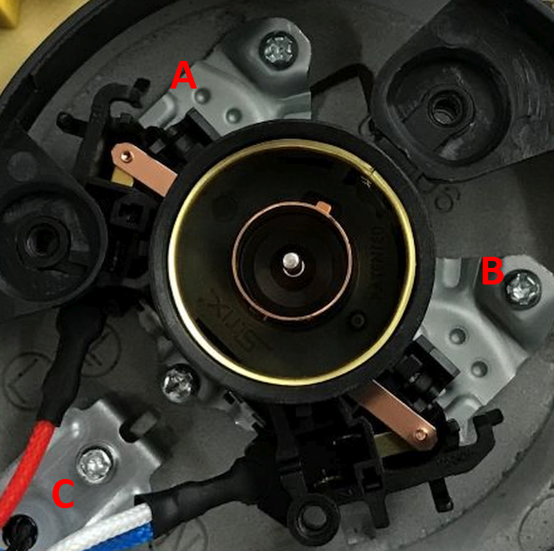

    No worries. The electronic kettle has a total of three protections.
    A, B - mechanical thermistors.
    C - thermistor for the electronics.
    Inside base of kettle showing protections A and B (thermal cutoffs) and C (thermistor). .
    You can safely switch on the heater without water. The thermistors can also work after all the boiling water has been poured out of the kettle.
    Just heating the water to 40°C is a useful function when we need to dissolve 2KC in a warm glass of water in the morning.

    It depends on the method of power supply. In the case of inverters, the rectangle doesn't bother anything - there is a rectifier at the input and a capacitor behind it. Here the signal waveform is indifferent. It can even be direct current. It is completely different when the power supply is transformerless - here the rectangle can destroy the device.
    Fortunately, WiFi devices need a lot of low-voltage current, and this is difficult to achieve in a transformerless power supply, Rather than using a transformerless power supply of e.g. 12V or 24V and then a step-down converter to 3.3V.

    @krzbor that's what I was gently aiming at, especially as I wrote in my presentation that the power supply looks flyback and I didn't know if my colleague @bumble was referring to that or if he just meant the transformerless ones.... our Electrode initiative has already described almost 800 IoT devices, which can be seen here: https://openbekeniot.github.io/webapp/devicesList.html and somehow I don't associate any with a solution other than flyback/step down.... well, except for the battery-powered and USB-powered ones, of course.
    The capacitor solution is what I rather see in timer programmers without WiFi, which I have also already presented:

    I've always wanted a temperature-controlled kettle. Boiling water at 40°C is quite a saving. You destroyed my dream by explaining that it doesn't cook, it only heats.
    A heating appliance should have at least a minimum of thermal insulation - this piece of crap does not. A couple of hours at 60°C will eat up a lot of coin (I know, I used to build a coffee cup temperature keeper).
    Definition: Automatic shutdown - After removing from the base
    deserves a Pulitzer.

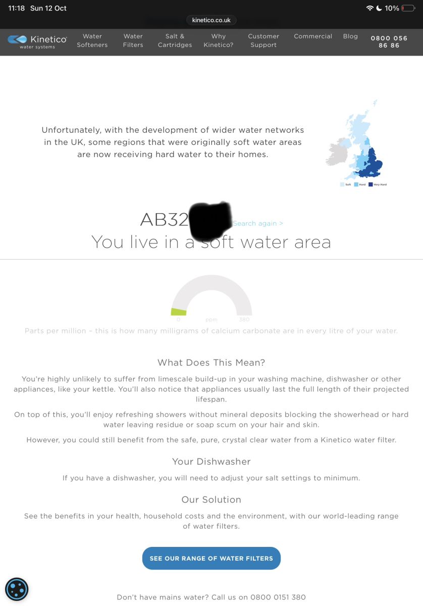

    It all depends on the water intake.
    My tap comes from the River Dee (north-east Scotland), a river meandering through woods and peat bogs.
    And the water from it is very mild and tasty.
    Screenshot showing postcode AB32 is in a soft water area in the UK .
