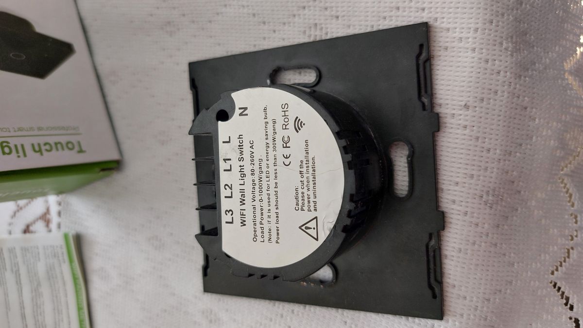

    OpenBeken on touch switch with T34 - offline control, 433MHz remotes, cloud OpenBeken on touch switch with T34 - offline control, 433MHz remotes, cloud OpenBeken on touch switch with T34 - offline control, 433MHz remotes, cloud OpenBeken on touch switch with T34 - offline control, 433MHz remotes, cloud OpenBeken on touch switch with T34 - offline control, 433MHz remotes, cloud OpenBeken on touch switch with T34 - offline control, 433MHz remotes, cloud .
  • Model identified as AY-W602 SH_GANG_2_BL_WF

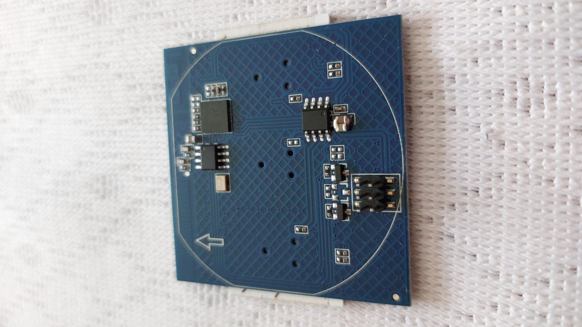

    I'm not familiar with this particular board, but that's potentially what I was saying. There is a chance that RF will still work after changing the firmware. Normally I would ask you to investigate the MCU connections to the T34, but.... access to the T34 pads is so poor with a multimeter that I won't bother asking about it.
    Can you read which circuit is the RF? Or both without markings?
    I don't see any programming pads unfortunately. I guess you are facing a procedure like here:
    [BK7231N / T34] Teardown Tuya Generic Wifi Wall Switch 3-fold .
    Worth writing down the model of the device: AY-W602 SH_GANG_2_BL_WF

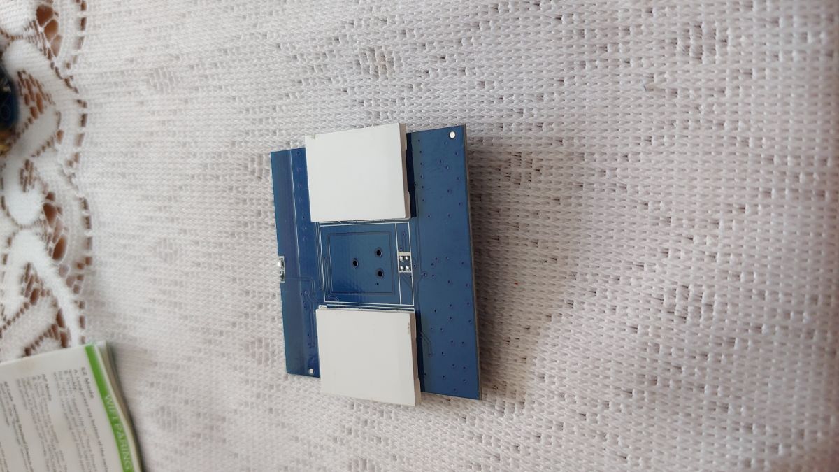

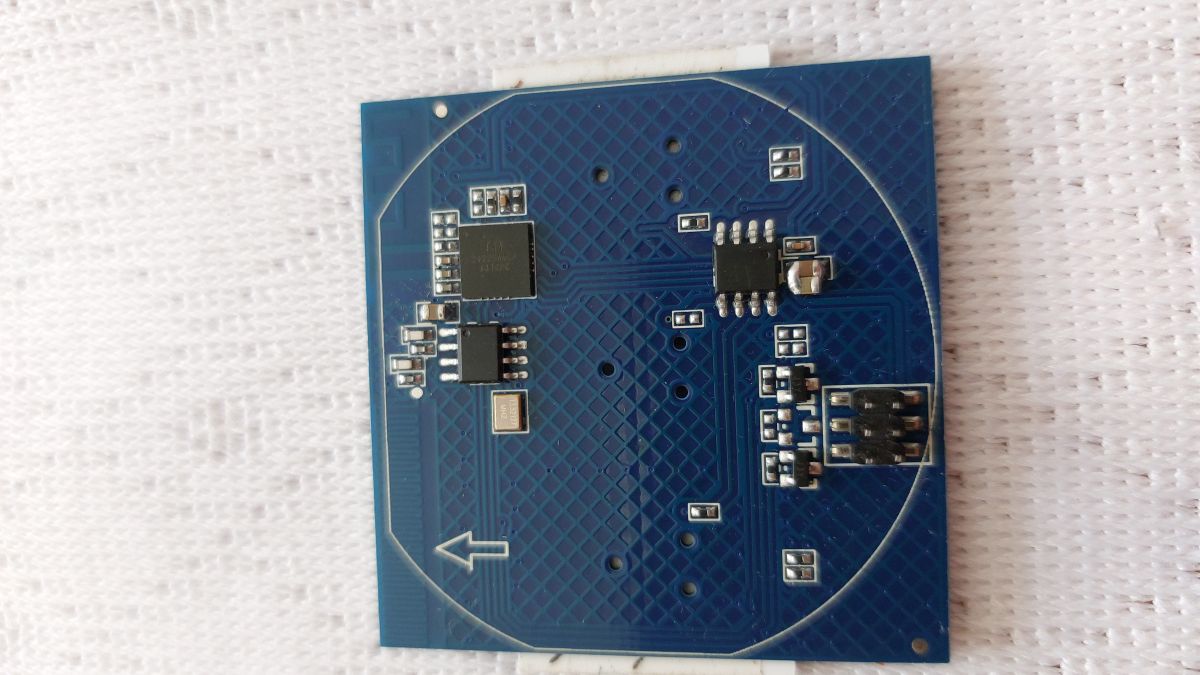

    I see no programming pads unfortunately.
    From my inspection it appears that there are not even any RX and TX paths out, this is a handicap but maybe I can sort it out.
    Can you read which circuit is RF? Or both without markings?
    Both have no markings.

    If there are no TX and RX paths out , that's a good sign - because that tells us it's not a TuyaMCU based device. So it is a device with what I said mechanism - that is, the RF chip is connected to the button controller and the button controller is connected to the WIFI module.
    I think you have the one here:
    https://www.elektroda.com/rtvforum/topic4036975-90.html#21694094

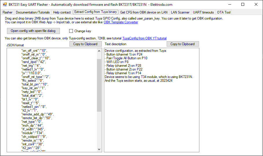

  • OpenBeken template and PowerSave setup for T34 touch switch
    #10 21710904
    Posts: 14756
    Rate: 12881
    Congratulations, you did it quickly. Will you brag about a photo of how you wired it, or write a few words about how you soldered the T34? A lot of people have problems with this.
    You already know the GPIO:
    BK7231 Easy UART Flasher window showing extracted Tuya configuration .
    This is the Tuya template:
    Now you can safely upload in OBK, then connect to the OBK AP, on IP 192.168.4.1, pair the device to your WiFi (temporarily, to test) and upload this template:
    Additionally, in the Short Startup Command, add "PowerSave 1" (without the quotation marks) and save. This will save a little power and reduce the heating of the power supply, extending the life of the sprite.
    Provided everything has gone ok, and you haven't hit on some new type of pretty board, the RF should still work, all by itself. At least that's how it's been in the devices we've developed so far. QTouch WiFi switch plugged into L wire only - test, interior, schematic .

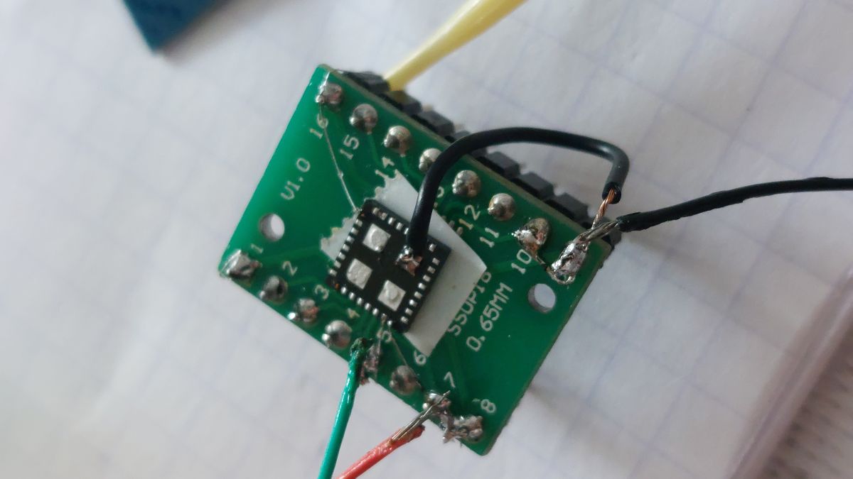

  • Hotair removal method for T34 chip soldering
    #11 21710930
    2konrafal1993
    Posts: 2916
    Help: 581
    Rate: 746
    Congratulations, that went quickly for you. Would you brag about a photo of how you wired it, or write a few words about how you soldered the T34? Lots of people have problems with this.
    I soldered with a hotair set at 350°C and used a nozzle of similar size to the chip, poured a generous amount of rma223 gel flux and set the blowing to 4 on a scale of 1-8. Do not over-blow as there are small parts next to it that can be blown off, but too little blowing will make the chip less hot and the soldering process may be prolonged, which is best avoided. The distance between the nozzle and the circuit is a maximum of 5 mm. When heating the circuit do not try to lift it, just slightly move it from side to side and when it floats well then lift it, this method allows you to make sure that all the solders are released and you do not break any tracks.
    Electronic module with wires soldered to a green PCB Hotair nozzle heating an electronic component on a blue PCB over graph paper. .
    I decided to place the circuit in a makeshift stand in order to protect myself in case of a tugging cable that might come off with the solder field.

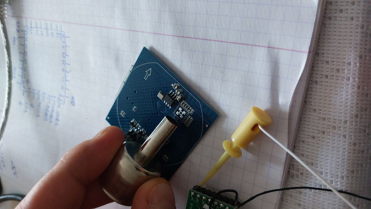

    The chip itself gives no signal and was not visible even on the laptop next to it, I am doing all the tests on the PCB. I'm doing the whole procedure for the first time so I'm assuming I've made a mistake somewhere, I'm going to check the quality of the solders because sometimes a weaker contact can happen and I'm taking that into account.
    Added after 32 [minutes]: .
    Just to be sure, I checked the MAC address because supposedly it can be removed and it is the same as it was originally. The network from my router is detected by the module and I have -69dB there so the devices see each other. I did a test that the phone is the access point and here it works except that I have a low internet speed from the sim because it is a village but it is possible to log in and do something there. I stand by my opinion that this router is a disaster because it's not the first device that has problems with a router, before I moved I had a TP link for 100zł and there were no such miracles because everything worked. I don't know what to do because everything seems to be fine but it doesn't work.
    The switch connects to the hotspot on the laptop so that something is going on with the router. I still want to pair the remotes because we have two, that would be all I need.
    I have investigated what I could and the pilot rf receiving circuit sends a signal to the T34 on the CEN leg, the RF circuit leads match the WF480RA. I checked with an oscilloscope and the RF pilot signal is received by the circuit and sent to the T34 but that is where my knowledge and ability to succeed ends.
  • #26 21713895

    CEN is the RESET pin, its shorting to ground resets the WiFi module. It is not likely that RF is received there?

    I just don't understand what's going on either, with an oscilloscope I have examined the signal at the output of the remote control receiver circuit and there is when I press the piot. A series of rectangles is arranged, it resembles a typical digital signal waveform and I have exactly the same thing when I connect the oscilloscope to pin 21 of the CEN, the continuity of the path is also maintained. Maybe the Chinese know an additional function of this pin and used it here, what is interesting is that no reset occurs during transmission of the remote control and on this pin itself the state changes from high to low.

Does the RF input really go to the CEN pin on some boards?
CEN is the BK7231N reset pin. If you observe RF activity on CEN without resets, your board may repurpose that line, affecting RF handling. Verify with an oscilloscope before mapping pins. [Elektroda, p.kaczmarek2, post #21713895]

Do missing RX/TX test pads mean TuyaMCU is involved?
Lack of exposed RX/TX often indicates it is not a TuyaMCU serial bridge. Instead, buttons and RF feed GPIOs directly on the Wi‑Fi SoC, which OpenBeken can handle locally. [Elektroda, p.kaczmarek2, post #21710615]
Which model was identified from photos in this thread?
The board noted matches AY‑W602 SH_GANG_2_BL_WF. Use this hint when searching templates or similar teardowns for GPIO clues. [Elektroda, p.kaczmarek2, post #21710571]

Use hot‑air about 350 °C with a nozzle sized to the chip, generous RMA‑223 flux, airflow ~4/8, and keep the nozzle within 5 mm. Wait for the part to “float,” then lift to avoid pad damage. Secure the board to protect pads. [Elektroda, 2konrafal1993, post #21710930]
