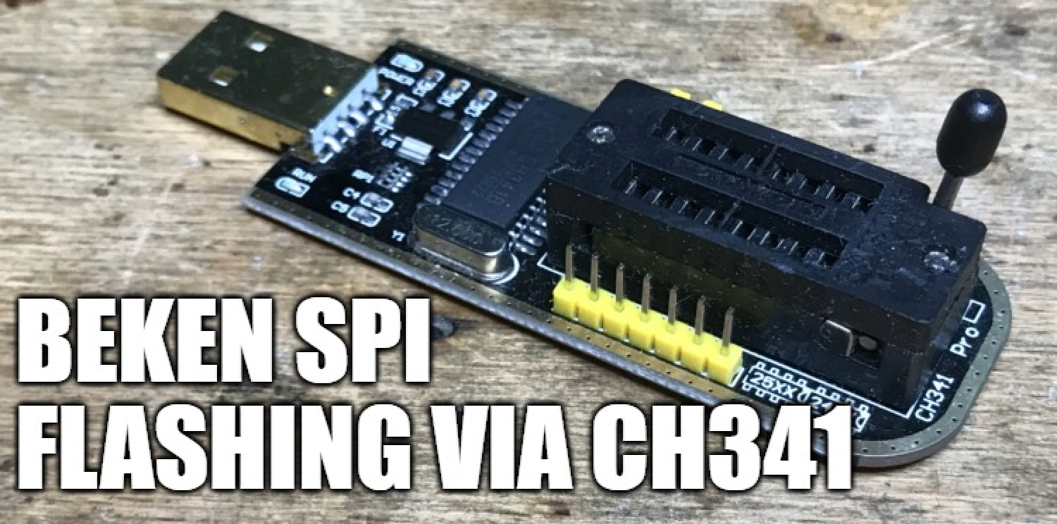

    Required Hardware

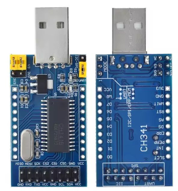

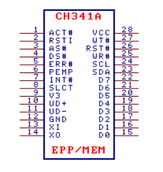

    For this guide, you’ll need a CH341 programmer — either the same one used in our video or a similar model:

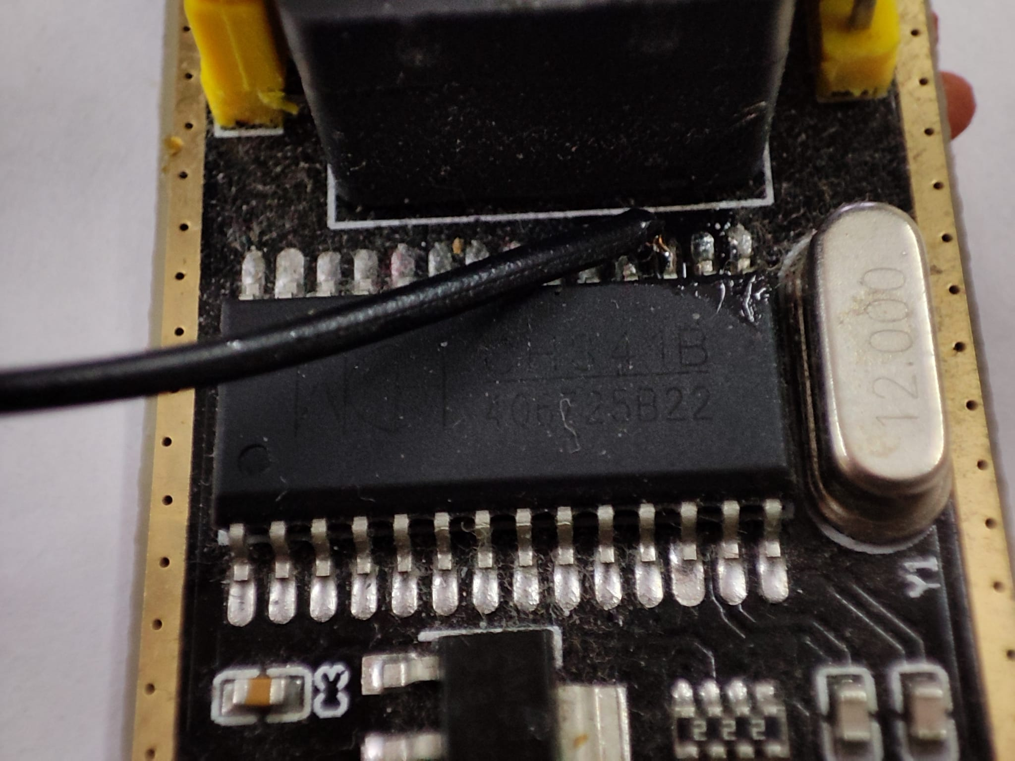

    Additionally, you’ll need a soldering iron to attach a wire to the D2 pin, which will be used to control CEN:
    Beken BK7231/BK7252 SPI flashing and recovery - new flasher tool and protocol specs
    Here’s how it looks in my setup:

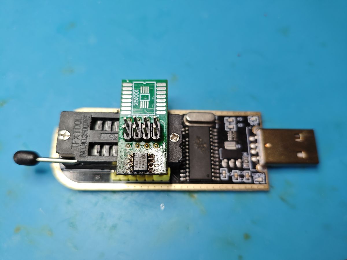

    Alternatively, you can use another version of the CH341 — the one with routed-out pins:
    Make sure the device jumper is set to the I2C position so that Windows detects it as USB-EPP/I2C... CH341A.

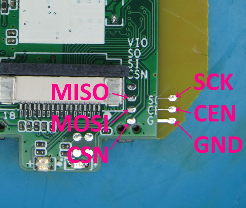

    Next, connect the CH341 to the Beken device in SPI mode:

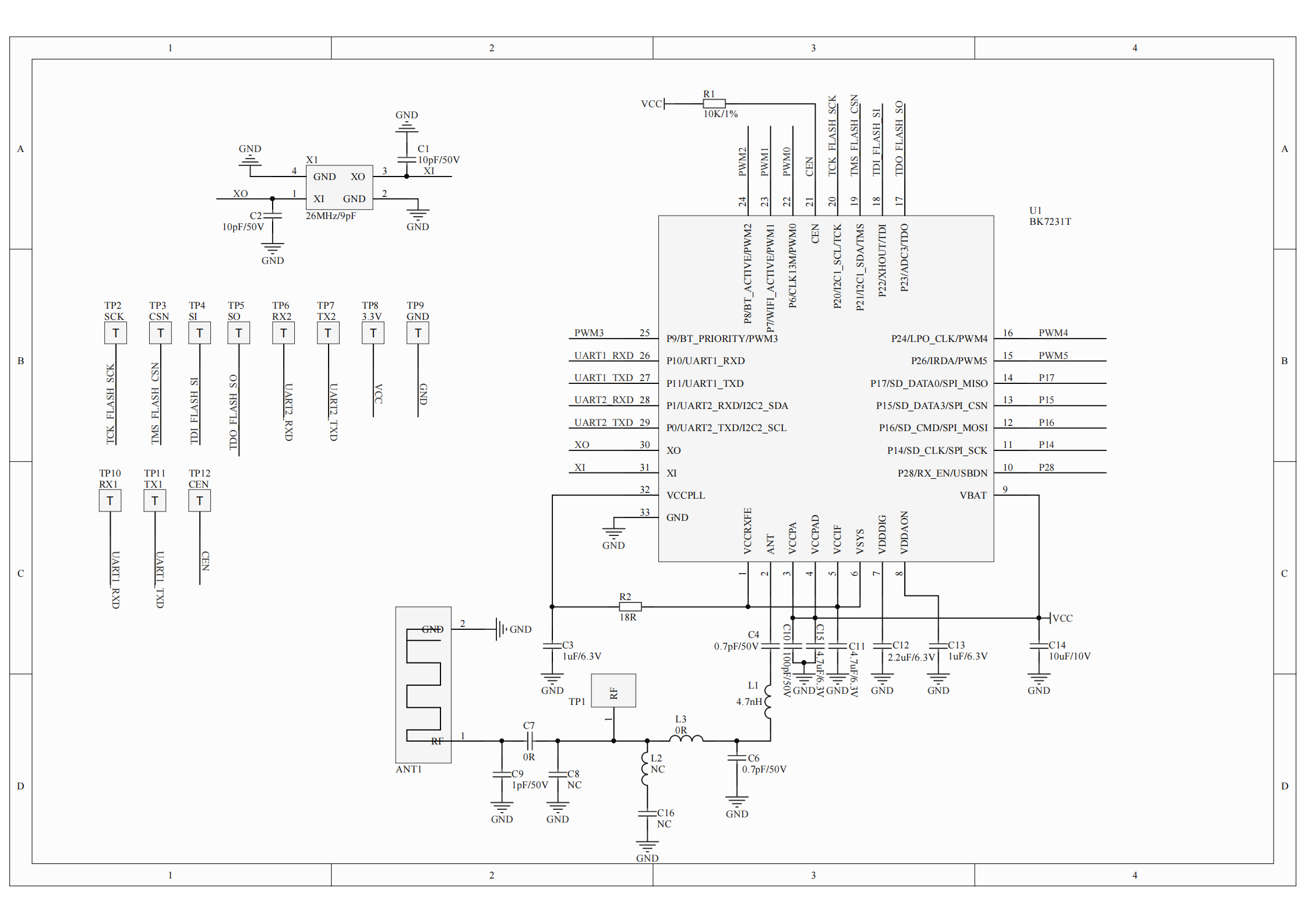

    Use the following pins: P20, P21, P22, P23 (SCK, CSN, SI, and SO).
    As usual, connect MOSI → SI and MISO → SO. Additionally, connect CEN to the previously mentioned D2 pin.
    You can also check for board markings — they might be available on some devices.
    Here’s an example photo from @divadiow:
    Connections summary:
    Generic IOTuya Doorbell PadsCH341A
    CE/CENCED2
    SCKTCKSCK
    CSNTMSCS0
    SITDIMOSI
    SOTDOMISO
    GNDGNDGND
    So, the pad naming may vary, but the connection remains the same. Don’t forget to connect power.

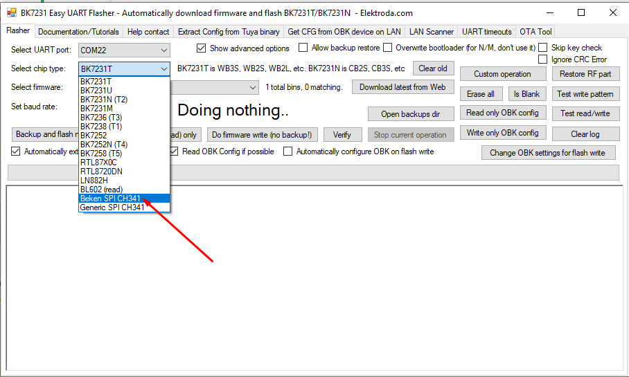

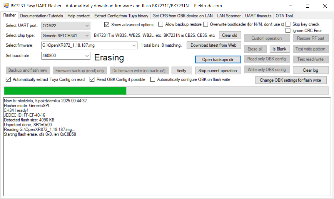

    Flash Tool Usage for Beken
    First, download our tool from the following link:
    You can either download one of the prebuilt binaries or compile it yourself in Visual Studio.
    After launching the tool, you should see a window like this — select the Beken SPI chip type:
    Next, you can use the buttons to Read, Write, Verify, or Erase the firmware.

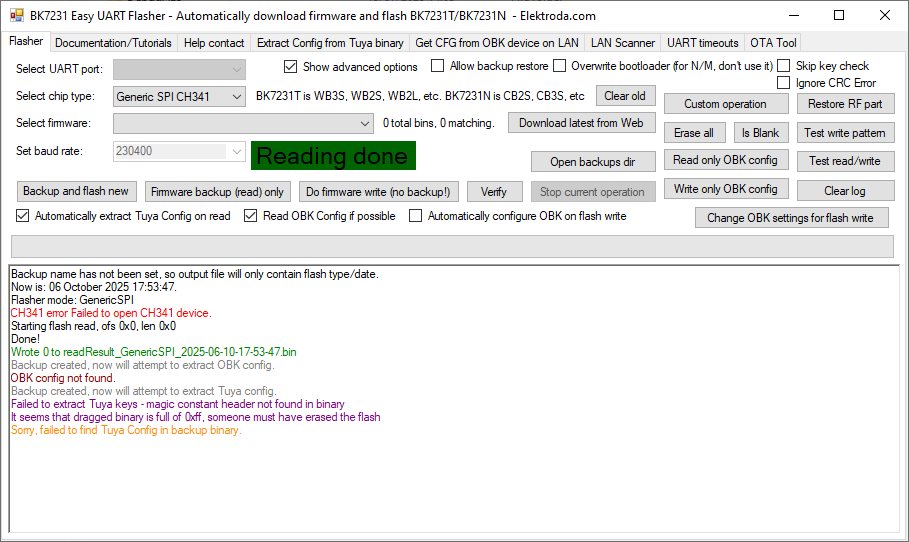

    If you encounter an error like the one below:
    Backup name has not been set, so output file will only contain flash type/date.
    Now is: niedziela, 5 października 2025 00:35:37.
    Flasher mode: BekenSPI
    CH341 error Failed to open CH341 device.
    Starting flash read, ofs 0x0, len 0x0
    Done!
    Performing a Beken CEN reset on D2 of CH341...
    Failed to toggle CEN - is CH341 connected and ok?
    Check if the CH341 is properly configured and detected by your PC.
    If the Beken chip does not enter SPI mode, verify the SPI and CEN connections.

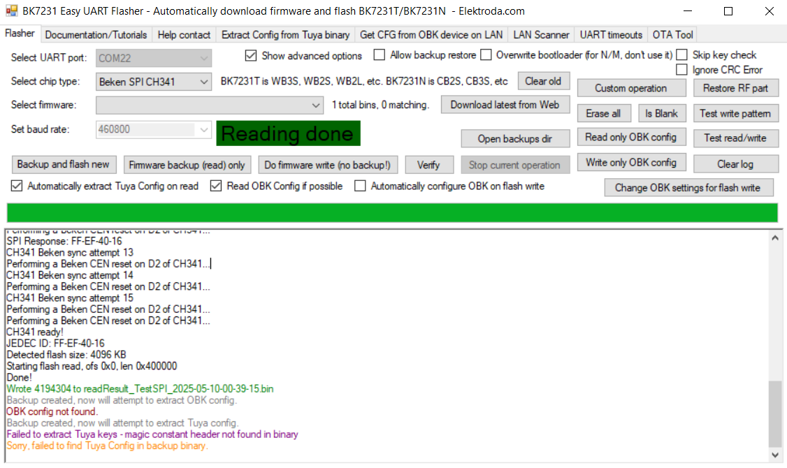

    Once properly connected, the tool should correctly identify the flash ID and size, and begin the selected operation.
    Sample ID output (your values may vary):
    JEDEC ID: FF-EF-40-16
    Detected flash size: 4096 KB
    Wait for the entire operation to complete:
    BK7231 Easy UART Flasher interface with “Reading done” message
    To write firmware, simply drag and drop the binary file onto the flasher window:
    Screenshot of BK7231 Easy UART Flasher with a firmware file path selected.

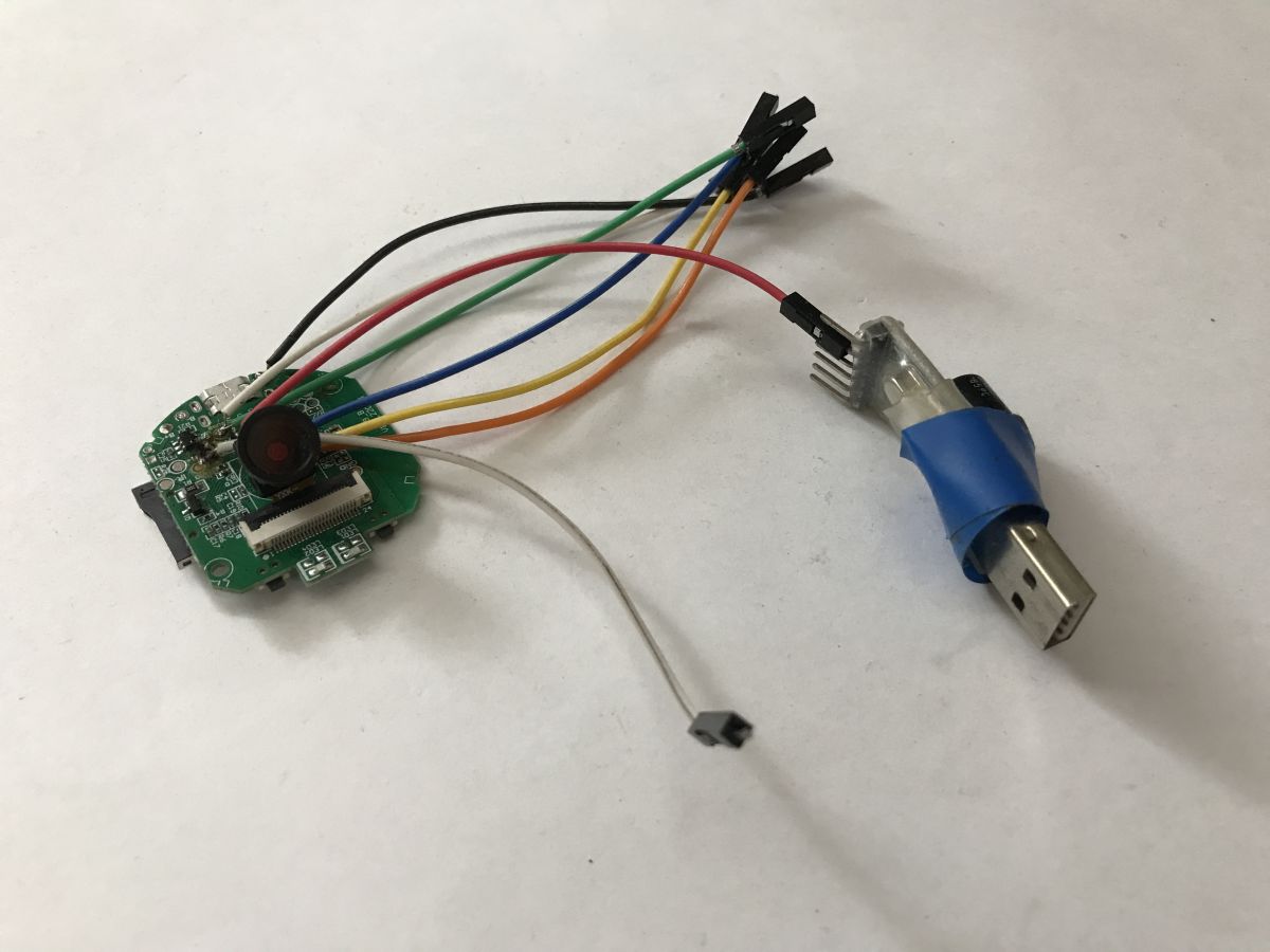

    This method can be used to recover bricked BK7252 camera device:
    Camera module with multicolored wires connected to a USB adapter

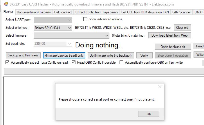

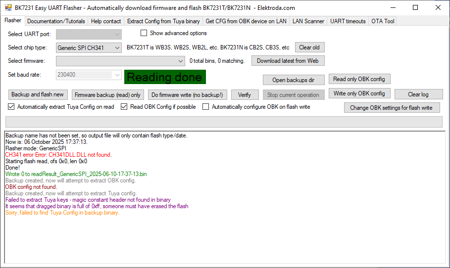

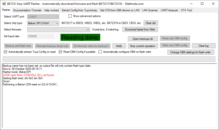

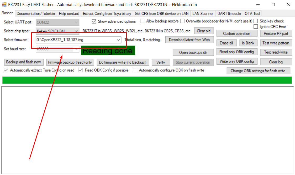

    cool! thanks for adding this feature. Easy Flasher has grown in a number of regards in recent weeks/months!
    A couple of things I have noticed, however:
    v98:
    -In SPI mode EF requires a COM port to be present/selected
    Screenshot of BK7231 Easy UART Flasher with serial port selection error message
    -In SPI mode with COM port present but missing CH341A EF will quit without warning - no CH341A detection
    -In SPI mode with COM and CH341A present I get missing ch341dll.dll not found
    BK7231 Easy UART Flasher interface with “Reading done” message displayed

    Thank you for testing. The incorrect COM port requirement should be fixed now, can you check?
    I can add CH341DLL later.
    Are you able to run the project with Visual Studio to check what crashes? I was sure that I handle all CH341 init exception well...

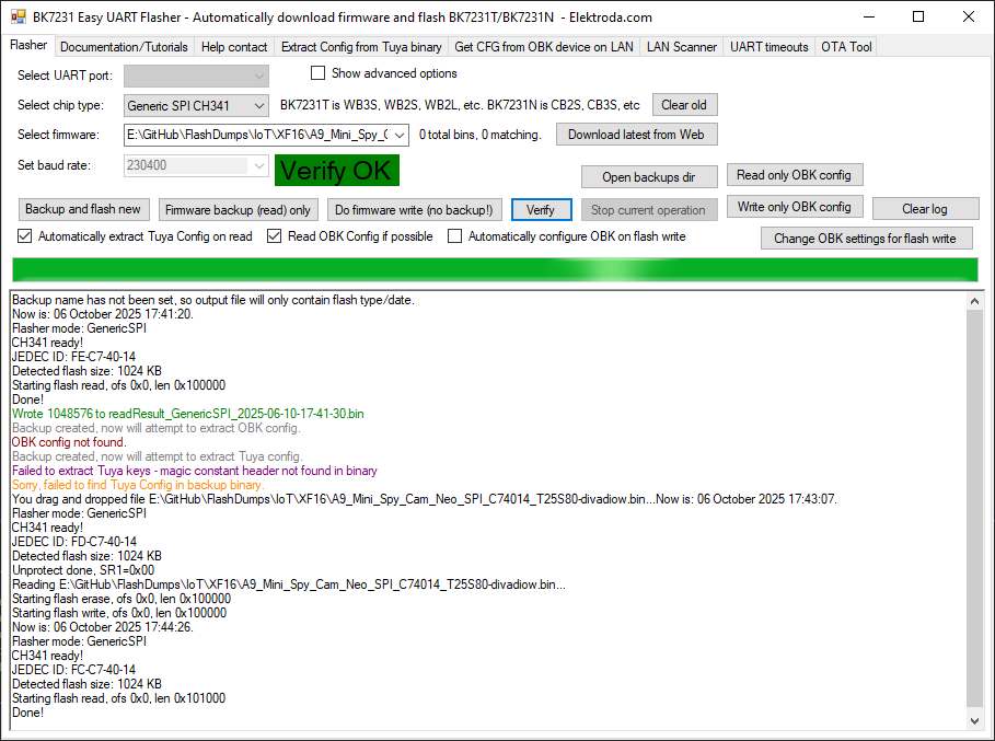

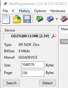

    computer rebooted. test setup:
    Driver properties for USB-EPP/I2C CH341A showing date 10/10/2023 and version 2.4.2023.10 CH341A programmer with SOIC-8 adapter and soldered flash memory on blue background
    1st - detection with Neo OK
    NeoProgrammer screenshot showing GD25Q80 CLONE 3.3V chip and memory parameters

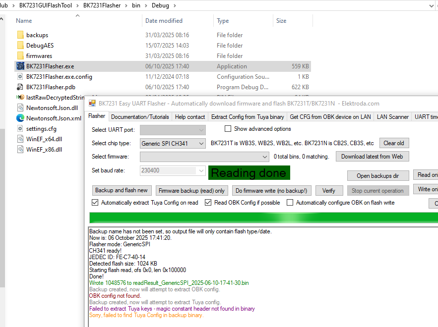

    Closed Neo. v99 EF from GH, generic SPI read:
    Screenshot of BK7231 Easy UART Flasher showing Reading done status in green
    same with test write
    build own (VS 2022) with latest code and read completes
    BK7231Flasher interface showing Reading done with flash read details
    write of test XF16 backup also completes and verifies
    BK7231 Easy UART Flasher interface with Verify OK and SPI flash operation log
    Added after 50 [seconds]:
    ps, what is the verify exactly? does it compare against loaded firmware in "select firmware"?
    Added after 57 [seconds]:
    I guess yes :)

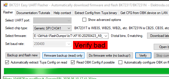

    Screenshot of BK7231 Easy UART Flasher showing Verify bad in red box
    erase success. Maybe every submission should clear previous completion status, "verify bad" persists after erase. No erase success in green to replace it.

    VS 2022 build - with no CH341 present EF does not die.
    BK7231 Easy UART Flasher interface showing Reading done status
    so is the Github workflow breaking something?
    Added after 44 [minutes]:
    forgot to mention that adding CH341DLL.DLL alongside Github build of EF exe does stop the 'missing dll' error but that's when EF will just quit

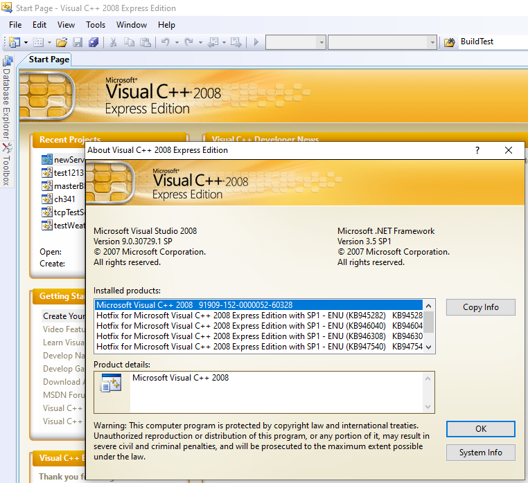

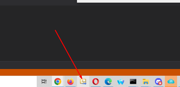

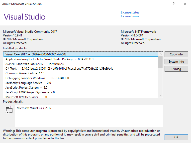

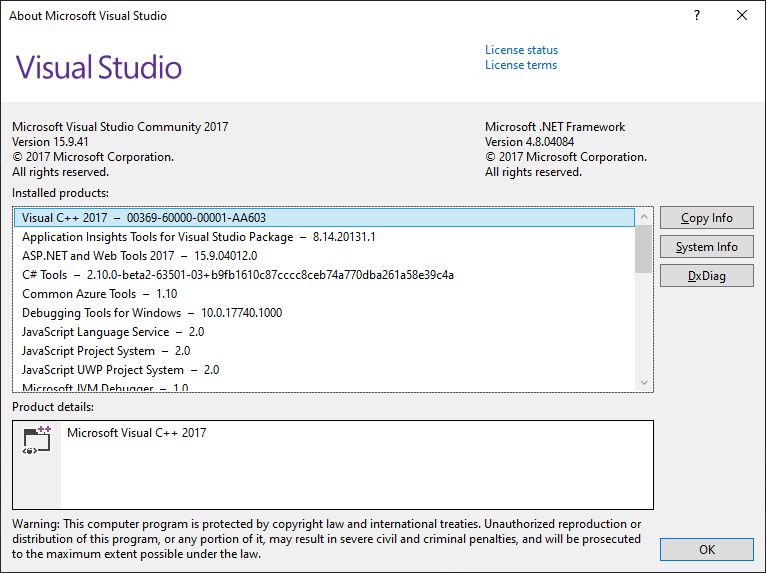

    The reason for using older NET is that I still have this Windows 7 laptop, which works very quickly and I sometimes use it for testing. Still, if you are convinced that newer NET is better for users, I can accept this change.
    On my main laptop (Windows 10, the one from this DIY - https://www.elektroda.com/rtvforum/topic4074433.html ), I have newer NET, but still use this MSVC:
    About window of Visual Studio Community 2017 with list of installed components
    Still, this isn't the older tool I have! I have also this, in which I started OBK:
    Windows taskbar with app icons and a red arrow pointing to one of them
    That's a great tool:
    About window of Microsoft Visual C++ 2008 Express Edition showing installed updates.
    Ok, seriously now, if you think there are advantages, then we can upgrade, but I can't help with mono - I never used it.
    I also think I have some newer MSVC on this machine, but don't use it for OBK currently.

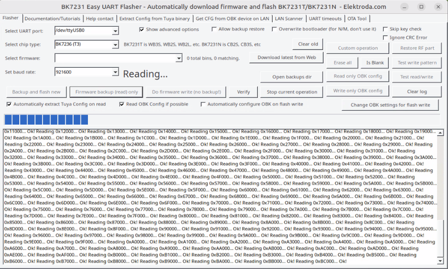

    We need someone to test it with mono https://github.com/openshwprojects/BK7231GUIFlashTool/pull/72 . To be honest, it's probably not that hard, maybe even GPT can guide
  • Mono flasher needs 921600 baud on Linux

    $ mono --version
    Mono JIT compiler version 6.12.0.200 (tarball Tue Jul 11 21:32:10 UTC 2023)
    Copyright (C) 2002-2014 Novell, Inc, Xamarin Inc and Contributors. www.mono-project.com
       TLS:           __thread
       SIGSEGV:       altstack
       Notifications: epoll
       Architecture:  amd64
       Disabled:      none
       Misc:          softdebug
       Interpreter:   yes
       LLVM:          yes(610)
       Suspend:       hybrid
       GC:            sgen (concurrent by default)
    BK7231 Easy UART Flasher interface showing memory reading progress and status log.
    Had to lower baud rate to 921600, while on windows 1500000 works fine.
    LAN Scanner works too.
  • Linux EasyFlash fails due to missing WinEF_x64.dll
