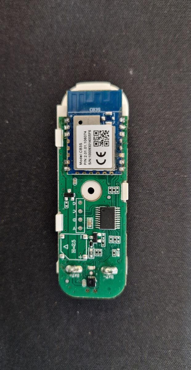

    First device in question is generic Thermometer with TuyaMCU.
    Interior of a device with a CB3S module on PCB, visible electronics and markings

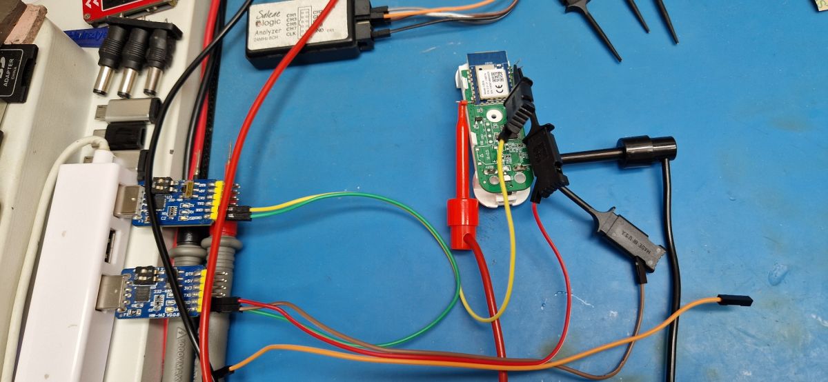

    Since I'll be doing this somewhat in depth and on multiple devices I prepared a small setup to make my life easier. Two USB to UART converters to capture both Rx and Tx from the TuyaMCU.
    TuyaMCU sensor setup with two USB-UART converters and a Saleae logic analyzer

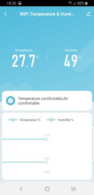

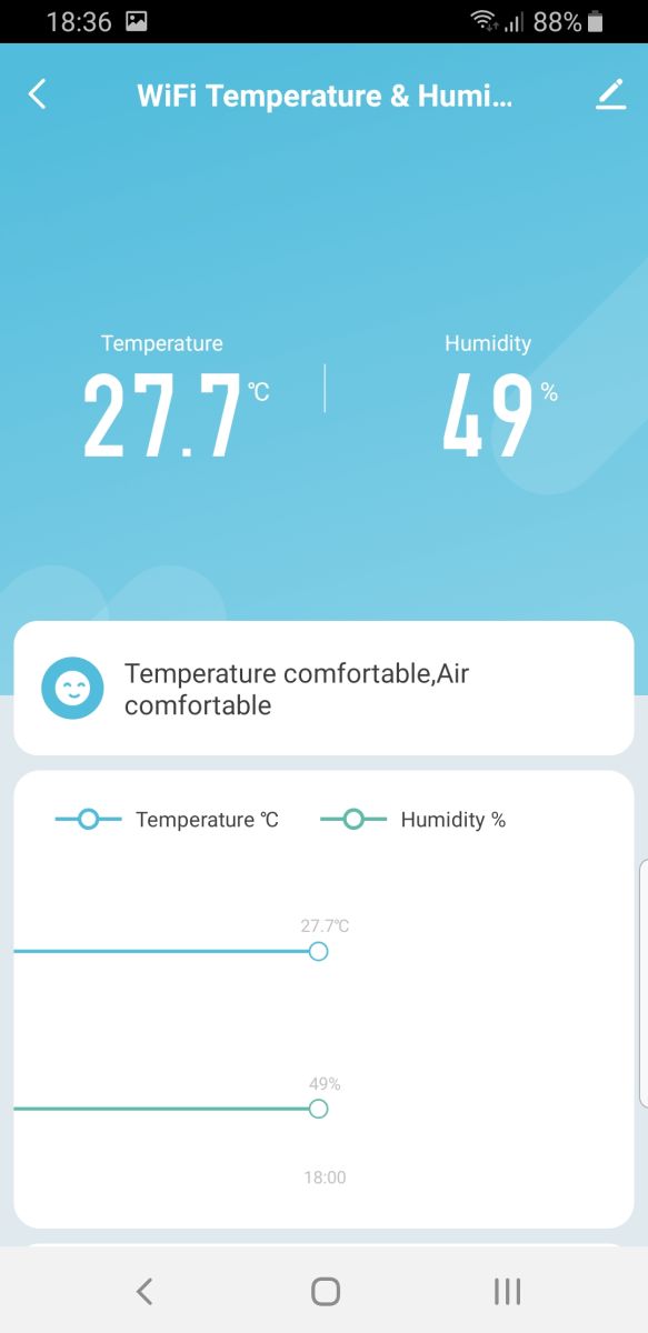

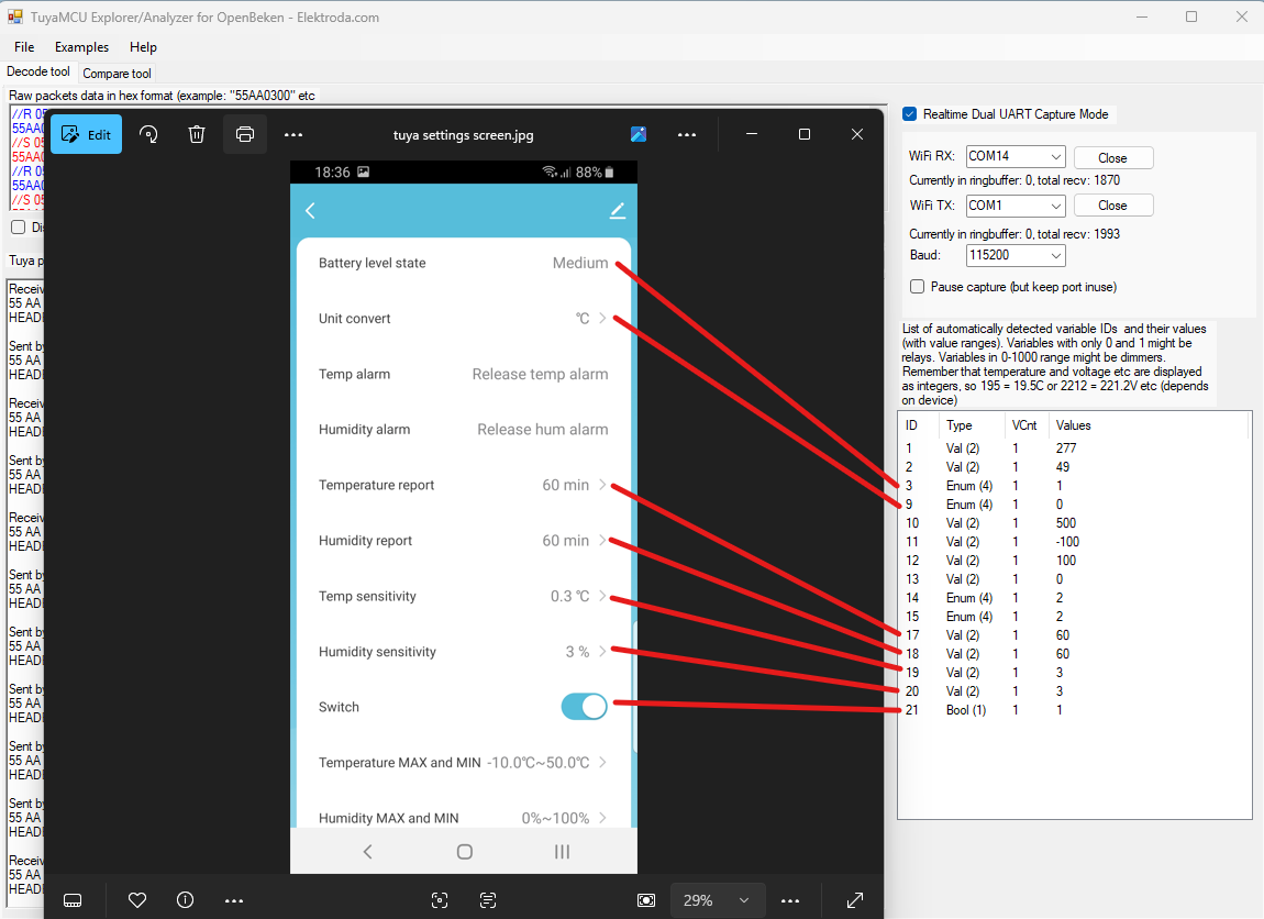

    Pairing with Tuya Smart application is straight forward I am working with stock Tuya FW to capture traffic and "decode" dpID's.
    This is what the app looks like on the phone:
    Screenshot of Tuya app showing temperature 27.7°C and humidity 49%

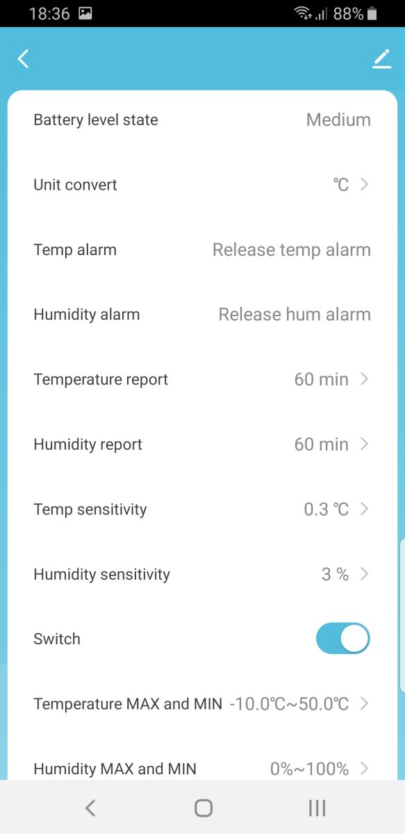

    Tuya Smart app settings screen with sensor parameters for temperature and humidity

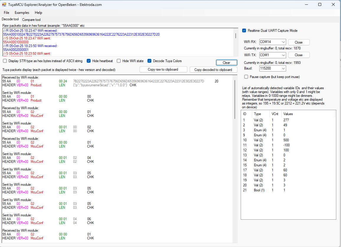

    And this is what our Analyzer has captured upon pairing and first readings (change baud rate between 9600 and 115200 if you don't get any readings):
    Screenshot of TuyaMCU Analyzer showing packet data and decoded dpID values
    Probably need to mention that on both my UART adapters I am using RX pins attached to Rx and Tx pins of the module as wee need to capture the traffic.
    You can find our Analyzer here - https://github.com/openshwprojects/TuyaMCUAnalyzer
    Can you spot some patterns and similarities?? :)

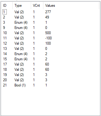

    So Analyzer got these values:
    Table with ID, Type, VCnt, and Values captured from TuyaMCU UART communication
    Comparing it to the app we can probably deduct which dpID does what. For example:
    ID 1 is temperature reading as a value 277 so it is been reported as a temperature with a division of 10 (important later when we will assign channels in OBK and set up actual value!!)
    ID 2 is humidity reding also as a value and a whole number, no division.
    This can be easier to determine if we play around with the application and monitor the traffic on the analyzer, doing so I was able to determine several data point ID's and get a very good picture of what I need to do when I convert this device to OBK. For example:
    Tuya sensor settings screen and UART analyzer showing dpID mappings
    Note that you'll have to reboot the device on any change in the application as it is, by default, set to wake up and report at 60 minutes so changes will not be applied if the device is sleeping. And not all dpID's are covered in this tutorial!!
    So from gathered info we have the following findings:
    ID1 - temperature_div10
    ID2 - humidity
    ID3 - battery state read as enum of 0 (low battery), 1 (medium battery) and 2 (high battery)
    ID9 - selection of temp reading 0 = Celsius and 1 = Fahrenheit
    ID17 - temperature report time in minutes
    ID18 - humidity report time in minutes
    ID19 - temperature sensitivity again as a whole number 3 which stands for 0.3 (because division by 10)
    ID20 - humidity sensitivity as a whole number 3
    ID21 - it the whatever the switch in the app is (no idea what it does at this point)
    Note again NOT all values are decoded by me in this instance!!! If you have more time you can dig into those deeper (maybe I'll do that at some point too)

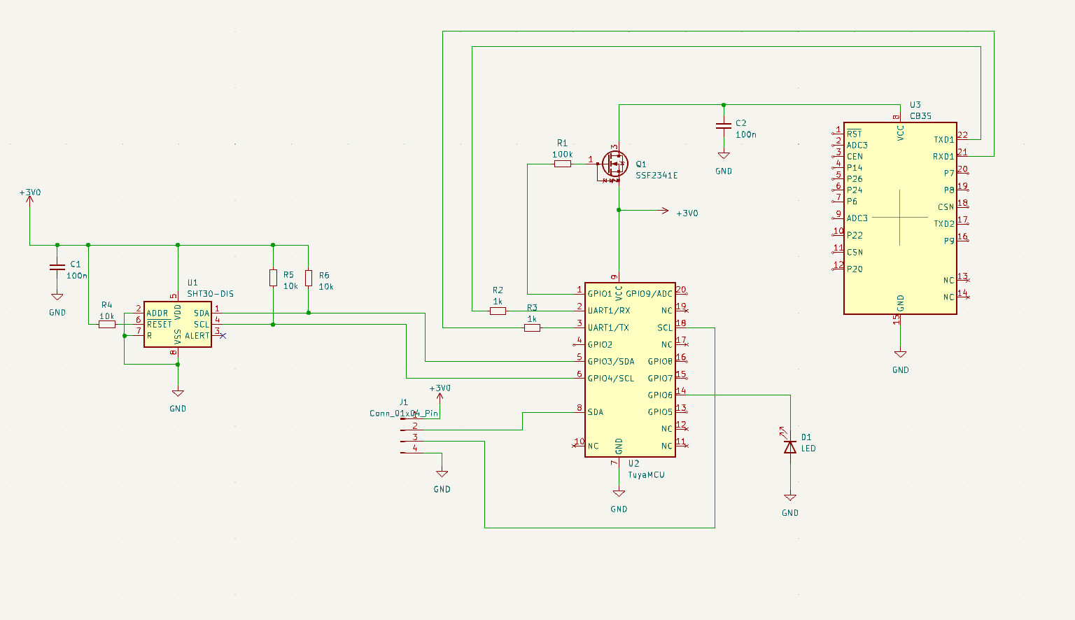

    From here on in I am confident I have what I need to convert this device to OBK and set it up to communicate with TuyaMCU and report what I set up to Home Assistant.
    Good practice to do so is to remove the module and program it separately but if unable to do so you can program it in circuit. Be sure to power the module directly and not via battery terminals as TuyaMCU controls a positive power supply via a small FET on the PCB - Q1 on the schematic.
    Another note is to power the module from a reliable power source (bench PSU or similar) for flashing, try to avoid using power supplied from your USB to UART adapter if possible and if you experience problems while flashing, remove R2 and/or R3 from the board to disconnect TuyaMCU and avoid it interfering with the flashing process!
    Wiring schematic for TuyaMCU, CB35, and SHT30-DIS sensor
    Schematic is for reference purposes, reversed by me and not ideal or 100% accurate as some values and marking are not present!!!

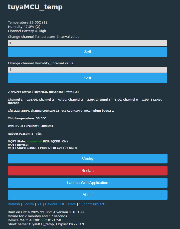

    I'll be using "only" 5 dpID's here to make a point and convey the general principle of converting this particular device, more in depth setup can be done but this explanation will not cover that.
    So to start we have to setup and start the TuyaMCU driver and it's tmsensor submodule/driver. Next is to set up OBK UART speed as not all devices use the same, device in question uses 115200. Making sure we are connected to WiFi with waitfor command and proceeding to set up OBK channels and linking them to dpID's.
    Starting with linking dpID 1 to CH1, setting up CH1 set to temparature_div10 because we determined how TuyaMCU reports it with the analyzer, next is humidity, same method just assigned dpID2 to CH2 and third is battery, difference being that channel is setup as ReadOnlyLowMidHigh as this is what TuyaMCu is reporting.
    Now dealing with datapoint cache values that can be set in the app namely reporting times for TuyaMCU. Logic here is to check set up those values and tranfer them to TuyaMCU on reboot. Channels 5 and 6 are used for that purpose and the end if you (copy/paste) this autoexec file you should get your index page to look like this:

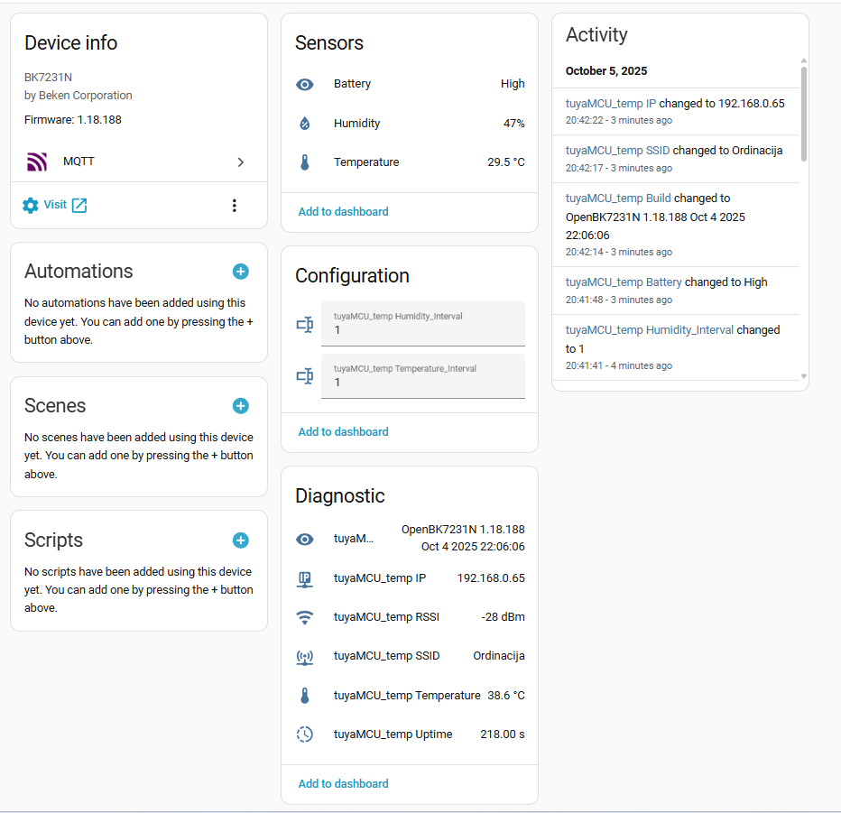

    OBK interface showing TuyaMCU temperature, humidity, and battery status
    Add your MQTT credentials and after connecting click on the button "HomeAssistant Configuration" under the "Config" menu on the device index page. this will trigger HA autodiscovery and if you have everything set up properly you will get this in you HA MQTT add-on:
    TuyaMCU panel showing temperature, humidity, battery and OBK configuration
    Hope this helps somewhat in dealing with TuyaMCU devices, more examples of different devices will follow shortly.

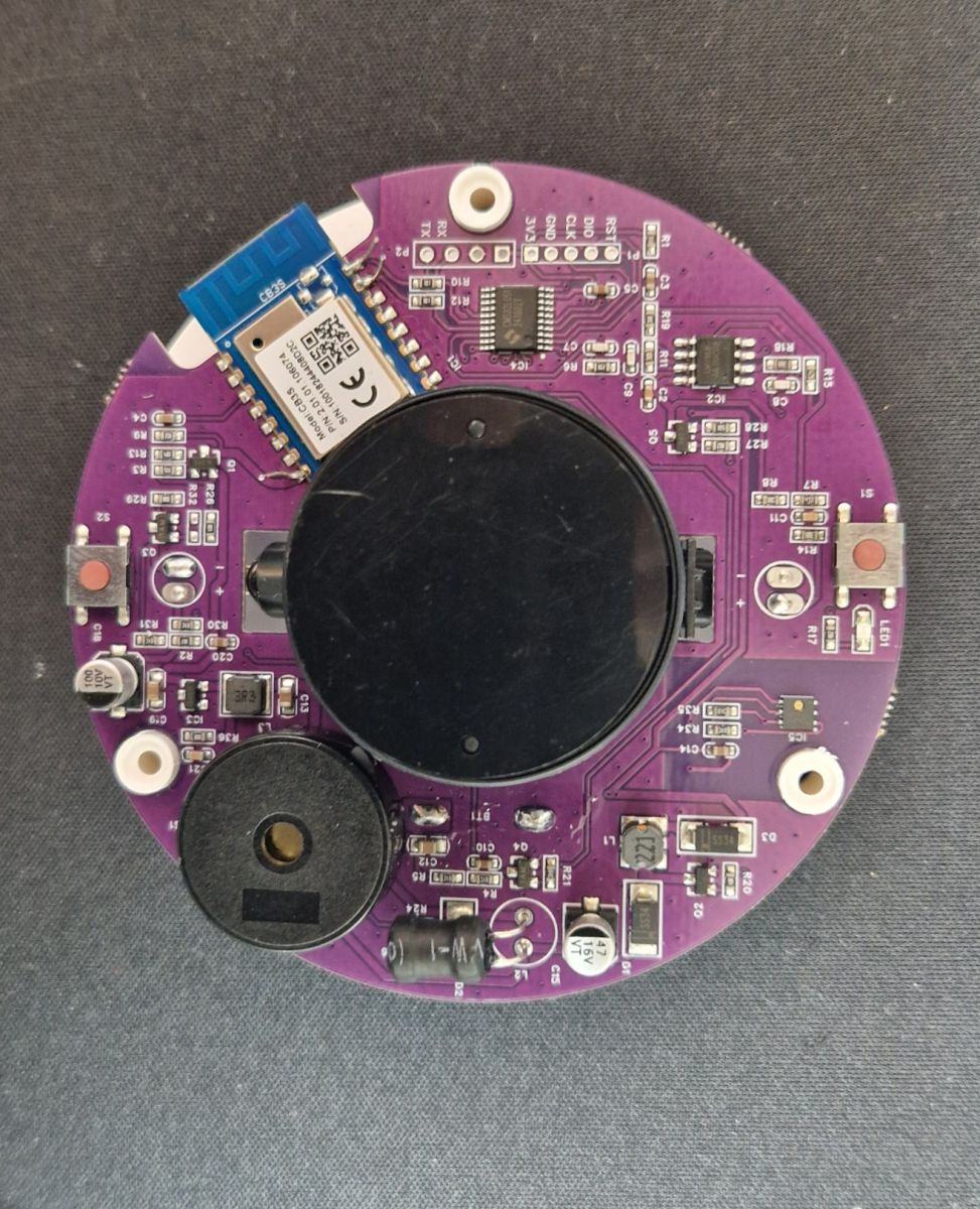

    Next device in line will be battery powered smoke detector with temperature and humidity sensor, provided to me by @io2345 (sorry for waiting this long for a response!)
    Purple PCB with Tuya module, UART headers, and various electronic components
    Same principals applies here, working with Tuya Smart App and stock FW on the device to figure out what is going on on the original device and replicate that with OBK.
    Link to the original thread and some difficulties with this device is here - https://www.elektroda.com/rtvforum/topic4124648.html
    Right from the start i can see some problems with this device, similar to many this device is not "finished" and was pushed to production and sold in that state. For example, @io2345 got these dpID's extracted from his device:

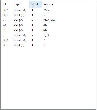

    and this what I got from the Analyzer:
    TuyaMCU analyzer data table showing dpIDs with types, counts, and values
    dpID 102 is not mentioned anywhere, I checked on my end and found the same when extracting dpID's so we will have to test and see what it is actually.
    So far by test and monitoring the traffic we can determine following dpID's:
    ID1 - smoke alarm but inverted, 1 is a normal state (no smoke) and 0 is alarm state (smoke present)
    ID15 - battery value in percent from 0 to 100
    ID16 - alarm mute asserted if value 1 is pushed to sensor while dpID1 is 0
    ID23 - temperature reading similar to the thermostat before sent as a round number divided by 10
    ID24 - humidity value
    ID101 - self test, pass value is 1 so my guess 0 is fail but can't replicate that, maybe something to do with the sensor (no idea)
    ID102 - unknown dpID right now has a value of 255 (max something??)
    ID107 - temperature alarm but without the option to set it (predefined maybe - HighMidLow??) current value is enum 2
