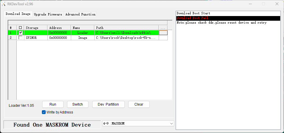

    I haven’t been able to locate a UART interface on the motherboard, not even using an oscilloscope. However, after gaining access to the NAND, I managed to boot the device in maskrom mode.
    In this mode, though, I can’t read the NAND because I don’t have a proper loader to boot the robot in emergency mode.
    RKDevTool screenshot showing Download Boot Fail error in MASKROM mode
    Here are the main component codes I’ve identified:
    RAM: NT5CC128M16JR-EK
    SoC: RK3308B
    NAND: XTX PN27G02BBGITG
    I’ve tried several loaders using rkDevTool, but the writing process always fails.
    Any suggestions?

    Have you tried rkdeveloptool ? :
    bash
    rkdeveloptool ld
    rkdeveloptool rfi
    rkdeveloptool rl 0x0 0x800000 dump_bootloader.bin
    You can also dump the entire eMMC:
    bash
    rkdeveloptool rl 0x0 0x617be00 dump_userdata.img
    Identify the loader (MiniLoaderAll.bin)
    Download from Xiaomi firmware or from OTA update and load it into RAM.
    bash
    rkdeveloptool db MiniLoaderAll.bin
    and only now you can use rkdeveloptool to read the partition....
    If you dump the NAND then use binwalk, dd, photorec, foremost to analyse and recover the data.
    If anything there is encrypted then access will be limited.
    Generally fastboot does not give access to NAND and certainly not in your case. You must go into mascrom mode and use rkdeveloptool.
    Look for the test point next to NAND or SoC - the small pad may be marked "TP" or "REC". If it is unlabelled because there are some, look for pads without description one of them leads to BootROM pins.
    It is often activated by shorting to ground....

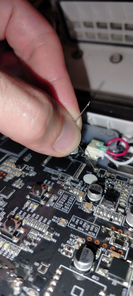

    >>21744005 Hi, thank you for your reply.
    The command
     rkdeveloptool ld
    gives:
     command is invalid!
     rkdevtool rfi
    and
    both hang without results until the board reboots and exits from maskrom mode. I'm successfully entering into maskrom mode short-circuiting NAND pin to GND, but NAND isn't readable.
    Finger holds a thin wire shorting pins on a black PCB with electronic components.
    Thank you.
