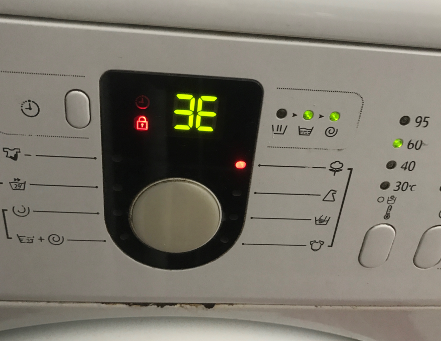

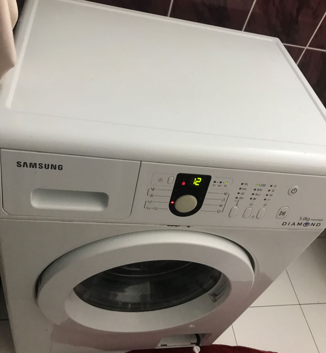

Why doesn't the washing machine start, spin? Replacing brushes, comparing old and new after 10 years
p.kaczmarek2 2361 25
  • Samsung Diamond WF8502NMW washing machine repair fixes a no-start, no-spin fault with occasional 3E error and black dust under the cabinet.
  • The fault came from heavily worn motor brushes; access was easy, the motor was unplugged, wires disconnected, old brushes removed, and replacements installed.
  • Matching 1:1 brush replacements with the same shear angle cost PLN20 for two pieces.
  • After cleaning the motor interior and reassembling, the drum spun normally with no excessive sparking, and the machine has worked for a month.
  • The repair was very late, and the brushes were not lapped because they already fit well.
  • Samsung Diamond washing machine with display showing number 12 on control panel
    How do the brushes look after 10 years of use? Today I will present a simple washing machine repair, a process that anyone can do at home. The patient is a Samsung Diamond WF8502NMW, which occasionally shows code 3E and usually just doesn't start at all. When the spinning alone is switched on, the timer goes from 12 to 11 and then goes back to 12 again and the drum does not start spinning. In addition, the owner reports that strange black dust has been collecting under the washing machine for some time. It's time to check what's broken.
    Samsung washing machine panel showing error code 3E and red door lock icon
    I didn't have time to take pictures, but I used the phone as a torch, so I have a video. Of course, first we unplug the unit from the mains. Access to the motor is very easy here.
    The characteristic black dust comes from the brushes. Brushes are the current-carrying components in motors that come into contact with the commutator. Such brushes gradually wear away as the motor runs, causing fine carbon dust to settle inside the washing machine. It is time to check how worn down the brushes are in the unit being repaired. Access is easy and they can be unscrewed without further disassembly.
    By the way, in the video, you can still see the RPM sensor on the 'end' of the motor - it too can be damaged.
    The screws are on both sides - but the phone can help us locate them, I myself often use it as a substitute for an inspection camera.
    Almost done, now the wires still need to be disconnected from them. Disconnect the flat connectors (pins), but don't pull, just push in the "tongue".
    Worn-out washing machine motor brushes and enclosures on white background

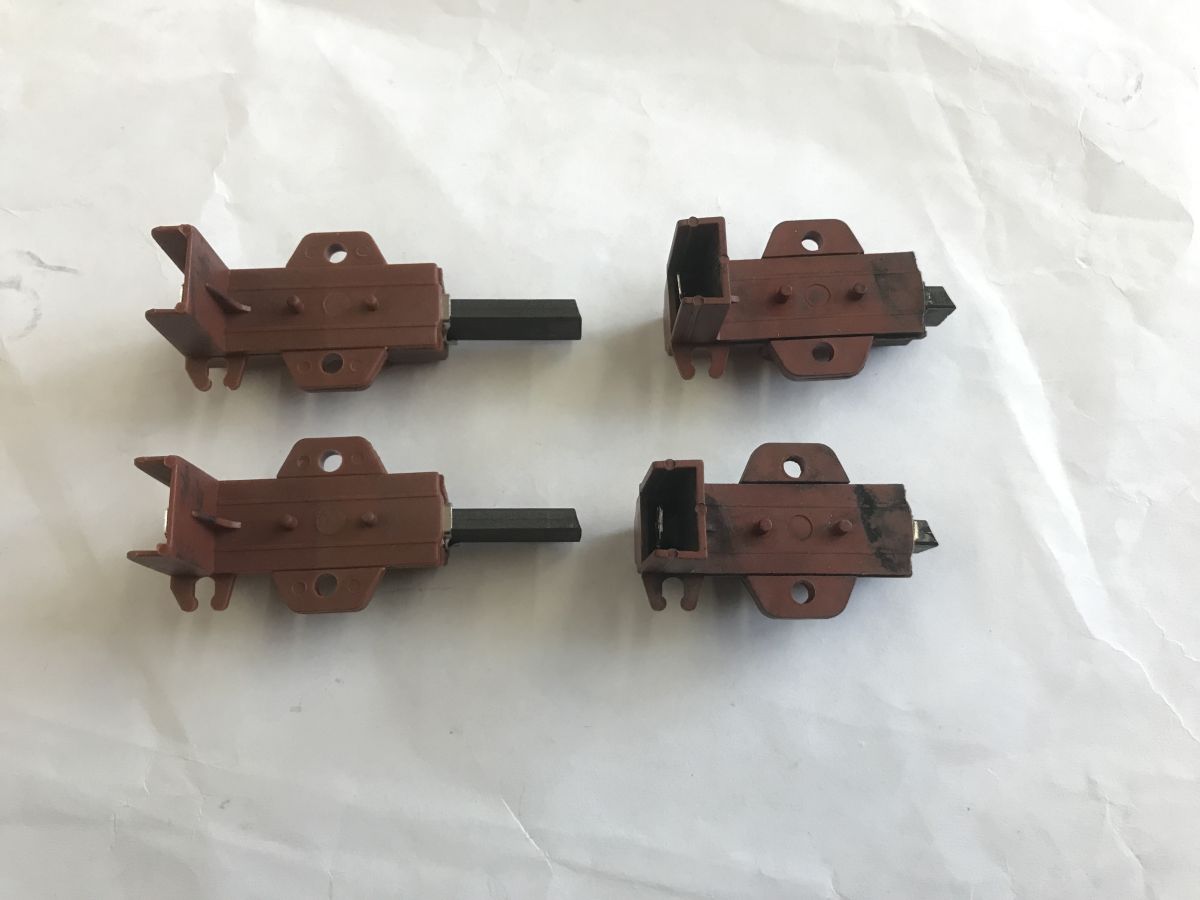

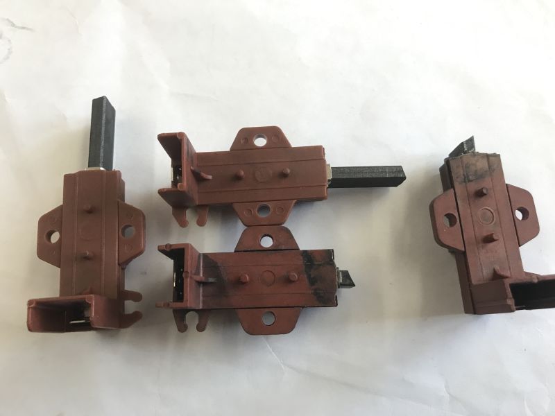

    The brushes appeared to be very worn. Below is a comparison of the new and old ones:
    Four carbon motor brushes for a washing machine, two new and two worn, on a white background
    We managed to order 1:1 matching replacements, with the same shear angle as the original. We paid PLN20 two pieces. In addition, I still cleaned the inside of the dust, although I didn't lapped the brushes themselves as I thought they fitted well. I only checked after assembly to make sure they weren't sparking excessively, and let it spin a few times with an empty drum.

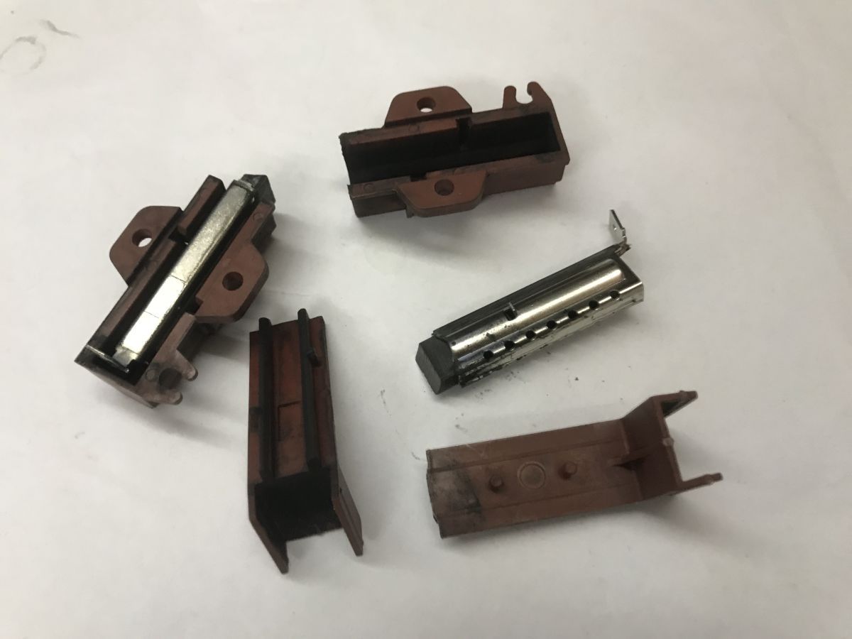

    Comparison of old and new carbon brushes for a washing machine motor
    You can still see how the brush works - there is a spring in the middle, this is what presses it down:
    In summary, the repair was done very late. The washing machine was no longer moving at all, and the unaware owner did not know that the mysterious black dust accumulating under the washing machine was the result of the brushes rubbing off. The brushes were replaced and the washing machine was cleaned, although I did not lapped the brushes themselves. The whole thing has now been running for a month without complaint. Do you also carry out this type of simple repair?

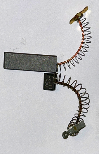

    At my place, the Bosh has eaten so much after 11 years:
    Worn carbon brush with copper wire and spring from a Bosch washing machine

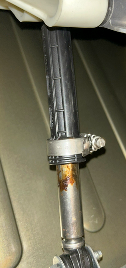

    By the way - because replacing the "shock absorbers" requires taking the drum apart, and it works only with thorns - I have made such a small modification - which allows the "shock absorbers" to be readjusted every two years in 5 minutes.
    Washing machine damper with corrosion and a hose clamp on the rod

    A long time ago on this forum I asked the question why the brushes are seated obliquely despite the engine running both ways, will someone explain???.
  • Motor only spins one way, so brush skew increases slip
    #12 21757602
    cranky
    Level 30  
    Posts: 2208
    Help: 70
    Rate: 415
    I have retreaded 2 rotors of identical hoovers - the pull of the commutator plates did not depend on the blade. Difference in vintage and the resin mentioned.
    klamocik wrote:
    Long ago on this forum I asked the question why the brushes are seated obliquely despite the motor running both ways, will someone explain???.
    The motor does not run in 2 directions. It mixes the laundry in 2 directions. It only spins in one, and the slip is then greater.

    As for the brushes in the washing machine, I have encountered on the forum that in a certain make/model only the original brushes are used, putting on a replacement ends up damaging the motor (different brush material/resistance).
  • Brush angle reduces sparking at high spin speeds
    #14 21757638
    kris8888
    Posts: 7080
    Help: 537
    Rate: 1929
    klamocik wrote:
    Long ago on this forum I asked the question why the brushes are seated obliquely despite the engine running both ways, will someone explain??.
    Probably only relevant at high spinning speeds, which are always one way. To minimise sparking. On the other hand, at normal spins the washing could be seated perpendicularly, and this oblique fixing probably doesn't bother too much at slow spins either.
