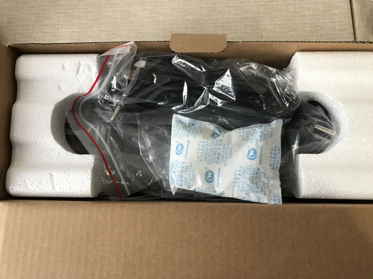

    So let's see what the courier brought.
    Cardboard box for GC PowerProof 600/800 VA UPS with device line drawing and feature list. Label on a Green Cell PowerProof 600 UPS box with specification table and QR codes. Power cable in a plastic bag with a desiccant packet, inside a box with white foam inserts
    The power supply is securely packaged for travel. There is also a moisture absorber inside to keep the whole thing from getting soggy. We also get cables.

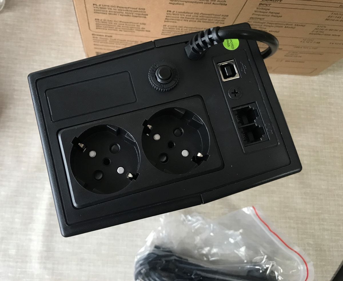

    The power supply has two sockets on the back whose power is backed up. In addition, there is a USB for communication with the computer (with an app), and RJ11 sockets (filter).

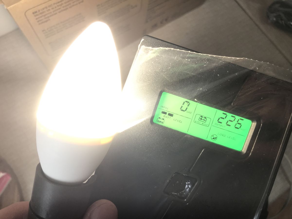

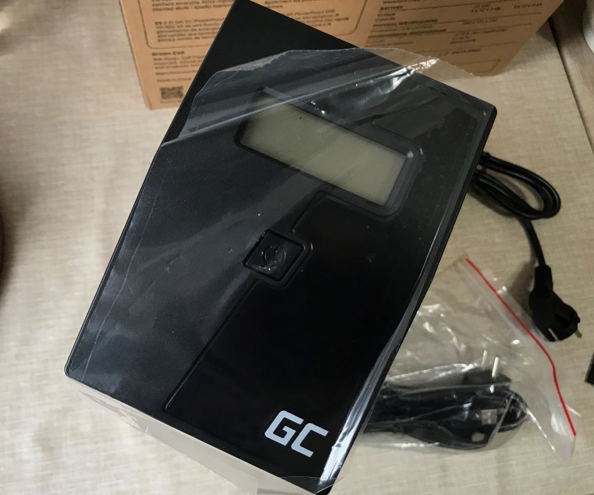

    The first start-up shows that the power supply works and the display is quite clear.
    Close-up of a UPS with a green LCD display and a lit light bulb next to it

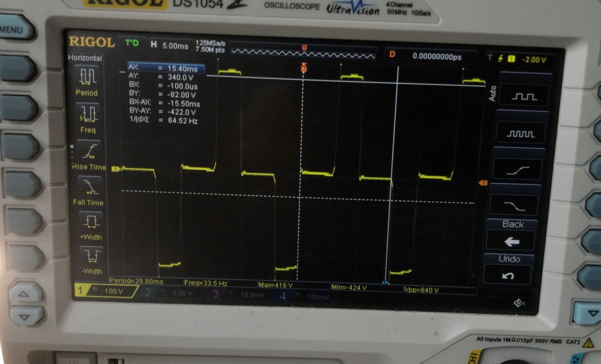

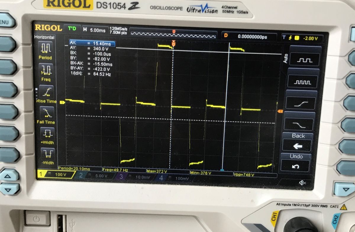

    I started by checking the waveform. Indeed, it is 50 Hz. I also measured under load - the picture shows 30 Hz, but this is probably a measurement error. I'll repeat the test when I get a chance.
    Rigol DS1054Z oscilloscope screen showing a yellow stepped square waveform and frequency readout Rigol oscilloscope screen showing a yellow square-like waveform and measurement readouts.

    Finally went the actual test - computer, monitor, additionally loaded with 20 W incandescent bulbs. 200 watts in total.
    There was no PFC laptop plugged in, so the whole thing held steady for over 3 minutes with a 200 W load. It probably would have lasted a bit more than that too, I only charged the UPS one night, so it may have run a bit short of full.

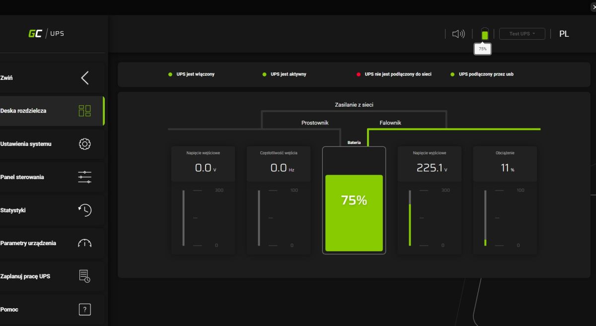

    Application capabilities

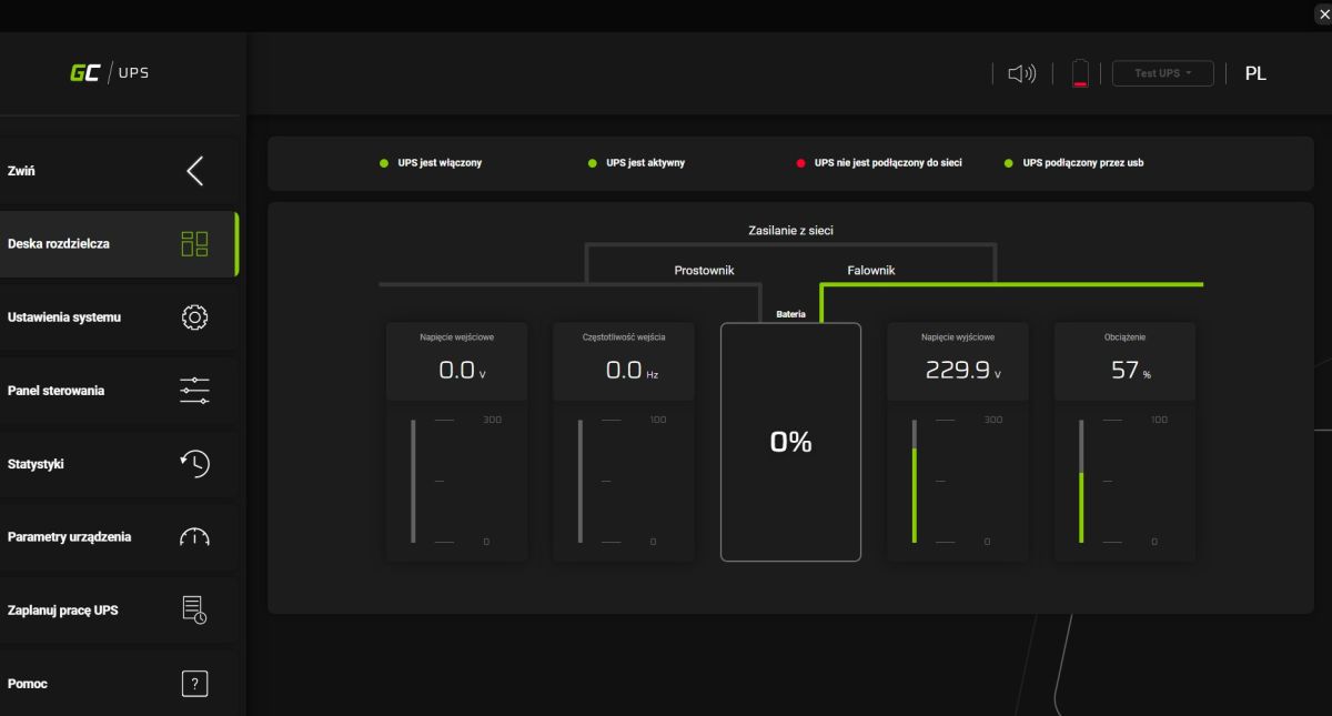

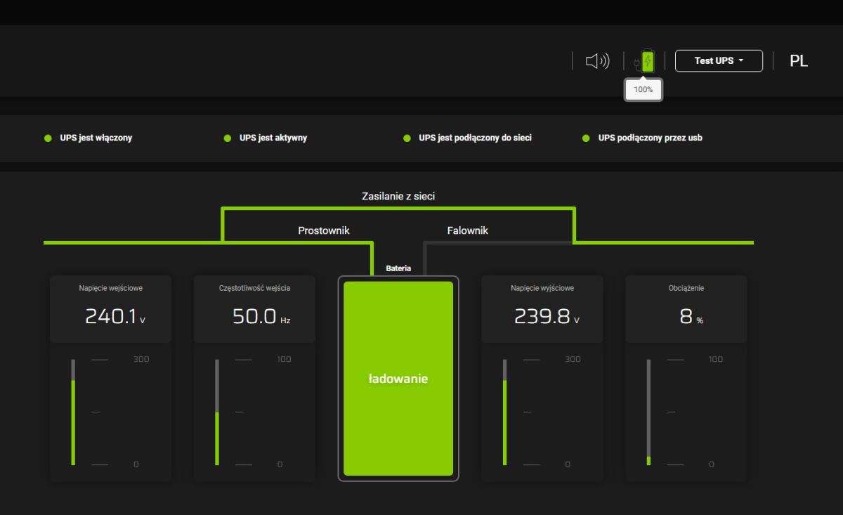

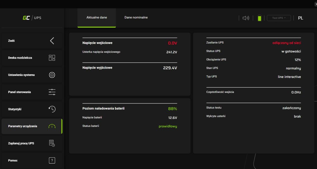

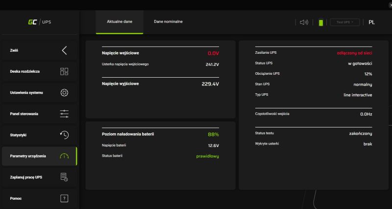

    The UPS is connected to the computer via a USB type B cable and works with the GC UPS application available for free download from the manufacturer's website.
    GC UPS app dashboard screenshot: input 0 V, battery 0%, output 229.9 V, load 57%
    The main panel shows us the voltages (input and output), frequency and load. The load is shown as a percentage, which surprises me somewhat.

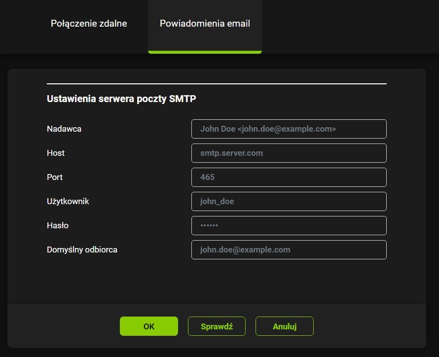

    GC UPS app screenshot showing Remote connection settings and an auto-start toggle

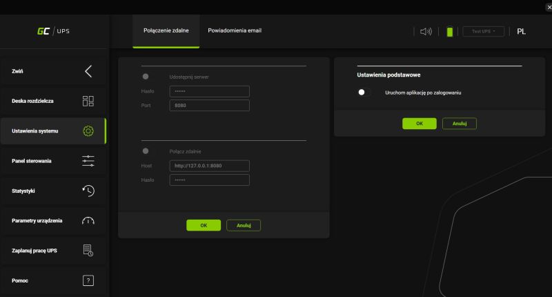

    In the app we have support for remote connection and notifications to email address via SMTP. It can be started automatically after login.
    SMTP mail server settings window in an app, with fields for sender, host, port, user, and password

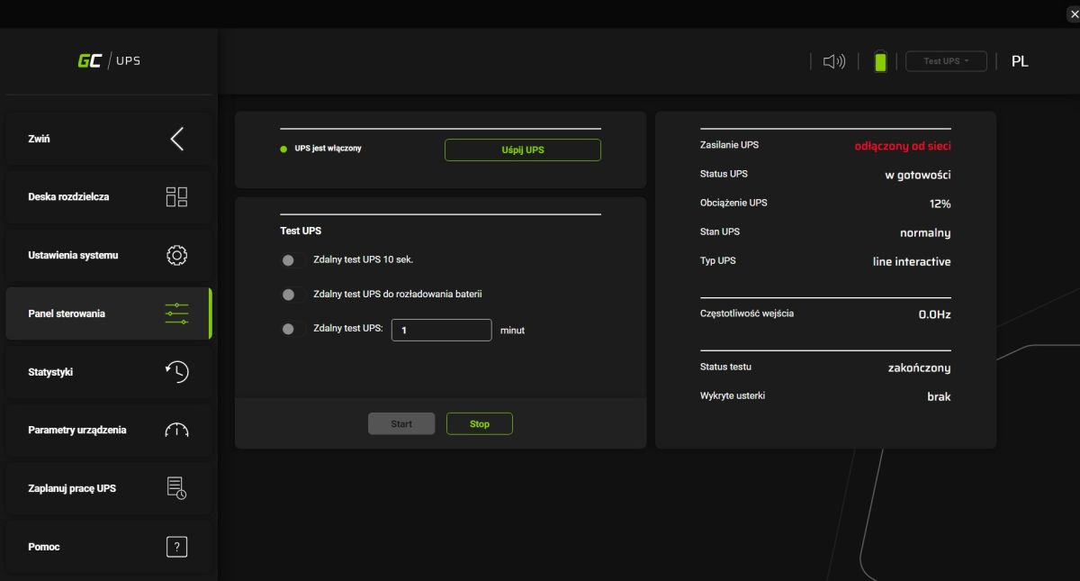

    In the control panel there is more information about the device and the possibility to perform a power supply test. Unfortunately, here too the load is given as a percentage.
    Screenshot of the GC UPS app showing the control panel and UPS test status

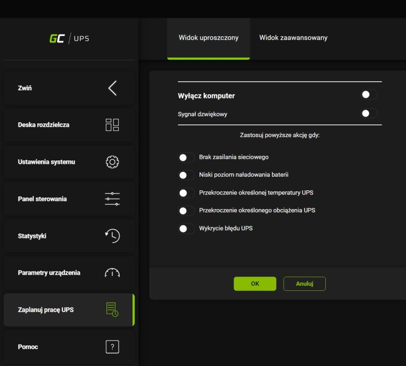

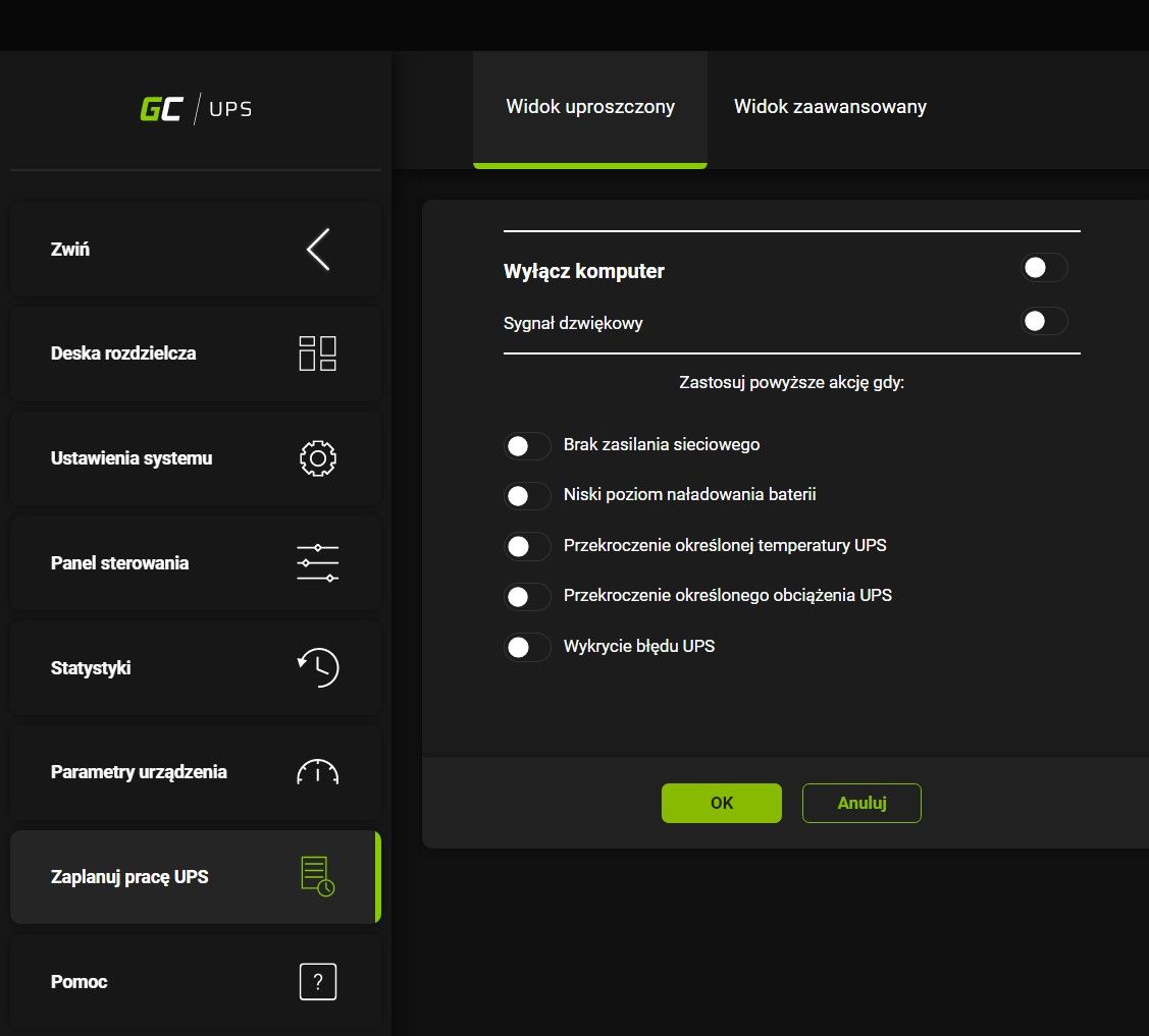

    You can also schedule the UPS and trigger certain actions based on the battery status:
    Screenshot of the GC UPS app showing action settings with toggles, including “Shut down computer”

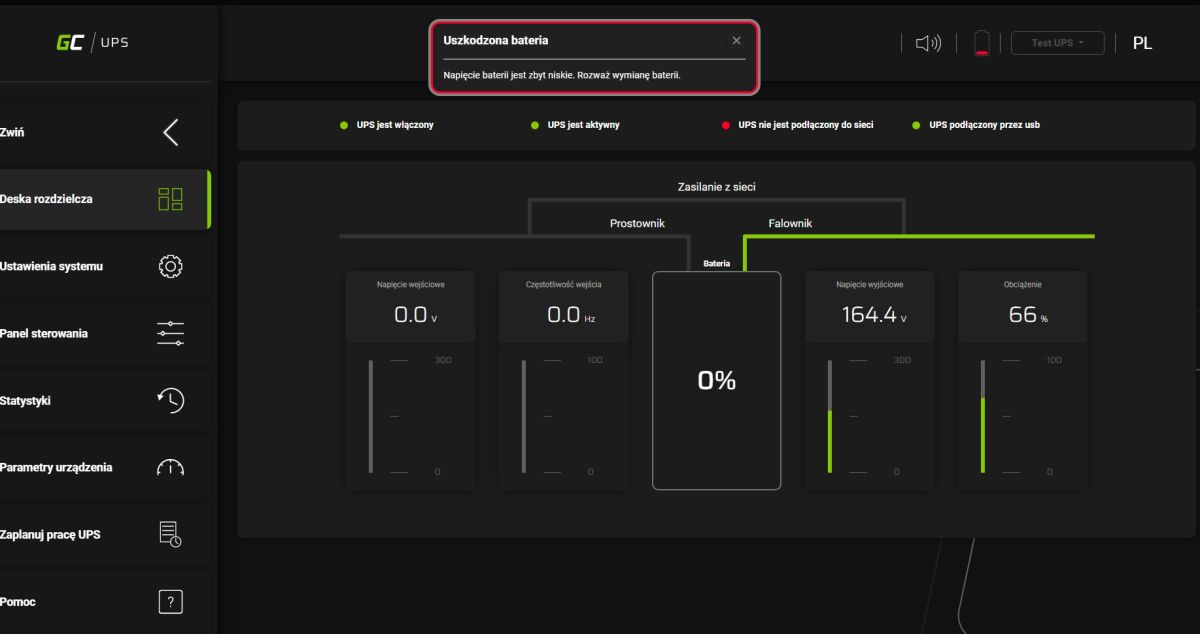

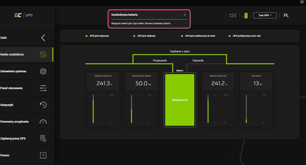

    This charge level is not reliably shown either, here I show screenshots of 5 seconds, the panel changes its mind and first shows "Damaged battery" and then 100%.... i additionally thought that there should be over-discharge (and over-charging) protection so that such a situation could not occur.
    GC UPS app screenshot showing “Damaged battery” alert and dashboard with battery and load readings. GC UPS app dashboard screenshot with “Damaged battery” alert and power parameters. UPS app screenshot: input 240.1 V at 50.0 Hz, battery charging, output 239.8 V, load 8% GC UPS app dashboard showing 75% battery and 225.1 V output voltage GC UPS app dashboard showing 75% battery and 225.1 V output voltage

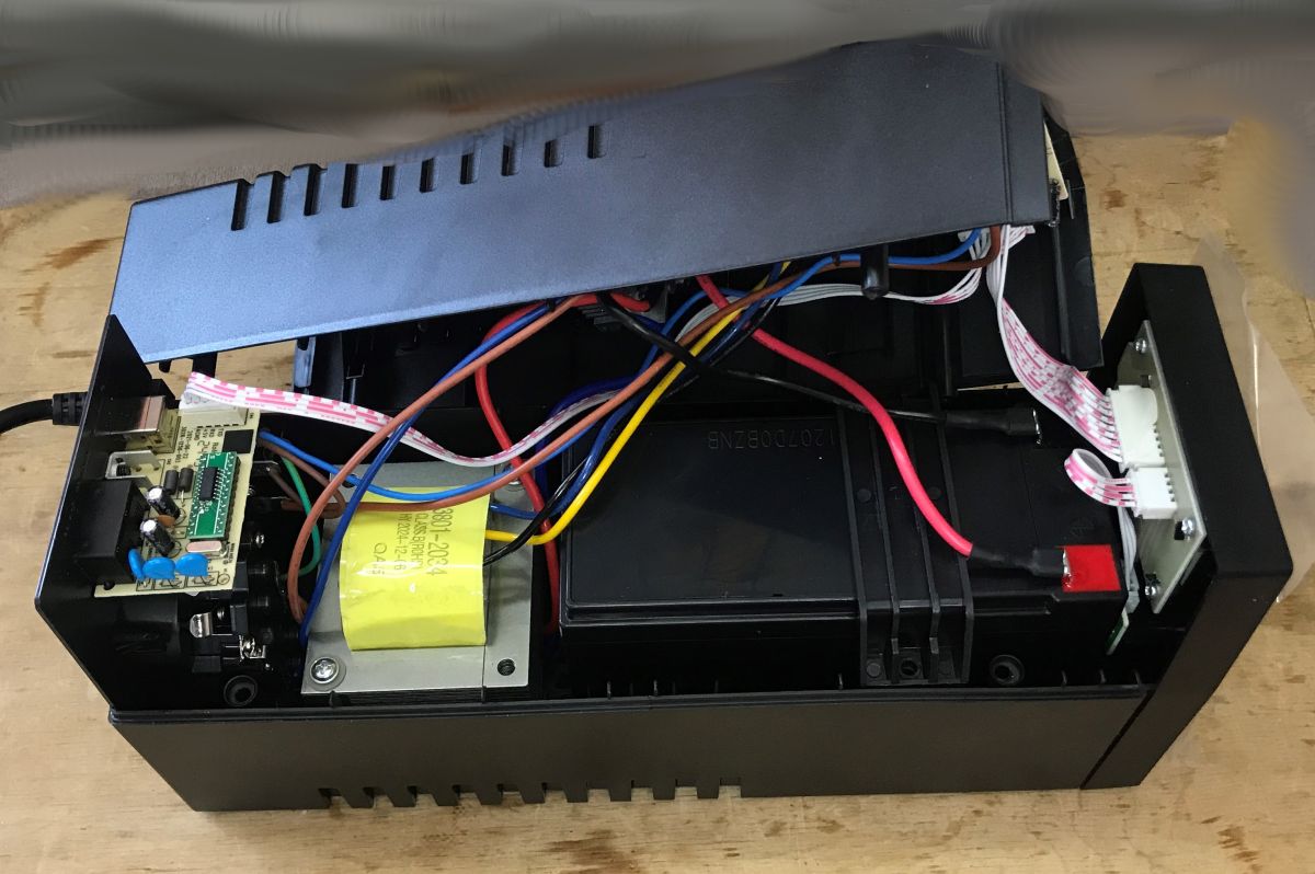

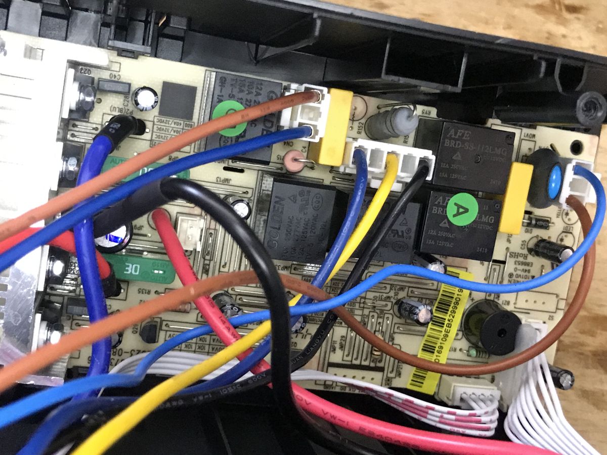

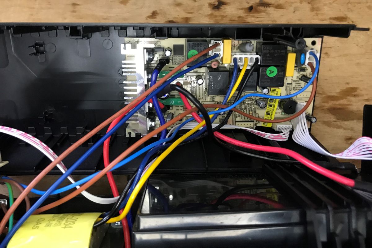

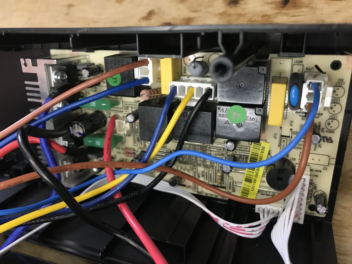

    Interior of power supply
    Brief this time, I didn't want to do excessive disassembly. The whole thing is based around a 50Hz mains transformer, relays to switch from charge to power and an inverter.
    Inside an open UPS case showing battery, transformer, wiring, and small circuit board Inside a UPS: PCB with wiring and a battery in a black housing Inside a UPS: circuit board with relays, capacitors, and many colorful wires connected to white plugs Inside a UPS: PCB with relays, connectors, and multicolored wiring Inside a UPS: PCB with relays, connectors, and multicolored wiring
    Anyway, we already have a detailed description on the Elektroda channel:

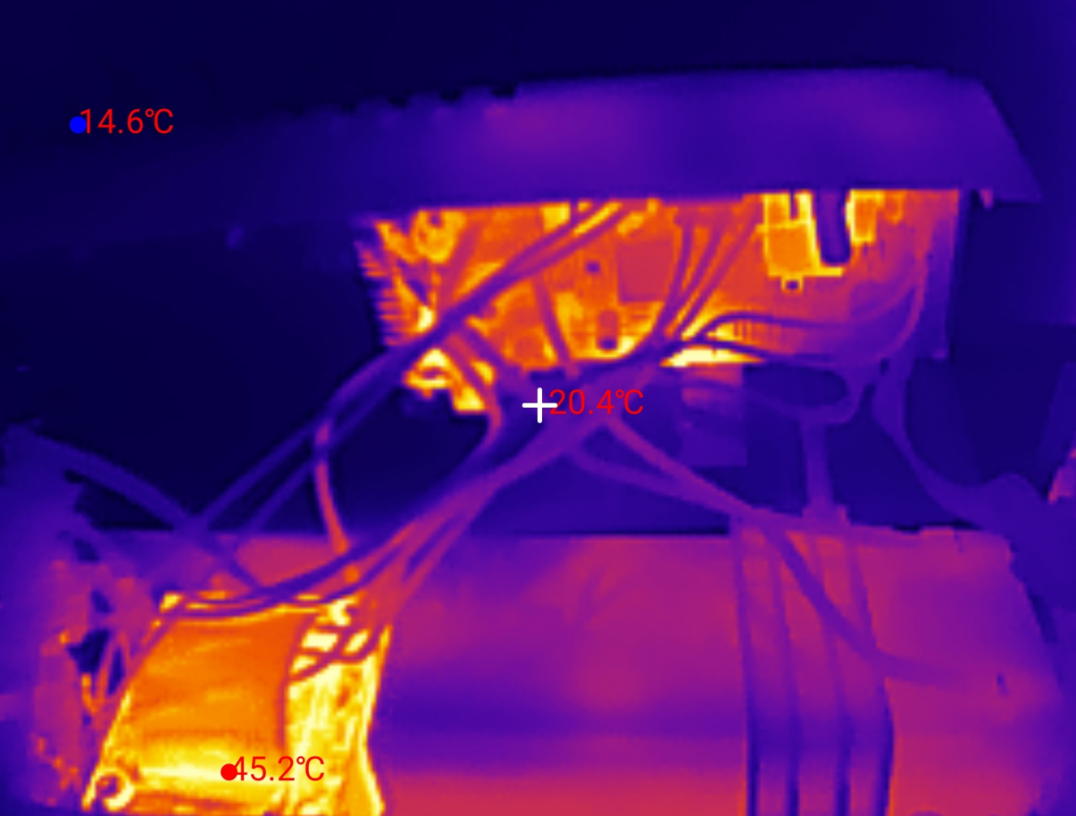

    Heat-up tests
    What heats up the most on the board, does the power supply overheat? Checked with
    InfiRay P2 PRO , for two load levels.

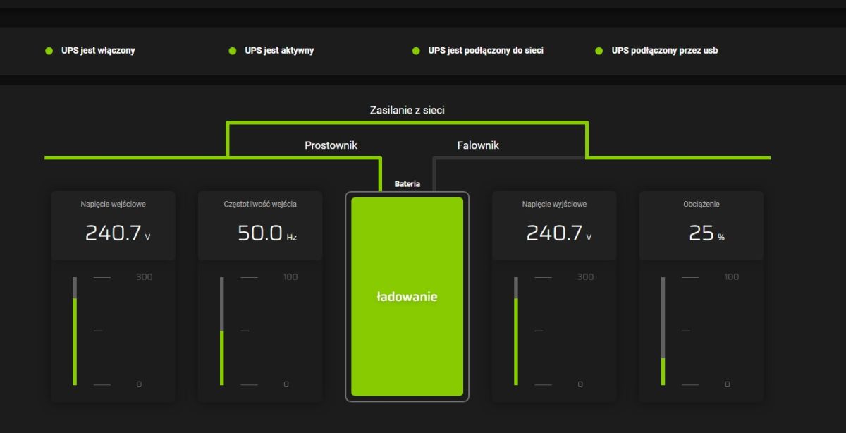

    Heating test - 60W load:
    UPS app screenshot with power-flow diagram, battery charging, and readings 240.7 V and 50.0 Hz Thermal view inside a UPS with cables; hottest spot around 45.2°C Thermal image of a device interior with a transformer and temperature readouts 16.4°C, 34.4°C, 53.5°C
    At 60 W it is acceptable, the transformer heats up a lot, up to 60 °C after a minute, the shunt resistor on the board also heats up, no excessive heating of the transistors can be seen.

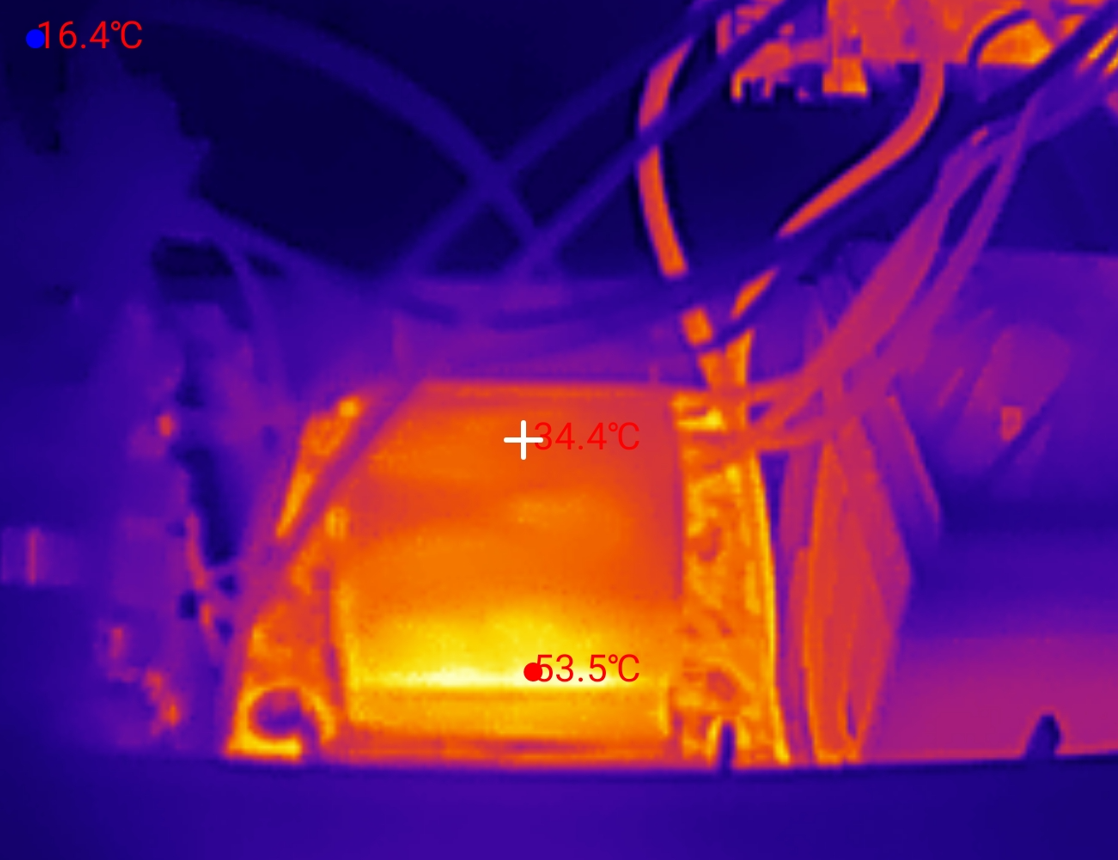

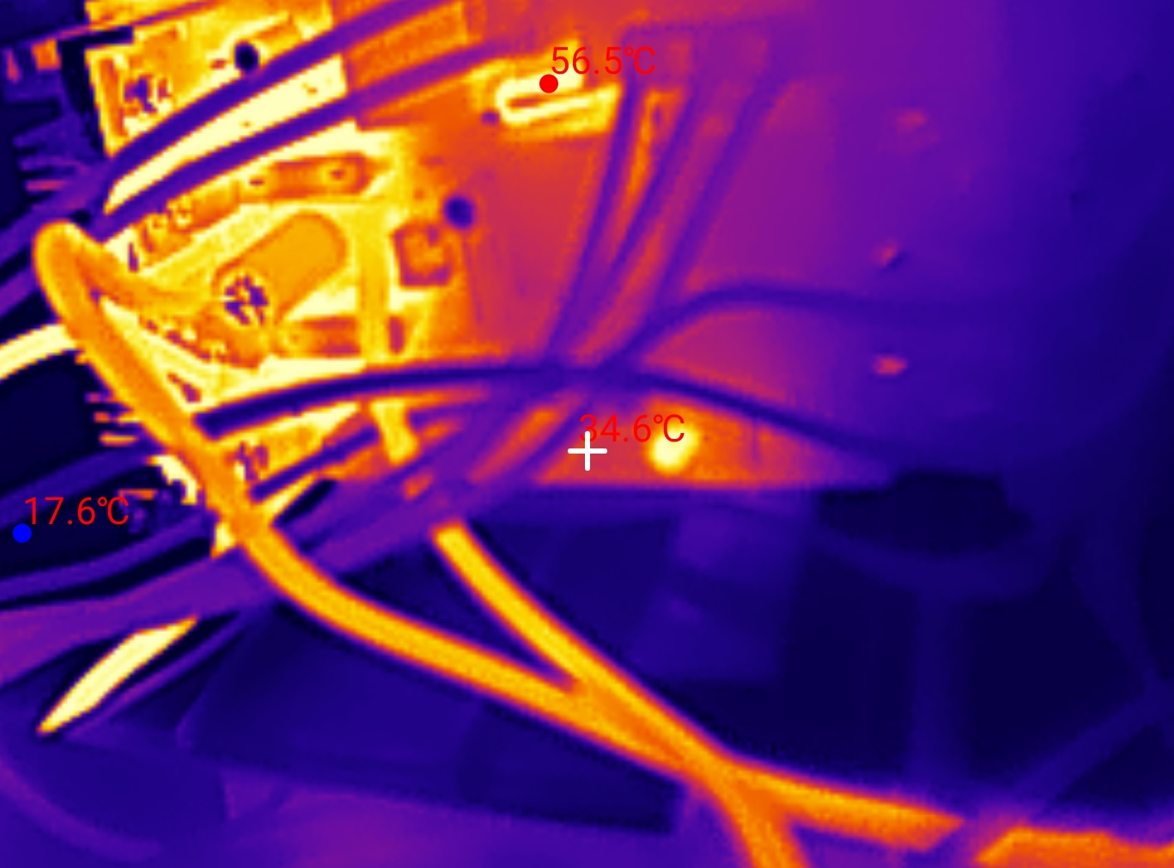

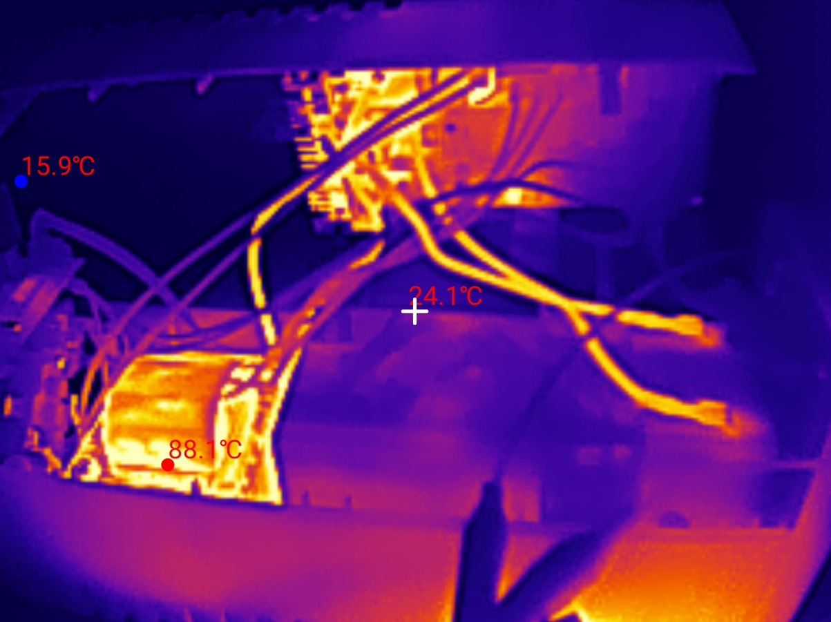

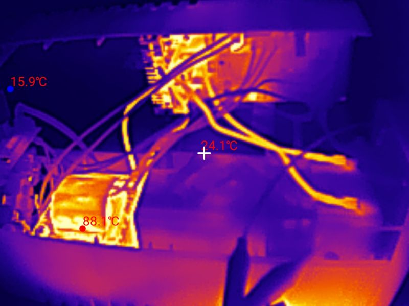

    Now 180 W:
    Thermal image inside a UPS: transformer at 88.1°C, measurement point at 24.1°C
    Here, unfortunately, it is worse, the transformer heats up to 100 °C, there is a characteristic smell of overheated electronics.
    Thermal image of device interior with wires and PCB, markers show 56.5°C, 34.6°C and 17.6°C
    The shunt resistor and the transistor section are also heating up, to around 60 °C.

    Additionally, I am thrown by the unreliable readings from the app.

    - already at less than 200 W load the transformer heats up almost to 100 °C, even though nominally this UPS has 360 W
    - the dedicated app cannot meaningfully determine the % of battery charge, it literally manages to show "battery voltage too low, consider replacing" and 5 seconds after connecting the power supply "100% charge", and this on a brand new configuration

    I was also surprised by this frequency change, I already presented an old UPS on the forum once and when I compared the oscillograms for the loads there, only the voltage dropped. In this thread it is, at the end:
    Interior of an old computer UPS, running as a solar inverter
  • Transformer doubles as charger and idle heat source

    In this UPS, the output transformer is both a power transformer and a battery charging transformer.
    I suggest you do a test with two wattmeters, or at least one with the UPS running at idle (no load).
    I know from experience that transformers with the UPS plugged in 24/7 can heat up quite a bit, which means wasted electricity.
    In addition, the transformer is close to the lead-acid battery, which negatively affects its durability.
    In the old APCs, which had a separate transformer for power and charging, this problem was not noticeable. The UPS itself drew a few watts depending on the battery charge.
  • Rigol scope likely misread the 15 ms period
    #5 21864885
    zgierzman
    Posts: 1787
    Help: 108
    Rate: 1573
    >>21864858
    Maybe it's an oscilloscope error, because the cursors (although set incorrectly) show the same thing - about 15 ms. You can't see the scale in the second photo, but it looks like the period is about 20 ms (four bars) in both photos. If the period were to be 30 ms, there would be six grids, even a blind person would notice without a scale.
    The run is jagged, it's Rigol that got lost, the cursors are more reliable.

    In the inverter, the output frequency has no way of changing.
    The change in frequency is due to an incorrect oscilloscope measurement (automatic measurement and cursors). The cursors are misaligned and do not cover the entire period of the waveform.

    UPS is cool, but the app gives a mega bummer. It's terribly resource intensive, can take up over 2gb of ram and up to 30% of CPU resources. A bit much for a background application.
    Windows Task Manager snippet showing “gcups (4)” using about 23.9% CPU and 2822.4 MB RAM
    bdw, maybe you guys can suggest how to de-gear it.

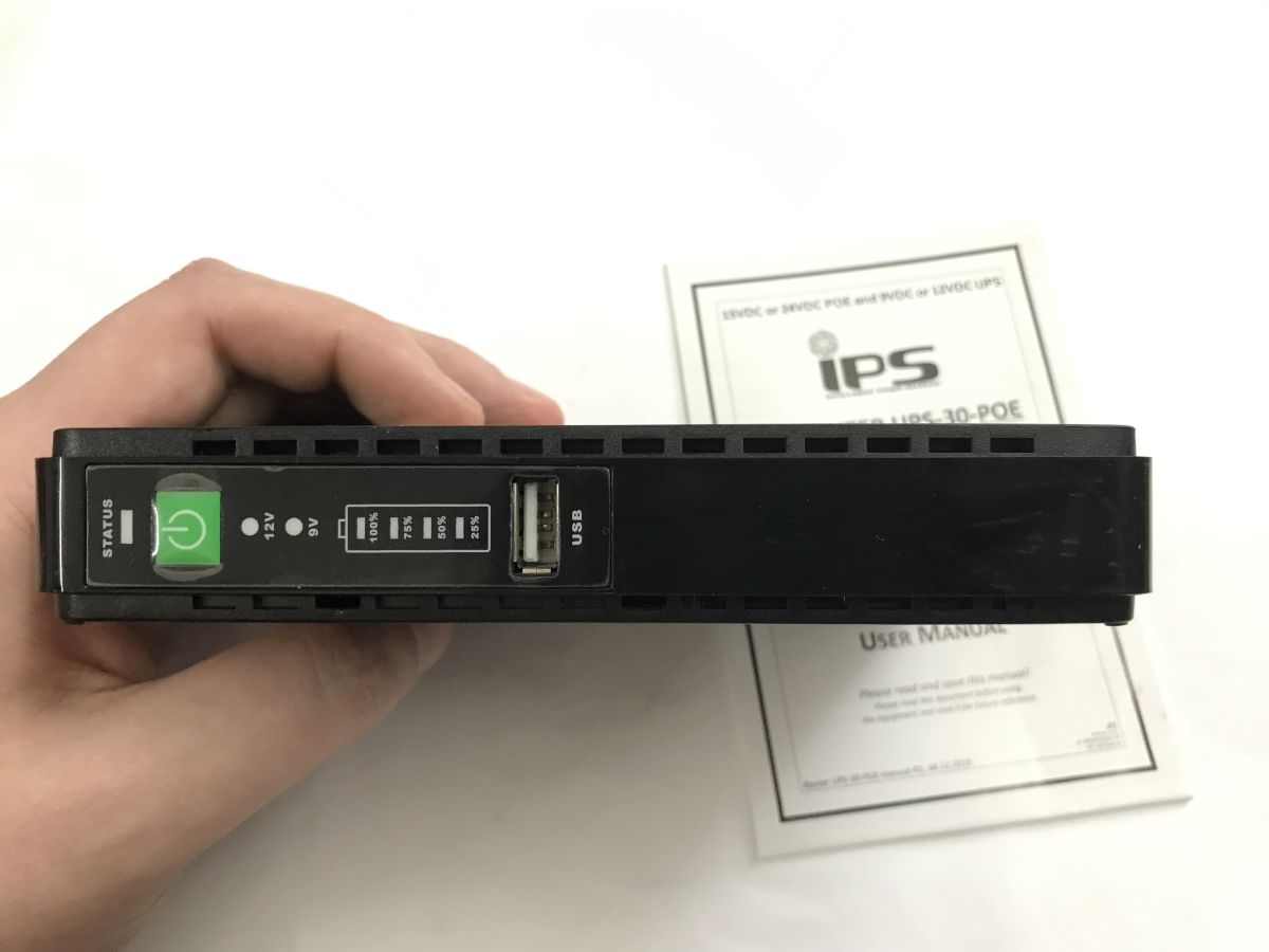

    As for power backup, I've still been testing something like this - a low voltage DC UPS under a router and a Raspberry for example. Details will be in a separate topic.

  • Battery charge estimation is unreliable in cheap UPS units
    #9 21865225
    puchalak
    Level 20  
    Posts: 1352
    Help: 12
    Rate: 229
    ...- the dedicated app cannot meaningfully determine the % charge of the battery, literally manages to show "battery voltage too low, consider replacing" and 5 seconds after powering up "100% charge", and this on a brand new configuration...
    Generally, it is very difficult to determine the charge of this type of battery, in this type of device, especially since, in fact, by the charge level, one expects to know how long the ups will sustain power at a given load. And it usually ends the same way - after a few years of blissful certainty that we have emergency power, in the "w" hour the ups runs on battery for 15 seconds, or sometimes not at all.
    I remember the old, very expensive ups, probably APC smart series, which once in a while carried out battle tests on the battery, updating themselves with information about its wear and tear and the expected duration of operation. The problem was with replacing them, because some kind of memory erase procedure had to be carried out afterwards.

    my subjective impression was that when a brand new unit (bought to plug in a small business) alternately shows "100% charge" and "consider replacing" then there is probably something wrong
    This is reminiscent of the situation found in mobile phones.
    By this I mean shutting down at the moment of higher load, despite even a fairly high percentage charge level presented on the camera display.
    It is a question of too much internal resistance of the battery, and this can occur quite independently of the correct capacity.
    The device presented is made with an emphasis on a low end price, so a poor quality battery may be present here.
    In my opinion, it would be worth repeating this check after installing a different and certainly working battery.

TL;DR: At a 200 W load, this budget UPS kept a PC and monitor alive for over 3 minutes, but one expert warning sums it up: "modified sine wave" models can misbehave with APFC loads. This FAQ helps PC buyers judge whether a low-cost UPS is good enough for safe shutdown, USB monitoring, and short outage survival. [#21864295]

  • The manufacturer app can show input/output voltage, frequency, load, battery voltage, schedules, and email alerts, but users reported false battery-state readings and even over 2 GB RAM usage with up to 30% CPU. [#21865154]

Why does a cheap UPS with an approximated sine wave have trouble with devices that use active PFC, such as some laptop chargers?
The rectangular output can upset the input stage of active-PFC chargers. One forum reply stated bluntly that with this waveform, “APFC in SMPS goes crazy,” and the author reproduced that behavior with a gaming laptop PSU. In practice, the UPS looked stable with a desktop setup, then became erratic when the APFC laptop charger was added. [#21864797]
How can you check whether a UPS output frequency reading is a real problem or just an oscilloscope measurement error?
Check the waveform period manually before trusting the oscilloscope’s auto-readout. 1. Compare cursor spacing to one full cycle. 2. Count grid divisions for a 20 ms, 50 Hz period. 3. Repeat the test under load and verify the scale. In this thread, a reply argued the apparent 30 Hz reading was a Rigol measurement error because the cursors still indicated about 15 ms and the visible period still looked near 20 ms. [#21864885]

How do you connect a GC UPS to a computer over USB and use the manufacturer app to monitor voltage, frequency, load, and battery status?
You connect it with a USB Type-B cable and use the GC UPS application. 1. Plug the UPS into the PC over USB. 2. Install the free manufacturer app. 3. Open the main panel to read input/output voltage, frequency, load percentage, and battery voltage. The thread also shows options for email alerts by SMTP, scheduled actions, remote connection, and a built-in power-supply test. [#21864295]
What causes a UPS app to show 'damaged battery' and then '100% charge' a few seconds later on a brand new lead-acid battery setup?
The app is likely inferring battery state badly from voltage alone. Forum users explained that charge estimation in a simple lead-acid UPS is hard, especially when users really want remaining runtime, not open-circuit voltage. Another reply added that high internal resistance in a low-quality battery can also confuse status reporting even when nominal capacity looks acceptable. [#21865430]
How can you reduce the GC UPS application's very high RAM and CPU usage, or replace it with a lighter monitoring alternative?
This thread does not give a confirmed fix, but it does identify the failure clearly: the app can consume over 2 GB RAM and up to 30% CPU. The only practical alternatives mentioned were to look for an open-source replacement or create one after checking whether the UPS communicates over USB HID. No lighter official setting or workaround was provided in the discussion. [#21865160]
