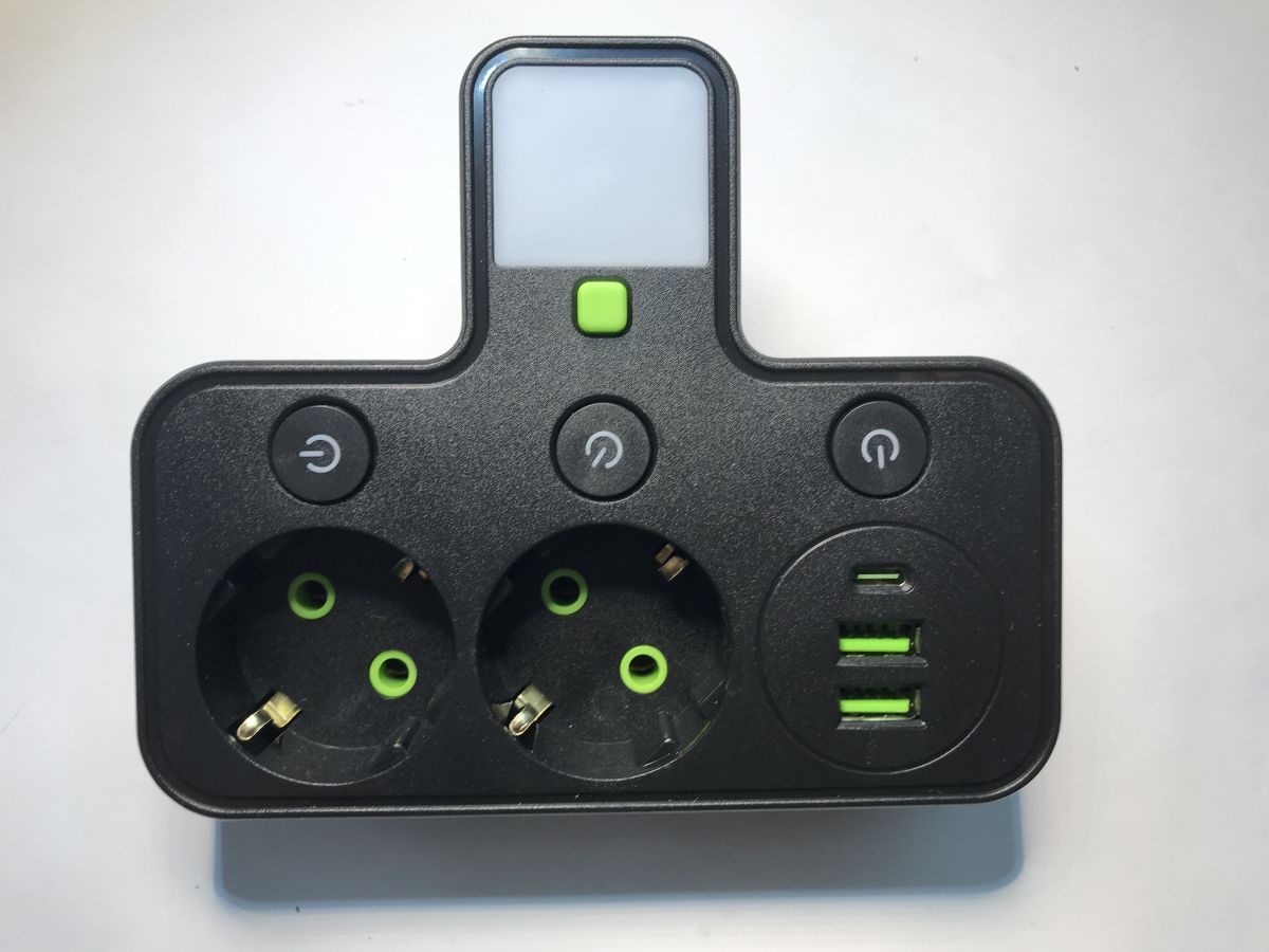

  • A SmartLED 8150 socket splitter from Smart/Tomic promises two 230 V sockets, three USB ports, and a lamp for PLN25.
  • Inside, the Schuko earth path is missing: continuity testing found no PE wiring, and the ground plate seems disconnected from the plug.
  • The USB supply uses a simple PSR flyback on a PL3378 IC with integrated switch, while the USB-C output stays at 5 V and 2.1 A.
  • The unit drew 2 A in testing, but the grounding is only for show, so it is judged a dangerous product.

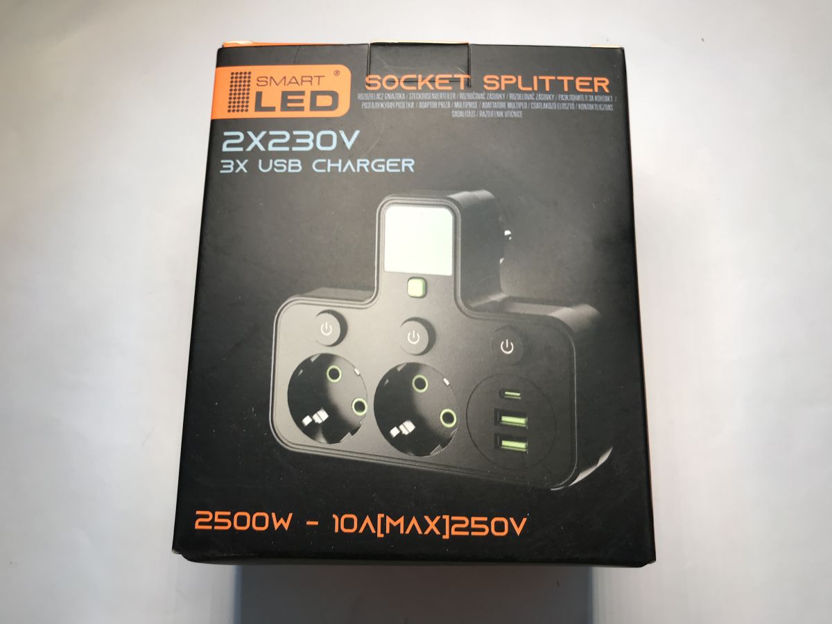

    The distinctive orange and black box immediately caught my eye, but I was only convinced by the manufacturer information - Smart from Tomic (according to the packaging). The price isn't so bad either, just PLN25, so it's probably worth a try. It would be a pity if it turned out again that this product does not have a ground connection....
    Package of Smart LED “Socket Splitter” with 2×230V outlets and a 3× USB charger.
    The distributor offers two 230 V sockets and 3 USB sockets, including one C socket. In addition, it has a light. The packaging lists the model name (SmartLED 8150) and the parameters of the sockets, although I am puzzled by the description of the USB 'charger' - only 5 V and 2.1 A. Does this also apply to this C socket? Is there no quick charge, a standard that supports higher voltages? However, let's not judge in advance. The main thing is that in big letters there is text about the manufacturer from Tomic.
    Orange-and-black “Socket Splitter” package showing specs table and index number 8150
    Orange Smart LED package with device icons and the text “INDEX: 8150”. Orange-and-black SMART LED box labeled “Socket Splitter” with “2x230V” and “3x USB Charger”

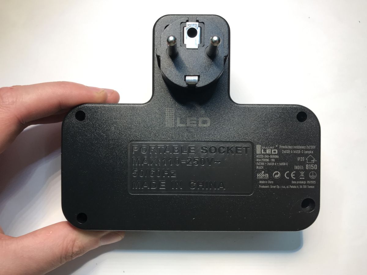

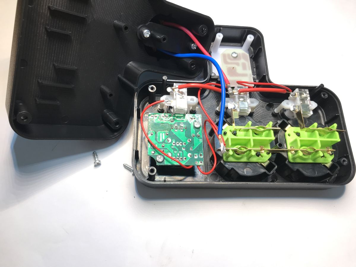

    We take a look inside and this is where the first crush occurs. It wasn't on the packaging, but on the product itself it says "Made in China". Just below it next to it is information about the manufacturer from Tomic. Am I clinging, or is this information somewhat in conflict? Perhaps they meant "importer"? Would a typical non-technical person, after reading the information from the packaging, understand that this is Chinese equipment, or would they think it was manufactured in Poland?
    Back of a black power adapter with Schuko plug and labels “PORTABLE SOCKET” and “MADE IN CHINA”
    Black power splitter with 2 Schuko sockets, 3 USB ports, and a small LED light with a green button

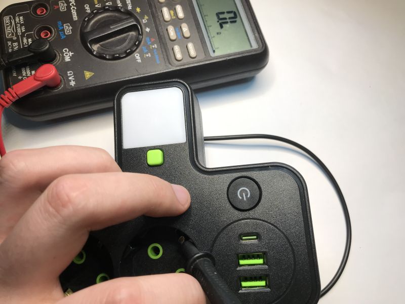

    The sockets are Schuko standard, but as long as the plugs have matching earthing then there is no problem.... Exactly, grounding?
    Hand tests a power splitter with Schuko outlets, three USB ports and an LED light using a multimeter.
    The continuity test shows no earth! Time to look inside and see what's going on there.

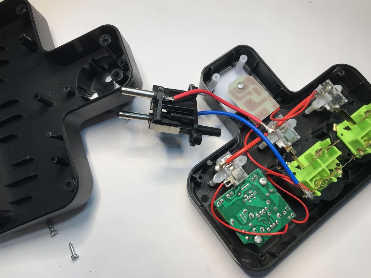

    Opened power strip interior with wires and a PCB; removed cover and screws nearby

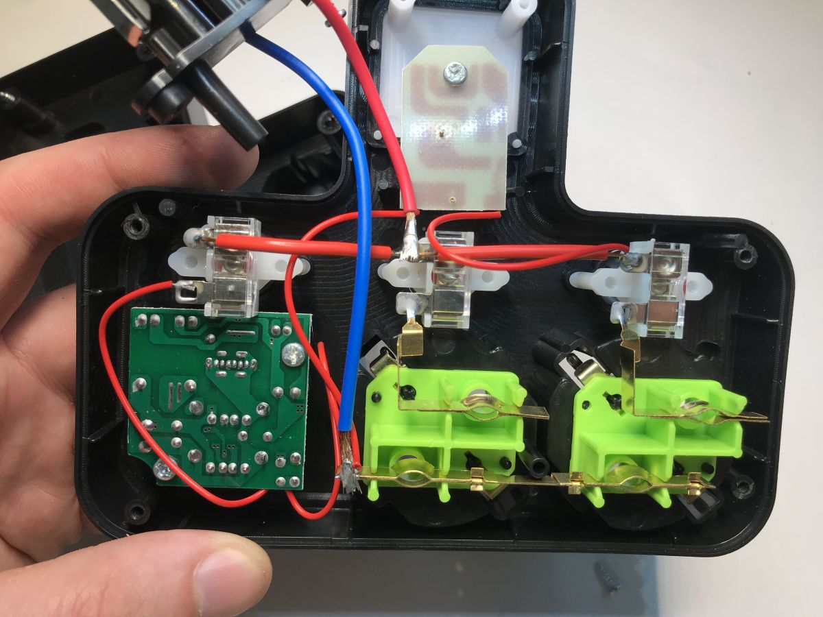

    Deadly product - no earthing, earthing is just for show. You can't see the option of how it could have been pulled.
    Opened power strip showing plug, wiring, contacts, and a small PCB inside a black housing

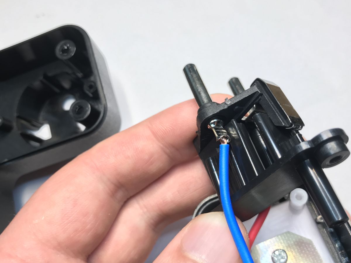

    The diameter of the wires and the ugly solders are not encouraging either:
    Inside a power strip: green PCB, red and blue wires, and two green socket modules in a black housing
    I can't even see a potential connection to the rest of the circuit on the ground plate from the plug:
    Close-up of a disassembled plug with a loose wire and a blue cable held in a hand

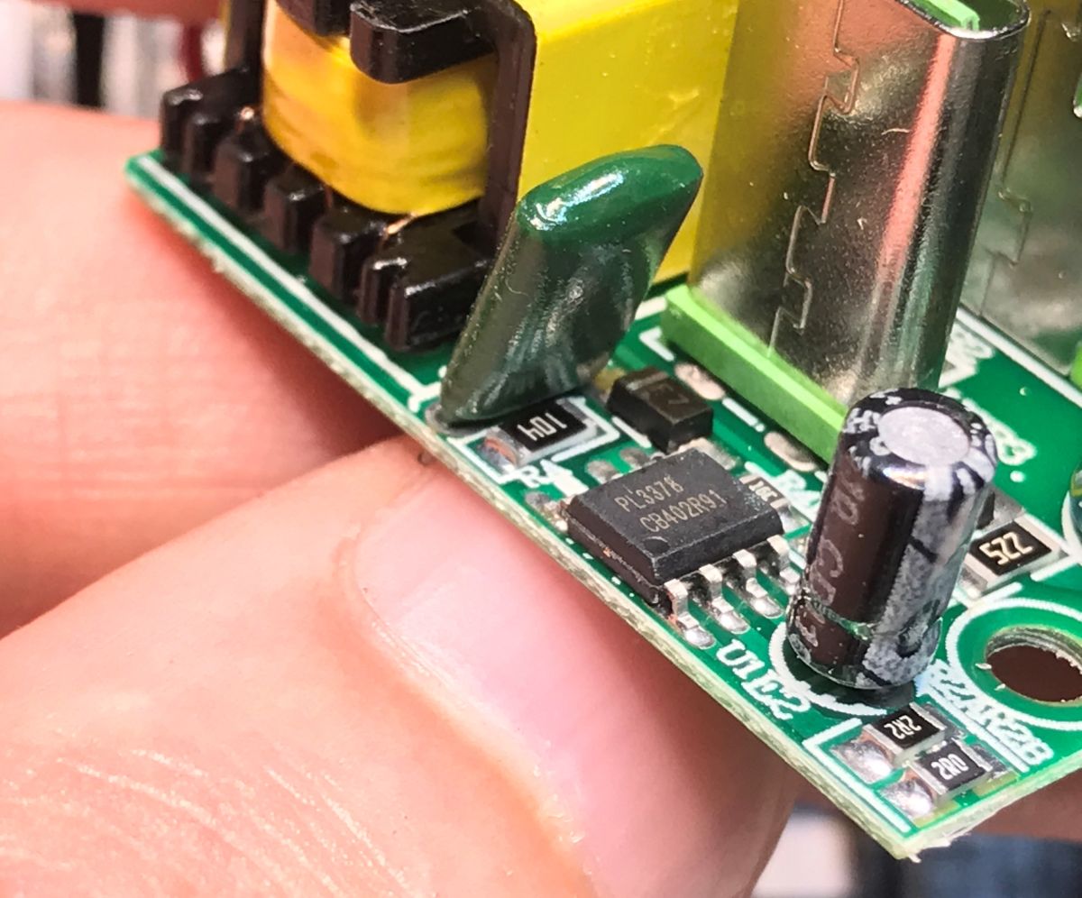

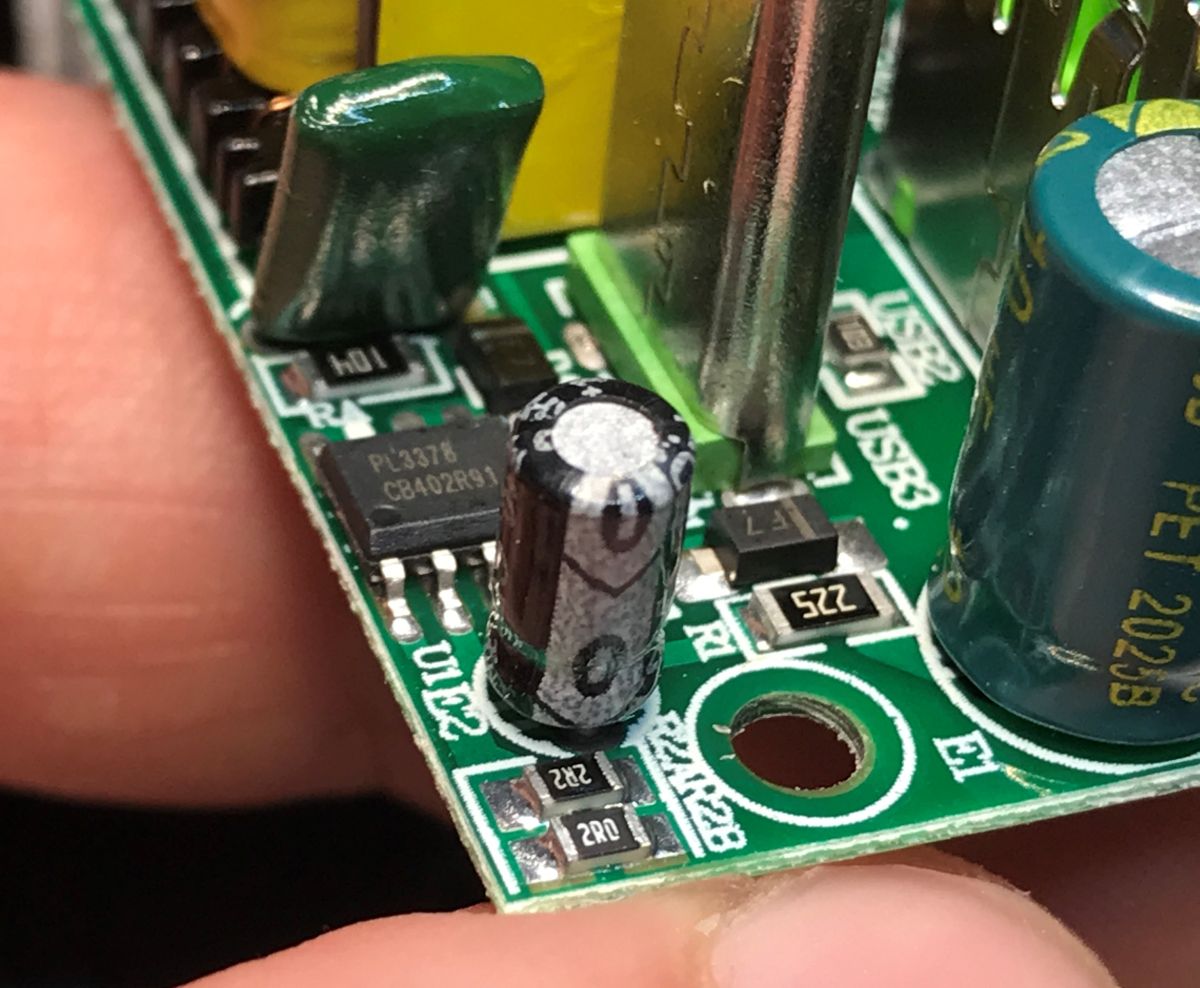

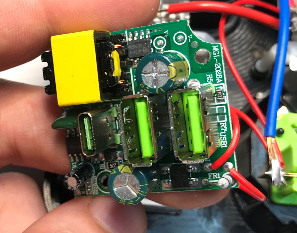

    That leaves the power supply module:
    Power supply PCB with transformer and USB ports: one USB‑C and two USB‑A, held between fingers Close-up of a PCB with capacitors, an SMD component, and wires, held between fingers Close-up of a PCB with transformer, capacitor, and PL3378 IC, held against a finger Close-up of a PCB showing PL3378 IC, capacitors, and “USB5V” marking.

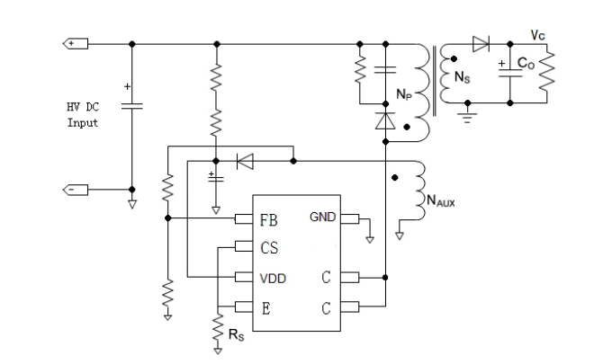

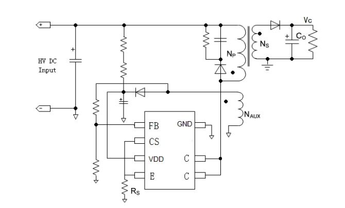

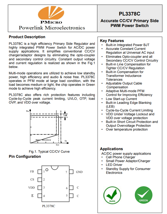

    The power supply is the simplest flyback with feedback taken from the primary side (PSR - Primary Side Regulation). The whole on a single IC with integrated keying transistor - PL3378. Minimum of external components. It also supplies USB C - no chance of a higher voltage supply.
    Datasheet page for PL3378C showing features, applications, CC/CV curve, and pin configuration
    Block diagram of a flyback switching power supply with transformer and primary-side feedback

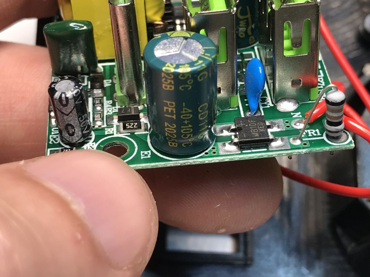

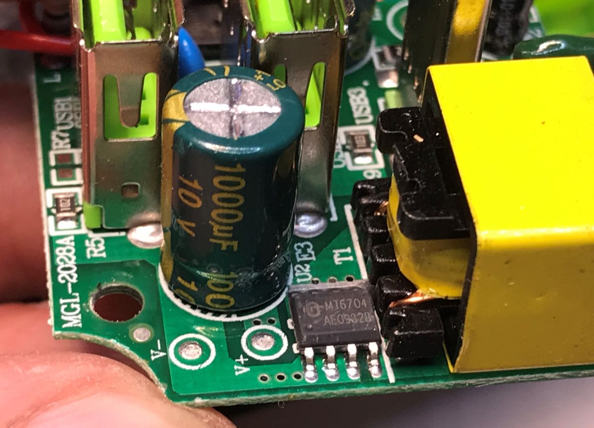

    I guess the only positive aspect is that synchronous rectifier on the secondary side. I'm seeing these more and more. They replace the Schottky diode. Here we have the MT6704.
    Close-up of a PCB showing a large capacitor, yellow transformer, MT6704 IC, and USB port housings

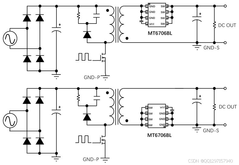

    Example schematic with a similar circuit:
    Two flyback power supply schematics with MT6706BL and DC OUT output

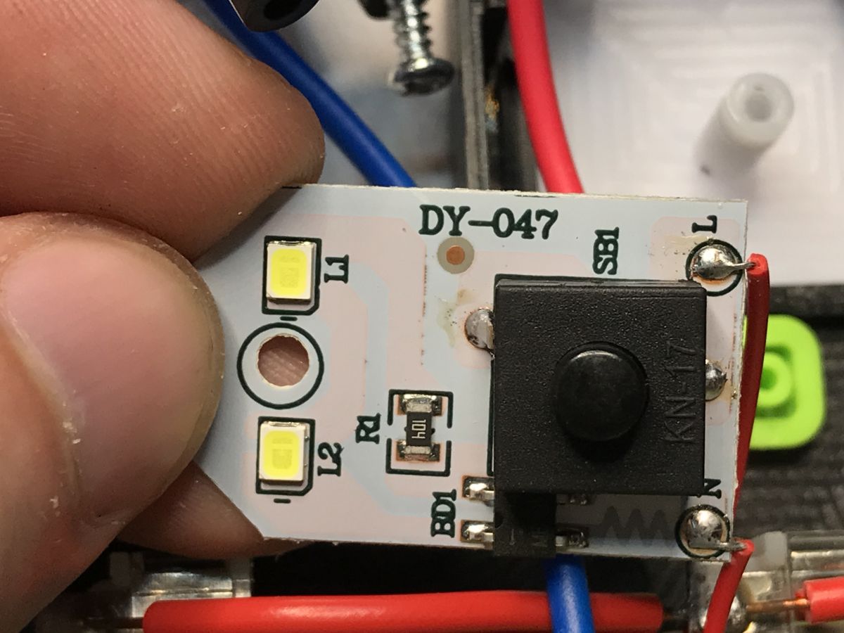

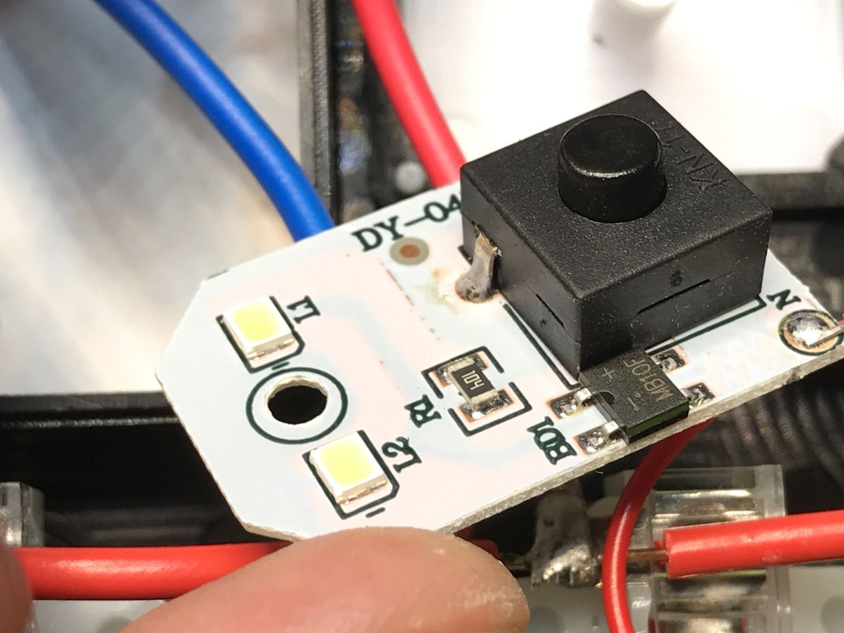

    What's left is the lamp - it's simply the LEDs behind the rectifier bridge and current limiting resistors:
    Close-up of a PCB with two LEDs, a push button, and red and blue wires Close-up of a PCB with two LED chips, a black push button, and “DY-047” marking, held between fingers
    You can even see her flashing on the phone:

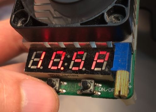

    I also checked the power supply - you can indeed draw up to 2 A.
    Close-up of a PCB module with LED display showing “0.0.0.A” and an ON-OFF button

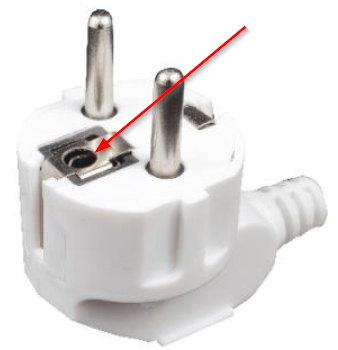

    @Mateusz_konstruktor perhaps I expressed myself awkwardly ;) The point is:
    White power plug with two round pins; a red arrow points to a metal grounding contact
    So a typical Uni-Schuko plug

  • Questionable soldering and switches in splitter design
    #17 21858810
    kris8888
    Posts: 6964
    Help: 532
    Rate: 1898
    speedy9 wrote:
    Judging by the diameter of the wires, I think so. Only the soldering is questionable.
    1mm2 for 10A is enough.
    It's not just that soldering but also those switches that don't inspire confidence.

    "Portable socket" on the case explains that the grounding is also "portable". 😂
    Greetings
