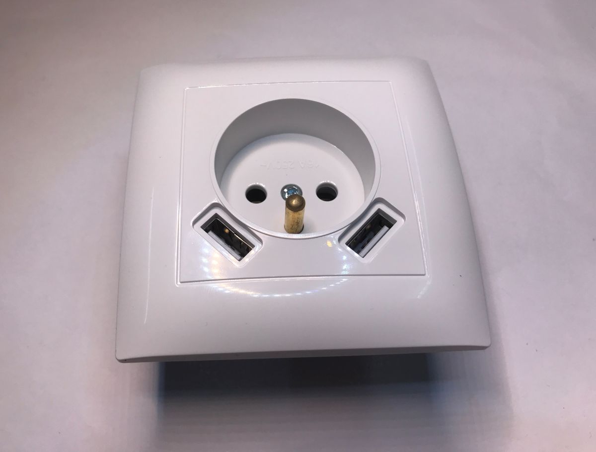

    The LC-13-A is a flush-mounted, single electrical socket with earthing and two additional USB ports for powering/charging mobile devices. Its dimensions (width 8.4x8.4 cm, depth 4 cm) allow it to be easily installed in most fi 60 mm boxes. In this topic, I will test how it is built and investigate how hot it will get when operating under full load. I'll show the results in the form of thermal imaging camera images, so we'll also see which components heat up the most.
    Wesa LC-13-A package: grounded socket with 2× USB, label with barcode

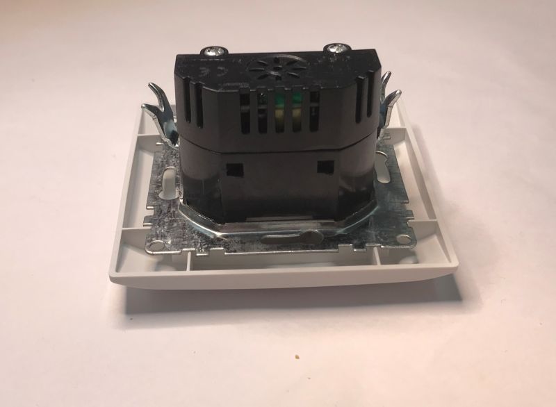

    Indeed, this product is slightly deeper than typical sockets, it is worth checking the box before buying.
    White power outlet with grounding pin and two USB ports angled at the lower sides Rear of an in-wall electrical socket module with black housing and metal mounting frame Side view of an in-wall electrical outlet: white front plate and black housing with a metal mounting bracket

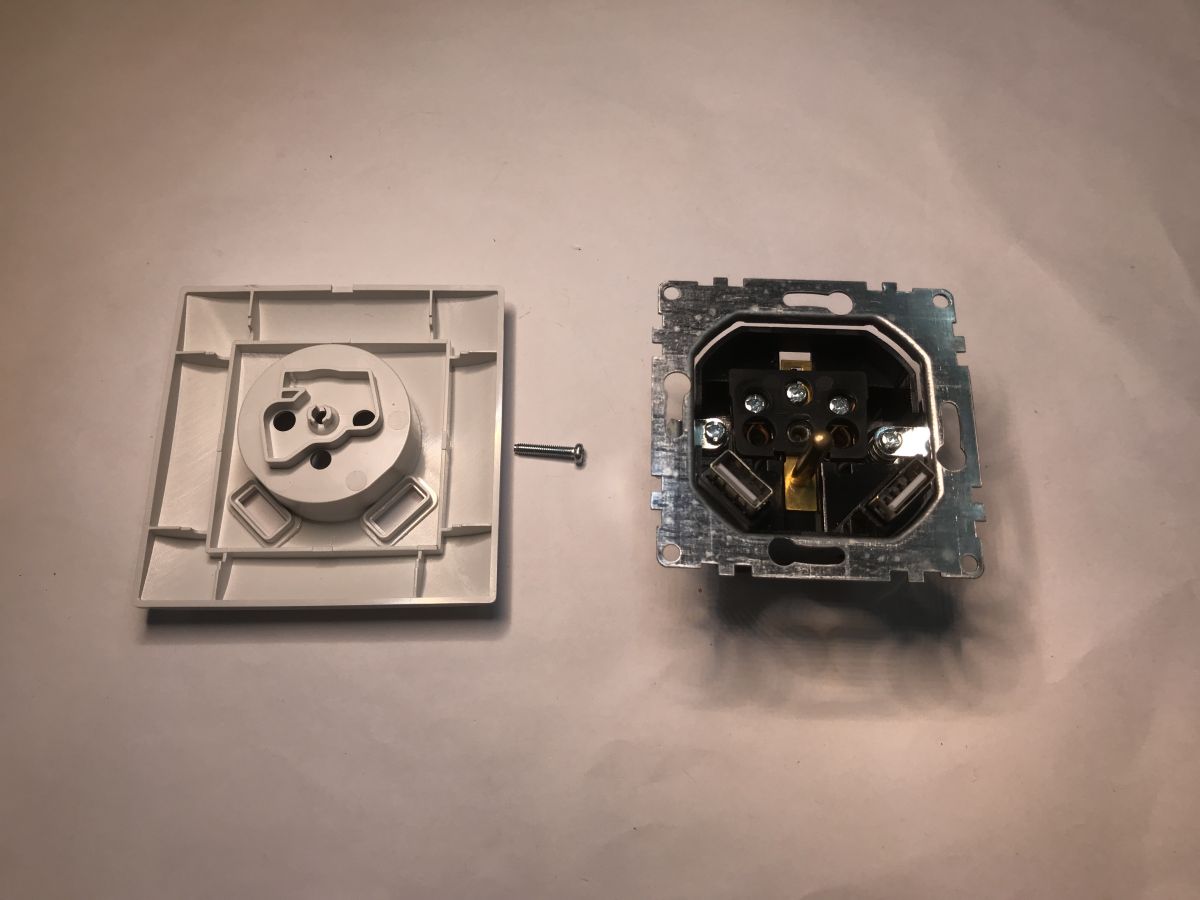

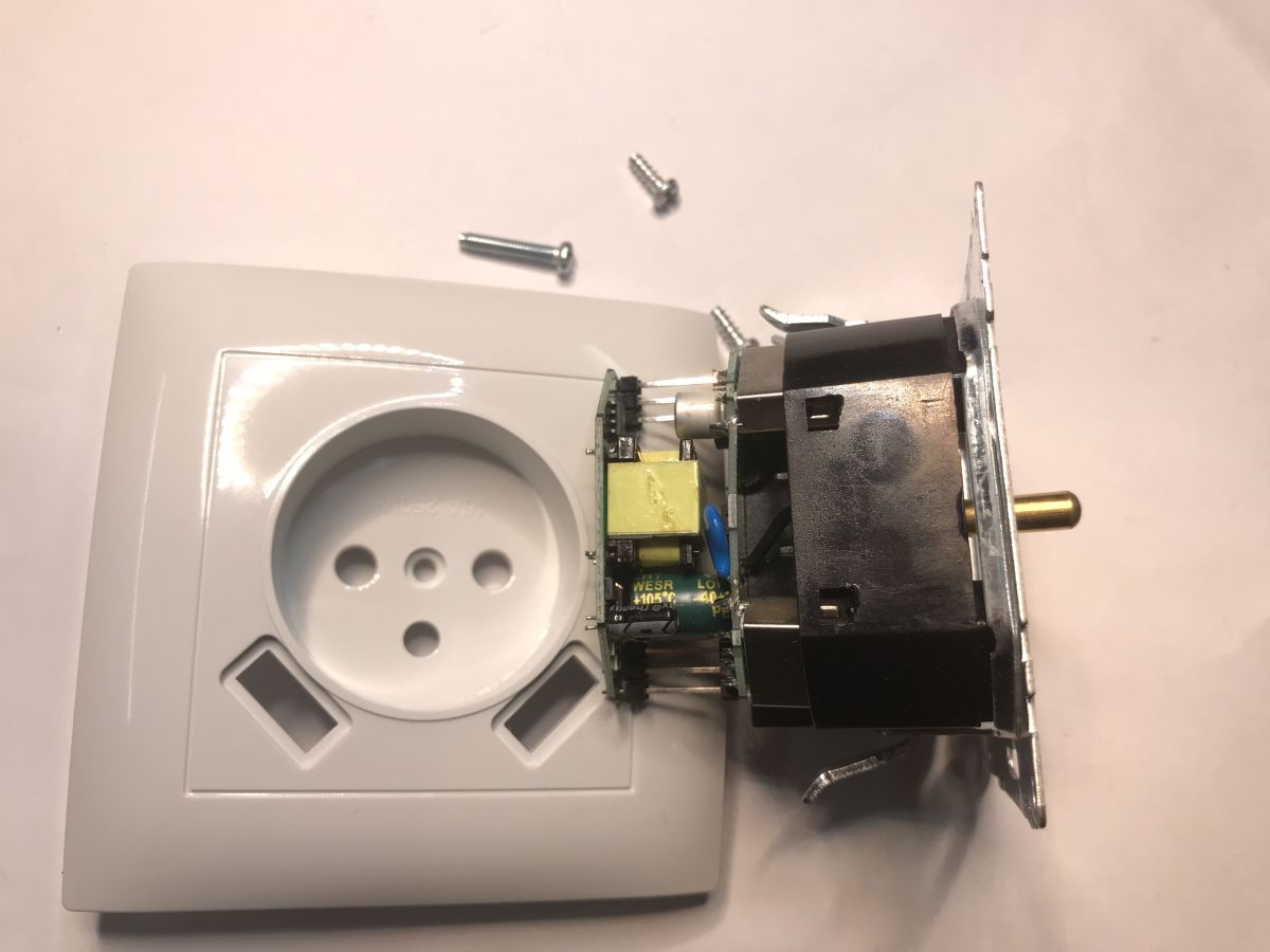

    Unscrew the screw to remove the front panel:
    Disassembled wall socket with USB: front panel, screw, and socket body with metal frame on a table

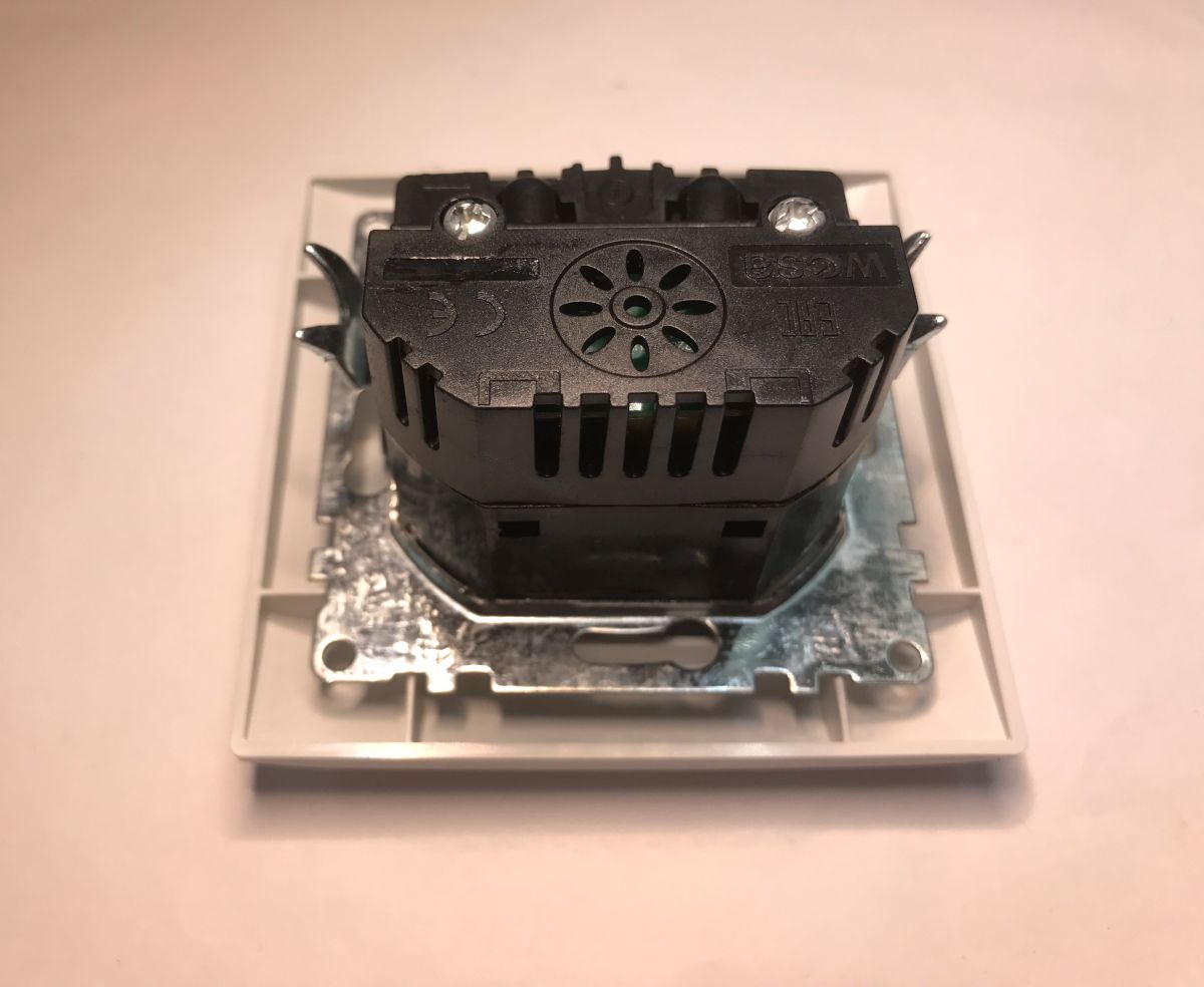

    There are vents in the case, but I don't think they provide much - after all, it's sealed in a box anyway. The back of the case is on hooks, let's take a look inside.
    Rear of a flush-mounted outlet with black housing and metal bracket on a white frame

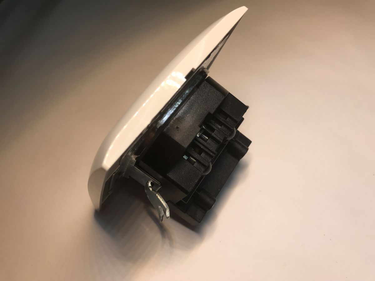

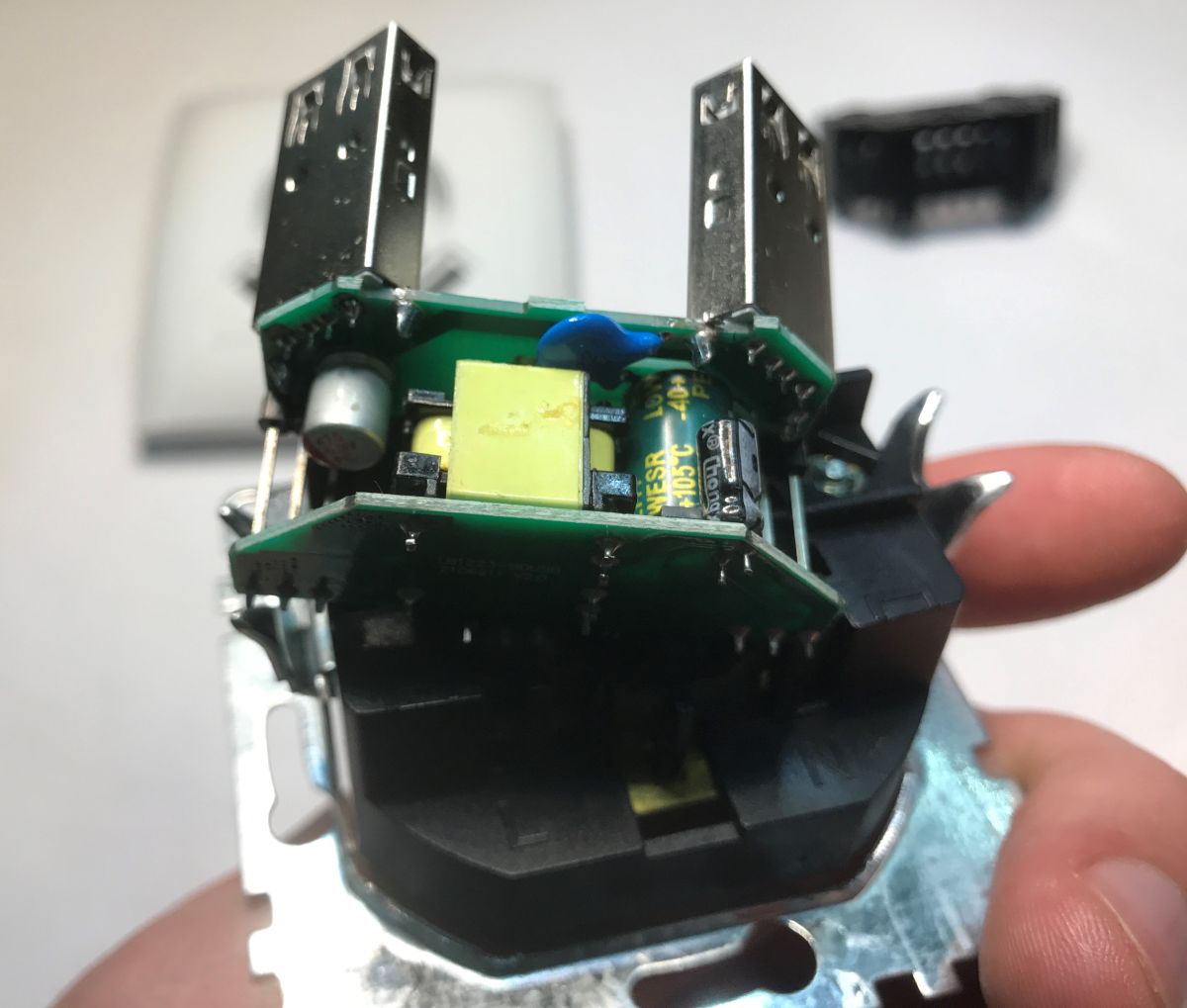

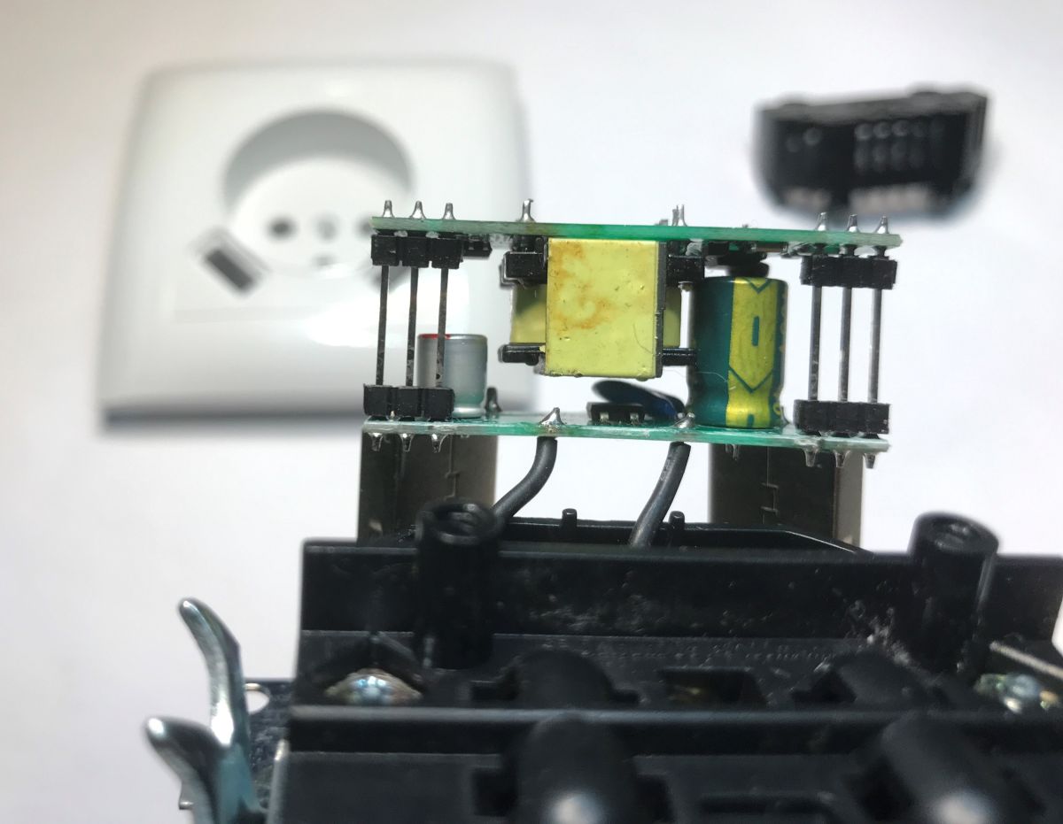

    The whole thing is cleverly built with two boards and deep USB ports. The manufacturer has made an effort to pack this efficiently into the available space.
    Disassembled in-wall socket: white faceplate, module and PCB with transformer, plus loose screws on a table Disassembled power outlet module with a green PCB and two USB-A ports, held in a hand. Inside a USB wall outlet: two PCB boards and a yellow transformer in a black housing Inside a USB wall socket: two PCB boards with a transformer and capacitor, with a white faceplate in back

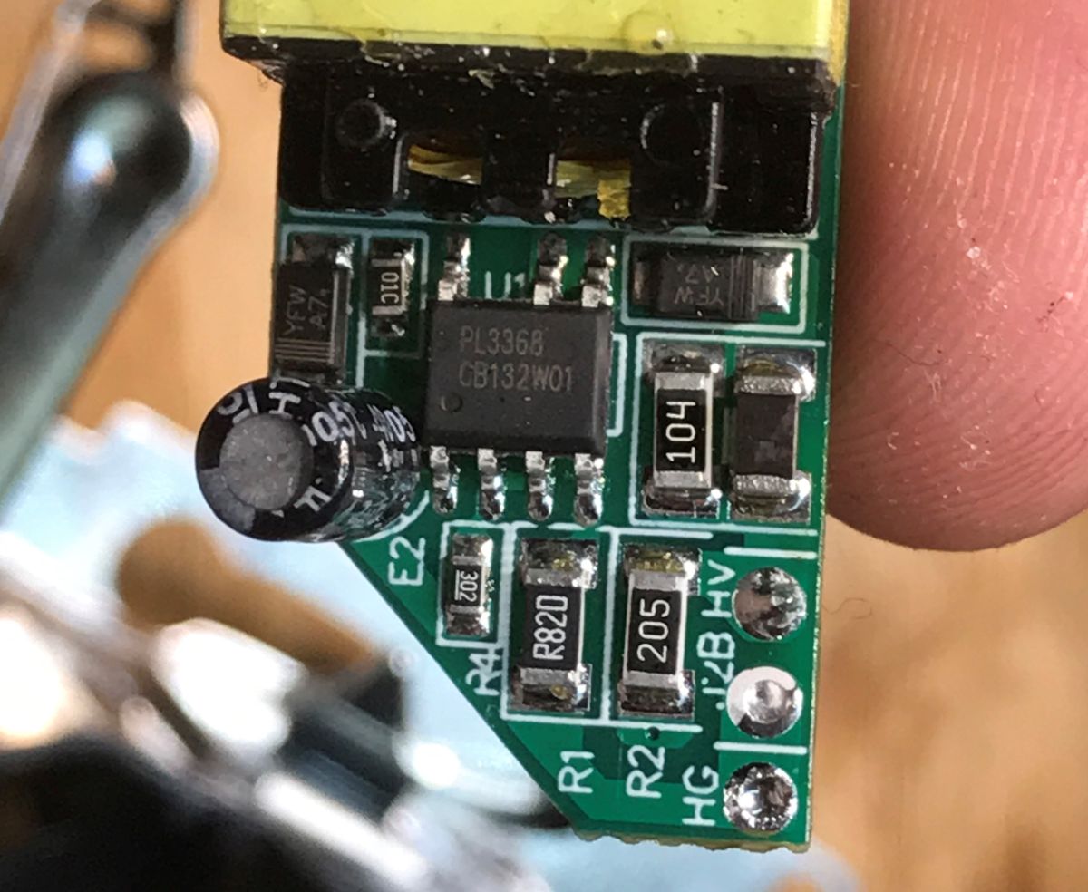

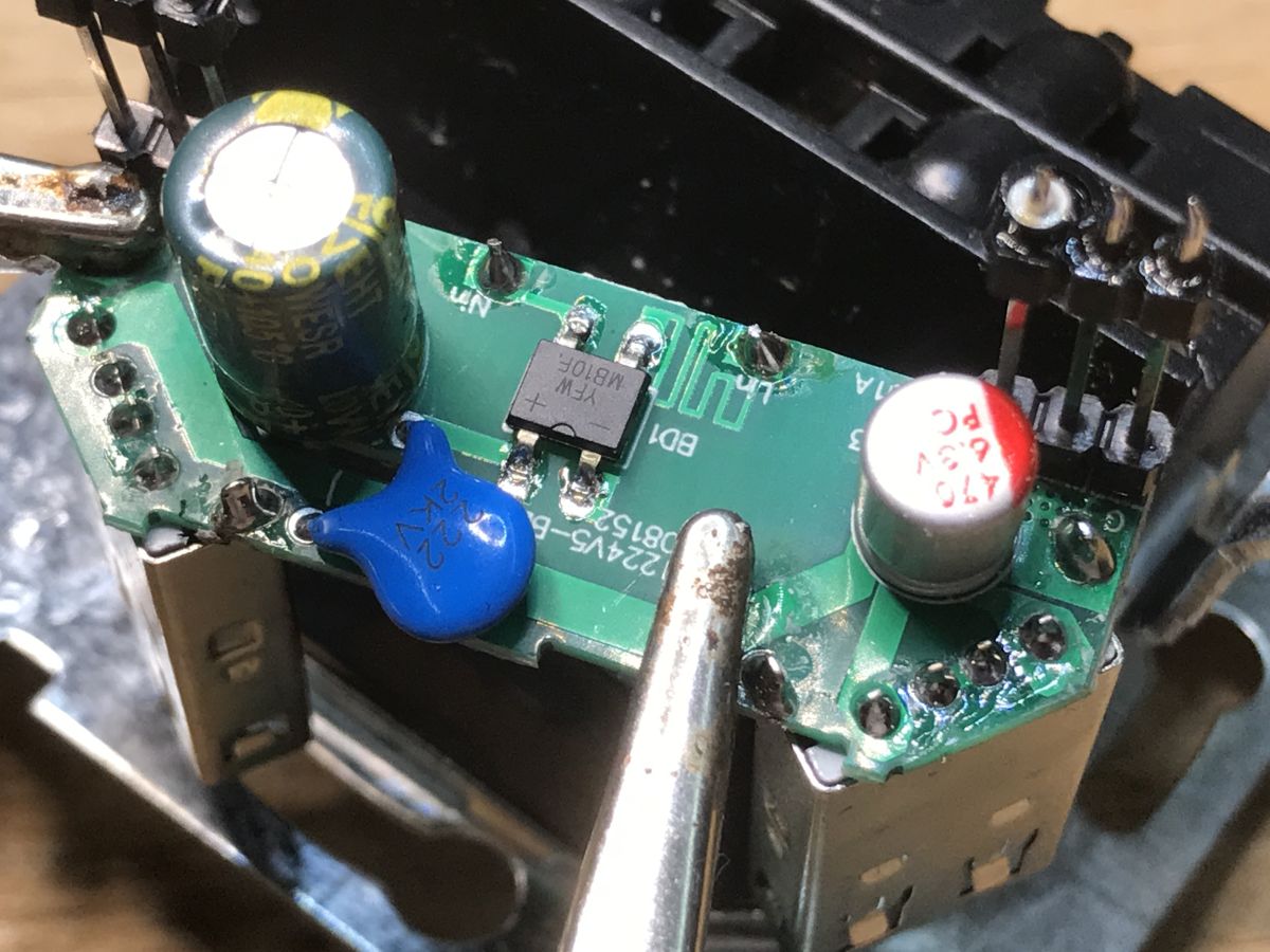

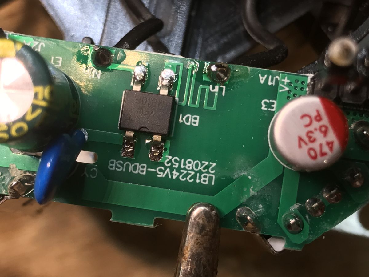

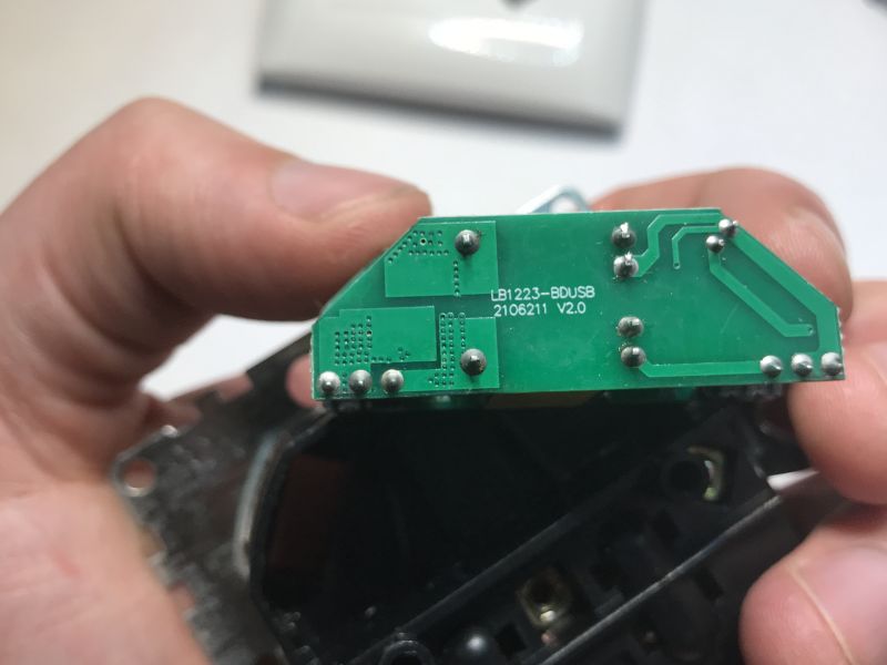

    Inside is a small power supply in flyback topology. The PCB is signed LB1223-BDUSB, but you can't see the chip markings. This will need to be unsoldered.
    Close-up of a green PCB labeled “LB1223-BDUSB,” held between fingers

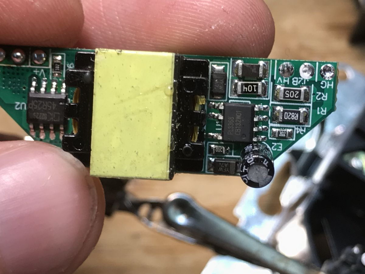

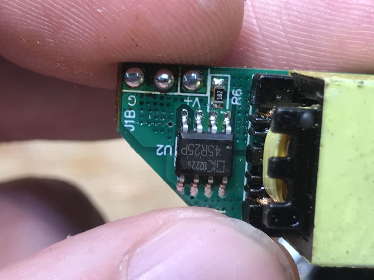

    After unsoldering you can see an interesting design. Here we have on one side a path instead of a fuse and a rectifier bridge, and on the other side USB ports and a capacitor for 6.3 V, this is connected by a CY capacitor. The distance between the 'hot' and 'cold' side is a little worrying, it's only a few mm.
    Close-up of a green PCB with an IC, capacitors, and the marking “LB1224V5-BDUSB” Close-up of a PCB inside a USB socket module with capacitors, SMD parts, and solder joints
    On the other side of the PCB we have two ICs - a PL3368 inverter controller and a 45R25P synchronous rectifier.
    Close-up of a PCB with a small transformer, IC, and electrolytic capacitor, held between fingers. Close-up of a green PCB with PL3368 IC and electrolytic capacitor, held between fingers Close-up of a PCB with IC labeled U2 and a transformer, held between fingers

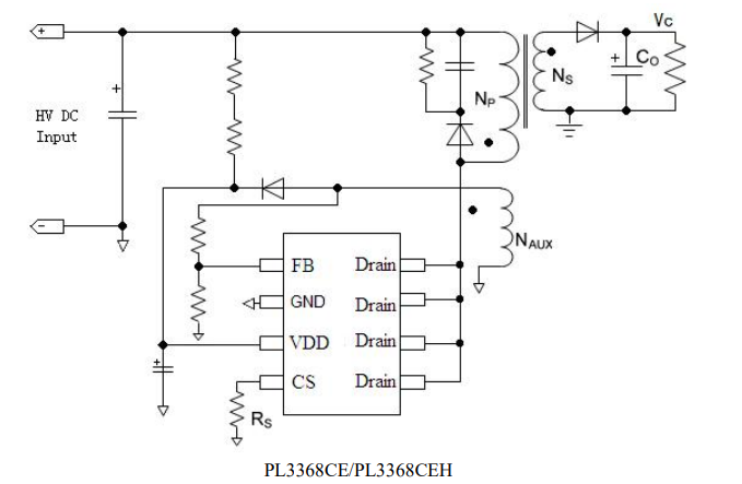

    Flyback converter schematic with PL3368 IC, transformer windings, and rectified output stage

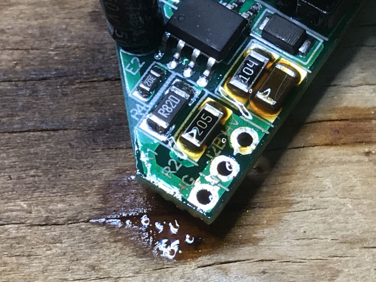

    After visual inspection I soldered the whole thing back together:
    Close-up of a green PCB corner with SMD parts on a wooden surface and a small liquid spill Close-up of a green PCB with soldered pins, with a black outlet housing in the background

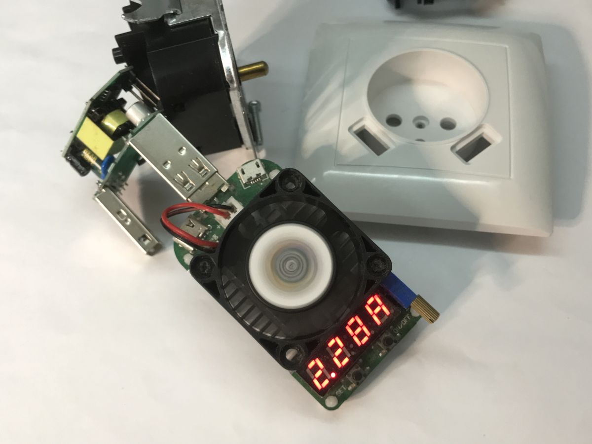

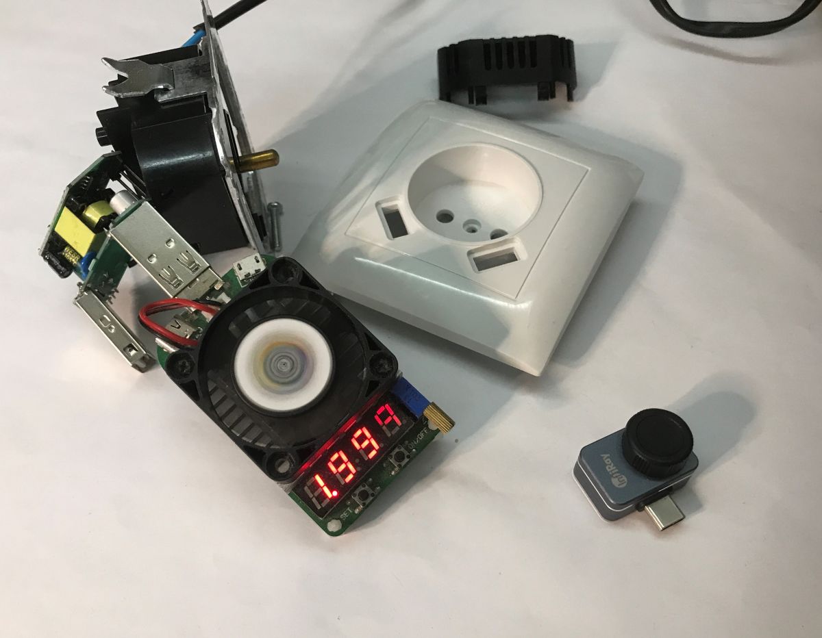

    Time for a load test. Up to 2.3 A at 5.1 V can be drawn:
    Disassembled wall socket with USB ports and an electronic load module with fan and LED display

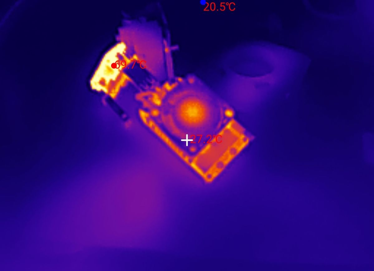

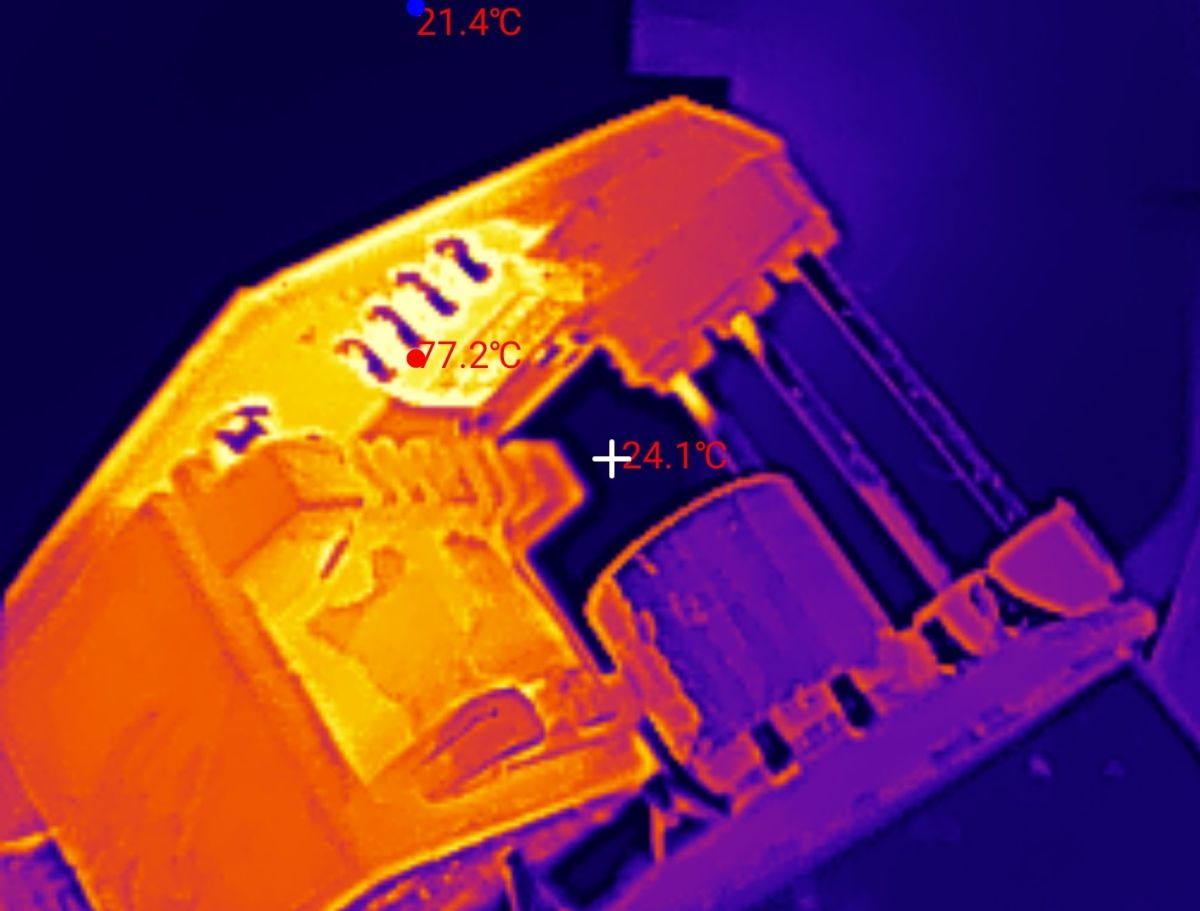

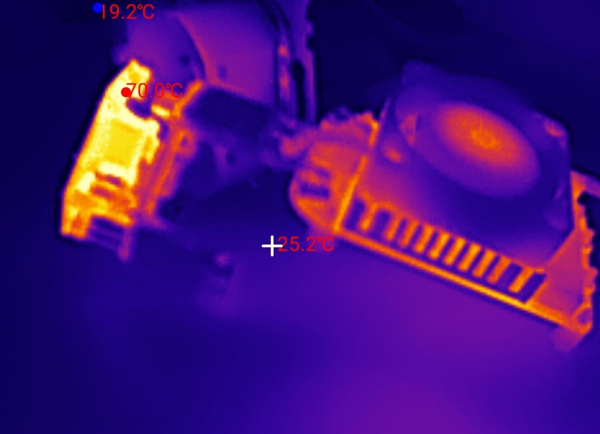

    The thermal imaging shows nicely how even the warm air from the LD35 artificial load warms the table top:
    Thermal image of an electronic PCB with a hot spot around 69.7°C and background around 20.5°C
    Thermal camera view of electronics on a table; hotspot labeled about 70.0°C and a 19.2°C reading

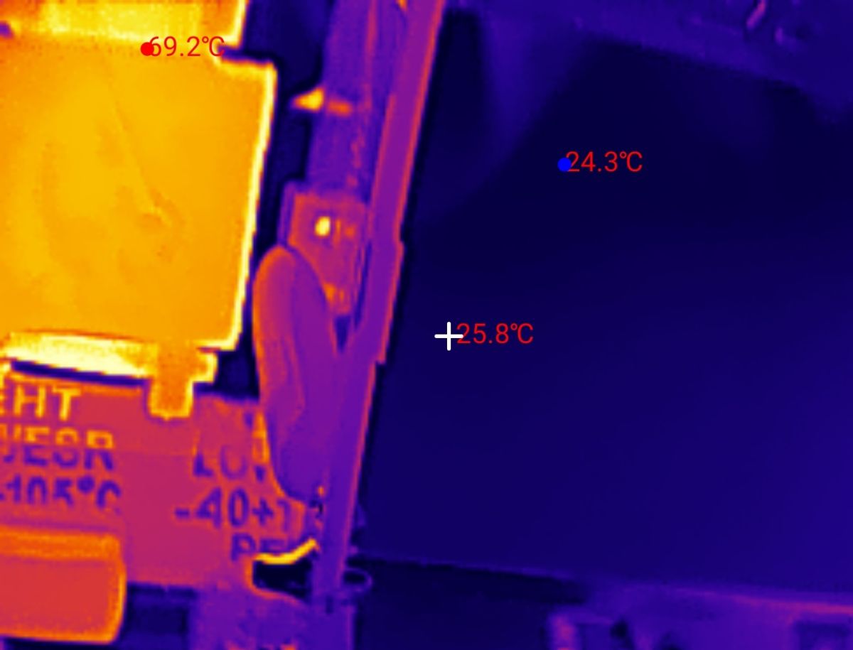

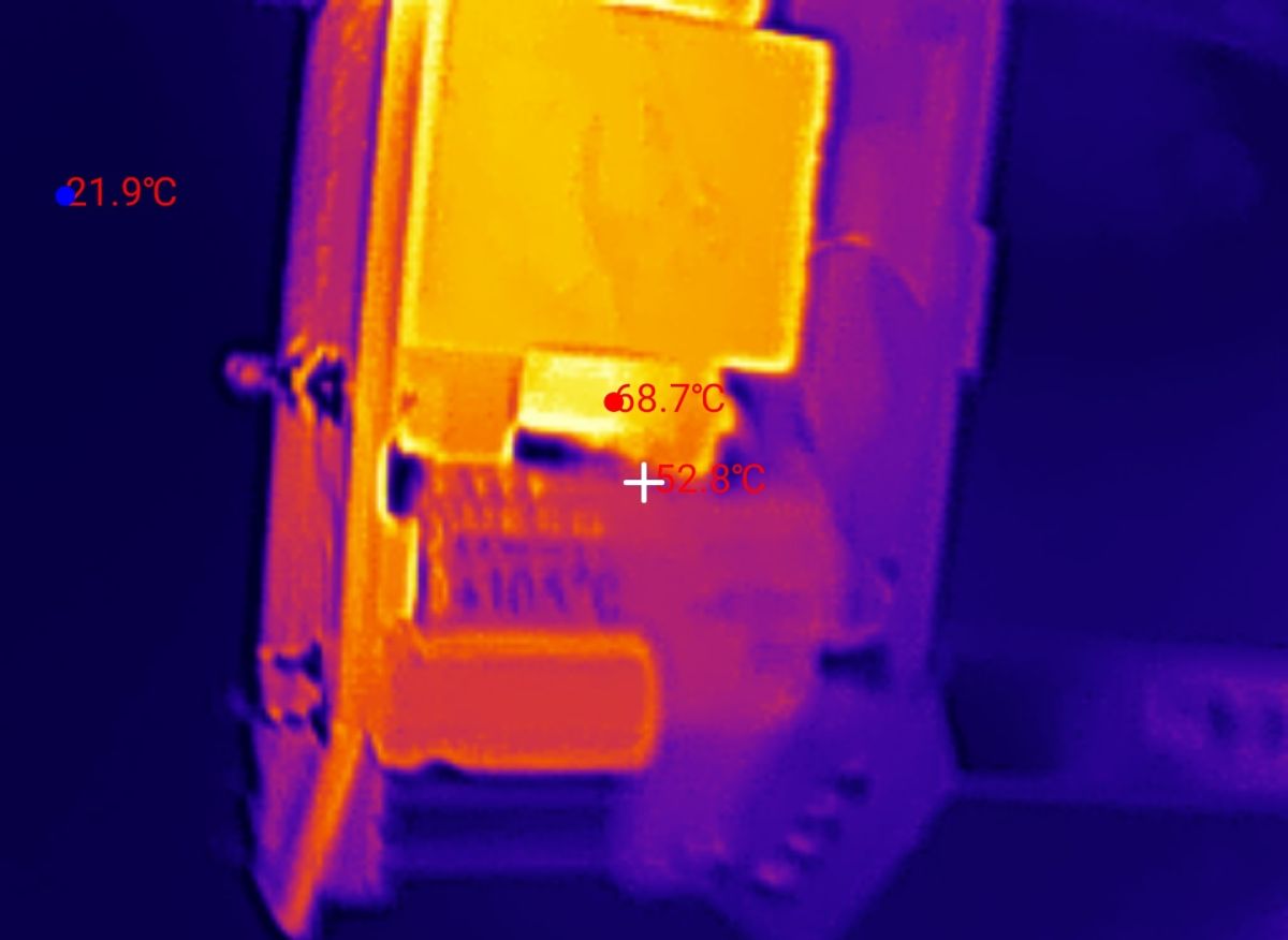

    Now the most interesting thing - the transformer heats up quite a bit, up to 70 °C, the inverter controller tops it, reaching 80 °C.
    Thermal image of an electrical device with hotspots at 68.7°C and 52.8°C and a 21.9°C background Thermal image of device internals; hottest spot 77.2°C, background about 21.4°C. Thermal image of an electronic component with temperature readings 69.2°C, 25.8°C, and 24.3°C
    In summary , the socket does its job, although the USB does not offer the QC standard support required by most modern devices and in addition it gets quite hot, potentially even hotter than my tests showed, as I tested with the case removed and outside the box. The construction inside is quite economical, I was a little concerned by the small distance between the mains voltage side and the low-voltage secondary. It was also interesting to see how the transformer is built, but I didn't want to dismantle it.

    I assume that infrared measurements are taken under load, but I am also curious about the power lost in idle operation. In these times of global "electro-saving", such sockets with an inverter operating 24 hours a day should not be right.

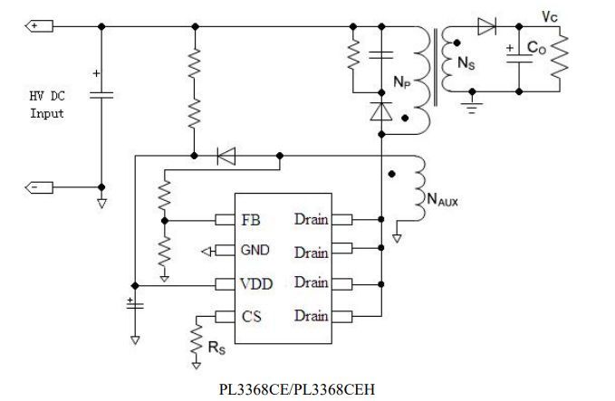

    This scheme is AI generated :?:
    Switch-mode power supply schematic with transformer and PL3368CE/PL3368CEH controller

    Jacdiag wrote:
    This diagram is AI generated :?:
    What do you think is wrong there?
  • #14 21863982
    CosteC
    Posts: 5383
    Help: 402
    Rate: 1674
    Drawn as if in painter by a beginner:
    Each coil different
    Primary ground symbols are different
    Ground after secondary
    Capacitors with connected covers
    Capacitors unpolarised but polarised.
    Missing designators
    Overall: regret not schematic (as per datasheet)
  • #15 21864021
    Jacdiag
    Level 30  
    Posts: 1635
    Help: 116
    Rate: 382
    Complementing the above post....
    e.g. missing the most important element - the USB socket
    & some "loose" dots
  • #16 21864032
    Posts: 14791
    Rate: 12937
    "Loose" dots mark the start of the windings - it matters, you can't reverse wind. And the USB isn't there, because it's from the inverter controller's datasheet. As for the rest of the criticism, I'll agree, a standard Chinese catalogue note.

    Costec, you are clinging for the sake of clinging. Dots start windings, coils different because different wire thickness. Masses different because they are separated. That's my opinion. It looks like it looks on other datashits.
  • Primary and secondary ground symbols are correctly different
    #18 21865143
    CosteC
    Posts: 5383
    Help: 402
    Rate: 1674
    keseszel wrote:
    looks at other datashits.
    Exactly, such shitty ones.
    keseszel wrote:
    coils different, because different wire thickness.
    As long as I have lived, and I have lived long enough, this is the first I have heard of coils being drawn differently due to wire thickness. Please bring me the literature that talks about this.
    You have not read...
    The fact that the primary and secondary side ground symbols are different is just fine.
    A colleague asked, a colleague got an answer. Not everyone is comfortable with the level of "shit" and equivocation.

Yes. The reviewer observed a small separation—only a few millimeters—between the primary (mains) and secondary (low‑voltage) sides, plus a PCB trace used in place of a fuse. Treat this as an economy design choice. [Elektroda, p.kaczmarek2, post #21861619]
What power‑supply topology does it use and why does that matter?
It uses a flyback converter with a synchronous rectifier. This common, compact SMPS topology enables small wall‑box integration but concentrates heat in the transformer and controller under load. [Elektroda, p.kaczmarek2, post #21861619]

Voltage drops significantly and charging performance degrades. This is the observed limit where the outlet can no longer hold near‑nominal 5 V under load. [Elektroda, p.kaczmarek2, post #21861720]

LC‑13‑A Yes No QC 70–80 °C (open‑bench)

One commenter criticized the high temperatures: “80° in the can… health to electronics…,” underscoring concern about heat in enclosed wall boxes. Consider derating and intermittent use. [Elektroda, keseszel, post #21861834]
