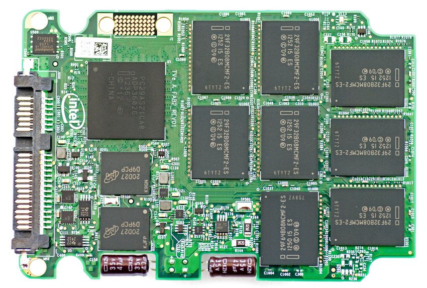

    SSDs manufactured 10-15 years ago had NOR flash for storing firmware, and capacitors to protect against rapid power loss. These components were very inexpensive for mass production, but now they are not installed, which greatly reduces the reliability of SSDs. WHY?
    SSD internal board with Intel controller and multiple NAND flash chips

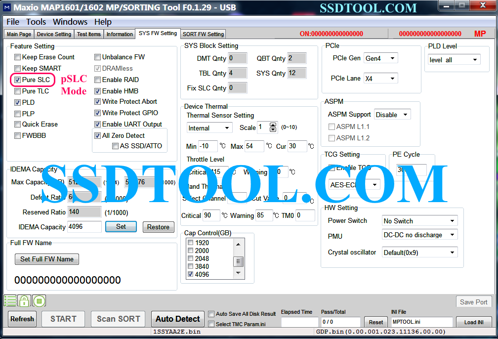

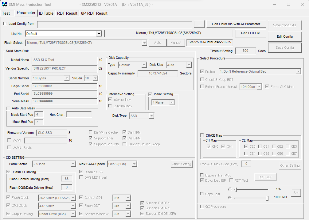

    Some enthusiasts working with SSDs have found a way to change the firmware to p(SLC) mode, which is very easy to do during production, but why isn't it being done?
    SMI Mass Production Tool software interface for SSD configuration and testing Maxio MP Tool software interface for SSD setup with Pure SLC mode selected

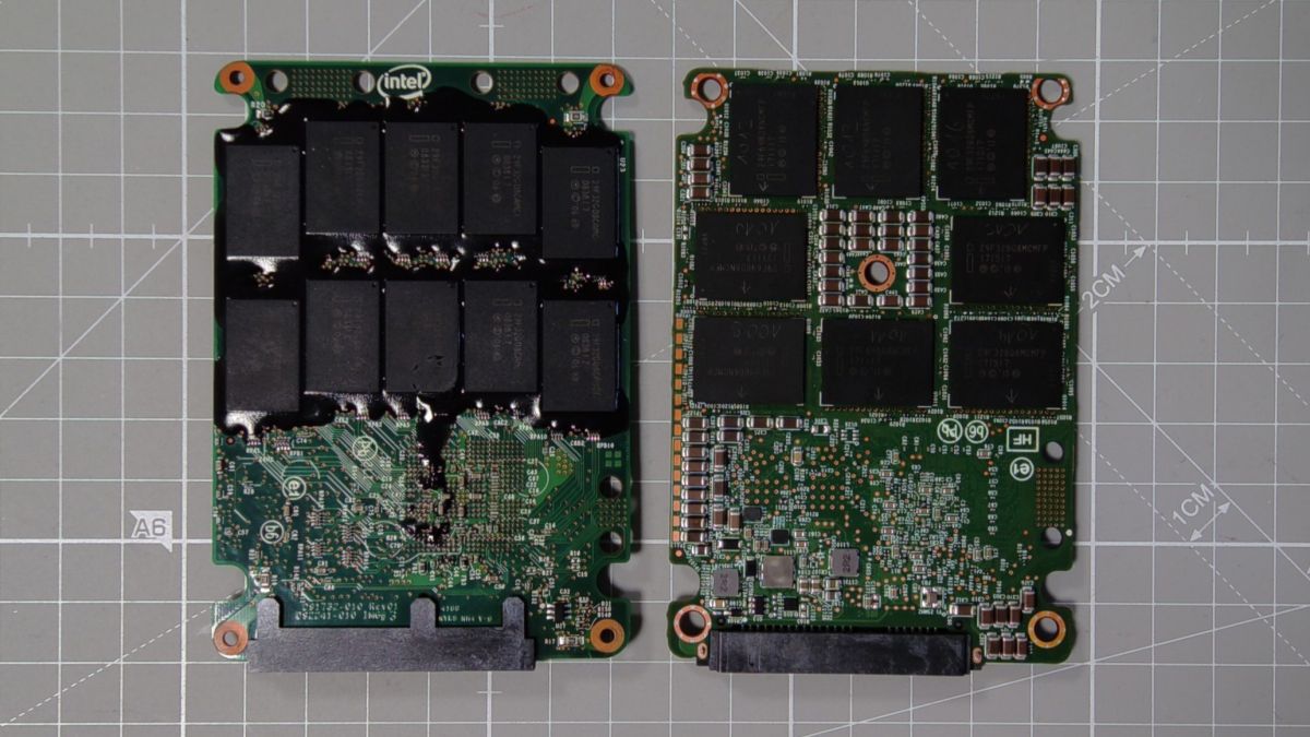

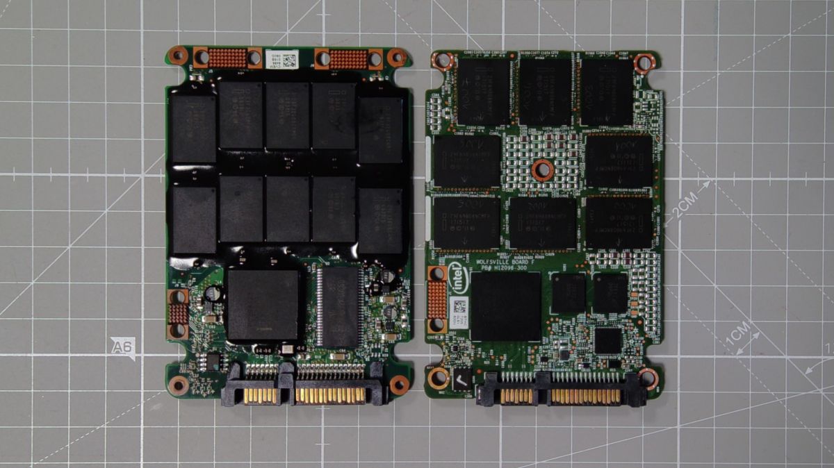

    #12 21776632
    Łukasz_W
    Posts: 5081
    Help: 633
    Rate: 658
    kaleron wrote:
    - have you been able to determine what is changing?
    Individual fragments. But that's not in every model either.
    For example, in the SSDSA2MH080G1GN, the NOR content (25X40AVNIG) remains the same, but this is also explained by the design - there is no capacitor bank.
    But already in the SSDSC2BX800G4N (25X40CLIG and 35V support on capacitors) there are individual changes in content.
    In both models, the NOR content is individual and cannot be transferred (or it) between drives.
    Unfortunately I have too little data to say more.
