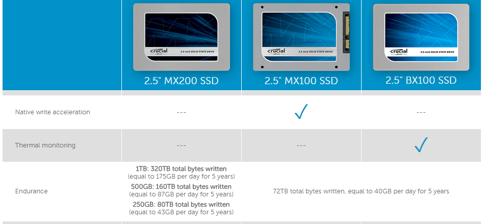

    You did not answer my question.
    This applies to almost every manufacturer. He writes almost because I am not familiar with the offer of every producer. I will give an example of two manufacturers:
    The first is Crucial. I have a BX100 250GB drive myself. Link to the specification .
    SSDs lose data with prolonged power outages

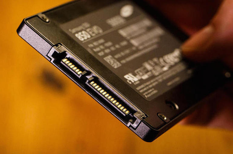

    And the other is the Samsung EVO 850. Link to the specification .
    I hope you can understand how it counts after the screenshots. You have a guarantee, for example, for saving 72TB of data, i.e. to save so much data, you would have to save 40GB of data daily for a whole year for a period of 5 years (40 * 465 * 5). And let me remind you, this is a WARRANTY, not how long the drive will work. It can run over those 72TB of write. If you save 100GB a day, 72TB will run out after about 2 years, but no private user will be saving 100GB a day, every day, for 2 years ... And then you can buy e.g. MX200 1TB and you have a 320TB guarantee, or 175GB a day for 5 years.

    Kużdo wrote:
    You have a guarantee, for example, for saving 72TB of data, i.e. to save so much data, you would have to save 40GB of data daily (...) for a period of 5 years (40 * 465 * 5). (...) If you save 100GB a day, you will run out of 72TB after about 2 years
    It should be mentioned here that according to Google research from 10 years ago, for classic HDDs the situation looks like this:
    - 1.7% of classic drives breaks down in the first year after the launch
    - but in the third year this parameter jumps up to 8.5%
    Link
    Much newer research ( Link ) thousands of drives showed that the results are similar to those obtained by Google. 22% of them broke down within 4 years.
    In this light, SSD wear is a lesser evil anyway.
