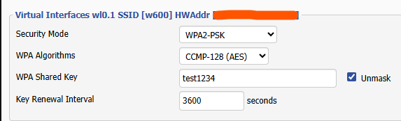

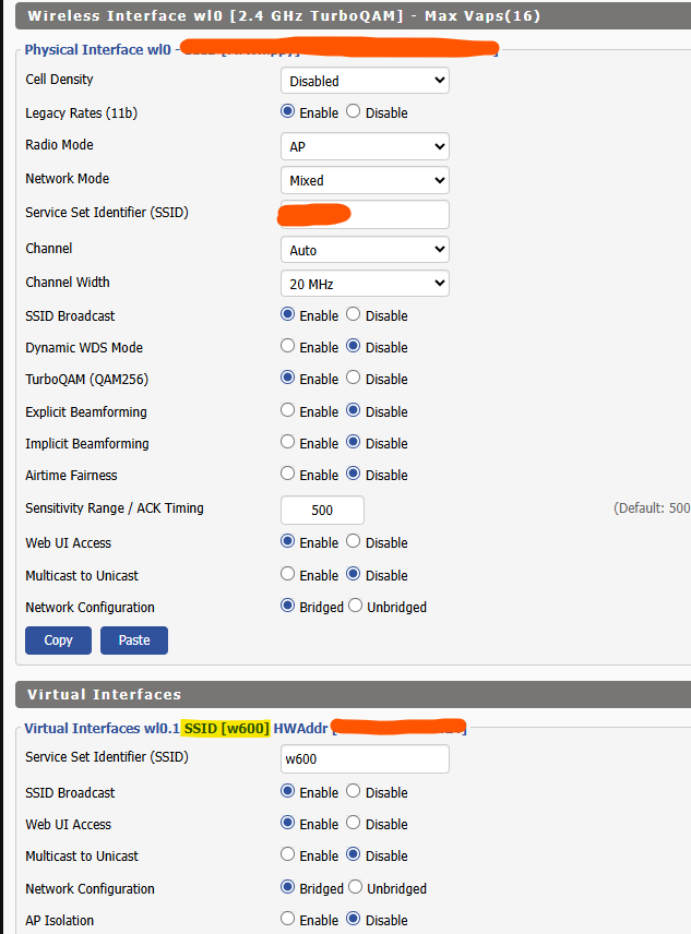

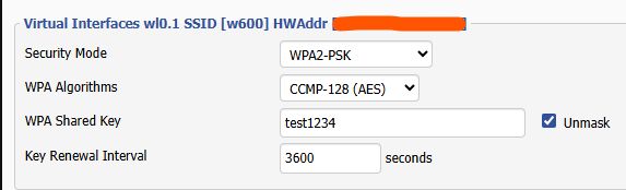

    in an attempt to replicate this I have flashed W600 with 1.18.226 and setup test DD-WRT AP as follows
    2.4 GHz wireless interface settings panel with SSID and radio mode options
    Wi-Fi security settings with WPA2-PSK and CCMP-128 (AES) algorithm selected
    connects OK
    also fine with ! in password.
    have you rebooted router?
