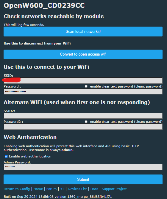

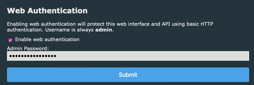

    To enable web password authentication login to your OpenBeken device web interface and enter Config -> Configure WiFi & Web configuration section.
    On the bottom you can see Web Authentication section. This section provides two options:
    * Enable web authentication - enables web authentication and will require user to log in before accessing web admin interface,
    * Admin Password - password to be used.
    Username is always admin.
    Screenshot showing network authentication interface with an enabled option and a password field.

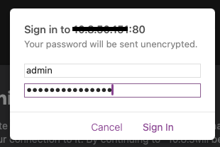

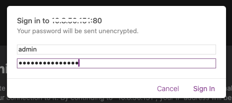

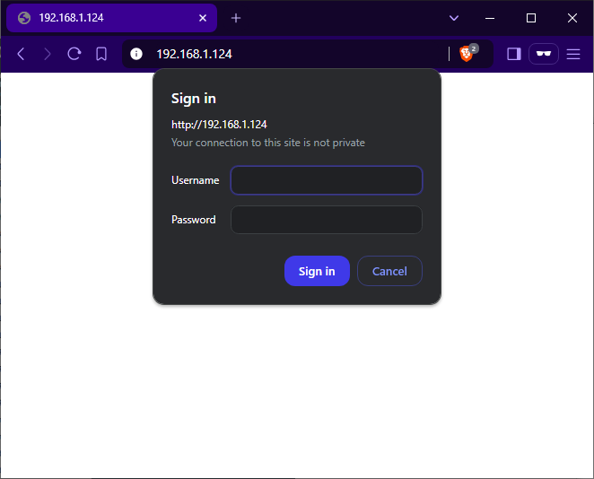

    Next time you will access web portal or API, you will be required to enter username (admin) and configured password. Any integrations using any web-based API will need to authenticate as well.
    Login window with basic HTTP authentication showing user admin.

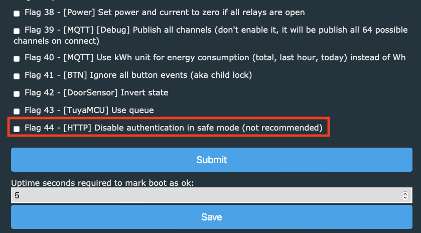

    By default web authentication (if configured) is enabled even when the device enters Safe Mode. This acts as a security measure, since device creates open AP to which anyone can connect and could possibly control the device or even misconfigure it to cause damage (eg. relays used to control heating, water pumps, etc.).
    If you, however, wish to disable password authentication is safe mode, this can be done using global flag 44 in Config -> Configure General/Flags section. It is not recommended though.
    Configuration window with flag options in the OpenBeken interface.

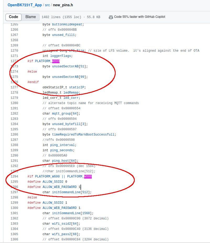

    Ahh, its missing a "char webPassword[33]" in "mainConfig_t".
    If I calculated correctly and we have "initCommandLine[512]" starting at 0x000005E0 (dec 1504),
    we end at 2016 leaving only 32 to fill 2048
    Screenshot of source code displaying sections related to W600 and W800 platforms.
    So can we put the 33 bytes to the "unusedSectorAB" for W600 and W800?

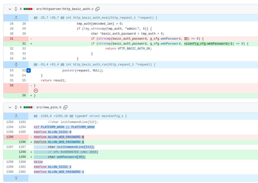

    O.k, made a PR with a password reduced to 30 bytes.
    Tested W800 : After OTA I had to restart it by hand and then at least WiFi config was gone (started as Open AP).
    But setting SSID and PW worked and I could set web password successfully.
    @p.kaczmarek2 : Is the change to new_pins.h o.k.?
    Is 2048 the limit as expected?
    Code changes in C source files.
