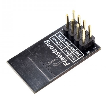

    Bought this one off aliexpress (similar link) a few years ago by mistake, there was only scarce micropython library that didn't support much. Found OpenApp today and was pleasantly surprised.
    [W600] ESP-01W WIS600 freestrong W600 WinnerMicro OpenBeken support
    Not really a teardown, but OpenApp does work flawlessly. Flashed it by pulling RX1 to GND with FTL232 using wmtools.exe. Idea is for this topic to pop up if someone googles it :)

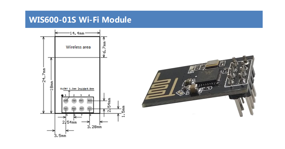

    Nice, thanks, I didnt even know there is a such W600 form board. I assume the pinout is the same as in the famous ESP board?
    Btw, have you tried "PowerSave" command? As far as I know, it works even on W600 platform (on Beken as well!)
    @iprak should be proud, it's his contribution to our project (porting, fixing, Ha Discovery and much more)
  • #3 20394400
    ginpachi981
    Yeah, it is similar to ESP-01, except it doesn't have nor need CH_EN, which adds one more pin for broad use. I tried powersave and it works nicely. OTA worked with JavaScript app
