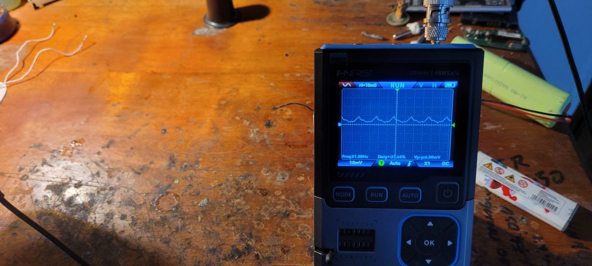

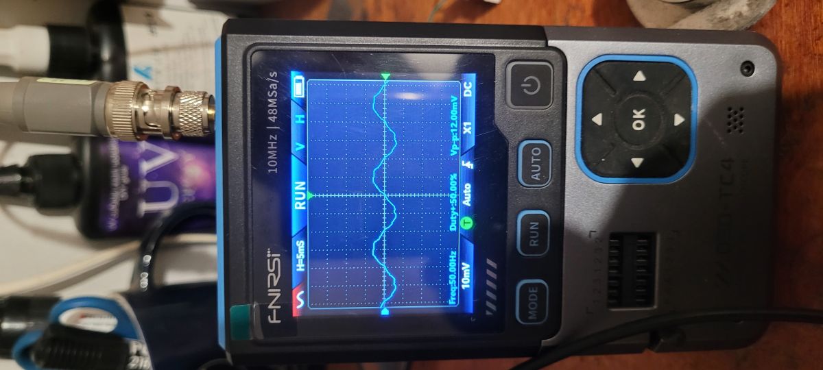

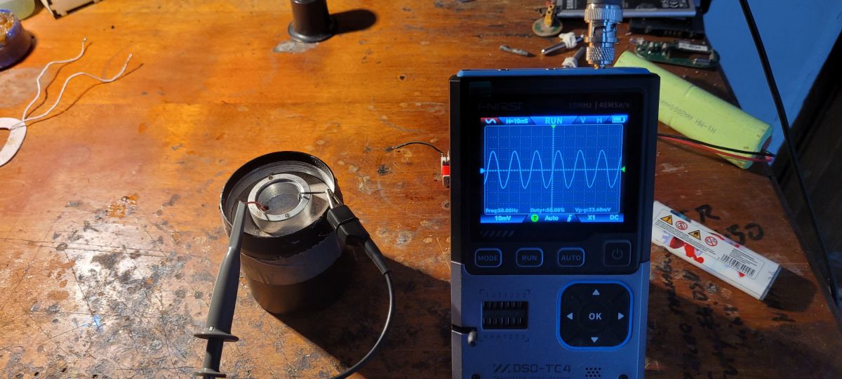

    Dzień dobry. Czy ktoś mógłby wyjaśnić mi to zjawisko? Oscyloskop podłączam do diody z latarki. Częstotliwość równo 50 Hz, wypełnienie 50%, Vp 32-33 mV. W ciemności, gdy zbliżam do światła, wszystko zanika. Nic z tego nie rozumiem.DSO-TC4 oscilloscope connected to an acoustic transducer on a wooden workbenchCompact digital oscilloscope on a workbench displaying a waveform on the screen

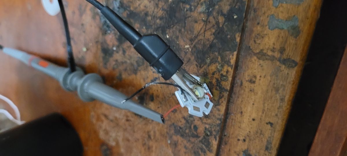

    No shielding. Connect the ground of the probe to the metal housing of the diode. 10 mV/dz is quite high sensitivity. It certainly catches interference from the mains.

    Or maybe from your fingers.
    Try not to touch the electrode of the oscilloscope. (Some paper, cloth).

    Czy można to zjawisko wykorzystać FNIRSI digital oscilloscope showing sinusoidal waveform on screenOscilloscope probe connected to an LED on a wooden workbench do pomiaru jakichś wartości? Dlaczego po wartości odczytu spadają do zera po oświetleniu diody? >>21790283

    Perhaps take care to ground the torch hand and ground in common with the oscilloscope?

    When the diode is illuminated, its dynamic resistance decreases. The lower the resistance, the more strongly interference from the mains is suppressed.

    If the oscilloscope has an input impedance of 1 MΩ (this is the standard), a photocurrent below the detection threshold with a typical meter already gives a lower diode impedance.

  • 50 Hz interference can appear without diode connection
    #10 21791269
    jarek_lnx
    Posts: 22679
    Help: 4187
    Rate: 6091
    dzimus wrote:
    There is someone here who is sober.
    If you don't understand the answer then don't cast doubt on the consciousness of those responding, because that won't help you. People answer, normally, culturally and truthfully.
    All it takes is a bit of intelligence and a few simple experiments to observe when a 50Hz waveform appears on an oscilloscope, what the amplitude depends on and to deduce where it comes from. Is it even necessary to connect to a diode to see 50Hz?
