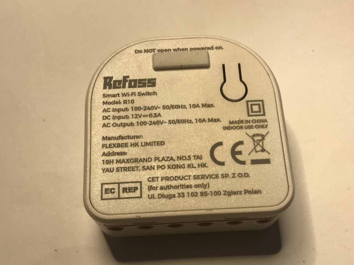

    Let's start with the packaging. Nothing here stands out about this product, maybe possibly that warranty. Two years? Anyone respect that?
    Box of Smart Wi-Fi Switch R10 featuring device image and Alexa and Google Home logos Side of Wi-Fi switch box showing product name in 12 languages Back of Refoss R10 switch box with technical specs and certification labels

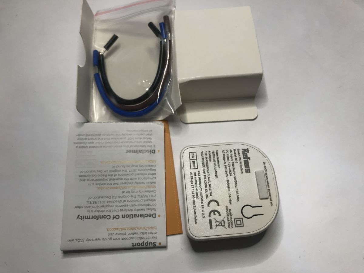

    Inside is the module, instructions and additional cables.
    Refoss R10 module with manual and wires on a white background

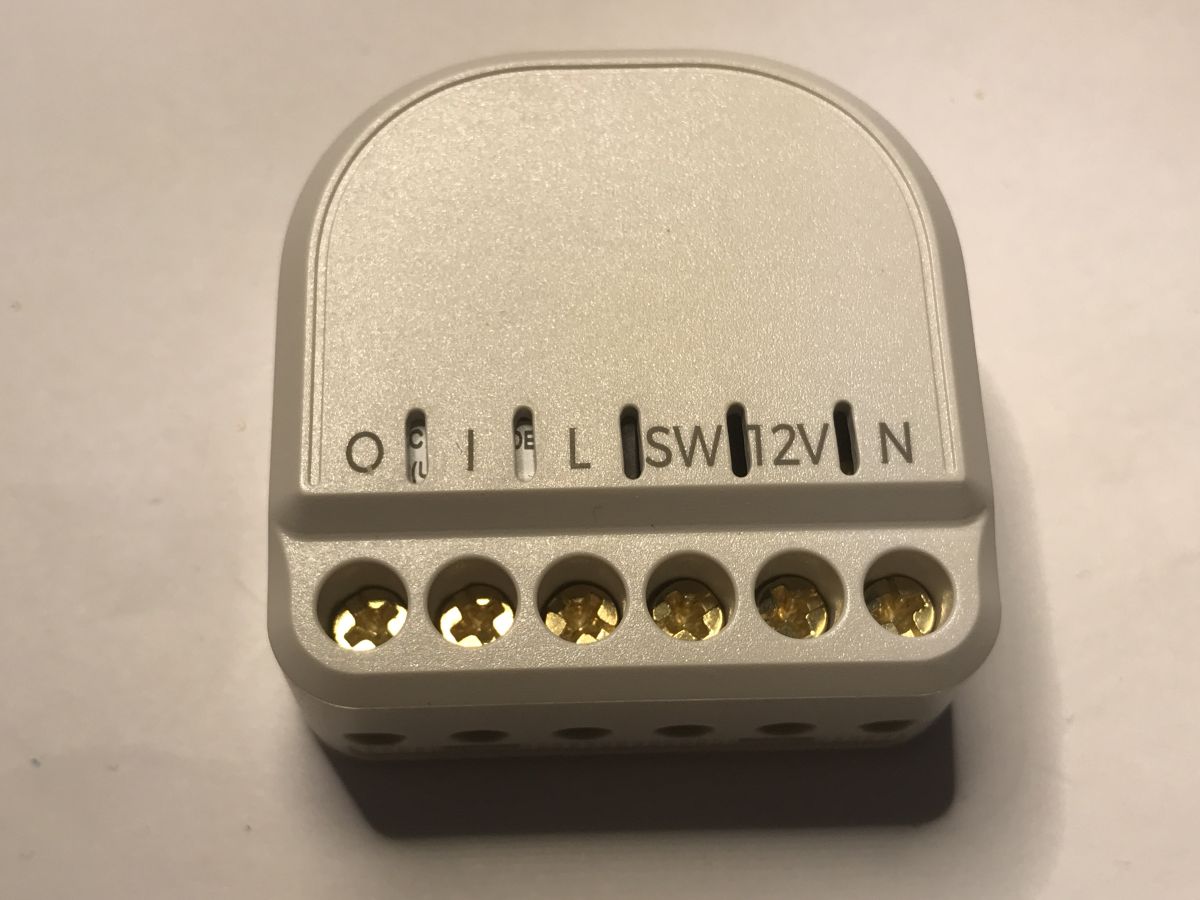

    The module itself is distinguished by two features:
    - there is a "window" for programming, now obscured
    - the module can operate on 100-240 V AC or on 12 V DC
    Above the window is a valid note - do not open when power is connected.
    Refoss R10 module with technical specifications and CE marking on casing Top view of Refoss R10 relay module housing with terminal labels visible

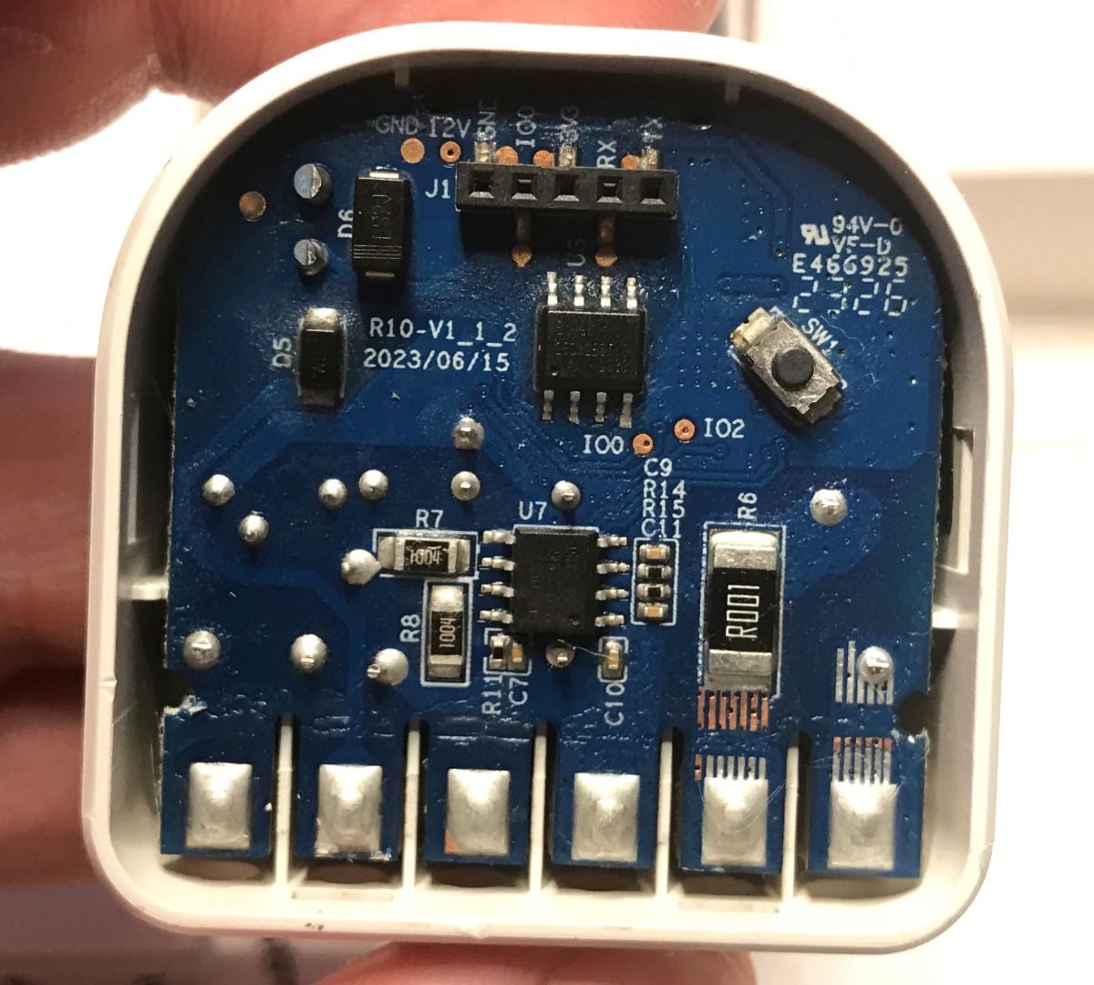

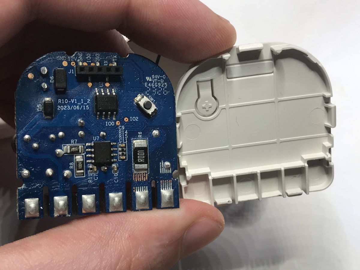

    Time to look inside . We simply lift the lid. The first thing that catches the eye is the state of the PCB. Is it dirty from flux?
    Close-up of Refoss R10 PCB with visible components and programming header J1
    PCB designation: R10-V1_1_2 2023/06/15 This is a fairly new design for a chip with ESP8266. You can also immediately see the programming connector. Next to it is a BoyMicro flash bone with firmware and a BL0937 for energy measurement.
    Refoss R10 PCB with programming header J1 and 2023/06/15 marking, cover removed

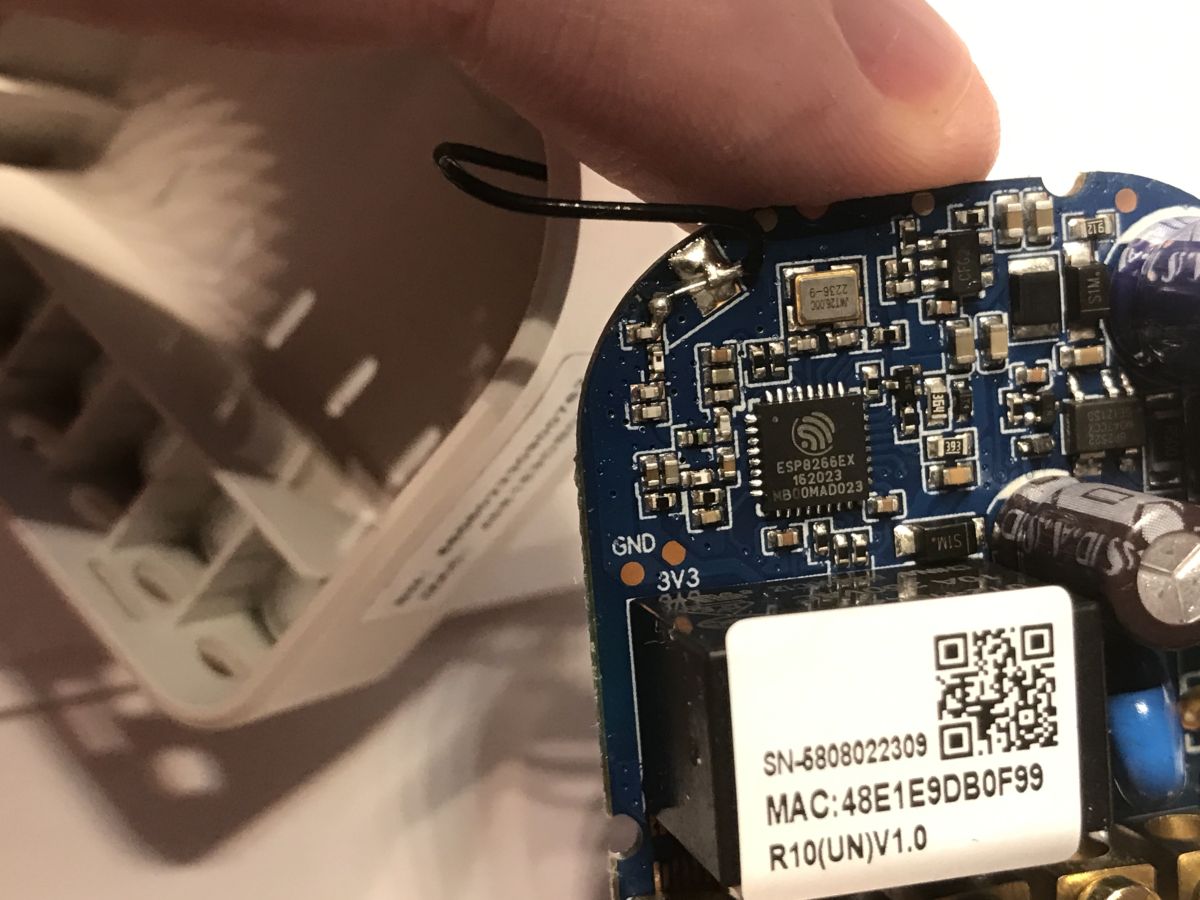

    On the other side of the board is an ESP8266. In the power supply section I see a BP2525.
    Close-up of Refoss R10 PCB with ESP8266 chip and labeled GND and 3V3 pins

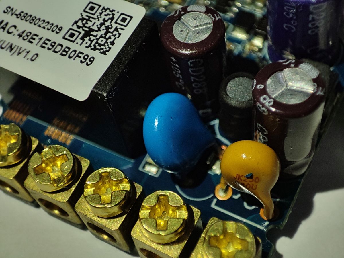

    A varistor is available in the power section:
    Close-up of capacitors and screw terminals inside the Refoss R10 module

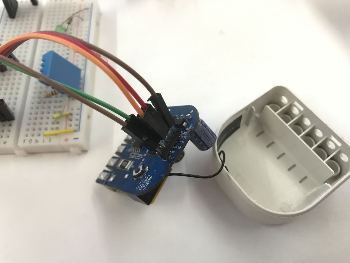

    Changing the firmware is very simple . This is an ESP8266, so you will need an esptool. We connect 3.3V, ground, RX, TX and GPIO 0, which must be in the low state. We only turn the power on when everything is connected. When the ESP8266 boots with GPIO 0 at ground potential, it will enter bootloader mode.
    You can follow my detailed material on the relay:
    ESP8266 and Tasmota - step by step WiFi relay control
    In my case it worked out like this:
    Refoss R10 module with UART wires connected for firmware flashing
    Note: the product must be disconnected from the mains before any operation with the programming connector! There is a BP2525-based step-down converter inside, there is no galvanic isolation, so connecting the product to the mains and to the computer at the same time may result in a short circuit!

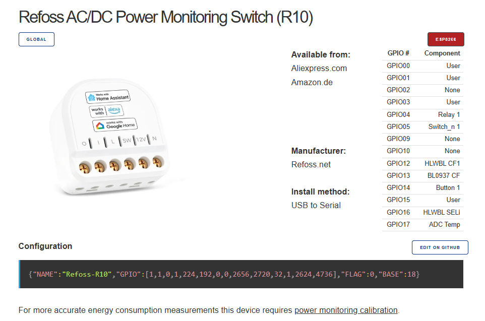

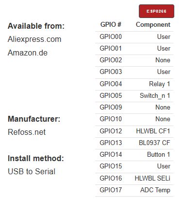

    Now the GPIO still needs to be configured. In OpenBeken we would have automatic configuration detection, but here it is done manually. Fortunately, someone has done this for us before:
    https://templates.blakadder.com/refoss_R10.html
    Refoss R10 relay module with GPIO pinout and Tasmota configuration shown
    I also learned from this site that this relay is more dangerous than I thought:
    SAFETY HAZARD: The digital GND is connected directly to mains voltage "L", so the GPIOs become LIVE during normal operation.
    I haven't tested this in practice - it's just absolutely impossible to operate on its GPIO when it's powered from the mains.
    Tasmota template:
    GPIO mapping table for the Refoss R10 module based on ESP8266

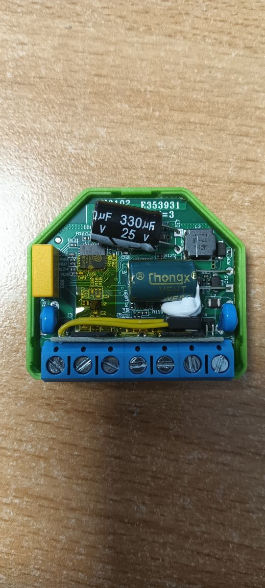

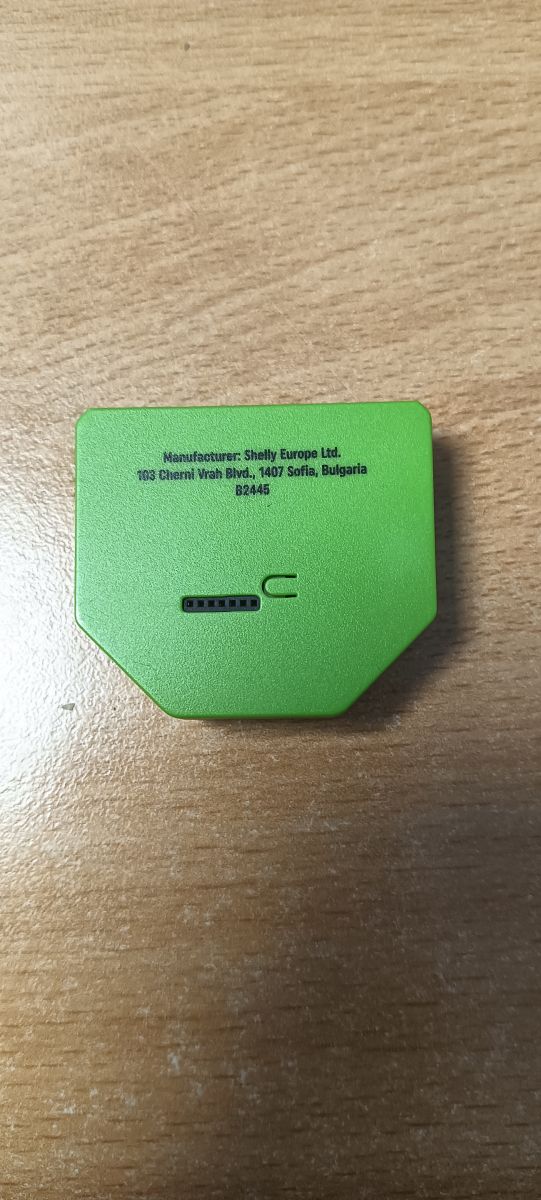

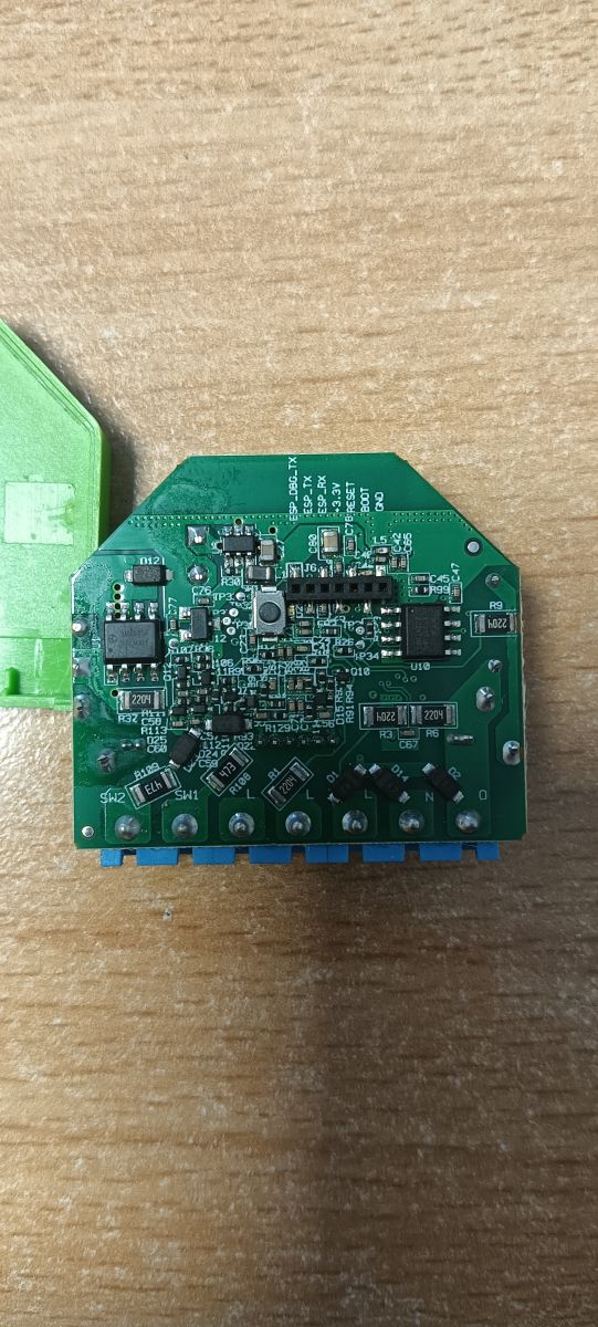

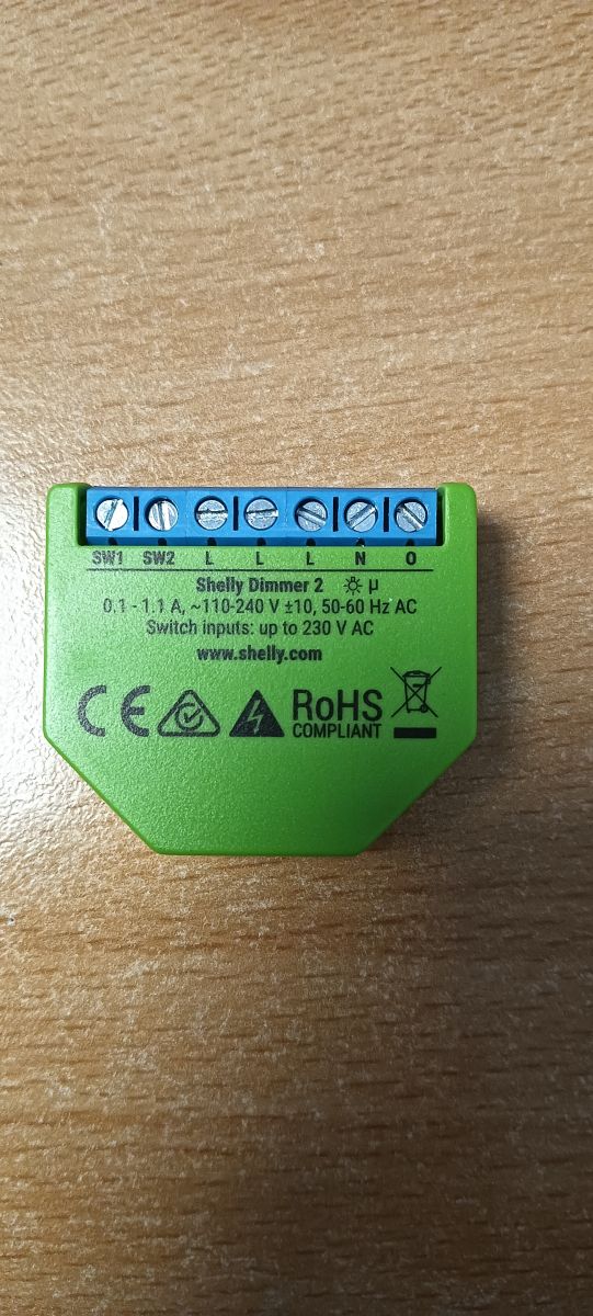

    Do you know of another product of this type where the manufacturer leaves a gateway for us to change the firmware and without soldering? Maybe someone is able to recommend something?
    And do you know/see this? 🤔
    Green Shelly Dimmer 2 module on wooden surface with visible screw terminals
    Electronic circuit board with capacitors, screw terminals, and SMD components
    Close-up of a green PCB with electronic components and labeled pin headers.
    Green adapter labeled as Shelly Europe Ltd. product on wooden surface

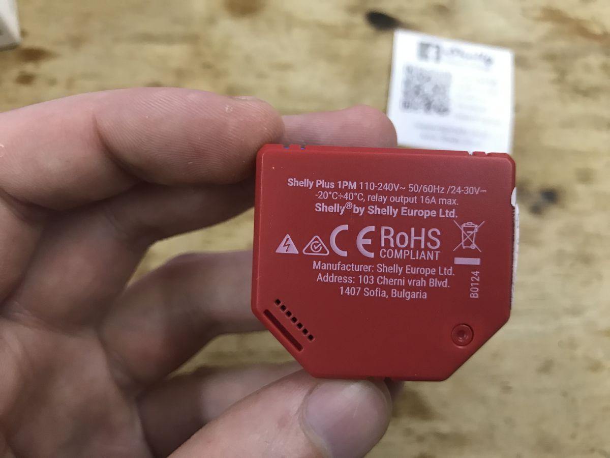

    I also have Shelly, waiting in the queue for publication:
    Red Shelly Plus 1PM module held in a hand, showing technical info on back
    It pairs nicely with Home Assistant too.
