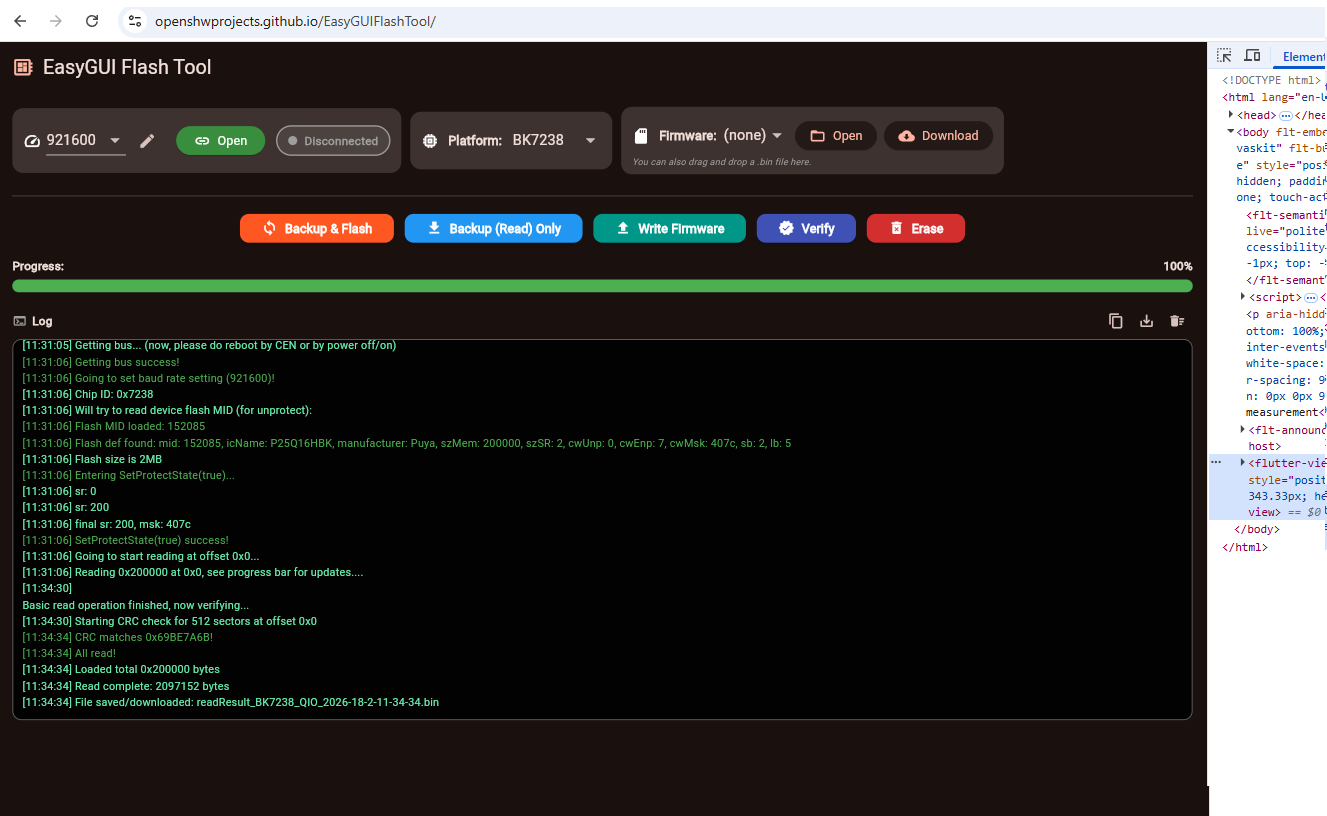

    The web version is based on modern browser APIs (Web Serial / WebUSB) and can be hosted either on GitHub Pages or run locally without any backend services.
    It allows selecting firmware files, configuring flashing parameters, and monitoring flashing progress directly from the browser.
    Screenshot of EasyGUI Flash Tool with 100% progress bar and a log showing firmware read operation.
    Screenshot of EasyGUI Flash Tool showing flashing progress bar and operation log
    Tested communication speed up to 1 500 000 baud on supported devices.
    There is a single known issue with web version - DTR/RTS pins used for automatic RESET may not work in some cases, it seems to be caused by Chrome limitation. For best experience, run the flasher locally, on localhost.

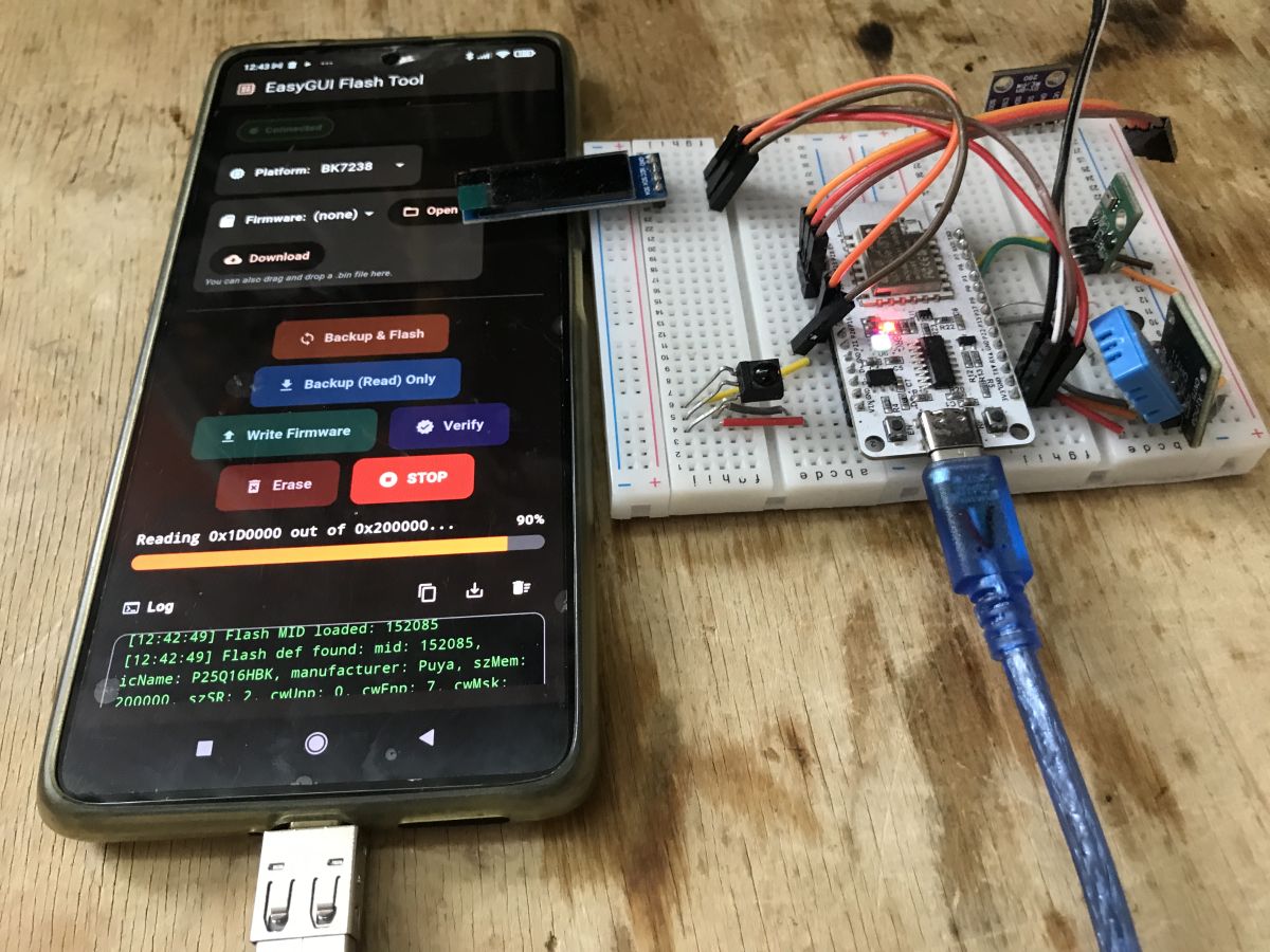

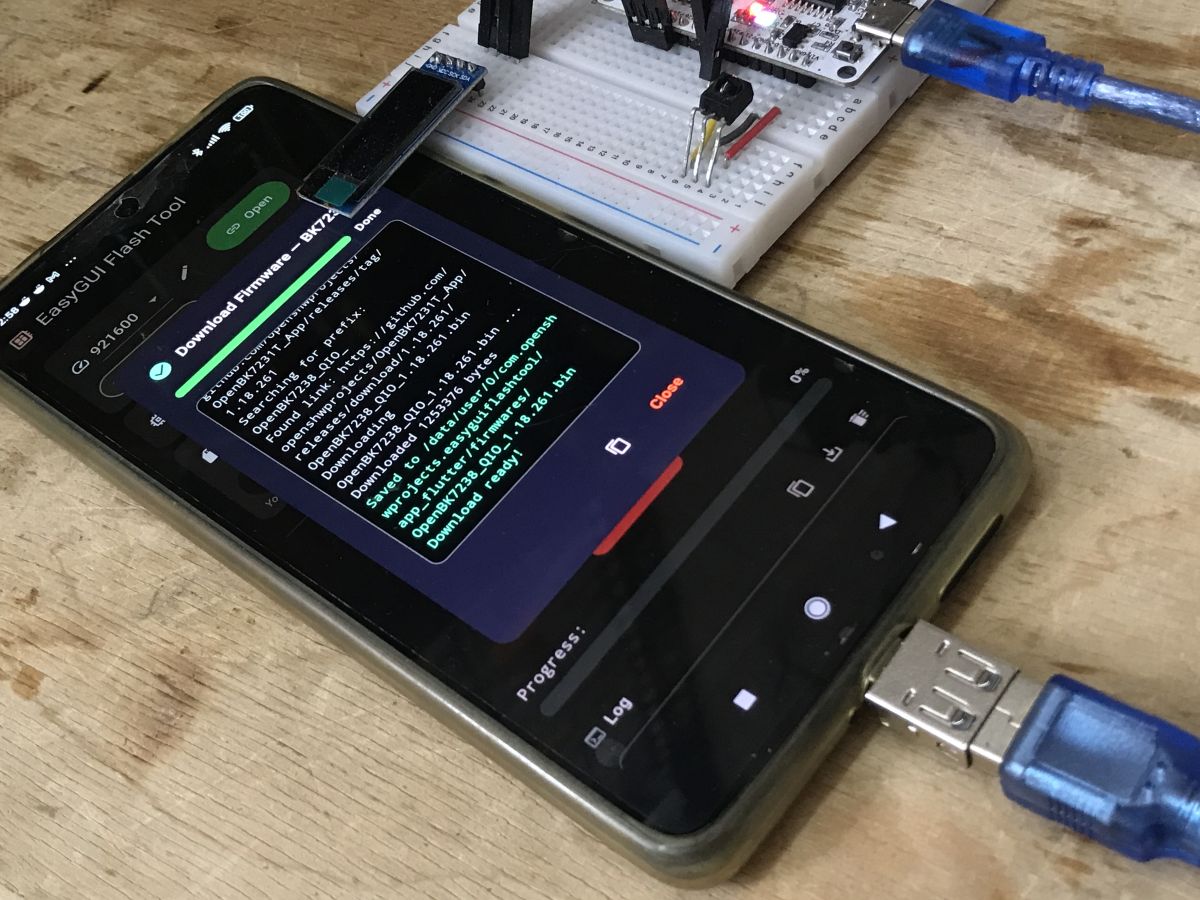

    Android Presentation

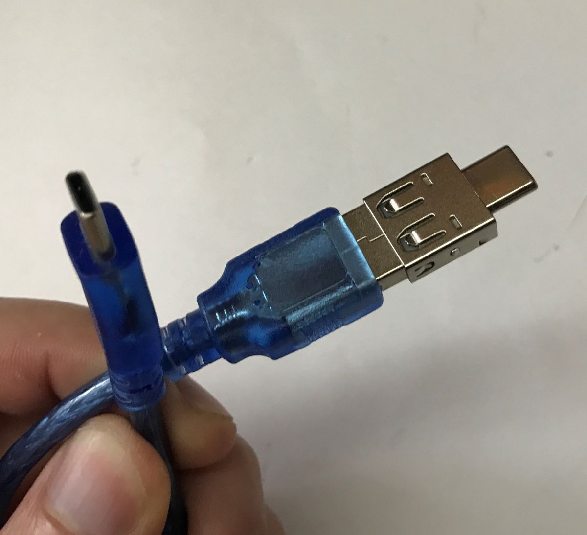

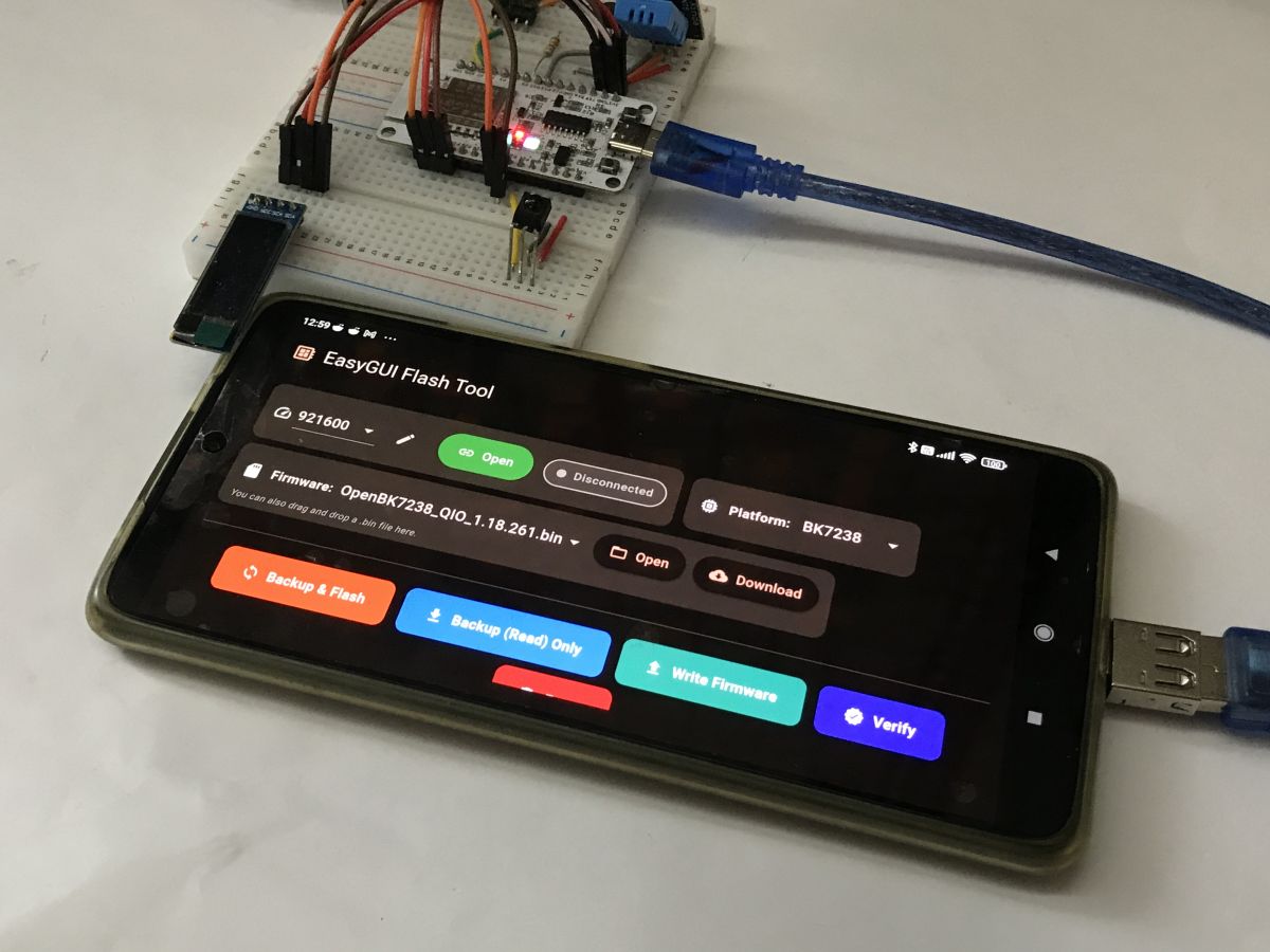

    The Android version is intended mainly for field work and quick device recovery.
    It requires connecting the target device using either:
    - USB-C to USB-C cable, or
    - USB OTG adapter
    Close-up of a blue USB cable with a USB-A plug and a small USB-C plug held in a hand.
    The application provides the same flashing logic as the web version, adapted to mobile UI constraints, and does not require root access.
    All flashing operations are performed locally on the device.
    Smartphone showing EasyGUI Flash Tool next to a breadboard with a module and USB cable
    Smartphone with EasyGUI Flash Tool next to a breadboard with a microcontroller, jumper wires, and USB cables
    Smartphone running EasyGUI Flash Tool connected via USB to a breadboard with an electronics module.

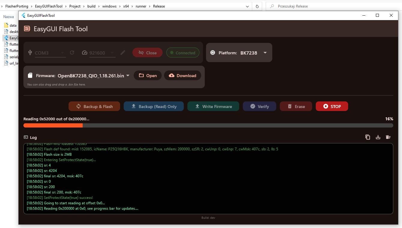

    Windows Presentation
    The Windows version runs as stand-alone application, it supports also a command line mode, same as main flasher.
    Screenshot of EasyGUI Flash Tool showing BK7238 connected and flash read progress bar.
    Still, currently it should be used only for testing, because on Windows we have a main mature version of our flasher:

  • #2 21842937
    Posts: 5125
    Help: 442
    Rate: 905

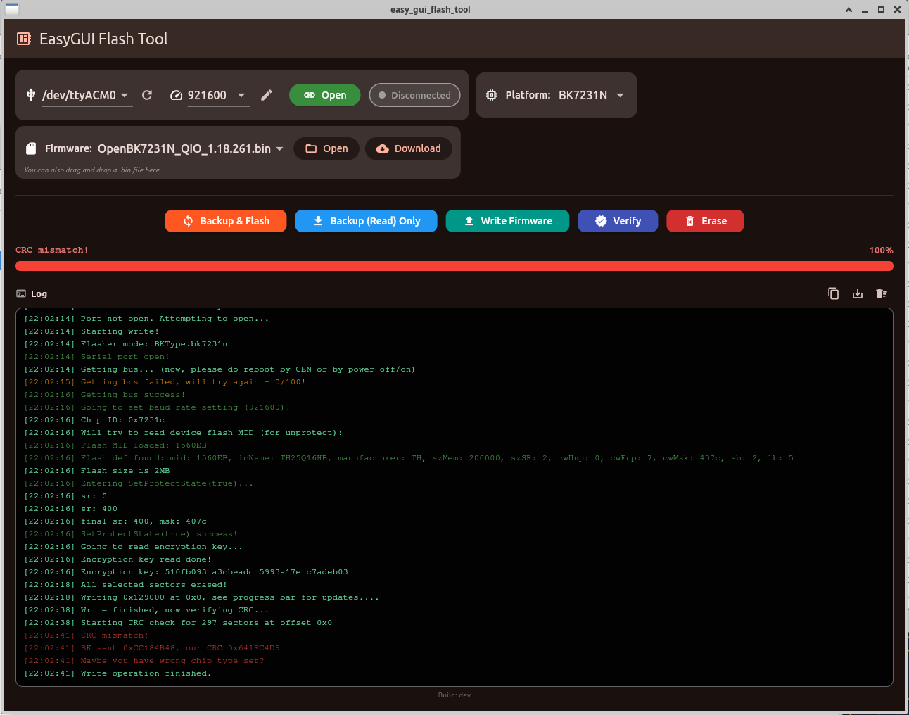

    this is exciting. I spent 5 mins on a quick Ubuntu test last night but BK7231N kept failing CRC after write. I see some newer builds have appeared since my attempt though, so will check again
    Screenshot of EasyGUI Flash Tool showing BK7231N selected and “CRC mismatch!” in the log
  • #3 21842978
    Posts: 14683
    Help: 656
    Rate: 12711
    I tested only BK7238 so it's possible that we have logical error on BK7231N, if CRC check fails. You'd need to compare with old flasher.

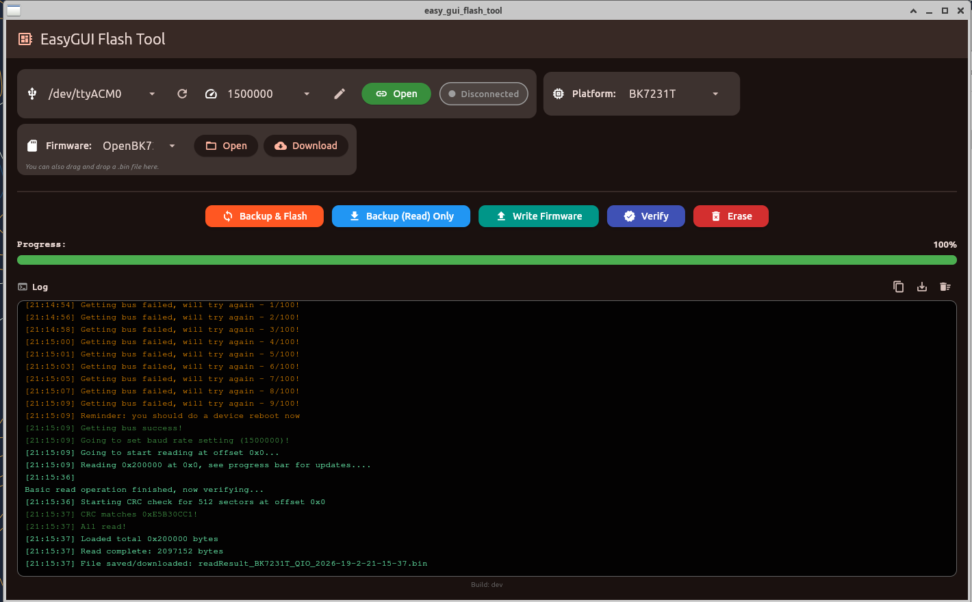

  • BK7231T read identified as QIO binary, not BK7231U
    #4 21843081
    insmod
    Posts: 1412
    Help: 164
    Rate: 445

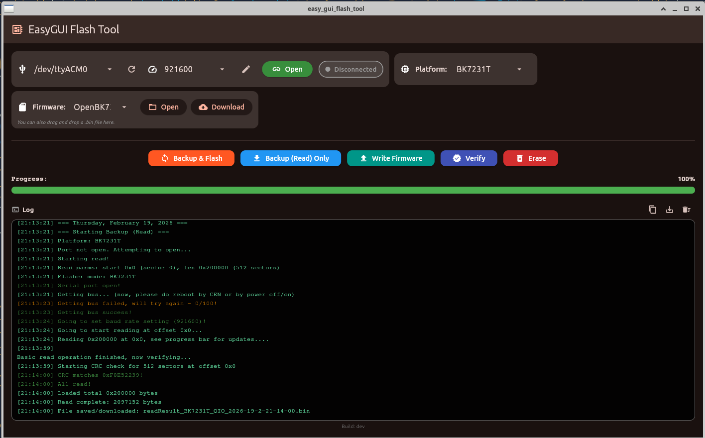

    BK7231T
    [14:28:30] Firmware selected: (none)
    [14:28:53] Port opened at 1500000 baud.
    [14:28:57] === Thursday, February 19, 2026 ===
    [14:28:57] === Starting Backup (Read) ===
    [14:28:57] Platform: BK7231T
    [14:28:57] Starting read!
    [14:28:57] Read parms: start 0x0 (sector 0), len 0x200000 (512 sectors)
    [14:28:57] Flasher mode: BKType.bk7231t
    [14:28:57] Serial port open!
    [14:28:57] Getting bus... (now, please do reboot by CEN or by power off/on)
    [14:28:58] Getting bus failed, will try again - 0/100!
    [14:28:58] Getting bus success!
    [14:28:58] Going to set baud rate setting (1500000)!
    [14:28:59] Going to start reading at offset 0x0...
    [14:28:59] Reading 0x200000 at 0x0, see progress bar for updates....
    [14:29:17]
    Basic read operation finished, now verifying...
    [14:29:17] Starting CRC check for 512 sectors at offset 0x0
    [14:29:18] CRC matches 0xEC4AB1C8!
    [14:29:18] All read!
    [14:29:18] Loaded total 0x200000 bytes
    [14:29:18] Read complete: 2097152 bytes
    [14:29:18] File saved/downloaded: readResult_BK7231T_UA_2026-19-2-14-29-18.bin
    "BKType.bk7231t" lowercase?
    readResult_*_UA? But resulting binary is QIO.
    No BK7231U.
    XR809?
    Interesting project overall.

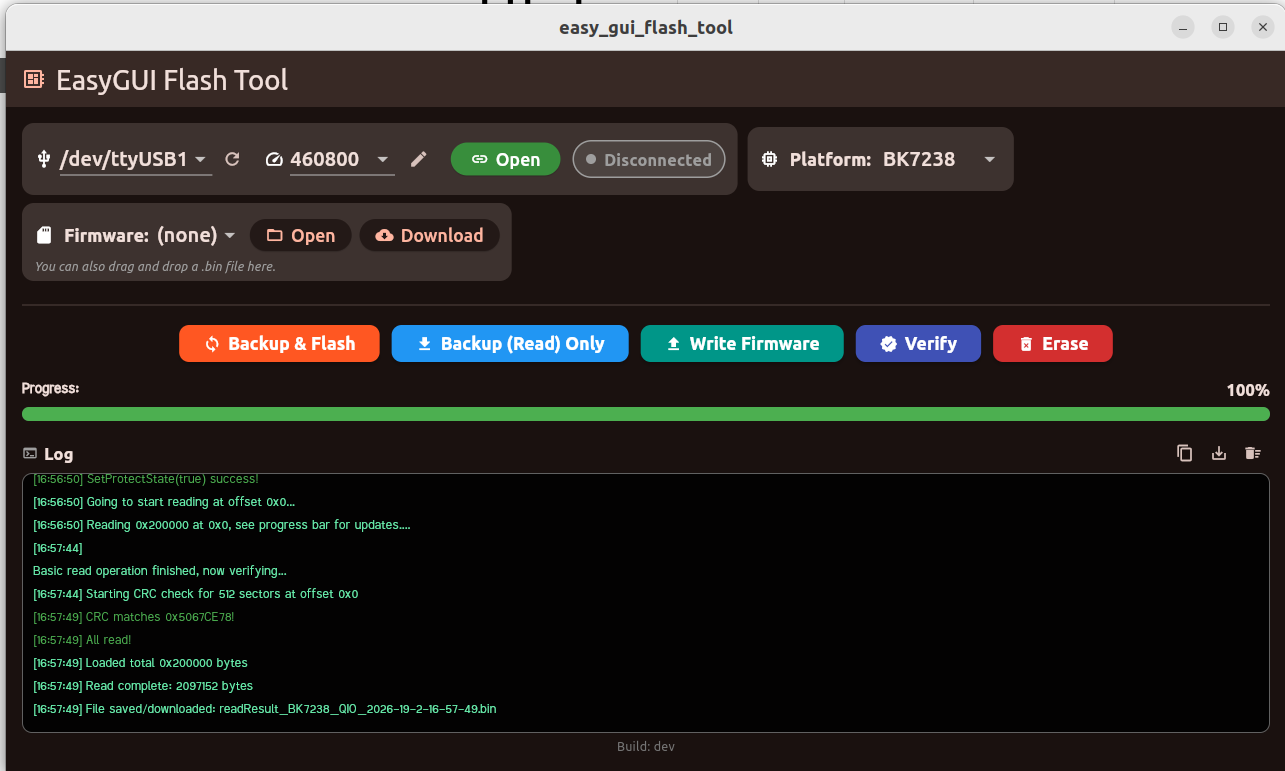

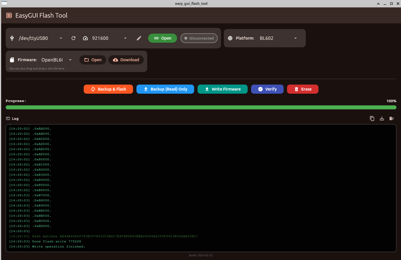

  • Ubuntu 22.04 required for glib 2.80 build
    #9 21843324
    max4elektroda
    Posts: 758
    Help: 49
    Rate: 189
    On Ubuntu 22.04 start fails due to missing glib symbol
    ~/Downloads/EasyGUIFlashTool-Linux/bundle$ ./easy_gui_flash_tool
    ./easy_gui_flash_tool: symbol lookup error: ./easy_gui_flash_tool: undefined symbol: g_once_init_enter_pointer
    g_once_init_enter_pointer is part of glib since 2.80,
    installed is 2.72.4 :-(
    Works when using 22.04 for workflow:
    diff --git a/.github/workflows/deploy.yml b/.github/workflows/deploy.yml
    index c453ec4..821264c 100644
    --- a/.github/workflows/deploy.yml
    +++ b/.github/workflows/deploy.yml
    @@ -18,7 +18,7 @@ concurrency:
     jobs:
       build-and-deploy:
    -    runs-on: ubuntu-latest
    +    runs-on: ubuntu-22.04
         environment:
           url: ${{ steps.deployment.outputs.page_url }}
    @@ -51,3 +51,4 @@ jobs:
           - name: Deploy to GitHub Pages
             uses: actions/deploy-pages@v4
    diff --git a/.github/workflows/release.yml b/.github/workflows/release.yml
    index 07ecb9b..b6b4212 100644
    --- a/.github/workflows/release.yml
    +++ b/.github/workflows/release.yml
    @@ -69,7 +69,7 @@ jobs:
               path: EasyGUIFlashTool-Windows.zip
       build-linux:
         steps:
           - name: Checkout
             uses: actions/checkout@v4
    @@ -183,3 +183,6 @@ jobs:
                 EasyGUIFlashTool-Linux.tar.gz
                 EasyGUIFlashTool-macOS.zip
    Only tried reading flash - higher speeds didn't succeed but 460800 worked:
    Screenshot of EasyGUI Flash Tool on Ubuntu with 100% progress bar and flash read log

    @max4elektroda fixed, downgraded to older ubuntu
    @insmod fixed combobox strangeness
    I have BL602 at hand, so BL602 port attempt next.

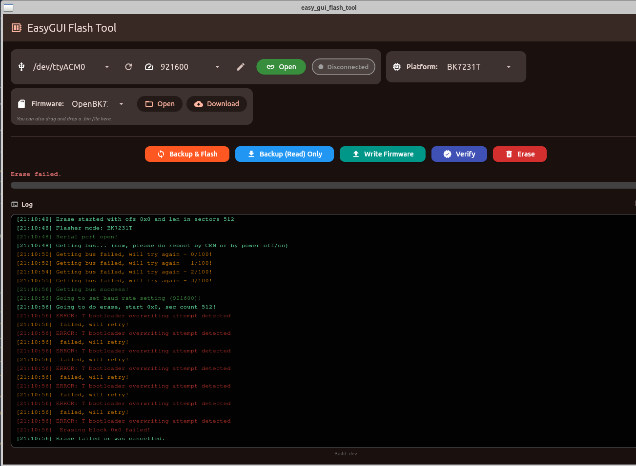

  • Erase and write fail on T, read works at 921600
    #13 21843633
    Posts: 5125
    Help: 442
    Rate: 905
    erase function on T tries from 0x0

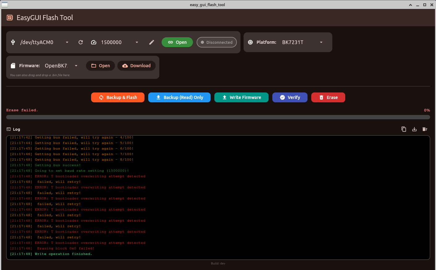

    backup and flash @ 1500000 - only does backup, doesn't start flash. took a few rsts to catch
    Screenshot of EasyGUI Flash Tool with 100% progress bar and operation log
    T write only - gets caught on same bl protection as erase
    Screenshot of EasyGUI Flash Tool showing “Erase failed” and an error log
  • #14 21843843
    Posts: 14683
    Help: 656
    Rate: 12711
    Thx. I added BK7231T and read and save fixes.

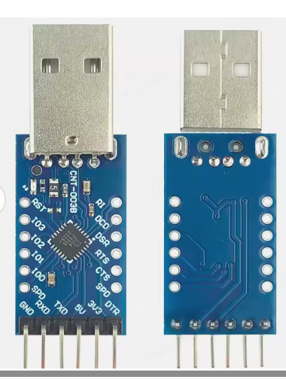

    Hello, i've a cp2104 usb to uart TTL
    Two blue USB modules with USB-A plug, shown front and back

    There is no AMS1117-3.3 on board, and I can't see any other LDO. This probably won't be enough.
    I mean, this requirement is general - it does not depend on used flash software. You just need a good power supply to do it.
    Alternatively, if there is AMS1117-3.3 on your smart device board, you could feed 5V from USB to the input of this LDO, to get 3.3V for WiFi module. This can also work.

  • Windows tool successfully read BK7231N at 921600
    #23 21844743
    defaliz
    Posts: 19
    Hi,
    Oh yes, i've don't try with this tool...
    I'll do the test today and give to you the result...
    Sorry for my poor english ..
    Added after 6 [hours] 58 [minutes]:
    ok test done with success
    with the windows tool
    https://github.com/openshwprojects/EasyGUIFlashTool/releases
    i successfull read and saved the chip , speed 921600 and platform BK7231N

  • Experimental BL602 port flashes reliably in download mode
    #26 21845852
    Posts: 5125
    Help: 442
    Rate: 905

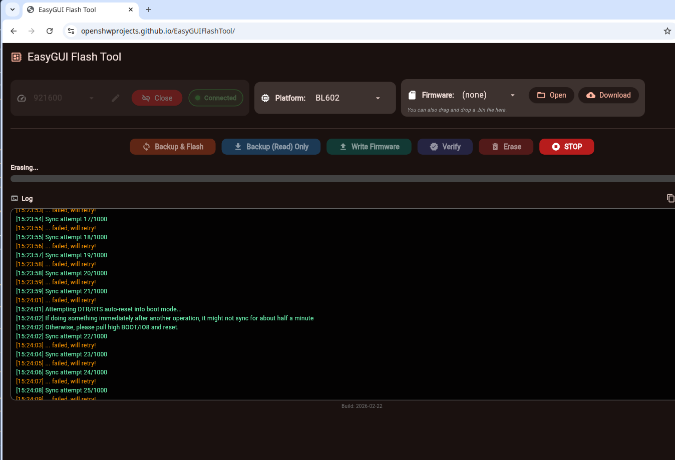

    I've pushed experimental BL602 port, seems buggy, sometimes works, sometimes not.
    EasyGUI - Linux binary v0.0.42
    my first BL602 attempt. backup-only worked first time at 921600. then backup and flash new worked at 921600, manual boot/rst required in the middle.
    Screenshot of EasyGUI Flash Tool showing /dev/ttyUSB0, 921600 baud, and a completed BL602 flash log
    it seems consistently able to flash and read if in download mode
    are you getting OpenBL602 to boot?
    I haven't tried browser yet. web flasher doesn't render for me at the moment.
    could do with a visible build number
    Added after 42 [minutes]:
    hmm. I see what you mean
    Screenshot of EasyGUI Flash Tool showing sync failures in the log and status “Connected”
    doh. I guess it doesn't do the bl etc yet

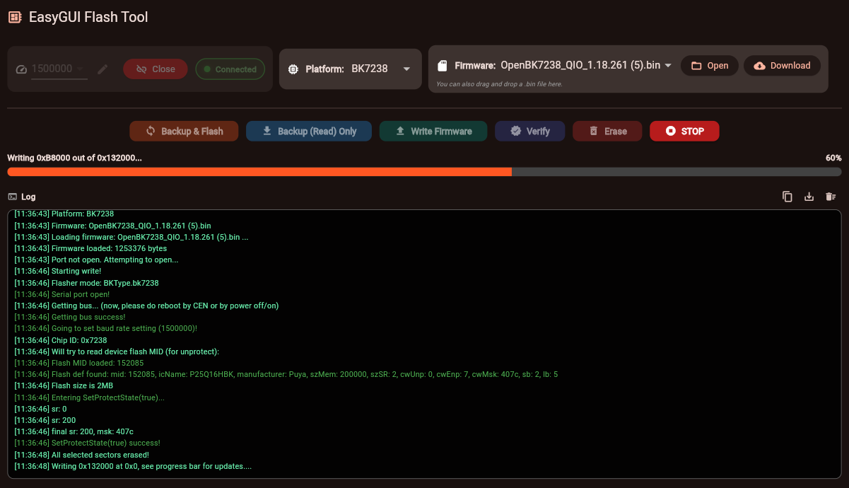

  • #27 21845945
    defaliz
    Posts: 19
    hi,
    i've try flashing another LSC Action plug , impossible with the GUI browser tool
    OK with EasyGUIFlashTool
    i've an error at the end of the process ( CRC mismatch) but firmware was downloaded and wifi and web page are ok
    17:17:58] All selected sectors erased!
    [17:17:58] Writing 0x129000 at 0x0, see progress bar for updates....
    [17:18:15] Write finished, now verifying CRC...
    [17:18:15] Starting CRC check for 297 sectors at offset 0x0
    [17:18:17] CRC mismatch!
    [17:18:17] BK sent 0x8166DF0A, our CRC 0xBA9C4957
    [17:18:17] Maybe you have wrong chip type set?
    [17:18:17] Write operation finished.
  • #28 21846886
    Posts: 14683
    Help: 656
    Rate: 12711
    Did you select wrong BK7231 type?

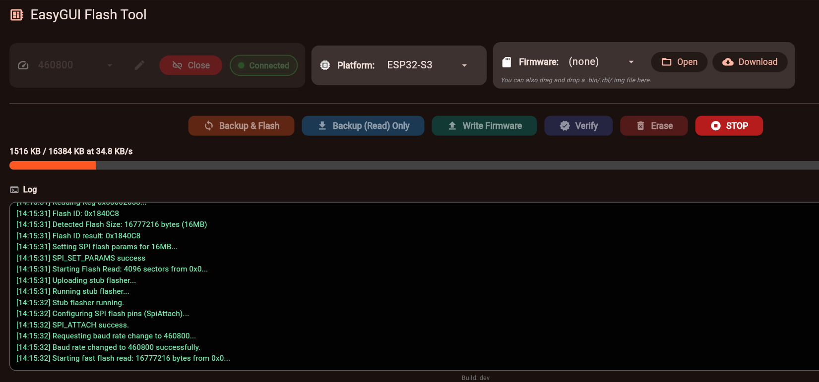

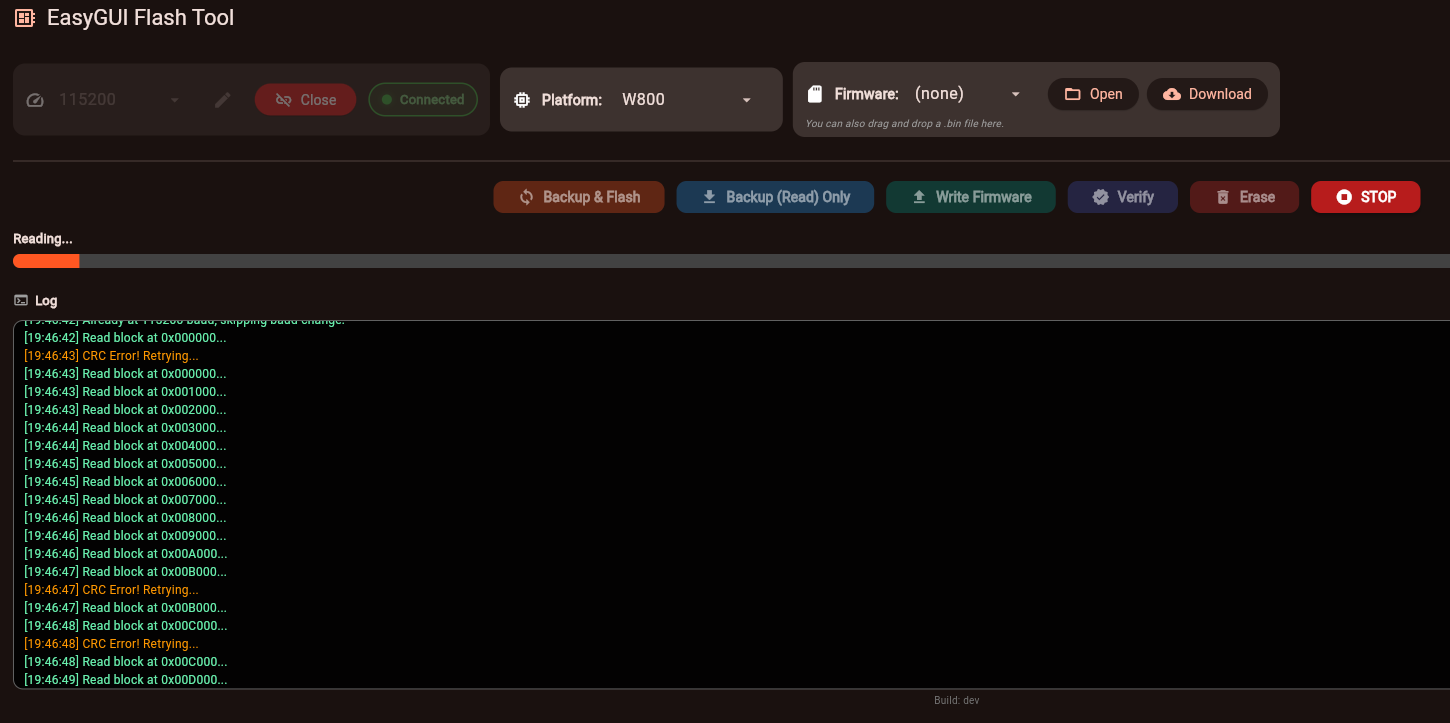

    W800 progress:
    EasyGUI Flash Tool screenshot: W800 selected, “Reading…” progress bar and log with CRC errors during read
  • #29 21847481
    Posts: 14683
    Help: 656
    Rate: 12711

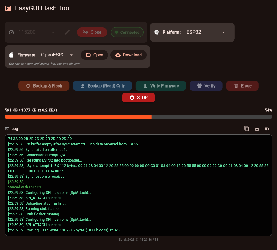

    Now both ESP32 and ESP32-S3 should work:
    Screenshot of EasyGUI Flash Tool showing progress bar and log during ESP32-S3 flash read
