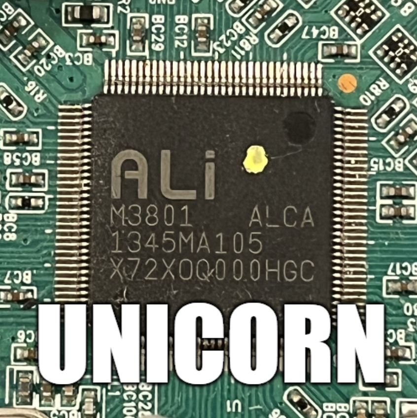

    Here I will show my first attempt at building an emulator for the ALI M3801 microprocessor based on off-the-shelf Unicorn and Capstone modules. The developed program will load the contents of the Flash memory and execute it similarly to a real physical CPU, although it will not be without modifications and fixes, as Unicorn/Capstone do not implement the full logic of a particular SoC or its peripherals. In addition, the whole thing will be able to correctly handle sending data over the UART, i.e. it will emulate the register responsible for transmitting bytes over the hardware serial bus. In this way, we will get the same messages in the console that running a programme on a real ALI chip would show.

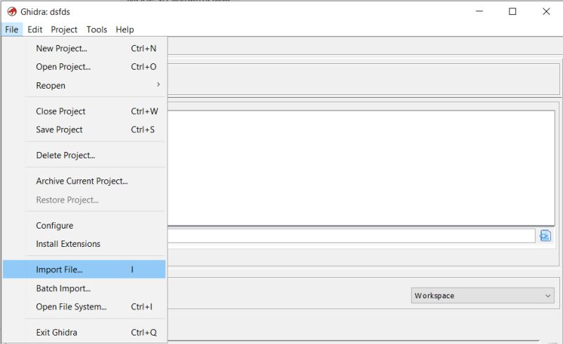

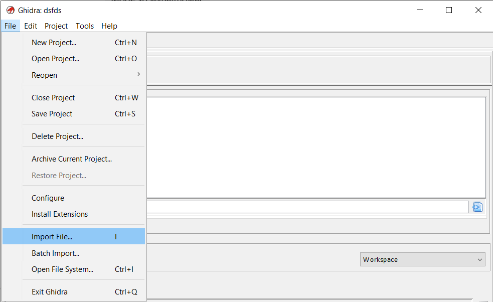

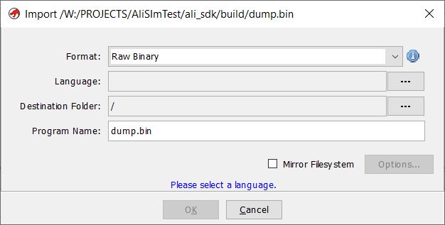

    Importing firmware in Ghidr
    Open Ghidra, create a new project, do File->Import File:
    Screenshot of Ghidra with the File menu open and “Import File…” highlighted.
    Before importing the file, you need to configure it properly.
    Ghidra import dialog showing “Format: Raw Binary” and program name “dump.bin”.

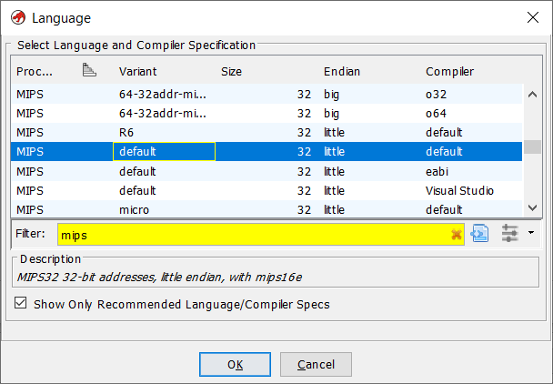

    Set the architecture: MIPS Little-Endian. MIPS is a RISC architecture and Little-Endian specifies the order in which bytes are stored in memory.
    Ghidra “Language” dialog listing MIPS variants, with filter “mips” and a selected 32-bit little-endian option.

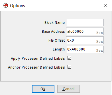

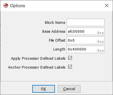

    Set base address: afc00000. The base address is the fixed starting address of the memory area. It serves as a reference point for further addressing of data or registers, without a correct base address the jump instructions would go to the wrong place.
    “Options” dialog showing Block Name, Base Address afc00000, File Offset 0x0, and Length 0x400000.

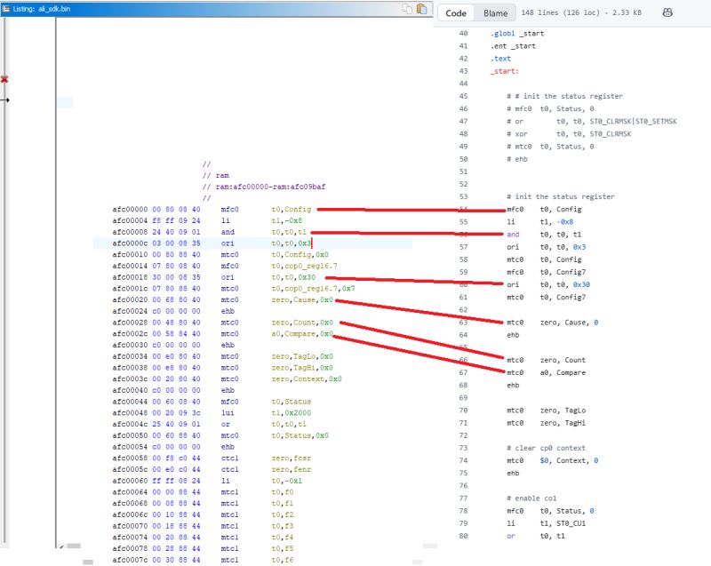

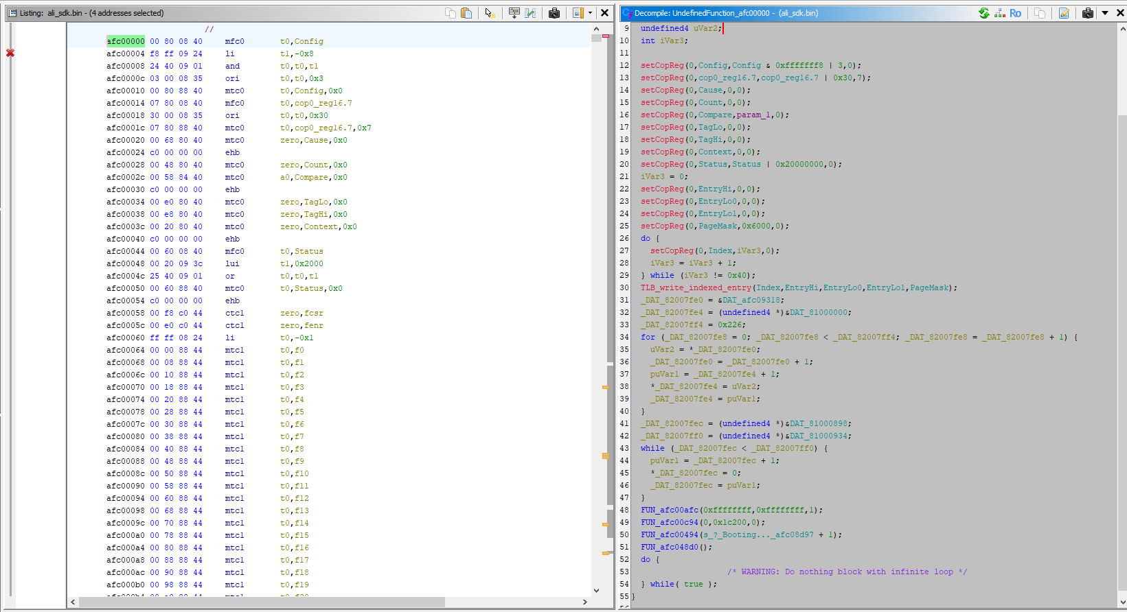

    When opened, Ghidra gives us two views. The first time we have to wait for the decompilation to finish, but after that everything works smoothly.
    The first view is directly the bytes of the opened file but mapped to the base address - hence the addresses start with AFC. Next to them we have the decompiled commands with their arguments.
    The second view is C pseudo-code, which tries to show what the function would do in C - as much as it can. A lot of information is lost when compiling, so we don't even have variable names or the exact syntax here as it was in the source code.

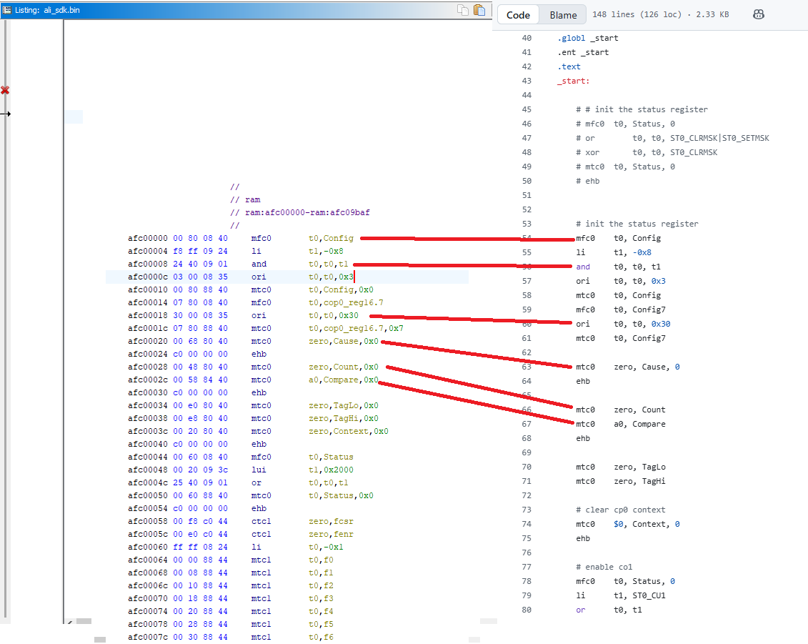

    Screenshot of Ghidra showing MIPS assembly listing and decompiled C-like pseudocode side by side
    In this case we have the source code of the decompiled program, so we can compare and check. The startup routine is partly written in assembler and partly in C:
    start.S:
    Code: text
    Continued in C:
    entry.c:
    Code: C / C++
    You can easily compare the two files:
    Screenshot comparing MIPS disassembly listing in Ghidra with source code on the right, linked by red lines

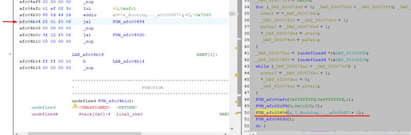

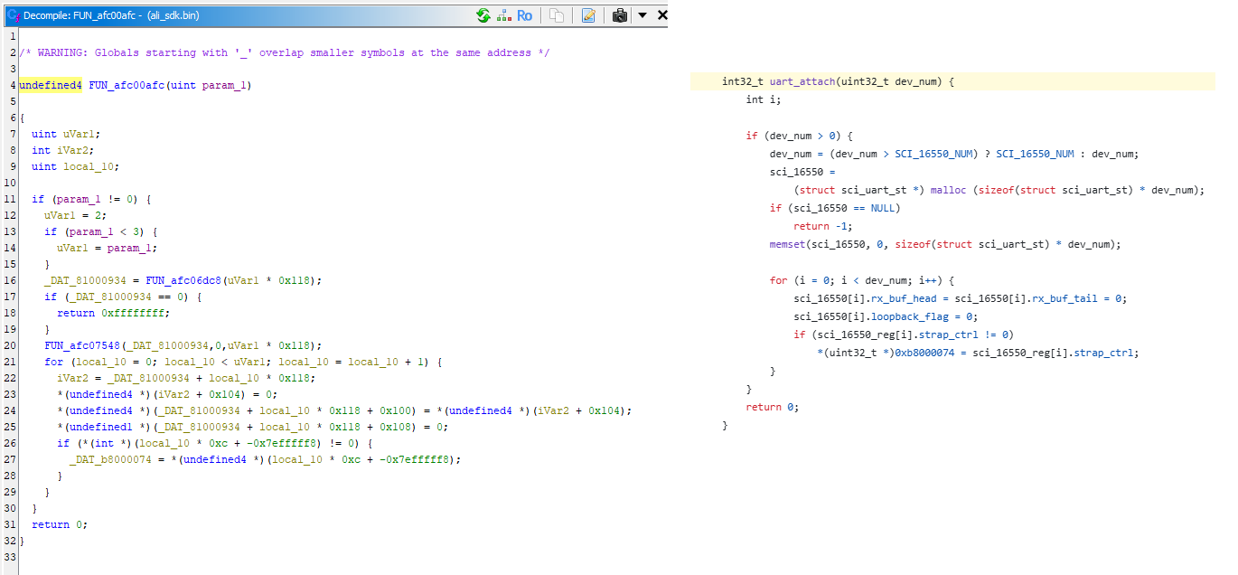

    You can see here, for example, that FUN_afc00afc(0xffffffff,0xffffffff,1); is uart_attach
    Ghidra screenshot showing decompilation and C source for the uart_attach function

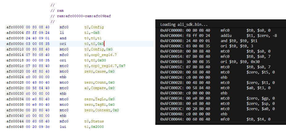

    Deassembly in Python
    Let's start with the simplest one. This example shows a simple disassembly of a binary code after a given address in Python. The binary is loaded into memory at the specified base address, without running or emulating instruction execution. The Unicorn engine is only used here to map the memory, while Capstone reads the bytes from under the specified address and translates them into MIPS assembler instructions. This allows the contents of the ROM code to be quickly previewed in human-readable form and compared with what Ghidra shows.
    Code: Python
    As a test, I read the first few dozen instructions. Virtually everything agrees:
    Screenshot comparing MIPS disassembly in Ghidra with console output from a program
    The only difference is li (in Ghidra) which the Python program shows as addiu. This is because li is not an actual MIPS processor instruction, but an assembler pseudo-instruction. In firmware, there is an actual addiu (or sometimes lui + ori), which Capstone shows explicitly, while Ghidra simplifies the notation to li for readability.

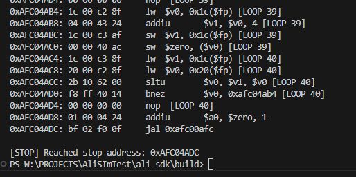

    Stopping at an instruction
    Another useful mechanism that I have decided to implement is to stop the program on a command with a given address. This allows me to easily check if the executed program reaches a certain point, whose address I find in Ghidra. You could say that this is a simple breakpoint, like in a debugger. For the moment, it is enough for me to define the STOP_INSTR variable in the code.
    Code: text

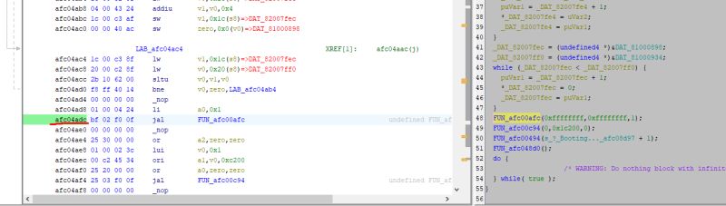

    This is where Ghidra came in handy again. There I selected the address at which I want to stop the execution of the commands (afc04adc) and then verified the program trace to make sure everything was correct. This is very convenient and useful for testing and verifying that the program is running correctly.
    Ghidra screenshot showing MIPS disassembly and C pseudocode; the line at address AFC04ADC is highlighted.
    Screenshot of a terminal showing MIPS emulation trace and stop at address 0xAFC04ADC

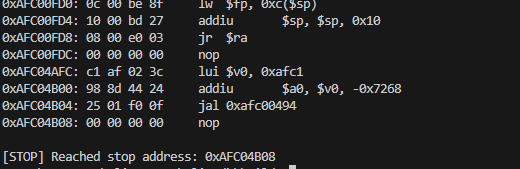

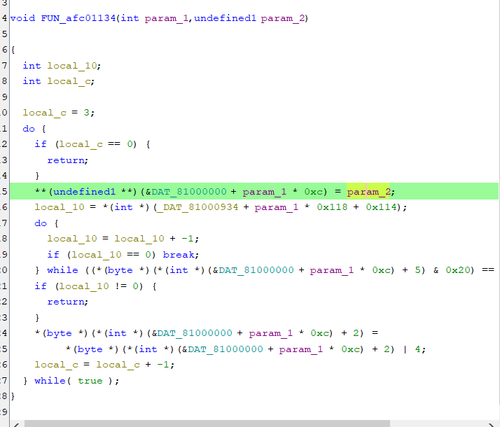

    Fine UART initialization fix
    The program, prepared in this way, was already reaching uart_set_mode, but was showing an access error when trying to write data to the UART register.
    Code: C / C++
    These registers were not mapped to memory:
    Code: C / C++
    I had to add their mapping:
    Code: Python
    After this change, the emulator gets as far as 0xAFC04B04, which is where the text data will be sent:
    Ghidra screenshot showing MIPS disassembly and C pseudocode with a highlighted function call
    What's more, the function itself from the display also executes. I set the endpoint right after it, and there are no errors.
    Terminal screenshot showing MIPS emulation trace with assembly instructions and a stop message at an address

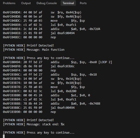

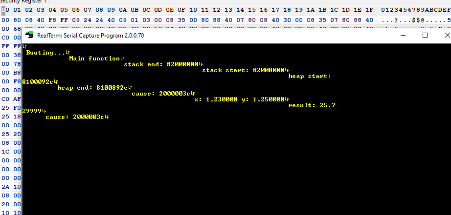

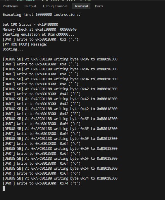

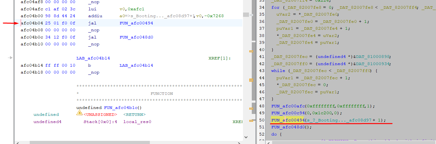

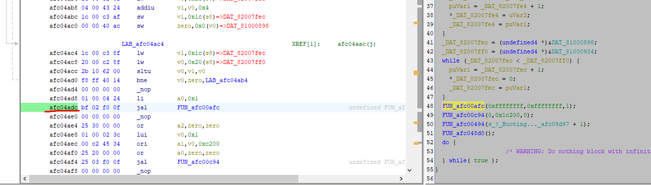

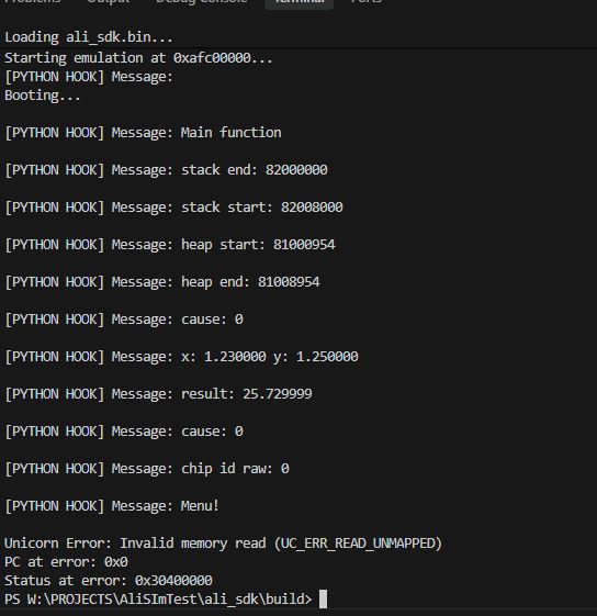

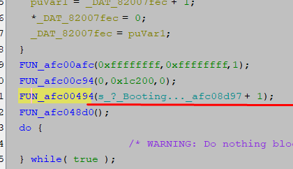

    Interrogating the text display
    Unfortunately, full support for text display would require emulation of the UART along with reading its register used to send data. For now, we'll keep it simple and just capture the printf function itself. In Ghidra, it is easy to trace it because its argument is a character string:
    Ghidra screenshot with function calls; the line containing “Booting...” is underlined in red.

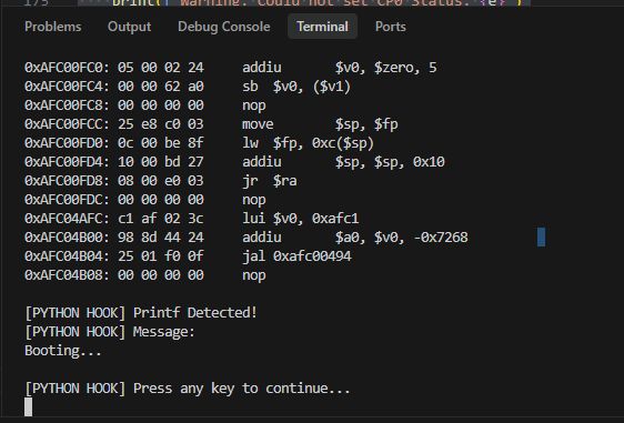

    We can intercept its call and artificially skip its execution:
    Code: Python
    Result:

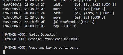

    Terminal screenshot showing MIPS instruction trace and “[PYTHON HOOK] Printf Detected!” message
    Terminal screenshot showing MIPS emulation trace and “[PYTHON HOOK] Printf Detected!” messages

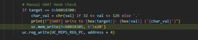

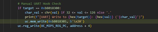

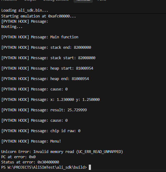

    Well, yes, but now printf-style formatting of variables doesn't work. No wonder, our Python function displays blindly. Maybe it's better to look at the printf source code:
    Code: C / C++
    The formatting can be emulated and we plug in fwrite though. Here, however, was a problem that took me a long time, but I will keep it to a minimum for you. It seems that the execution of the sb/sw commands , i.e. the instructions responsible for writing to memory, is not working.
    I have implemented their manual execution:
    Code: Python
    And this is what the hook on fwrite looks like:
    Code: Python
    Result:
    Console screenshot showing Python hook “fwrite Detected” and a MIPS instruction trace with 0xAFC00AAC addresses
    Agrees with the one from the CPU:
    Screenshot of RealTerm showing UART logs: “Booting…”, stack/heap addresses, and a calculation result.
    All text, after turning off showing instructions:
    Terminal screenshot with emulator logs and “Invalid memory read (UC_ERR_READ_UNMAPPED)” error
    Not too bad, even operations on floating point numbers work.

    Terminal screenshot showing MIPS emulation logs and intercepted UART writes

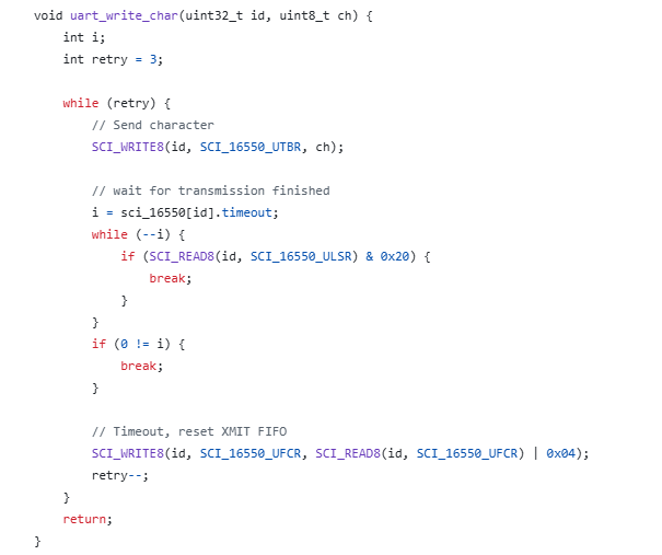

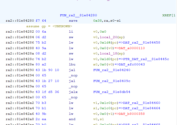

    Eventually the UART sends the data, but something is wrong. The data is repeated three times. An explanation of this will be found below:
    Screenshot of Ghidra showing C-like pseudocode with a highlighted memory assignment line
    C function uart_write_char code for UART communication with retry mechanism
    The firmware checks to see if the UART acknowledges the sending of the data and, if not, performs the transmission again. All in a loop, in a blocking manner. So we still need to include the transmission acknowledgement flag.
    To do this, we need to simulate bit 0x20 of SCI_16550_ULSR. We can do this as soon as a byte is sent. Very simple:
    Python code fragment with UART memory write condition and status simulation
    Full code:

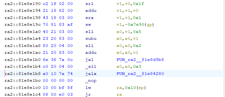

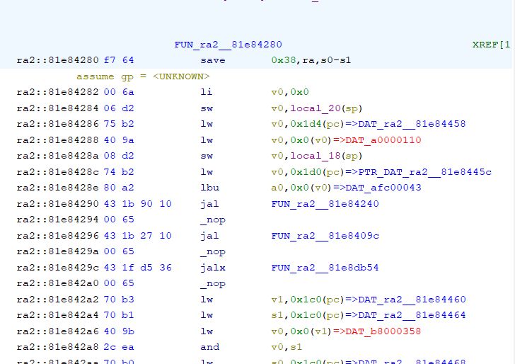

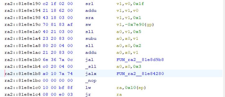

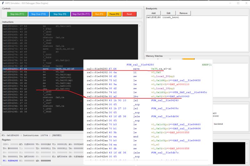

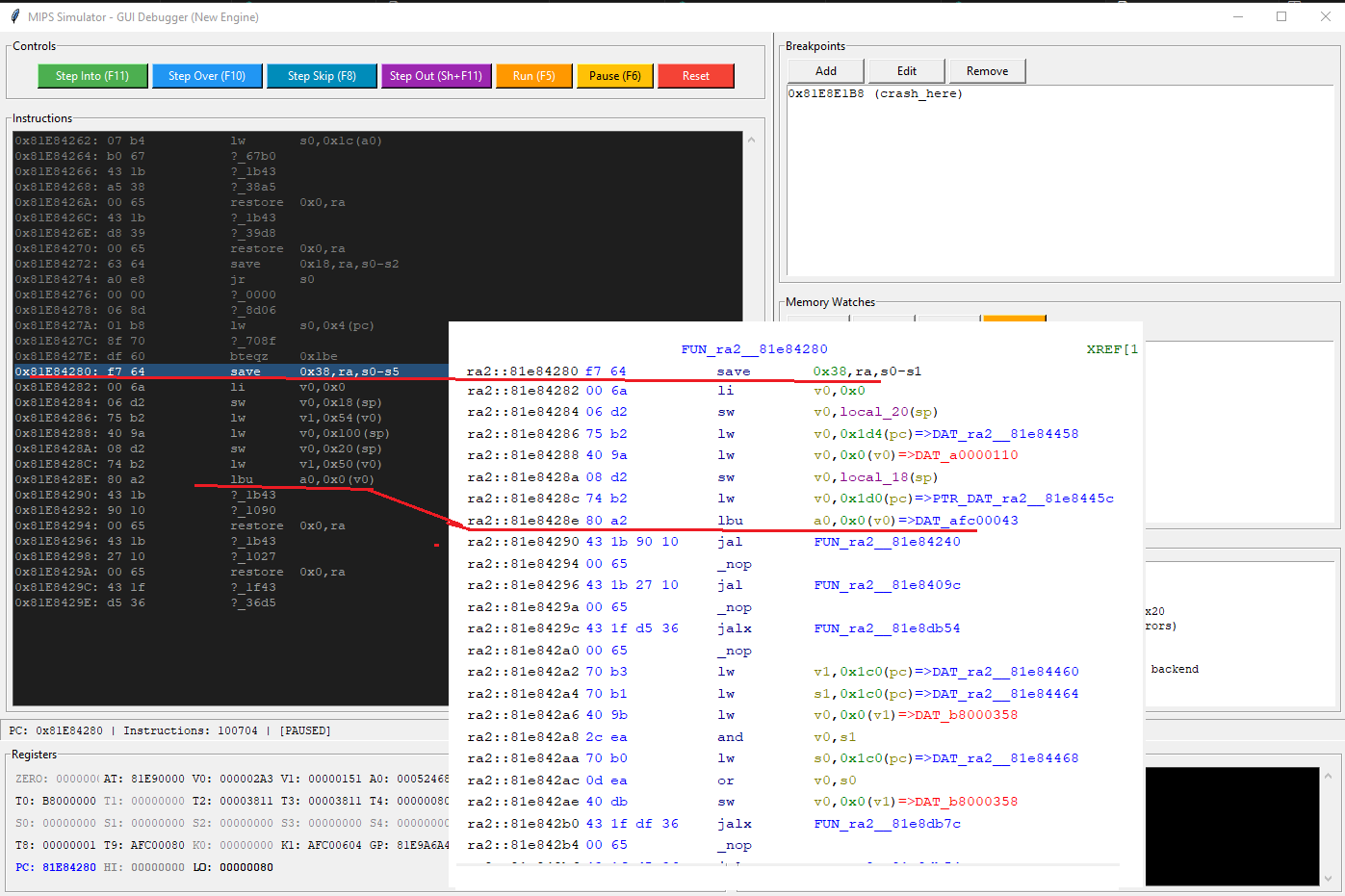

    The main problem that is still to be solved is the 16-bit MIPS commands, these occur sporadically on the original upload from ALI:
    Screenshot of disassembled code showing mixed 16- and 32-bit MIPS instructions
    And moments later:
    Screenshot of decompiled MIPS code with mixed 16- and 32-bit instructions
    The emulator used does not seem to support this, so there will be further combinations.

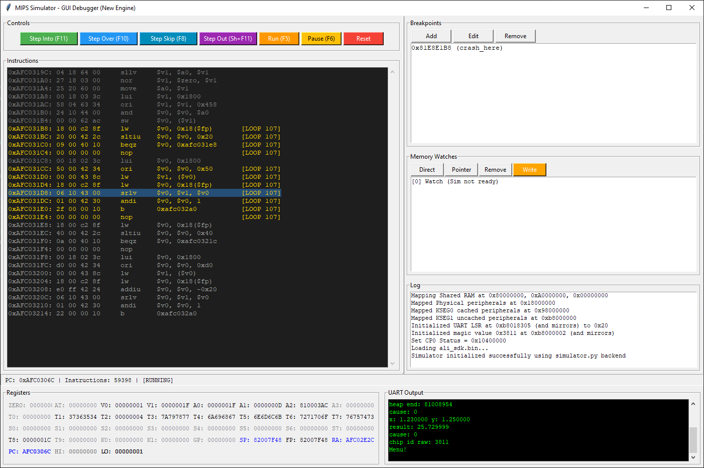

    Here's a little preview of the next topic:
    MIPS debugger window showing assembly, registers, and UART output

    A small update as to the fun of emulating.
    As I suspected, I'm stuck on those 16-bit instructions for now. Without them, I won't even for a good while start executing the actual bootloader from the DVB receiver, and Unicorn/Capstone won't decode them for me. I'm trying manually for now. Below is a screenshot from me of the program with a screenshot from Ghidr superimposed:
    Screenshot of MIPS debugger with highlighted SAVE instruction and disassembled code view
    Much of the bootloader is written this way, so there is no way out, you have to support 16-bit instructions too.
    I'm testing on an insert from here:
    https://github.com/openshwprojects/FlashDumps/tree/main/Sat/Comsat%20TE%201050%20HD

    At the moment the problem is with 16-bit inserts. Capstone/Unicorn doesn't seem to support them (I couldn't get it to do so), so I have to combine manually. Unfortunately they are repeated repeatedly in the actual bootloader. What I have can extract it to RAM and start executing it, but then there are problems.
    Custom compiled batches work 100% because they don't have 16-bit instructions.
    If you want to join forces and experiment with it, I'll show you how many I have, but it's a mess and on top of that I warn you that I backed up with LLMs.

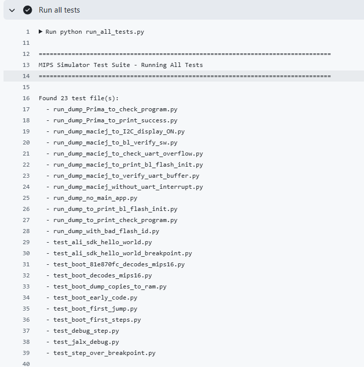

    In addition, there are some simple program tests - run_all_tests.py. These verify that the right system is decompiling the instructions (also the 16-bit ones) according to Ghidra, as well as checking that I haven't messed up the UART in the program from the first post. This allows you to experiment and iterate quickly without worrying about messing things up.
    This is what the program test from the first post looks like:
    Code: Python
    And yes a test if the right first bootloader from ALI copies well to RAM:
    Code: Python
    And this is what the mips decoding test looks like - verifying that my code sees the same thing as Ghidra:
    Code: Python
