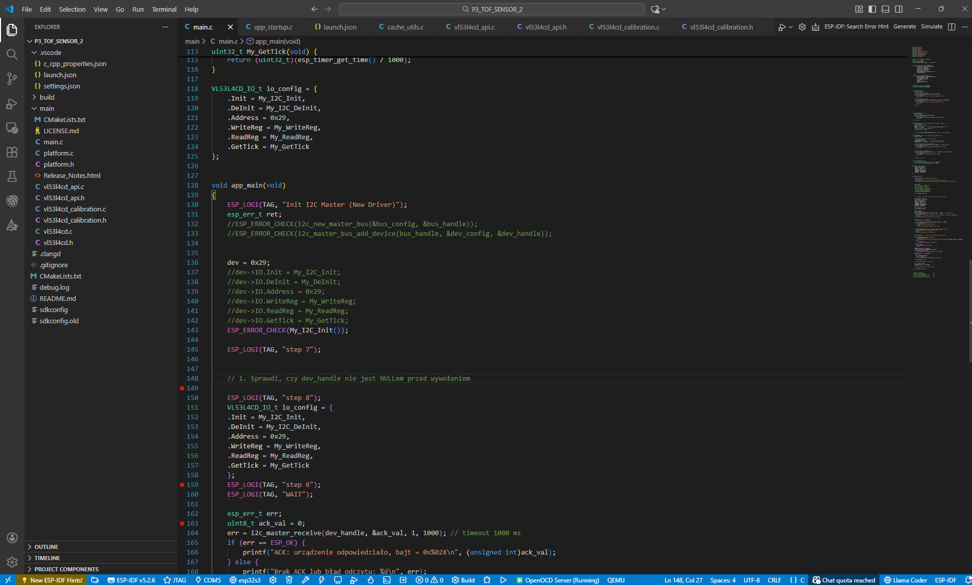

    Good day, I am programming an esp32s3 microprocessor in an ESP-IDF environment. I would like to connect it with one sensor (in the future with four) TOF VL53L4CD from ST Microelectronics (LINK1). I managed to establish communication with the sensor in the Arduino IDE, it works fine there without problems. In ESP-IDF I also manage to communicate with the sensor via i2c. However, I am a beginner and I am having a lot of problems implementing the library for this sensor (LINK2). I get an error when calling the function VL53L4CD_SetI2CAddress() :
    Code: text
    I get a Guru Meditation error when calling this function:
    Code: text
    Line 48 in the platform.c file is :
    Code: text
    I used the debugger and it turned out that the indices
    Code: text
    and
    Code: text
    have the value 0x00 despite their previous declaration :
    Code: text
    If there is a knowledgeable person on the forum who would be willing to help me, I would be grateful. I am using ESP_IDF via Visual Studio Code
    VS Code screenshot showing ESP-IDF project code for VL53L4CD I2C init and IO callbacks

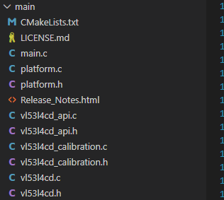

    , I have imported all the files from the sensor library into the main folder for convenience I hope this is not a problem:
    View of the main folder in Visual Studio Code with VL53L4CD project files

    What is a dev_t? Rather than an address, but a pointer to an object?
    Code: C / C++
    Why are you setting it to 0x29?
    Code: C / C++
    It should rather be an object created by malloc() or by a function designed for this purpose, I am not familiar with this library.

    As far as I know this dev_t is a pointer to a VL53L4CD_Object_t:
    Code: text
    this is the code from the platform.h file.
    Actually I guess it doesn't make sense to write any value like that since it's a pointer, I corrected the code to make it more readable
    Code: C / C++
    Need to use VL53L4CD_RegisterBusIO with io_config

    Since it is a pointer to an object of type VL53L4CD_Object_t, by setting it to 0x29 you are pointing to a memory cell with that address, no wonder there is a crash.
    Is your new code complete?
    For example, I don't see you using there:
    Code: C / C++

    After removing the dev indicator definition
    My dev->IO.WriteReg is still 0x00. Is there any way to write a value to this object?
    Debugger screenshot: Dev struct with IO fields set to 0x0 and C code calling Dev->IO.WriteReg
    Sorry for my non-technical language, I am just learning :)

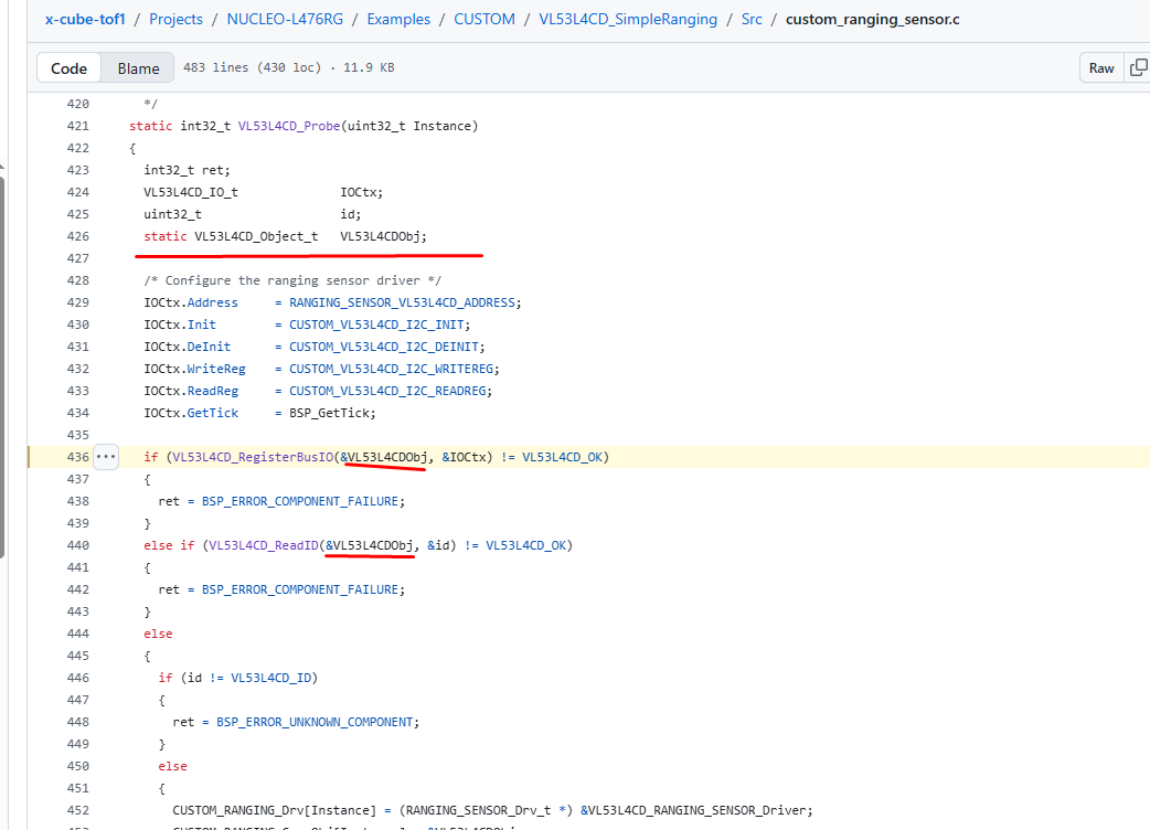

    The problem is more on the side of C-language knowledge, not ESP.
    You have in the code:
    Code: C / C++
    Dev_t is defined as a pointer to this object, a pointer uninitialised as a global variable has a value of 0. It points into the void, there is no object.
    For this object to exist, you must first create it. You can do this by using malloc.
    You can also make this object as a global variable, e.g:
    Code: C / C++
    and then instead of dev give &myObject(pointer to myObject).
    I'm sure it will help you a lot if you read up on pointers in C, etc, as this limits your work with ESP.
    You can also look generally at how others are using this library, e.g. by searching on GitHub:
    Screenshot of code editor showing VL53L4CD_Probe function using VL53L4CDObj object

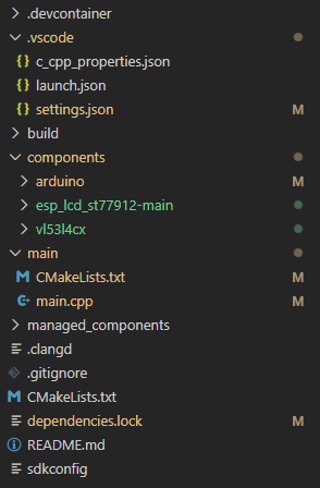

  • Arduino library workaround for VL53L4CX in ESP-IDF
    #12 21840144
    kaczmarekabt
    Posts: 9
    Good morning, I managed to solve the issue, I used the Arduino engine as the library in ESP-IDF and the STM32duino VL53L4CX library for the Arduino. I copied the STM32duino VL53L4CX library manually into ESP-IDF. This is what my files look like:
    VS Code screenshot showing an ESP-IDF project tree with components and main folders
    Here we have the arduino library, the vl53l4cx (STM32duino VL53L4CX) and the library for the display (that's a topic for a separate thread). The main code is written in C++ and not C as in ESP-IDF, nevertheless most of the code written for ESP-IDF can be adapted to C++ standards quite easily.
