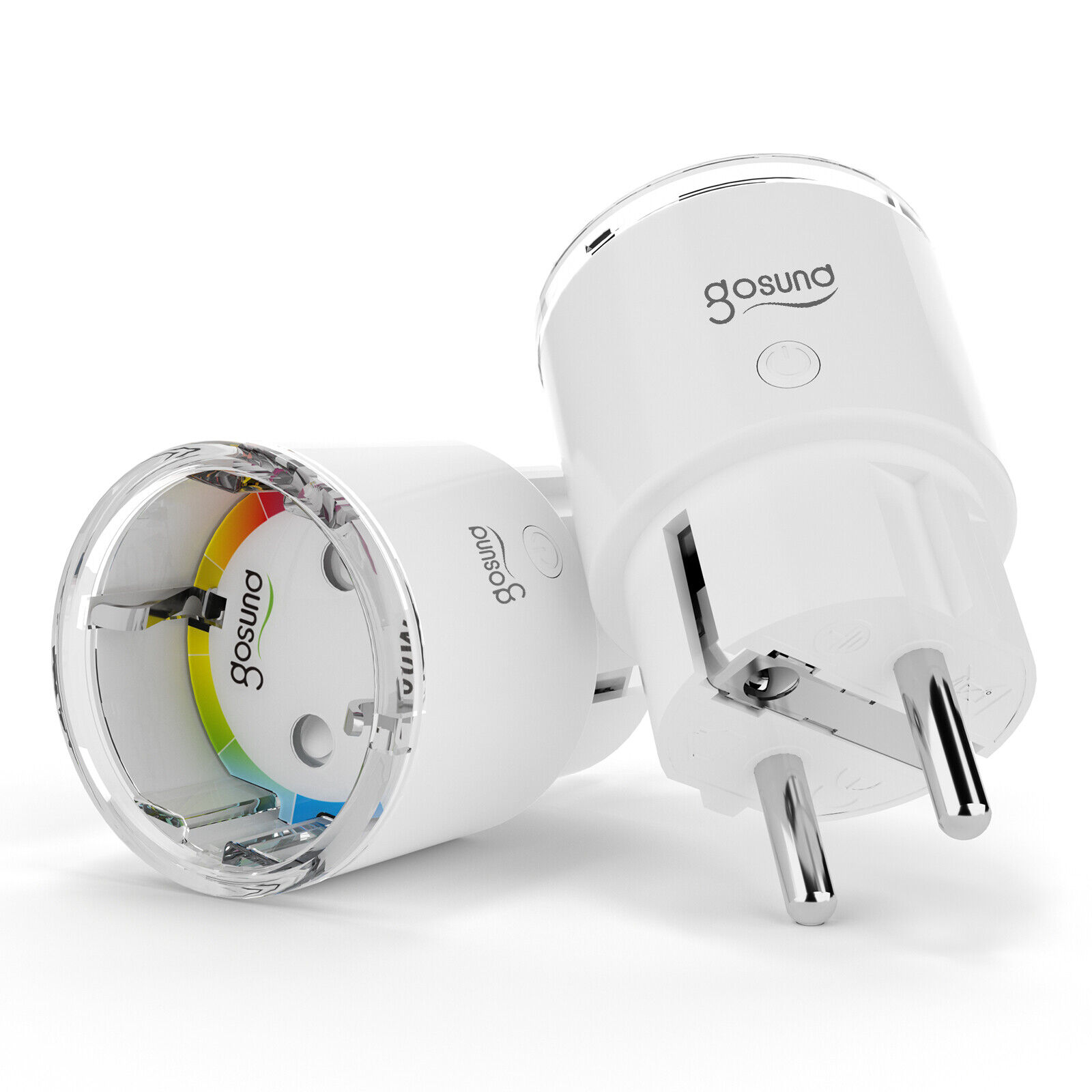

    Two white Gosund smart plugs with EU pins; one shows the front with power button
    I found in the appendages a similar socket to the author of this topic. Based on the information there, I decided to make it cloud free and change the firmware to OpenBeken. Everything seems to be working, including the power measurement. I'm attaching the configuration below, as although there are templates for EP2 I couldn't find a ready-made one for this version anywhere.
