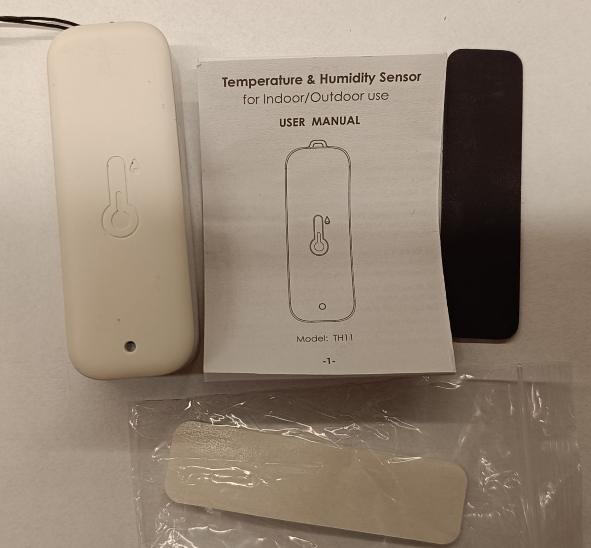

    This is another WiFi temperature sensor that works with the Tuya/Smart Life system as standard. It is an IP65-rated version for outdoor placement. The sensor is powered by two AAA batteries and is based on the CB3S module and the TuyaMCU microcontroller - here, as usual, the sensor was purchased to convert to OpenBK, i.e. to work with Home Assistant bypassing the Tuya cloud.

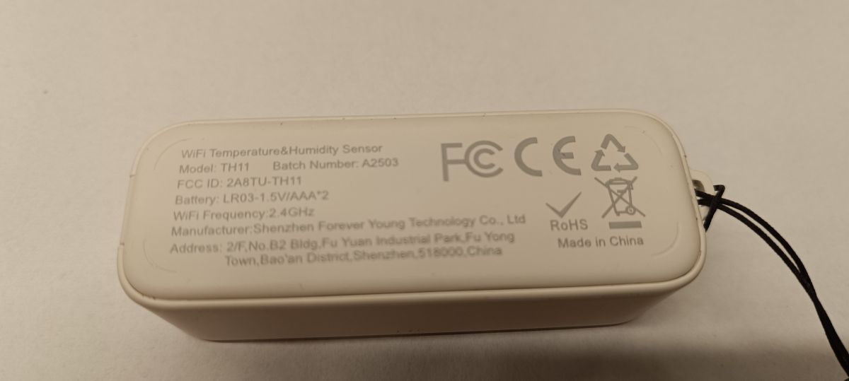

    What we get in the box
    Here, without much surprise, a short instruction manual, the sensor itself + pendant and the mounting tape and magnetic tape.
    TH11 temperature and humidity sensor with manual and mounting accessories Close-up of the back of a TH11 temperature and humidity sensor with technical details Opened housing of a sensor showing dual AAA battery slots
    User manual for TH11 temperature and humidity sensor, showing specifications and instructions Tuya temperature and humidity sensor manual with installation and feature guide

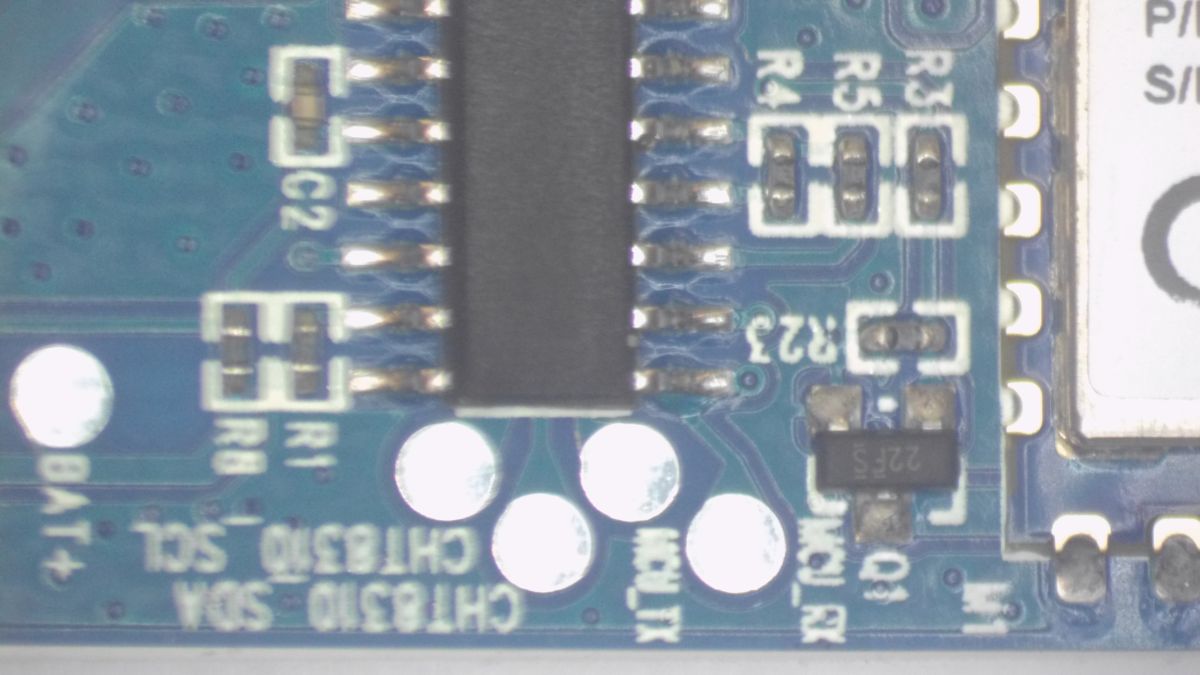

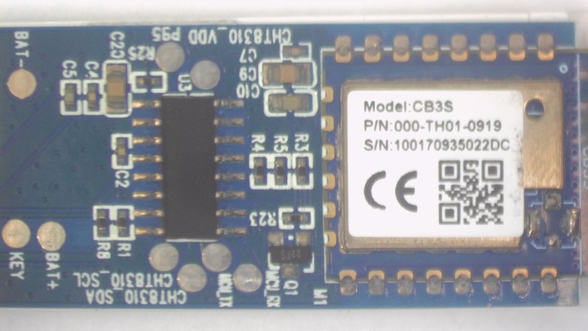

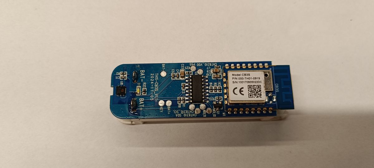

    Interior sensor
    Here, as expected, there is not much :) That is, what was mentioned the module CB3S with BK7231N chip, TuyaMCU that is an unknown microcontroller, transistor Q1 controlled by TuyaMCU chip (U3) whose task is to cut the ground from the CB3S module. As a temperature/humidity sensor, a chip Sensylink CHT8310 communicating with TuyaMCU via I2C bus was used. Plus one button, an LED and some RC passive components....
    PCB view with CB3S WiFi module and temperature sensor components WiFi temperature sensor casing opened, showing compartment for two AAA batteries
    TuyaMCU connection to CB3S module
    TuyaMCU (U3)
    TuyaMCU (U3) CB3S (M1)
    GPIO (Pin 7) RST (Pin 1)
    UART TX (Pin 9) RXD1 (Pin 15)
    UART RX (Pin 10) TXD1 (Pin 16)
    In order to upload OpenBK, all I had to do was lift/disconnect the RX and TX legs of the TuyaMCU and power the CB3S module directly....

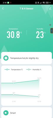

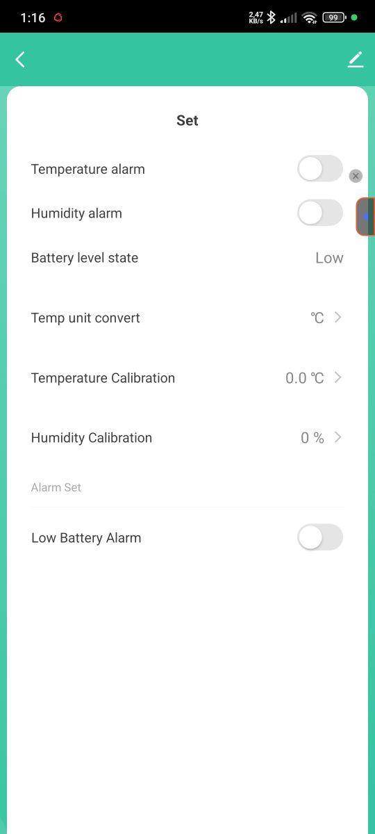

    Image in the Tuya app and data from the Tuya Developer Platform service
    Basically, like most temperature/humidity sensors there is not much in the app i.e. data visualisation and simple settings.
    Tuya app screen showing 30.8°C temperature and 23% humidity readings Sensor settings screen in Tuya app with alarm and calibration options

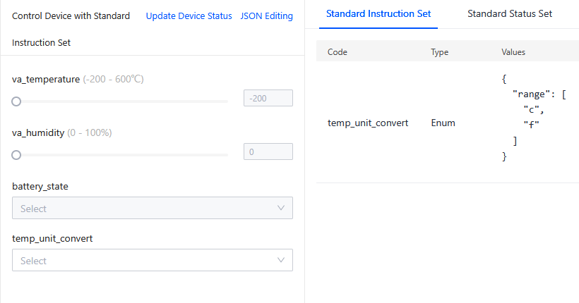

    Data from the Tuya Developer Platform looks as follows.
    Screenshot of Tuya Developer Platform interface displaying sensor data
    Standard Instruction Set
    temp_unit_convert	Enum
      "range": [
        "c",
        "f"
      "range": [
        "c",
        "f"
    Standard Status Set
    va_temperature	Integer
      "unit": "℃",
      "min": -200,
      "max": 600,
      "scale": 1,
      "step": 1
    va_humidity	Integer
      "unit": "%",
      "min": 0,
      "max": 100,
      "scale": 0,
      "step": 1
    battery_state	Enum
      "range": [
        "low",
        "middle",
        "high"
      "range": [
        "c",
        "f"
    Standard Status Set
      "unit": "℃",
      "min": -200,
      "max": 600,
      "scale": 1,
      "step": 1
    va_humidity	Integer
      "unit": "%",
      "min": 0,
      "max": 100,
      "scale": 0,
      "step": 1
    battery_state	Enum
      "range": [
        "low",
        "middle",
        "high"
      "range": [
        "c",
        "f"
    Additional JSON extracted from original firmware

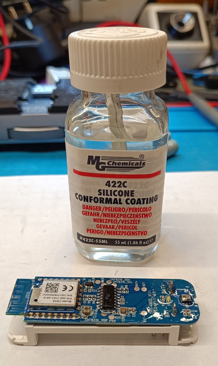

    Additional moisture protection
    Theoretically the sensor is IP65 rated but after uploading the firmware I decided to additionally protect the electronics with a silicone coating (MG Chemicals 422C)
    MG Chemicals silicone coating bottle and sensor PCB with electronics
    Here, care must be taken that the preparation does not get into the "window" in the temperature/humidity sensor. Likewise, I do not recommend coating the antenna circuit on the CB3S module with silicone....

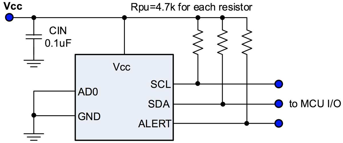

    Although I would still prefer to convert to a version without TuyaMCU - there is DeepSleep in the obk.
    Does your sensor report every fixed interval or when something changes? CHT has an alert function.
    I²C sensor connection diagram with ALERT line and 4.7kΩ pull-up resistors
  • TuyaMCU likely polls sensor data more frequently

    The CHT8310 can be programmed to pin alert to wake up the MCU (or WiFI module) when a certain change occurs. There is no need to do polling (manual polling).

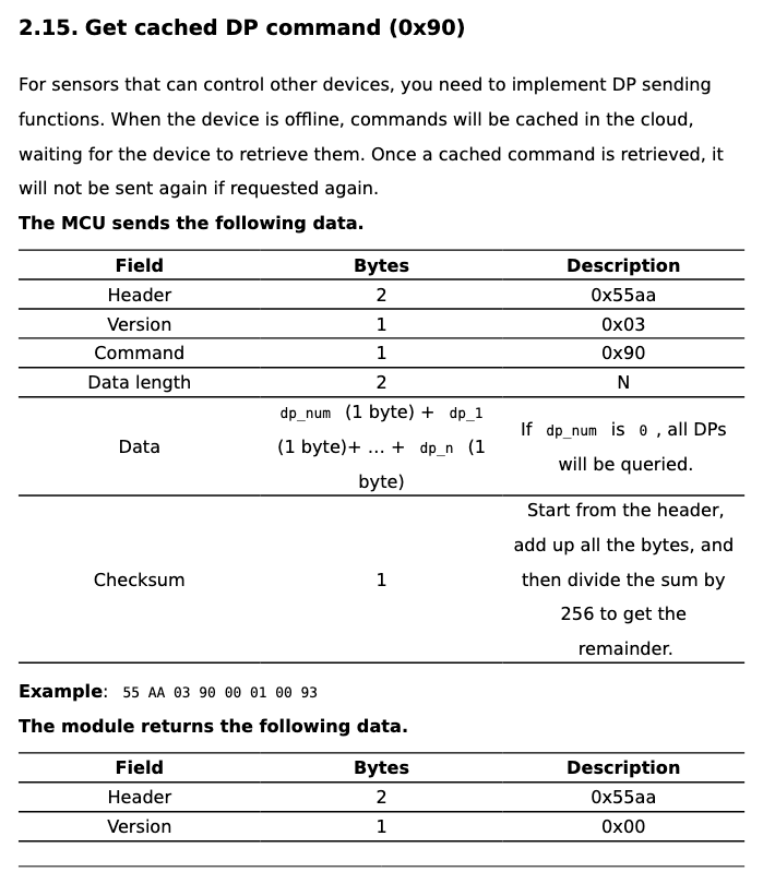

    Could you give me a 1:1 breakdown (in one block) of what the OBK should send first, which corresponds to the MCU? In hex. I'll put that into hardcoded tests on Windows and try to get OBK to behave according to those expectations. These tests are already on GitHub, and will make sure that future versions work as expected.
    As far as I can see this is a command that works similarly to the DPCache you described.

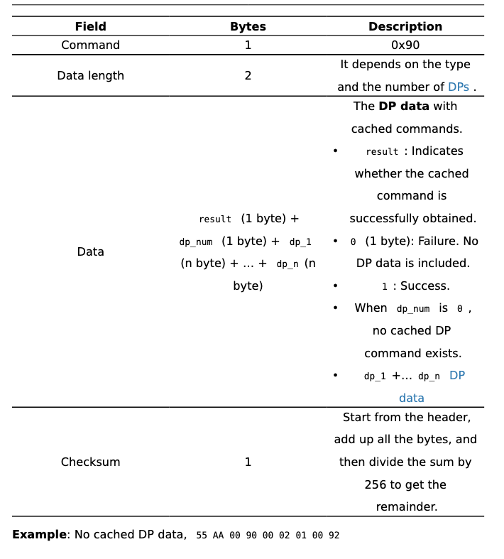

    TuyaMCU sends the command 0x90 (Get cached DP):
    55 AA 03 90 00 04 03 09 17 18 D1
    OBK when no data is available responds:
    55 AA 00 90 00 02 01 00 92
    Description from documentation:
    Table of Tuya MCU command 0x90 Get cached DP from documentation.
    Data format table for TuyaMCU 0x90 command with example byte sequence
    For the moment, I made a primitive workaround in autoexec....
    delay_s 1
    uartSendHex 55AA00900002010092
    ...but it's not the best approach because there's no guarantee that I'll get the answer right if there's any major delay in response.

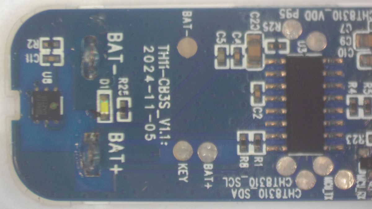

    All in all, it can be done either way - hmm looks like a good idea to practice this.
    Looking at it this way, Pin3 of the CHT8310 (ALERT) is not routed out, but it should be possible to solder the kynar etc. On the other hand it's only one of many connections to make anyway :)
    Microscopic close-up of CH8310 chip on a blue PCB
    I have another sensor with the usual one not IP65 - I'll see maybe I'll dedicate it to such an experiment. I've put this IP65 out of the window and it's being tested - well, to bad the temperatures are now positive.... ...and I wanted to check how long the batteries would last in sub-zero temperatures...
    By the way, as I've already ripped the card from the microscope camera, I'm pasting some pics of the TH11 sensor PCB.
    I didn't paste before because the quality of my microscope camera leaves a lot to be desired, so I let it go
    Close-up of PCB with CHT8310 marking and SMD components Close-up of TH11 sensor PCB with CB3S Wi-Fi module and CHT8310 chip Close-up of TH11-CB3S_V1.1 sensor PCB with electronic components and labeled test points

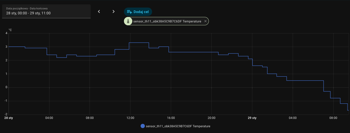

    The most important thing about these sensors is whether they report negative temperatures, many do not. I don't know if this is a limitation of Tuya or the electronics.
  • Negative temperature reading confirmed on TH11 sensor
    Good I can answer. This one at least finally showed a negative temperature ;)
    Temperature graph from Tuya sensor showing values dropping below zero
    Temperature chart from sensor showing drop below zero degrees Celsius

What is the TH11 sensor and what’s inside?
TH11 is an IP65 Wi‑Fi temperature/humidity probe for Tuya/Smart Life. Inside: CB3S module with BK7231N, a TuyaMCU coprocessor, and a Sensylink CHT8310 temp/RH sensor. It runs on two AAA batteries and includes a button, LED, and basic passives. [Elektroda, tplewa, post #21819906]
Does TH11 support negative temperatures?
Yes. The firmware exposes va_temperature with min −200 and scale 1, meaning −20.0°C. Max is 60.0°C (600/10). Negative readings within this range are valid. Example telemetry shows values like 301, which equals 30.1°C after scale. [Elektroda, tplewa, post #21819906]

How do I handle the 0x90 “Get cached DP” / ObtainDPcache behavior with OBK?
TuyaMCU issues 0x90; OBK should reply 55 AA 00 90 00 02 01 00 92 when no data. A temporary workaround sends that hex via uartSendHex after a short delay, though it’s timing‑sensitive. Logs and exact frames are provided. [Elektroda, tplewa, post #21820891]

Can the CHT8310 ALERT pin reduce power usage?
Yes. Configure CHT8310’s ALERT to trigger on threshold changes and wake the MCU for reporting. This avoids constant polling. "There is no need to do polling." This suits battery‑powered outdoor nodes. [Elektroda, p.kaczmarek2, post #21820252]
How should I protect the PCB against moisture?
Apply a silicone conformal coating (e.g., MG Chemicals 422C) to the PCB. Do not coat the CHT8310 sensing window. Avoid the CB3S antenna area to preserve RF performance. The unit is IP65, but extra protection helps outdoors. [Elektroda, tplewa, post #21819906]
What do the battery levels actually indicate?
Battery is an enum from the device: low, middle, high (DP id 3). It is not a voltage reading. Use it as a coarse indicator for battery replacement planning. Surface it as a read‑only channel in OpenBK. [Elektroda, tplewa, post #21819906]
