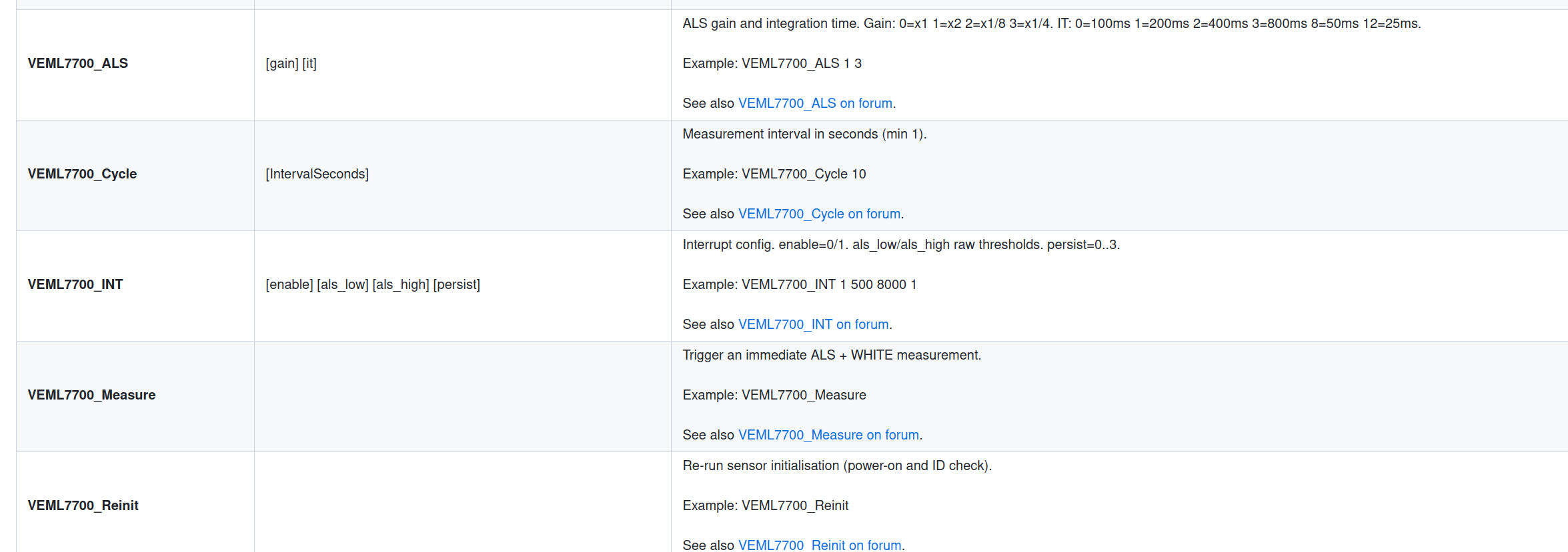

    Which IR driver do you need?
    I tried a VEML7700 driver
    Since I don't have them, I added them to the I2C simulator and it works there.
    Maybe you can try in real life? You can fetch the binary for BL602 here (must be logged in to get the artifacts)
    https://github.com/MaxineMuster/OpenBK7231T_App/actions/runs/23042548404
    startDriver VEML7700 [SCL-pin] [SDA-pin] [chan_lux] [chan_white]
    Table of VEML7700 commands: ALS, Cycle, INT, Measure, and Reinit with descriptions and examples.
