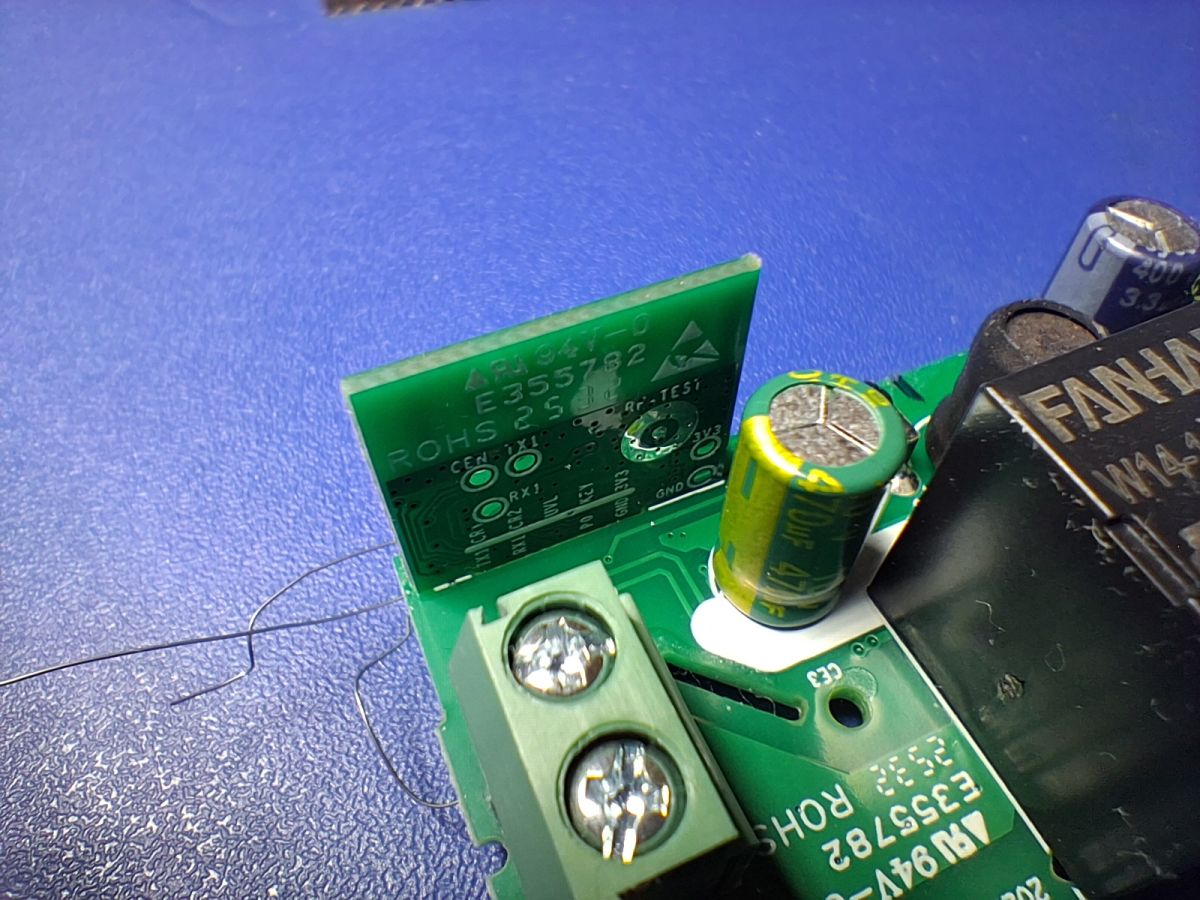

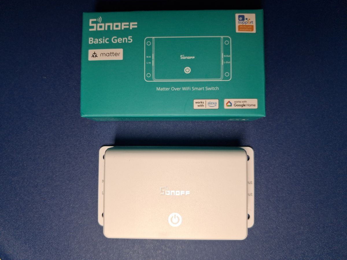

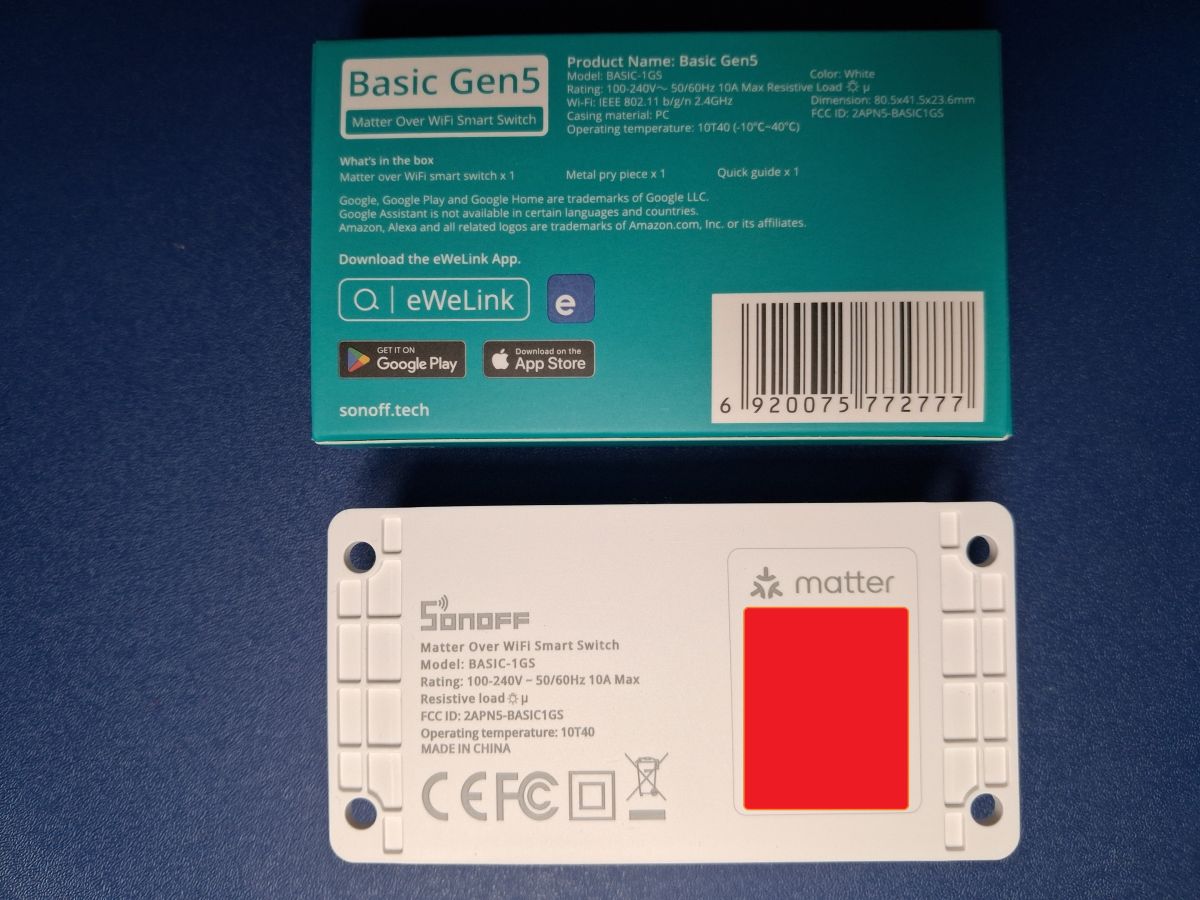

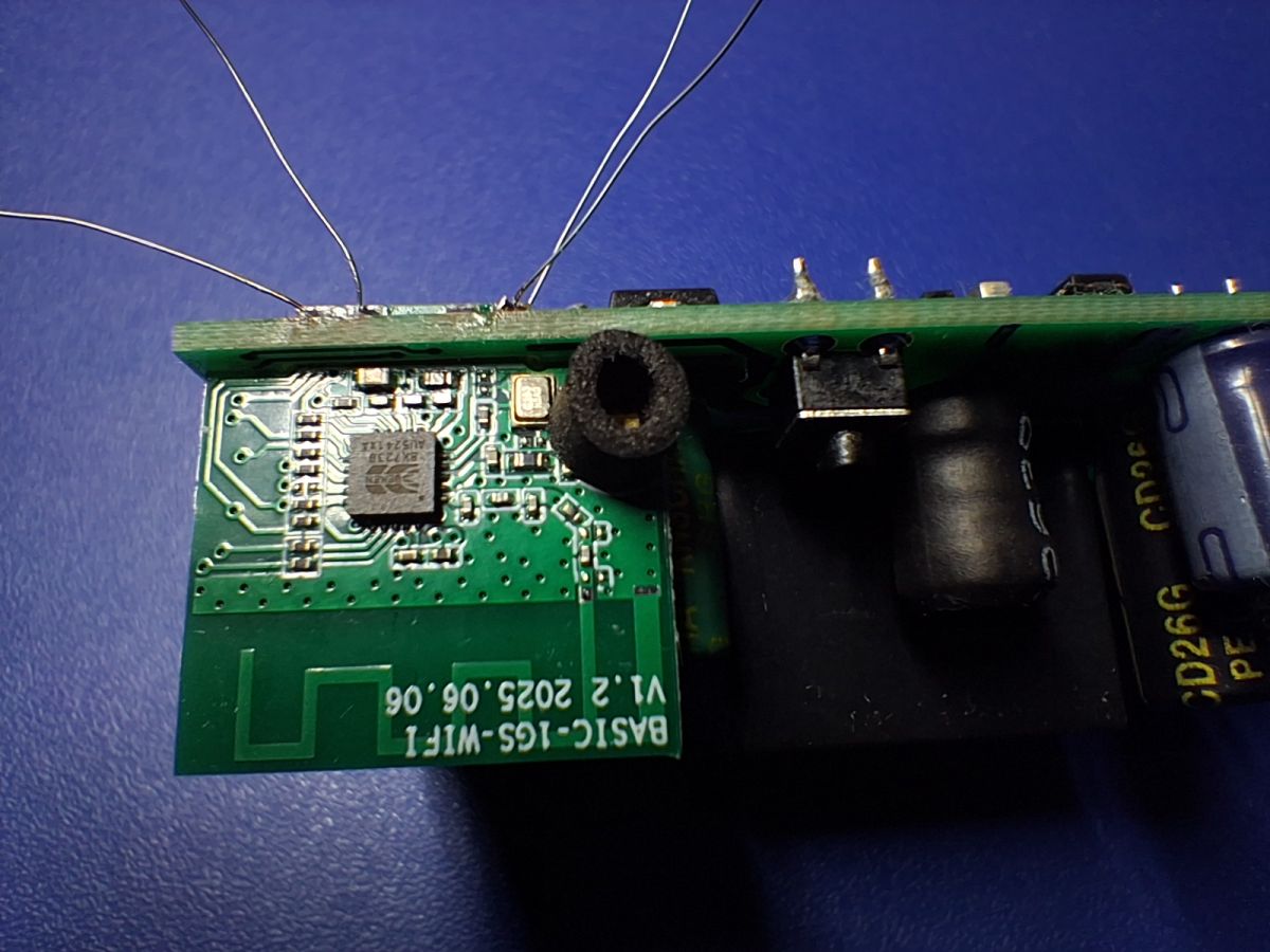

  • BK7238 template for Sonoff Basic Gen5 BASIC-1GS
    #1 21860796
    gpre
    Green Sonoff Basic Gen5 box and a white smart switch module on a blue background
    Box and white Sonoff Basic Gen5 (BASIC-1GS) smart switch module on a blue surface
    Close-up of a PCB with soldered wires and a red alligator clip on a blue work mat
    PCB connected with wires and alligator clips on a blue work mat
    Close-up of a green PCB with an IC, soldered wires, and a capacitor on a blue surface
    Close-up of a PCB with a FANTAR relay, electrolytic capacitor, and green screw terminal block
    Close-up of a green PCB with a screw terminal, electrolytic capacitors, and a black component labeled FJAHH
