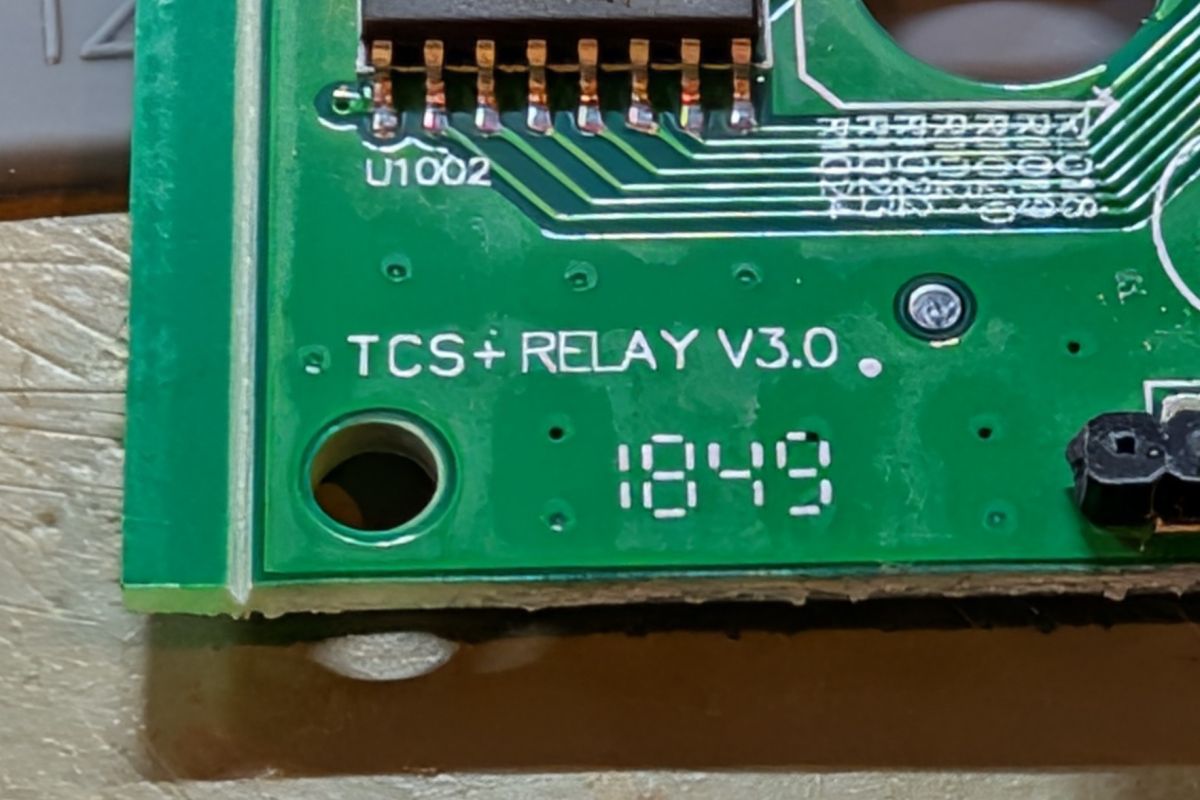

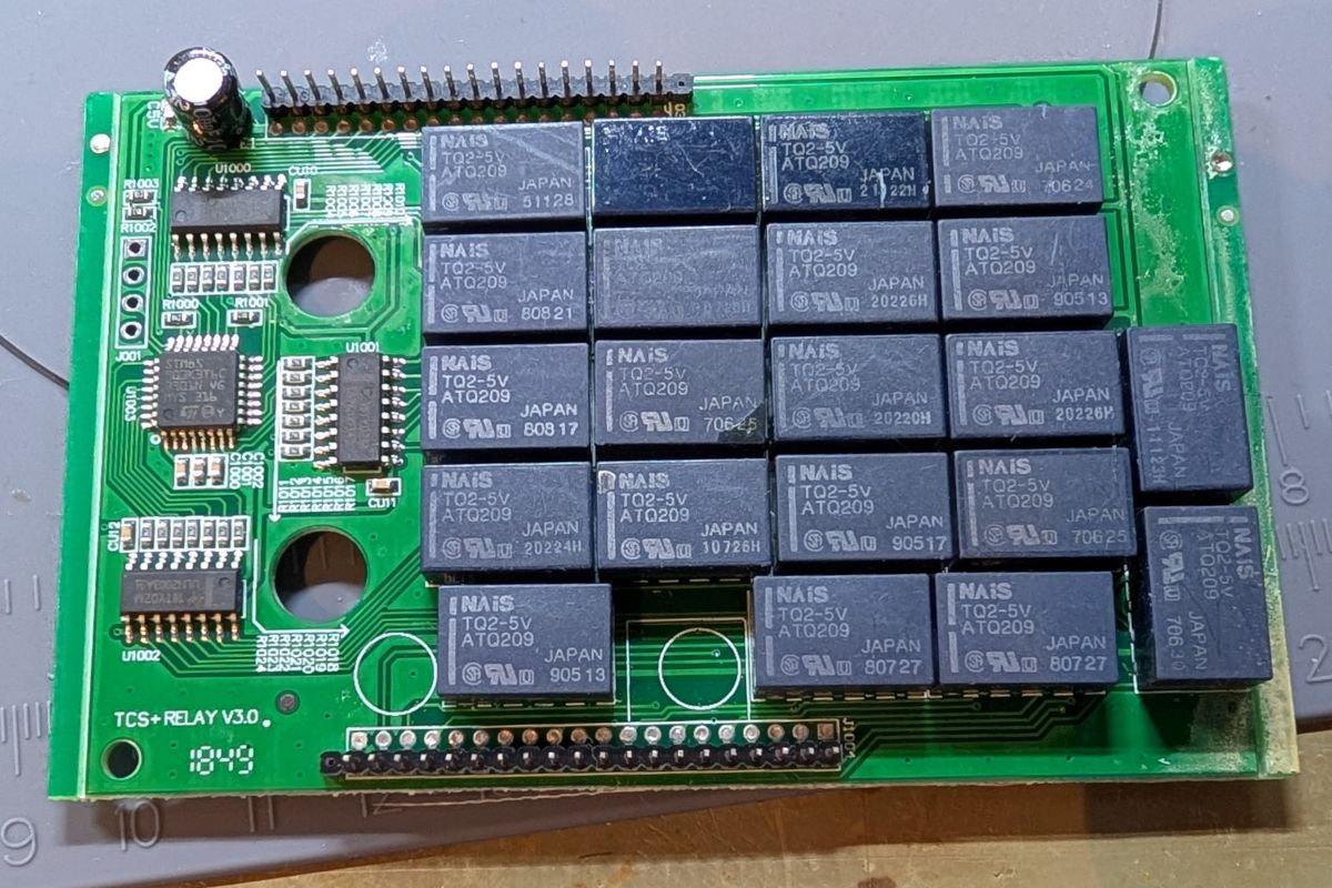

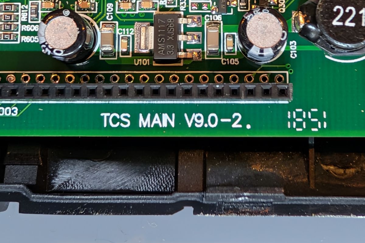

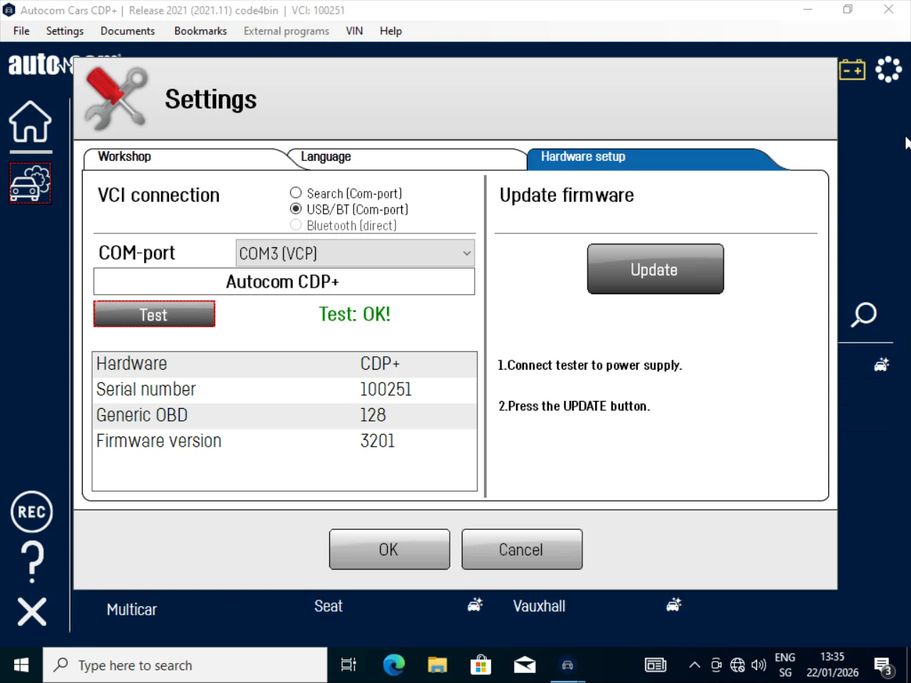

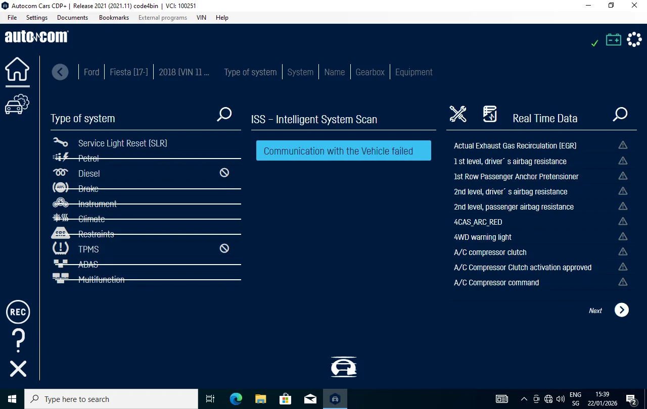

    I have a `2018 NEW VCI for Delphis VD DS150E CDP TCS CDP Pro OBD2 diagnostic tool` from AliExpress. I downloaded 2022.11 software and updated firmware from 1532 to 3201.
    Unfortunately, it is unable to communicate with my Ford. Any idea if this VCI isn't compatible with the software?
    Any recommendation on what software to use for this VCI or which VCI to buy?
    Thanks

    And does it connect to other cars?

    Exactly as above connect to others? That's once and connect it normally over cable not BT.

    A two-board clone on an inferior V9 board. It's worth checking on another car how many modules it connects to, but I wouldn't expect miracles. Which Ford were you trying to connect to? Wasn't it better to buy a pass-thru J2534 head and FORScan to connect?

    Do the update (i.e. update) after checking the hardware test, otherwise you will not be able to connect to the car. And you can swap the language in the software. You can also change the firmware to 1620, but do the update for now.
    I have the same hardware name and it works on 1620 as well as 3201
