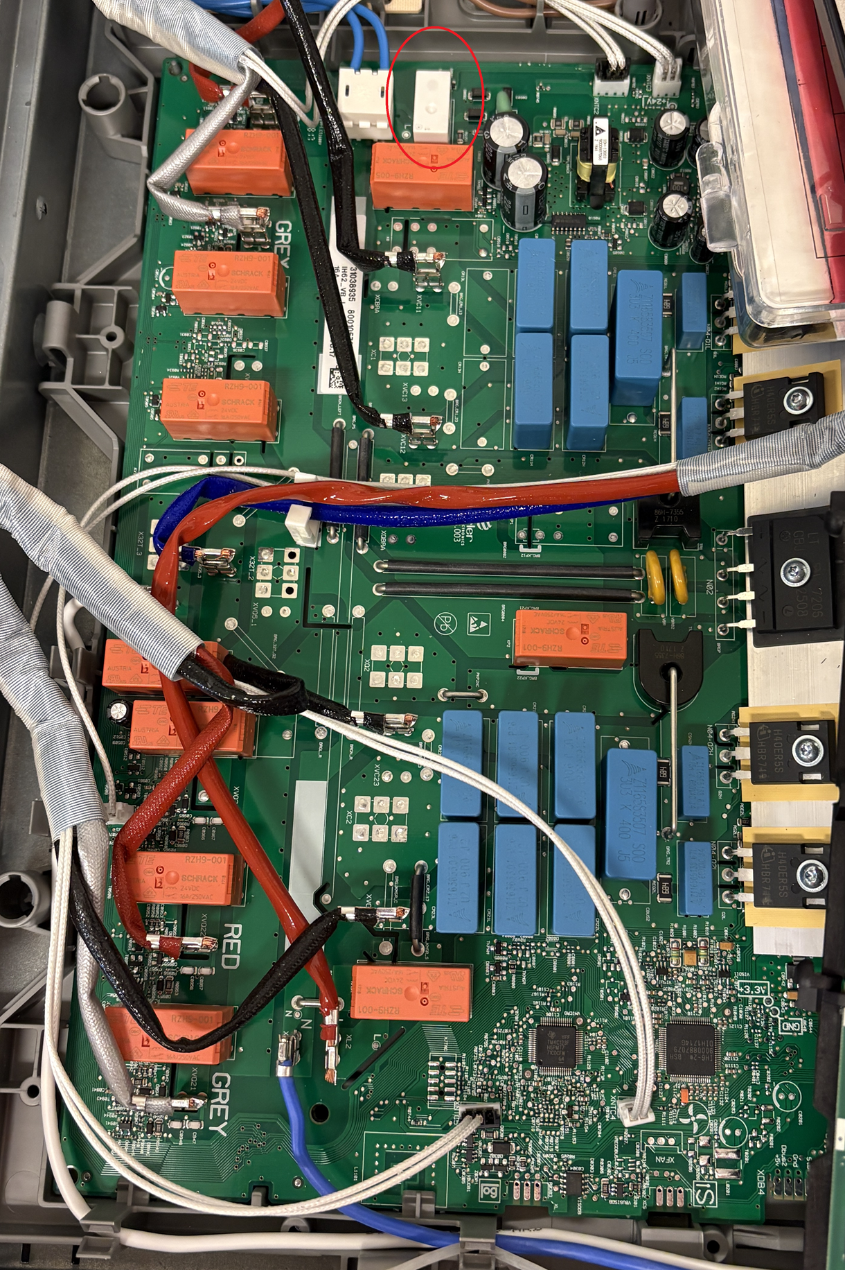

    I bought an unused Bosch induction hob where the seller described it as having a fault with error code 0513.
    My suspicion was that the hob had been incorrectly connected without a double neutral or jumper, so that only half of the hob was connected.
    When I connect and start the hob now, I quickly get EEEE and then the hob switches off and cannot be started.
    The previous error code is indicated when connected incorrectly, but also when communication between the circuit boards does not work in the hob. But since I do not have time to press EEEE when starting, I do not know if that is what is wrong now.
    Could some part have been broken if it was connected incorrectly before? I have measured that the filter boards let through both phase and neutral to the respective power module right/left.
    Does anyone have a good idea what could be wrong?
    (The hob was produced in 2017 so unfortunately there is no warranty. But it looks brand new and unused. No dust on the inside or scratches.)

    AI: Can you describe exactly how you have currently wired the hob (e.g., single-phase or two-phase, and whether you have installed a jumper or double neutral as recommended in the manual)?
    Two-phase with double neutral with bridge.
    AI: When you power on the hob and see the EEEE error, do you notice any other indicators, sounds, or lights (such as blinking LEDs or beeps) before it switches off?
    It switches off right after EEEE in about a second, and will not turn on again.

    So a small update. Hope someone can fill in a bit.
    I have measured both filter inputs, and they seem to be fine. Also the bridge rectifiers have good forward and backward voltages.
    But:
    Left side ELIN (if that's what it's called) doesn't seem to enable the 5 V relay. This is when I enable the breaker for 240 V to the hob. Since it turns off after a few seconds and is unresponsive, I have to turn off 240 V and turn on again.
    I can audibly not hear left side clicking either on or off, while I can hear right side clearly. But perhaps this is some other relay and not the 5 V one?
    5 V from the right-side filter board seems stable at 5.3 V. I think that is what it is supposed to be.
    So is the relay enabled automatically on 5 V on startup? Or is it part of the DBUS2 communication and enabled from that logic? Does anyone know who controls the left and right side 5 V (white) relay?
    I thought that the relay enables voltage for each of the left- and right-side logic and 5 V / 3.3 V. But I can't really find any good documentation about it. Or video explaining it.
    Thanks!
    Added after 10 [minutes]:
    Picture of left side ELIN with relay circled.
