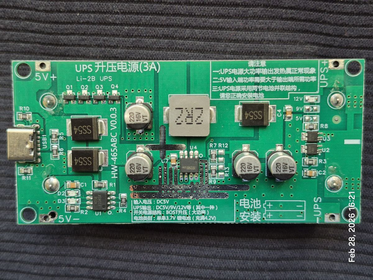

    I have a small Chinese-made UPS.
    Green UPS module PCB with USB‑C port, “2R2” inductor, and IC labeled U4 in the center

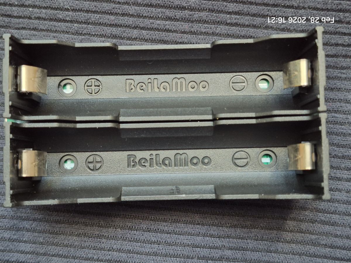

    Dual 18650 battery holder with metal contacts and “BeilaMoo” marking.
    Currently, I am using the version with a 12 V output, but it is behaving oddly: it typically outputs only about 3.4 V. However, if I press on the chip XR2981 in the center of the board (labeled “U4” on the picture), it temporarily outputs the correct 12 V.
    I have already tried resoldering the contacts, but the issue persists.
    Interestingly, I own two identical UPS units, and both exhibit the same defect. They have never been used and have been stored in their packaging for about a year.
    Does anyone have an idea what might be causing this behavior, and how it could be resolved?

    Input was from a USB charger. The batteries' condition was good, but without them it exhibits the same behavior as described. It behaves the same with a small load and without any.

    Try adding lead tin and remove that grey tin. It looks overheated. Re-solder from scratch.

    I don't quite understand. Should I first add solder to the chip's pins and then remove it? There seems to be an acceptable amount of tin there now.
    Re-soldering the entire chip might be an option, but only as a last resort.
    The overheating suggestion doesn't seem to be realistic: mechanical action is what's important. Simply pressing with a finger to dissipate the heat doesn't help. You have to actually press. It looks like a bad contact on the board. But simply bending the board or pressing near the chip doesn't help either. You have to press specifically on the chip.

    Both units have the exact same issue, it’s almost definitely a common design flaw with this board, not a random part failure. If I were you, I’d just reflow the whole chip with some flux and a hot air station.

    But those two devices were bought together with the third one, which works fine already for a couple of years. While the mentioned two were lying in the box.

    Remove the chip, clean the board underneath it, inspect it, fix the vias around the chip with wire, solder the chip in.
