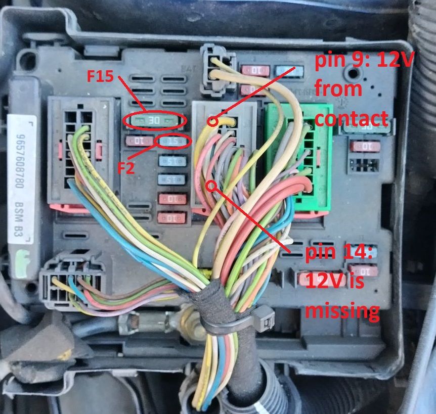

    Hello, guys. Please, if you can, help me.
    On the BSM of my Peugeot 206 1.4 HDi, 2004, on fuses F15 (30 A) and F2 (15 A), I have no power when I turn on the ignition. The relay does not turn on. That is why the ECU has no power, and I cannot start the car. It turns over but does not start.
    These are the two fuses marked in the picture. Gray connector: pin 9 got 12 V from the ignition, and pin 14 should have 12 V to activate the relay that turns on these two fuses, but there is none. When I bring 12 V from pin 9 to pin 14, the relay turns on, I get voltage, and I can start the car. Is it the BSM, the BSI, or something else that can generate this problem? All fuses, both in the engine and in the passenger compartment, are fine.

    It would be worth looking at the control of the sonic relay, in which case it is probably integrated into the BSM.
    i.e., the cable connecting the ECU-BSM. The engine controller gives ground when it receives terminal 15, i.e., 12 V after the ignition.

    Perhaps an ignition switch?

    Checking the voltage after the ignition at the ECU will dispel any doubts with the ignition.
