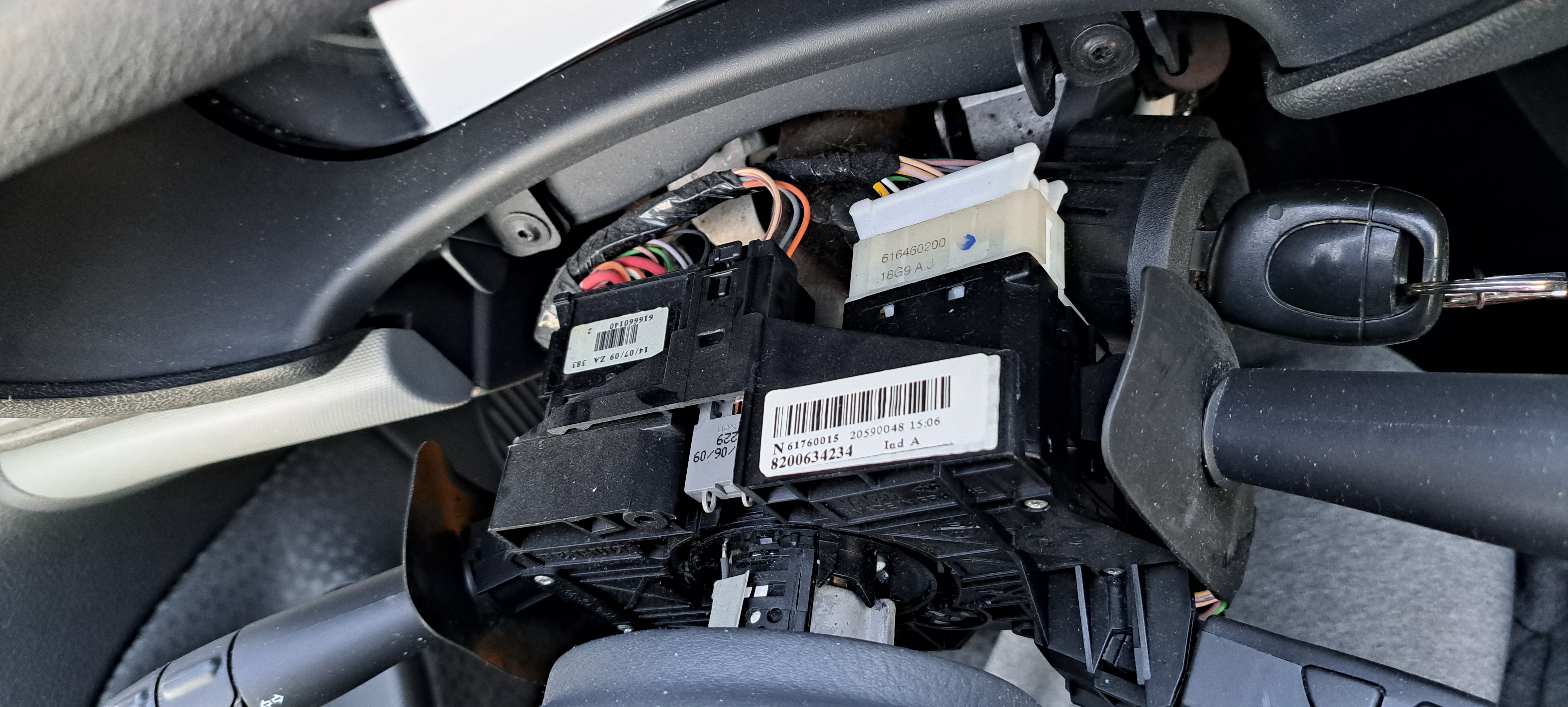

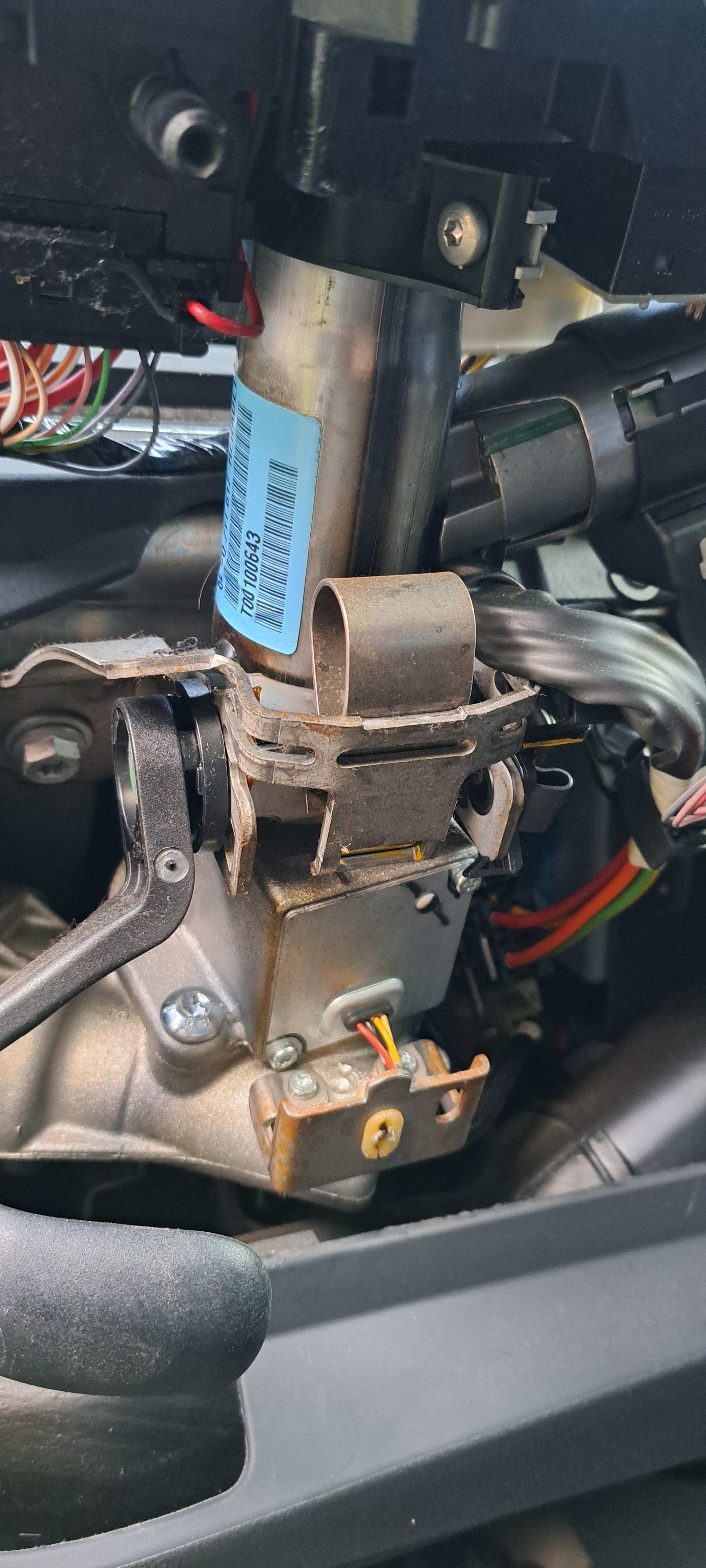

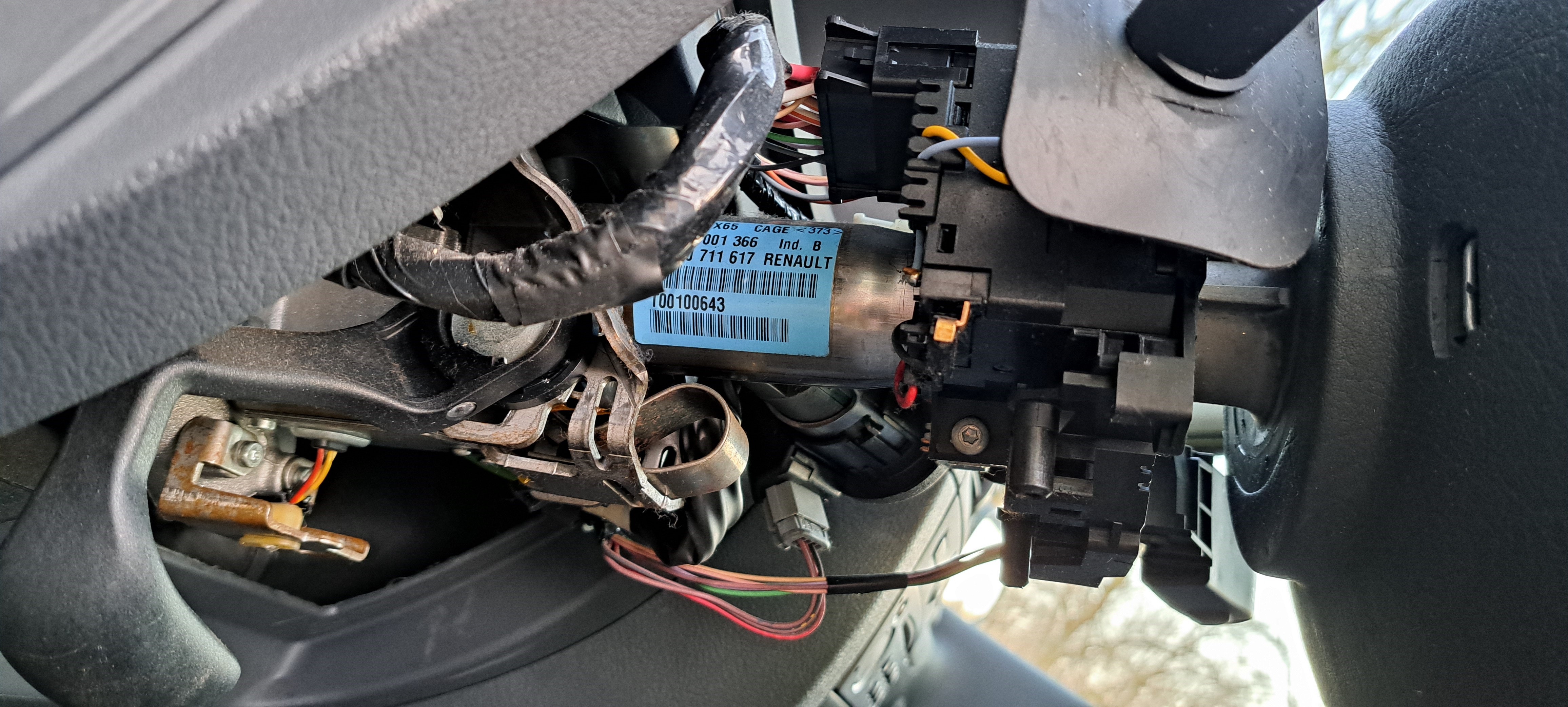

    Hello friends,
    I have Renault Clio Storia 2009, 1.2, 43 kW and I have a problem where the steering wheel does not return to the center. It stays at around **45° of turn (in both directions), and then I have to manually straighten it. As far as I know, this car has **electric power steering (EPS).
    Pictures included of the steering wheel components.
    Thank you.

    • Renault Clio Storia 2009 1.2 EPS Steering Wheel Not Returning to Center Issue 20260315_173512.jpg (1.75 MB) You must be logged in to download this attachment.
    • Renault Clio Storia 2009 1.2 EPS Steering Wheel Not Returning to Center Issue 20260315_173453.jpg (2.66 MB) You must be logged in to download this attachment.
    • Renault Clio Storia 2009 1.2 EPS Steering Wheel Not Returning to Center Issue 20260315_173437.jpg (1.84 MB) You must be logged in to download this attachment.
    • Renault Clio Storia 2009 1.2 EPS Steering Wheel Not Returning to Center Issue 20260315_173416.jpg (2.5 MB) You must be logged in to download this attachment.

    The power steering is not responsible for the steering return. First of all, check that no knuckle pin is seized.
    Any cracking of the rubber immediately qualifies it for replacement. Fold back the lashing rings on the steering gear and check for rust. Lubricate it prophylactically even if it is not rusted. Have you had this car for a long time and it just happened by itself, or did you buy it with this symptom? This is important because if you bought the car, you need to look in one more place.

    Akerman forces are responsible for the automatic return of the steering wheel. And this is counted and taken into account when designing the car. And here, as above, you have to physically go under the car and check the condition of the components and whether any are seized.
