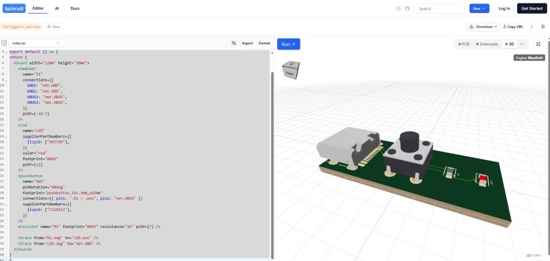

  • tscircuit editor with JSX code on the left and a 3D PCB preview on the right

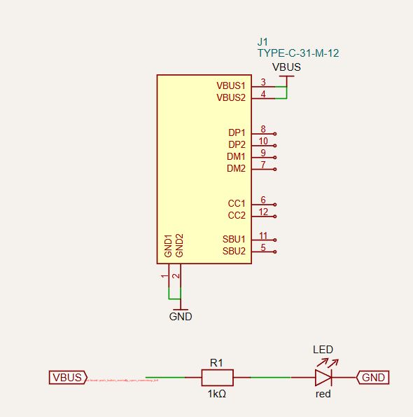

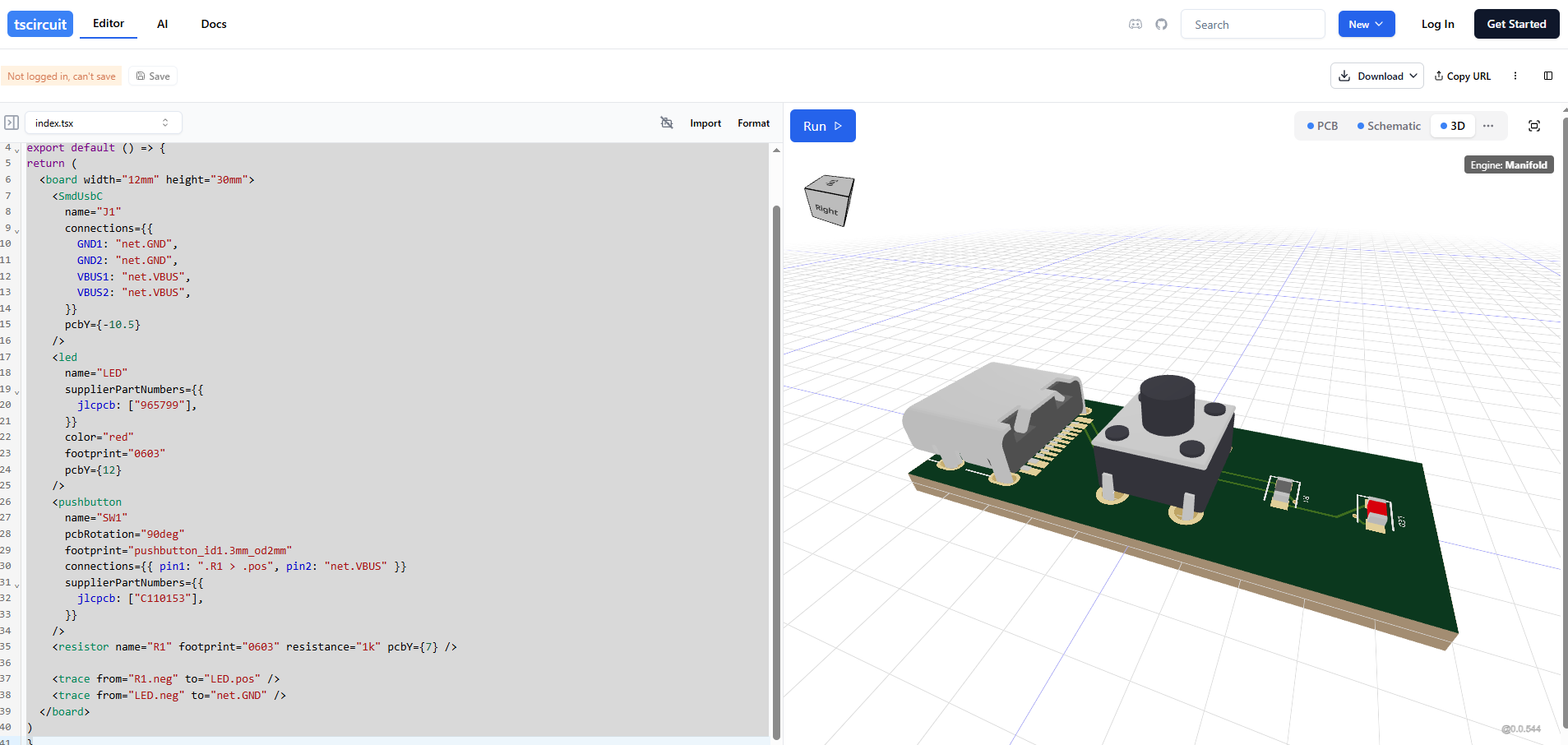

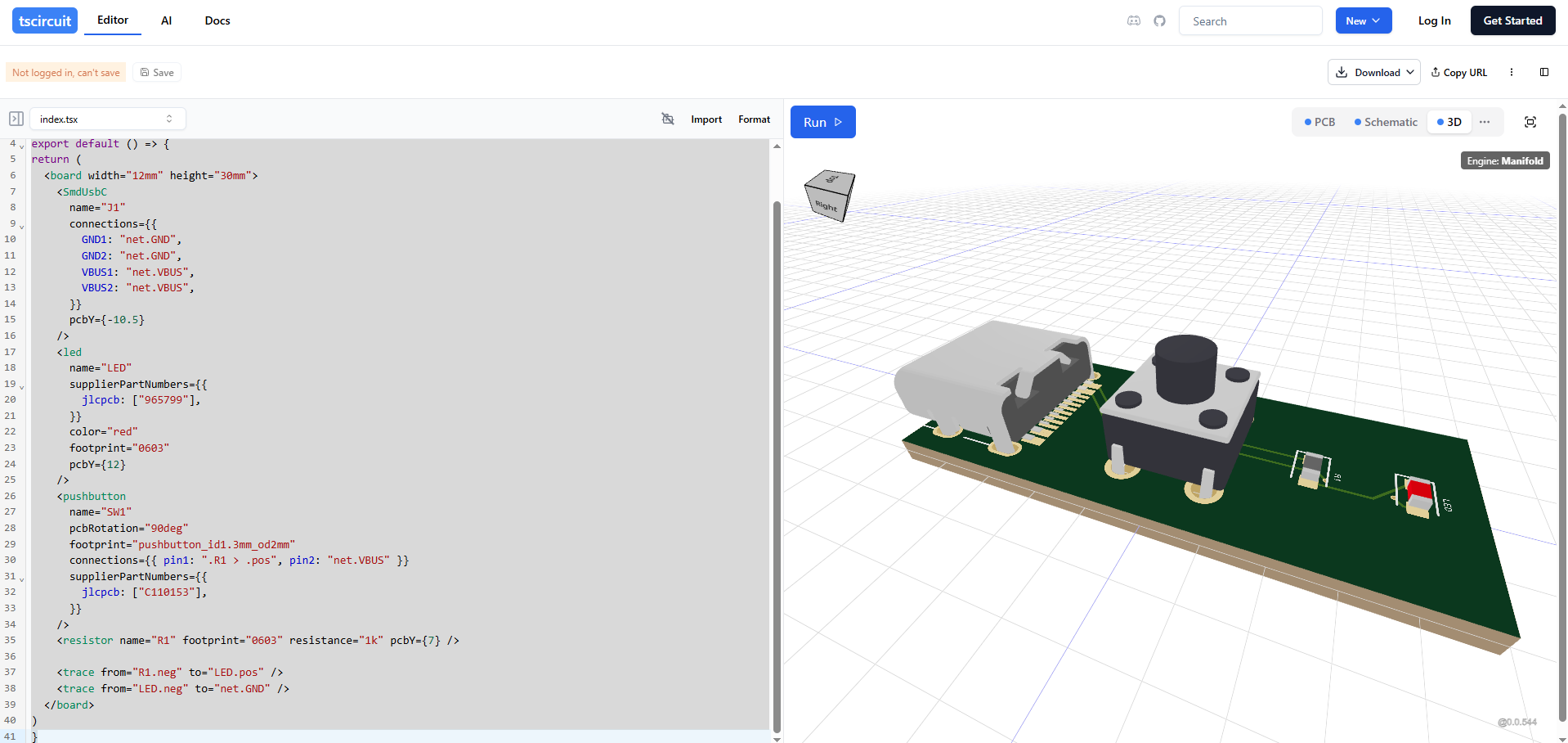

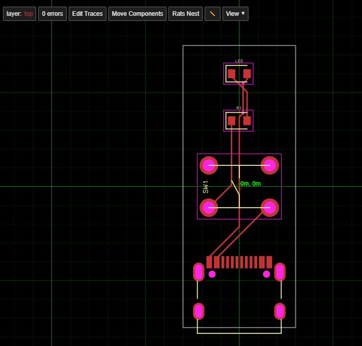

    A gallery of screenshots showing the results for the code posted above:
    Screenshot of the tscircuit editor with JSX code on the left and a 3D PCB preview on the right.
    Schematic of USB‑C connector J1 with VBUS, DP/DM, CC, SBU pins and an LED circuit with 1 kΩ to GND Browser-based PCB editor view with traces and components on a grid, top layer
