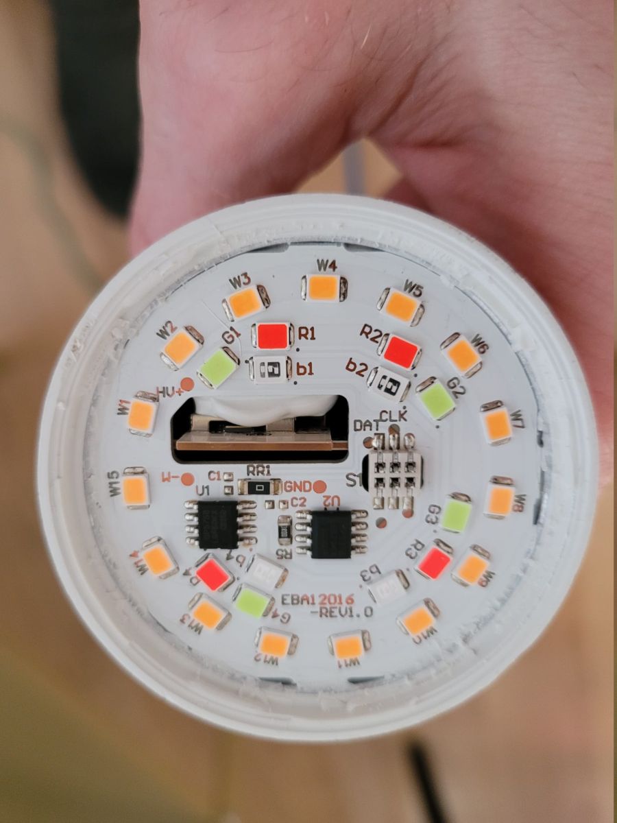

    230V LED Nous smart WiFi Bulb P3 repair help needed.
    Round LED circuit board with multicolor LEDs and electronic components, held in a hand
    Bulb doesn't work. Multimeter shows:
    GND - W-: 0.15V
    GND - HW+: 0.12V
    HW+ - HW-: 0.14V
    I tried shortening all LEDs one by one - didn't help. The LEDs also doesn't light when I test each with continuity/diode tester (with mains power removed). How to proceed?

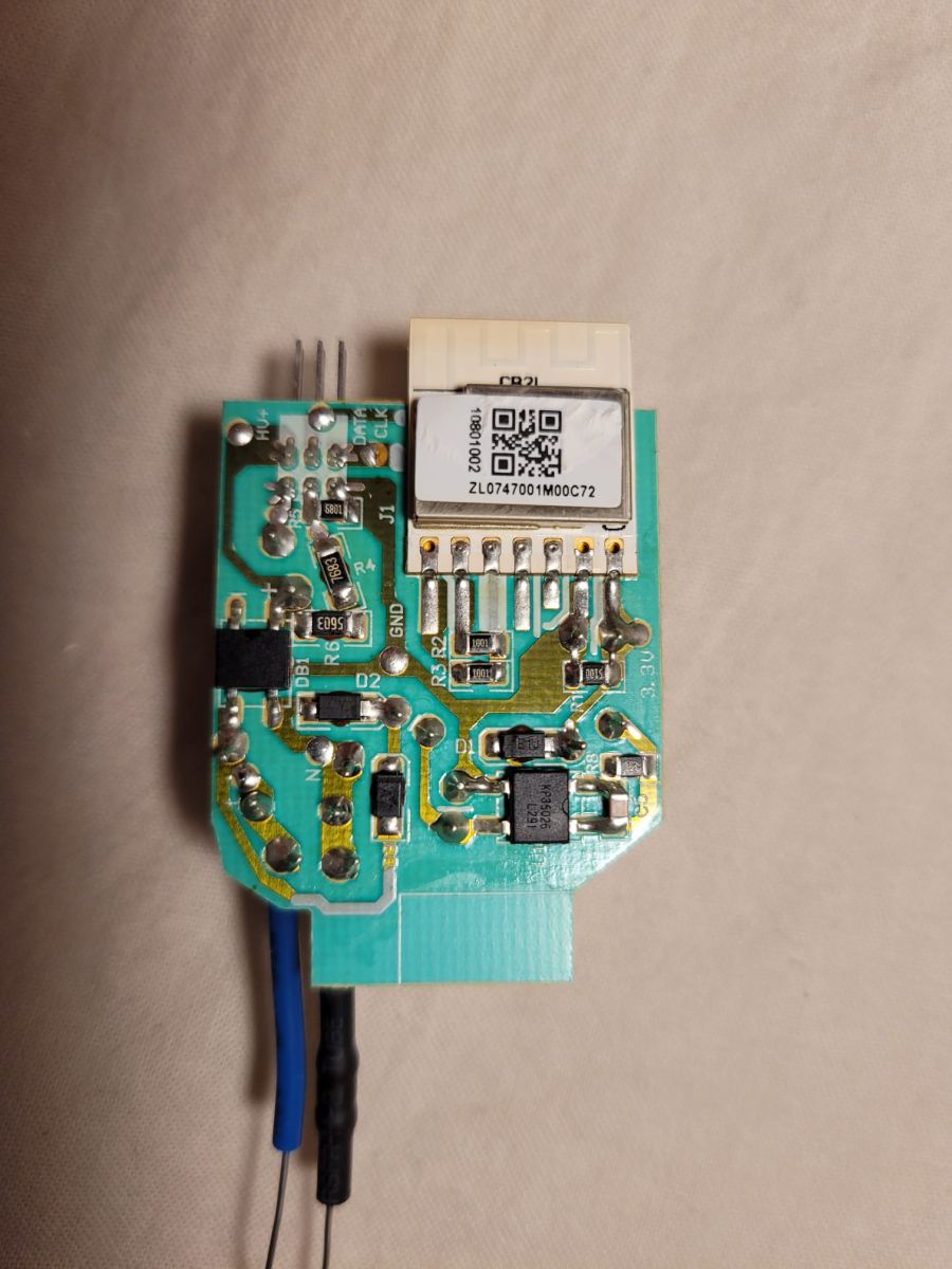

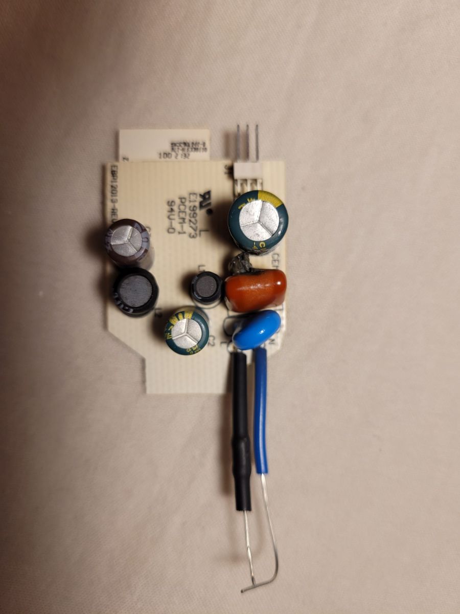

    AI: Can you share where exactly those voltages were measured, and what voltage you have at the mains input and on the main DC bus after the bridge rectifier/filter capacitor when powered from 230V?
    The labels are on the attached picture.
    PCB with LED driver components and black and blue wires on a light background Wi‑Fi bulb control PCB with shielded module, QR code, and labeled test points including 3.3V and GND
    Ok, I see CEM1-1 has burned.

    At all? If not a single LED is illuminated then you need to focus on the mains power supply circuit - there will probably be a bridge, an electrolytic capacitor for the high voltage and, depending on the design, either the transistor key of the switching power supply or something to step down the voltage to the required value (inherently a few tens of V max) to supply the LED array. The power supply I am writing about is located on the perpendicular to the plate shown in the photo inside the LED bulb housing.

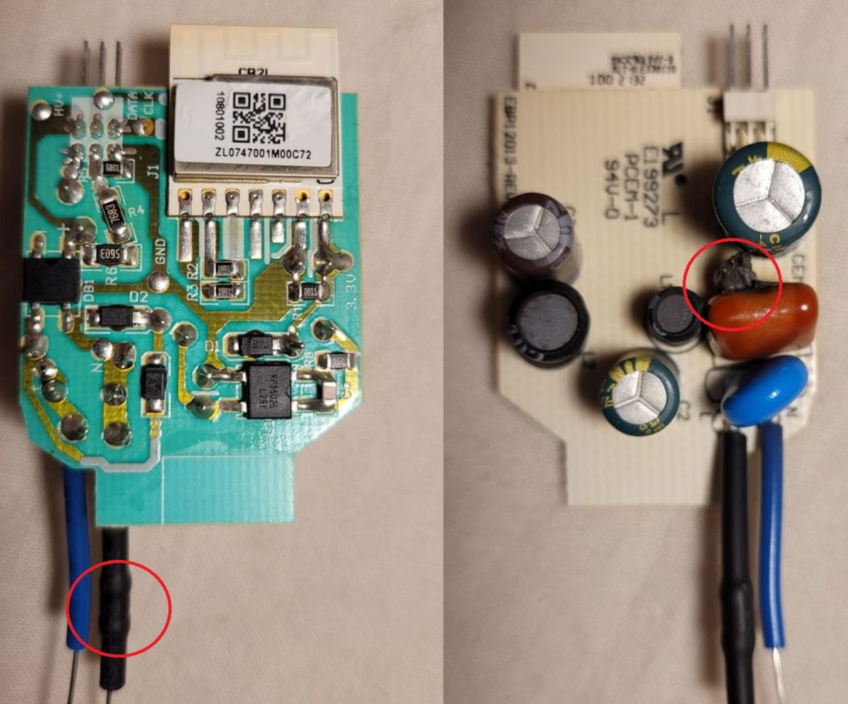

    @martinspukitismail, sorry I didn't look at your original message yesterday because two of your images didn't show up in my (Polish) forum. It was only today when I clicked on the "Show original message" option that these pictures of yours appeared

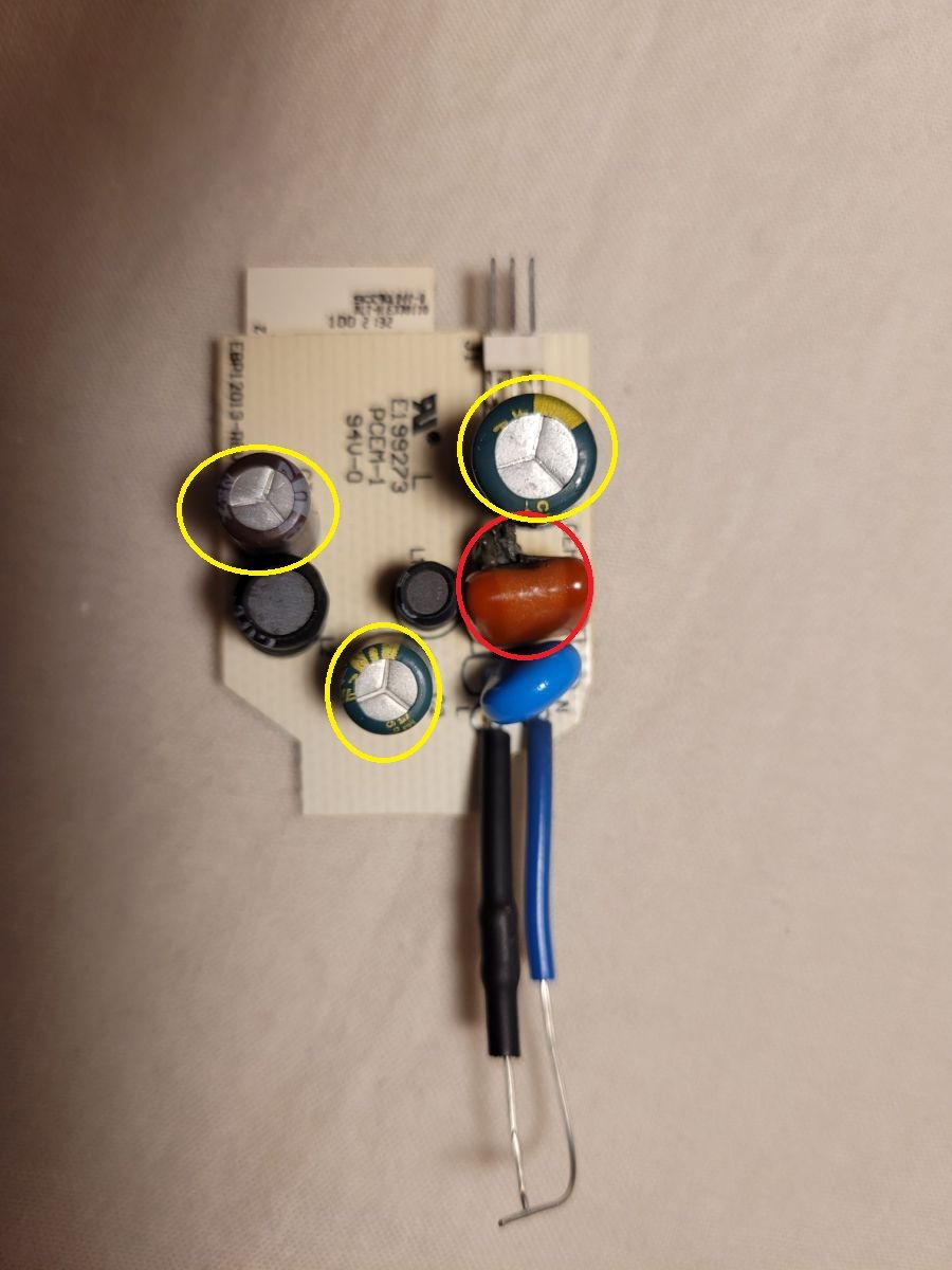

    Small PCB with capacitors; parts highlighted with yellow circles and one red circle and on one of them according to me (I may be wrong) you can see a burnt capacitor (I marked it in red on the above mentioned picture), try to see if there are any inscriptions on the unburnt side? If there are no inscriptions then measure the dimensions of this capacitor with my caliper: length, width and thickness. By eye, it should be rated at about 864J, which means it could be about 860 nF, but it would be better to find this out in the other way described above, or someone else will tell you if they have one in their collection... Also replace the electrolytic capacitors marked in yellow. And for testing their efficiency after discharge, of course I recommend another tester this time: Link
    Two PCB photos; right board has a scorched component area highlighted with a red circle.
    Take a closer look at the circuit to see if any resistors or other components are soldered in parallel to the suspected burnt capacitor then check them....
    Also measure the resistance of the resistor in the black shrink sleeve and if there is no resistance then carefully remove the sleeve to read what is written on it....
    Everyone once started the adventure with electronics and if it is not a one-time adventure, I in good conscience recommend both of the above-mentioned testers, which will make it easier for you to diagnose in the future, as well as whether it is necessary to replace some of the components I write about, e.g. electrolytic capacitors marked in yellow?
    I can see from your other topic https://www.elektroda.pl/rtvforum/topic4168746.html that this is not your first adventure with electronics and by the bulge of the capacitors you can recognise their defect, but this bulge is not always visible, so in good conscience I recommend the above mentioned testers even if others disagree and criticise me, I have my opinion....
    PS. I know that sometimes it is difficult or the equipment does not allow you to, but try to take pictures with a better sharpness, because not everyone has a falcon eye, I do not have it anymore due to sitting in front of a monitor...

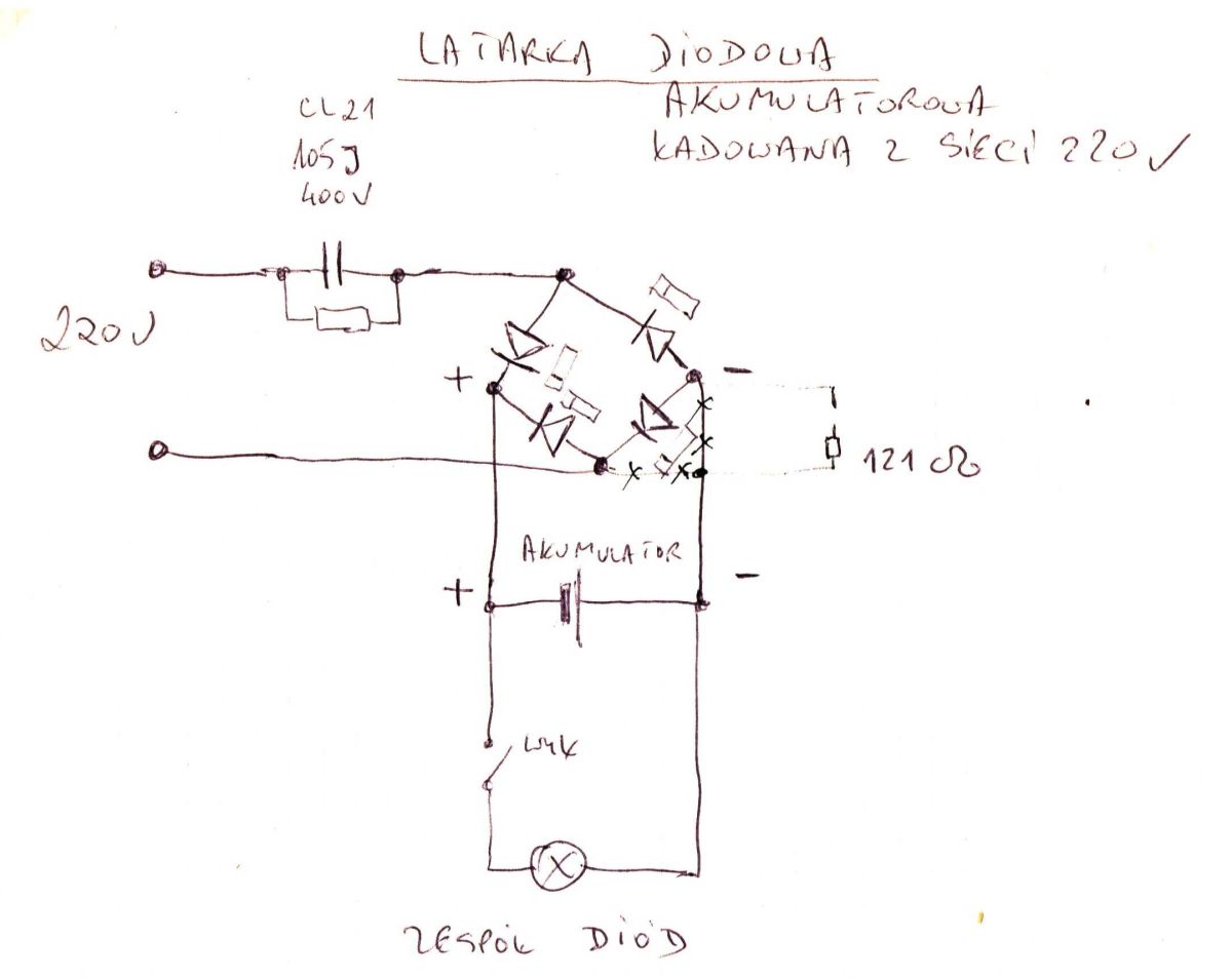

    Sometimes it is helpful to try to draw a diagram of some device you want to repair, e.g.: https://www.elektroda.pl/rtvforum/topic4091076.html
    Below I show you a schematic of a rechargeable LED torch that I once drew to show you a typical way of getting a lower voltage from 230V AC mains to get a DC voltage of about 4-5V using a capacitor and a resistor connected in parallel and a bridge rectifier (Graetz circuit) and you should already know what voltage to expect and where to make and what kind of measurements in AC or DC mode... it will be much easier if you try to draw the power supply circuit for your light source...
    Hand-drawn circuit diagram of an LED flashlight charged from 220 V mains, with capacitor and bridge rectifier.
    For the correct operation of any circuit you need to establish the efficiency of the above mentioned components and if they do not correspond to the original designed or applied values or are burnt out then replace them....
    I would like to point out, however, that the values of spare parts for bad ones you have to determine precisely because the communication module is also powered from this circuit, so the original conditions of its power supply must be created and these depend on the mentioned elements and their values and unless it has undergone failure, by the way, this will be your next successful repair this time of this light source when the cause of the burnt-out of the aforementioned capacitor was not the communication module or the failure of the electrolytic capacitors or the LEDs....

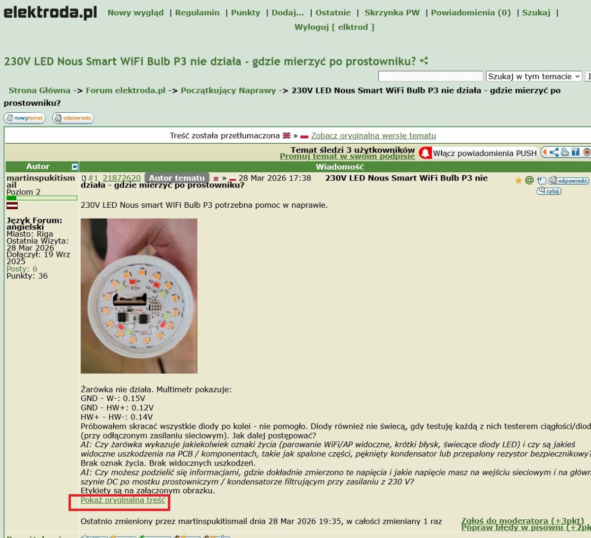

    @martinspukitismail I'm curious if on your computer my message shows up in full or just an excerpt and the rest only shows up when you click on the "Show original content" option? Please write back. With me, this is how your topic shows up:
    Screenshot of elektroda.pl forum thread about Nous Smart WiFi Bulb P3 with a “Show original content” link
    And I don't always get the idea of clicking on the aforementioned option at the bottom left of the screen....
    It shows up full without clicking.
