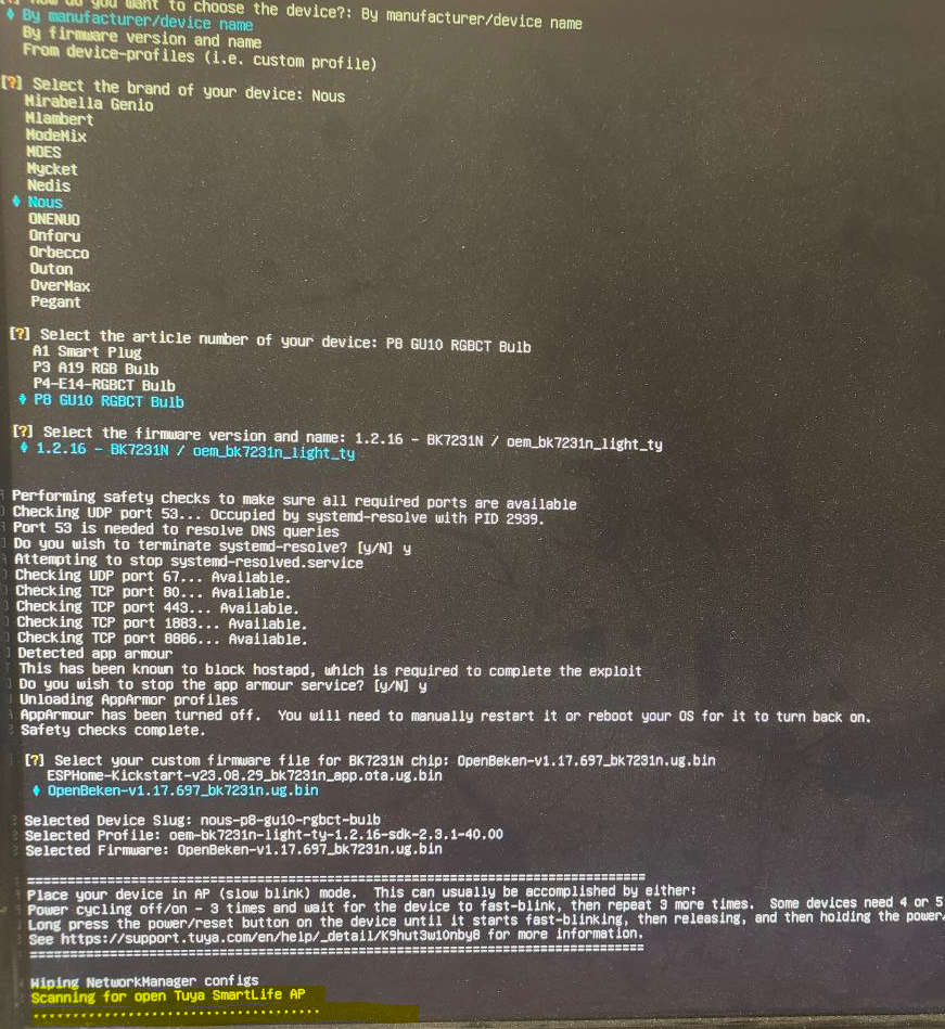

  • Cloudcutter profiles and OpenBeken configs justify teardown
    #6 20289631
    Posts: 14782
    Rate: 12920
    All in all, there are two things that should be added/underlined, because although I have written about it many times before, the topic is incomplete without it.
    1. In other GU10 there were goldpins here and it was possible to remove the legs:
    Spoiler:
    Nous Smart WiFi Bulb P8 RGBCW, GU10, EB01-B + BP5758, pinout WiFi
    2.
    Mateusz_konstruktor wrote:
    Without the ability to put it back together, this project can be considered unfinished or failed.
    This comment is a bit inconsistent with the facts because:
    1. thanks to the tuya-cloudcutter project, if the device has the right profile (created once by ripping the batch with cables), then its other pieces can be programmed remotely. So basically I download profiles, do the "dirty work" and others can then possibly remotely program further pieces, i.e. without opening the housing
    I'm simplifying a bit here, some devices have "common profiles", but let's keep it simple
    2. when I open the device and specify the pins and the LED driver (whether 5 PWM or something integrated on pseudo-I2C like BP5758), others do not have to do it anymore because they have a ready configuration for my OpenBeken, i.e. they do not have to start over her to guess and look for pins.
    So basically, it's not "art for art's sake" or "destroying LEDs in vain", but it makes some sense.
    And supported devices are added to the search engine:
    You can type "Nous" there and it will show...

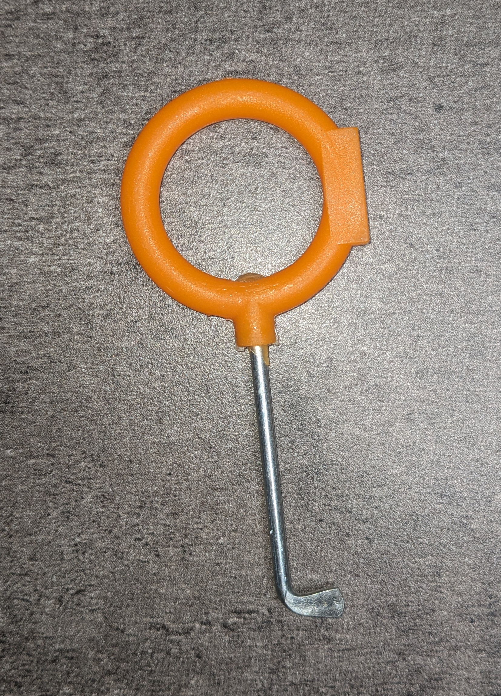

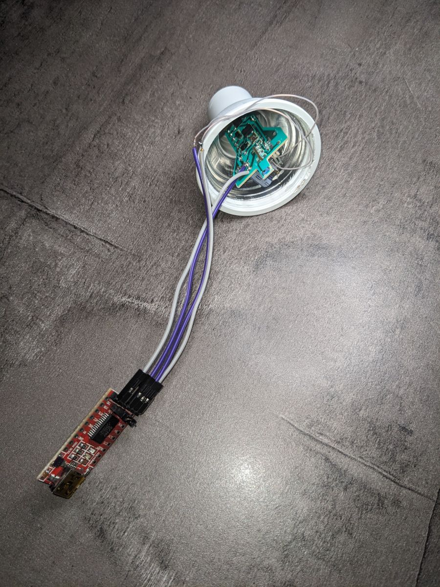

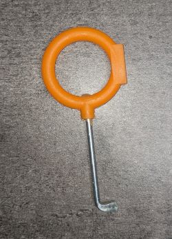

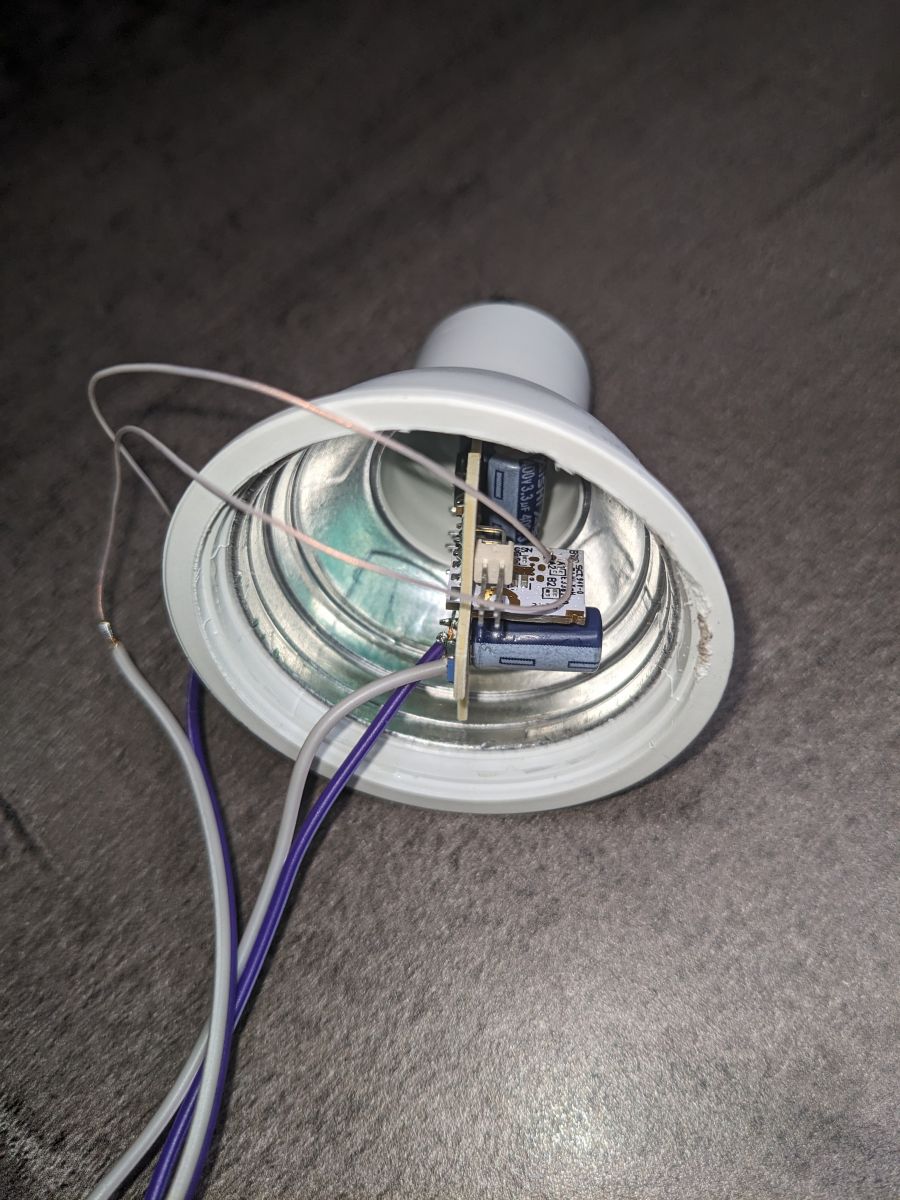

  • Disassembly and flashing via hooked access hole
    #9 20962731
    repsac1
    Disassembled, soldered wires, flashed, unsoldered wires, reassembled.
    Did a little damage to the edge with a soldering iron, but then cleaned the place up so nothing was left.
    Electronic circuit board with connected wires inside a light bulb casing. Dismantled LED bulb with visible wires and circuit board.
    With a hook like this, it's easy to pull the plate out if there's a hole like in my bulb.
    Orange hook with a metal tip on a gray surface.

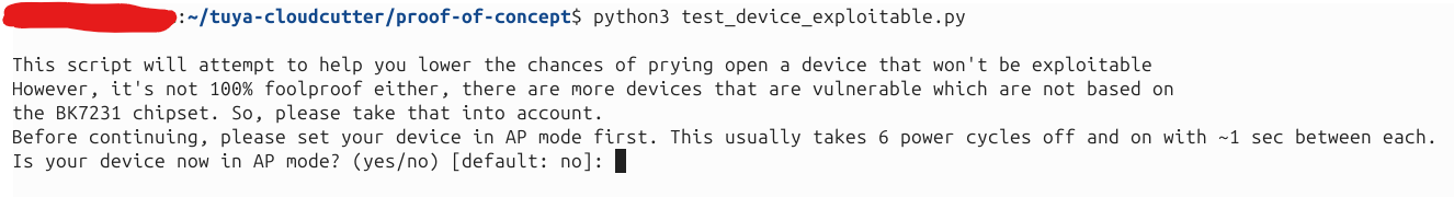

    divadiow wrote:
    Also doesn't Cloudcutter have an exploit-possible checker option?
    try this?
  • #18 21343684
    tech1977
    Posts: 29
    how do i test it? i cant connect it to the access point of the light bulb

    if the access point doesn't activate, eLightleak can't work either?
  • UART flashing required if AP mode cannot be enabled
    correct. Lightleak and Cloudcutter rely on a working stable AP.
    tech1977 wrote:
    if I can't activate its access point even if I open a light bulb, then I have to open the others too?
    If Cloudcutter or Lightleak are not an option then the only thing would be to open each one and UART flash, yes. This could be troublesome though depending on how destructive you have to be to gain access to the module.
    Have you created an issue in the Cloudcutter Github in case I've missed something?
