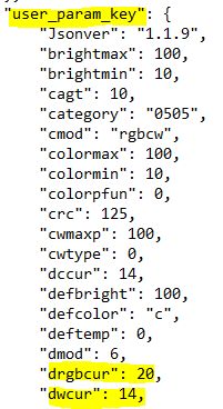

  • Factory firmware exposes RGB and white currents in user_param_key
    #3 21029332
    Posts: 5216
    Help: 448
    Rate: 917
    If you were able to get factory fw the RGB and W currents appear to be set under user_param_key.
    eg Screenshot of a JSON file fragment showing user settings.
    Maybe Easy UART Flasher could be updated to extract and display this too?
    actually, I see you attached json which has this. cool. Is the C in dCur "COLD" as opposed to W perhaps? It looks like there's only 1 white LED type on that disc, so I guess that makes sense. no dWcur in your json
    Screenshot showing a JSON code snippet with various keys and values.
  • Config dump shows dccur and drgbcur swapped
    #4 21032465
    tom105
    Hi,
    Yes, I was able to get the configs. Put this below:
    I can see again that:
    "dccur":"13",
    "drgbcur":"14",
    No mention of dwcur though. I assume they are swapped.
    Regards,
    Tom.
